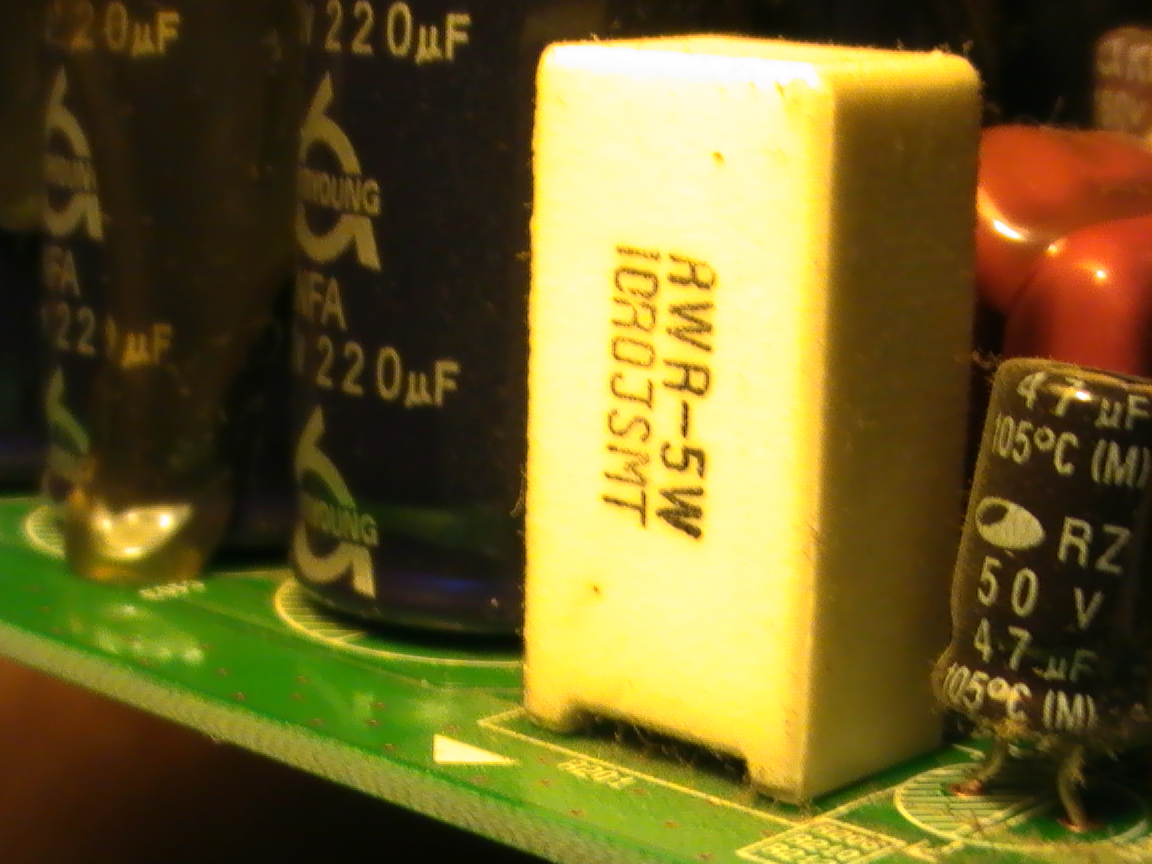

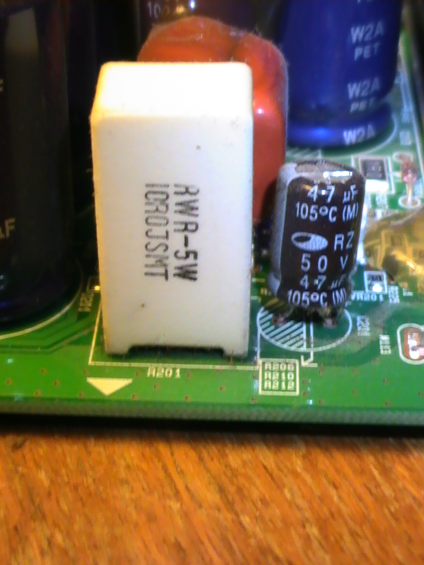

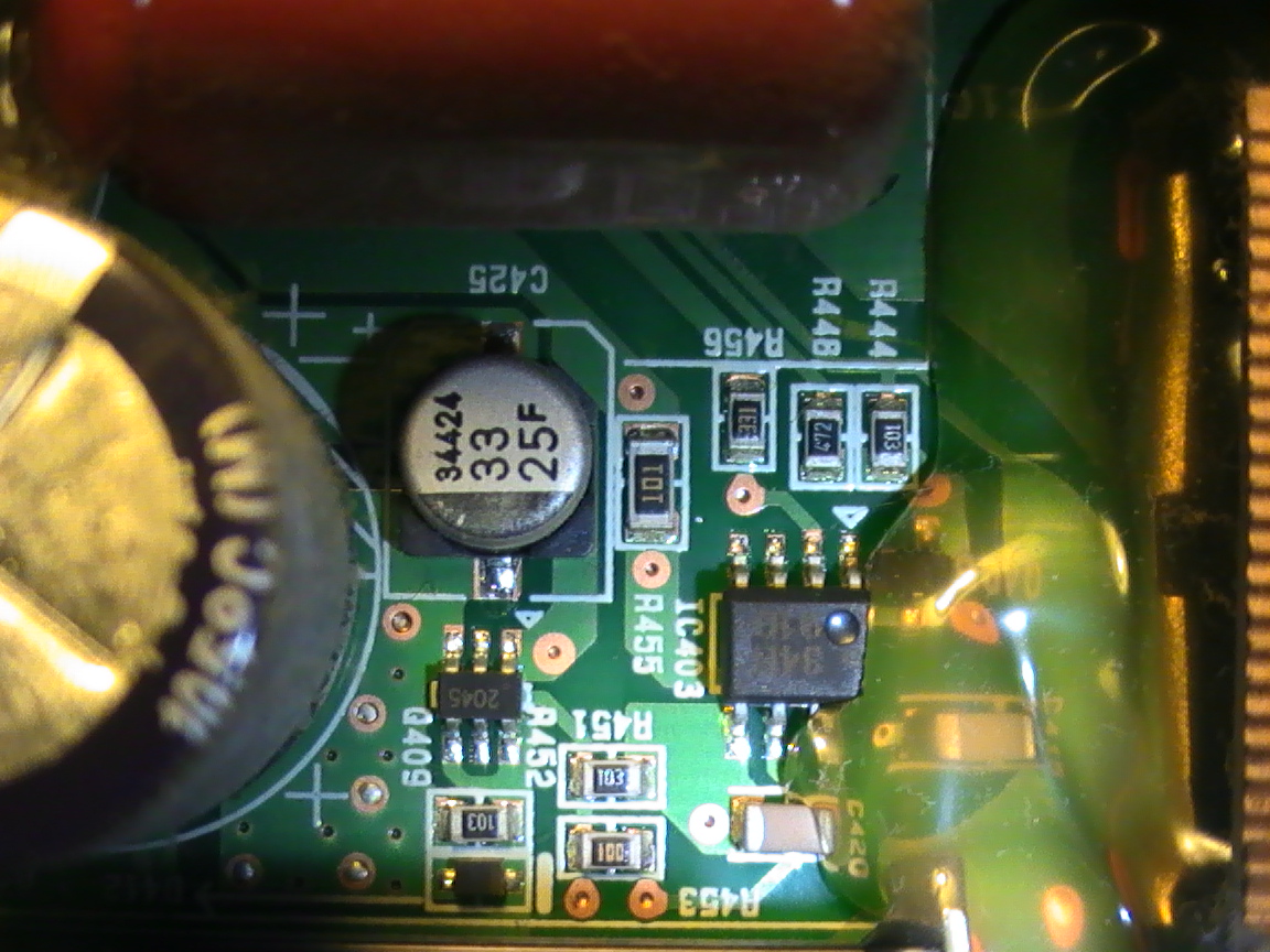

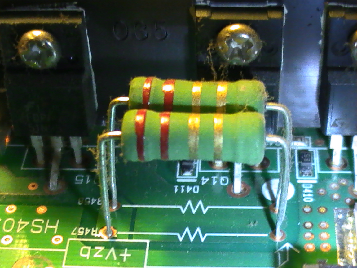

    Last 4 from Front... Note found that Q15 drain and source had about .3 ohms in both directions.. think its shorted. Q13 and Q14 show 8M ohms drain -, source + and open the other way with the probe leads.
    Let me know what other measurements to make...
      Re: LG 50PS80 51" plasma - startup issue
      Shorted Q15 could do it! That looks to be the regulation transistor.

          Found a good deal on the Z-sus board so picking that up to compare with mine. I found a link to a very similar problem here:
          http://www.tv-forums.com/forum/TV_Eq...oting_P151178/
          Seems Q13-15 and a few other parts are involved with a fix kit that is sold on eBay. Looks like a bear to disassemble, especially that sticky foam I had to peal away..
          If mine doesnt test out, I'll fix for a spare later.. Here's hoping that the replacement is the fix. I'll test the VZbias first prior to hooking up the to the panel to make sure its in specs.
            Soooooo... yes, it was the Z sustain board. Plugged the new one in without connecting it to the display and the Zbias measured correctly! Shut her down and waited a bit and inserted the flexible circuit connectors to the board and powered her up and it was nice and stable. Thank you so much for getting this newbie a working unit that I would have been pondering over for awhile if not for this forum and yourself! Let your professors know that you are doing a great job here support many people. You have a gift and using it like this is a wonderful thing... Let see, since last discussed, bought second hand Playstation 3 40G. Total investment.......$142 and our time... Watching first Bluray tonight after hooking back up the 5.1 system that I've had but not used in some time now.. Again, thanks!
