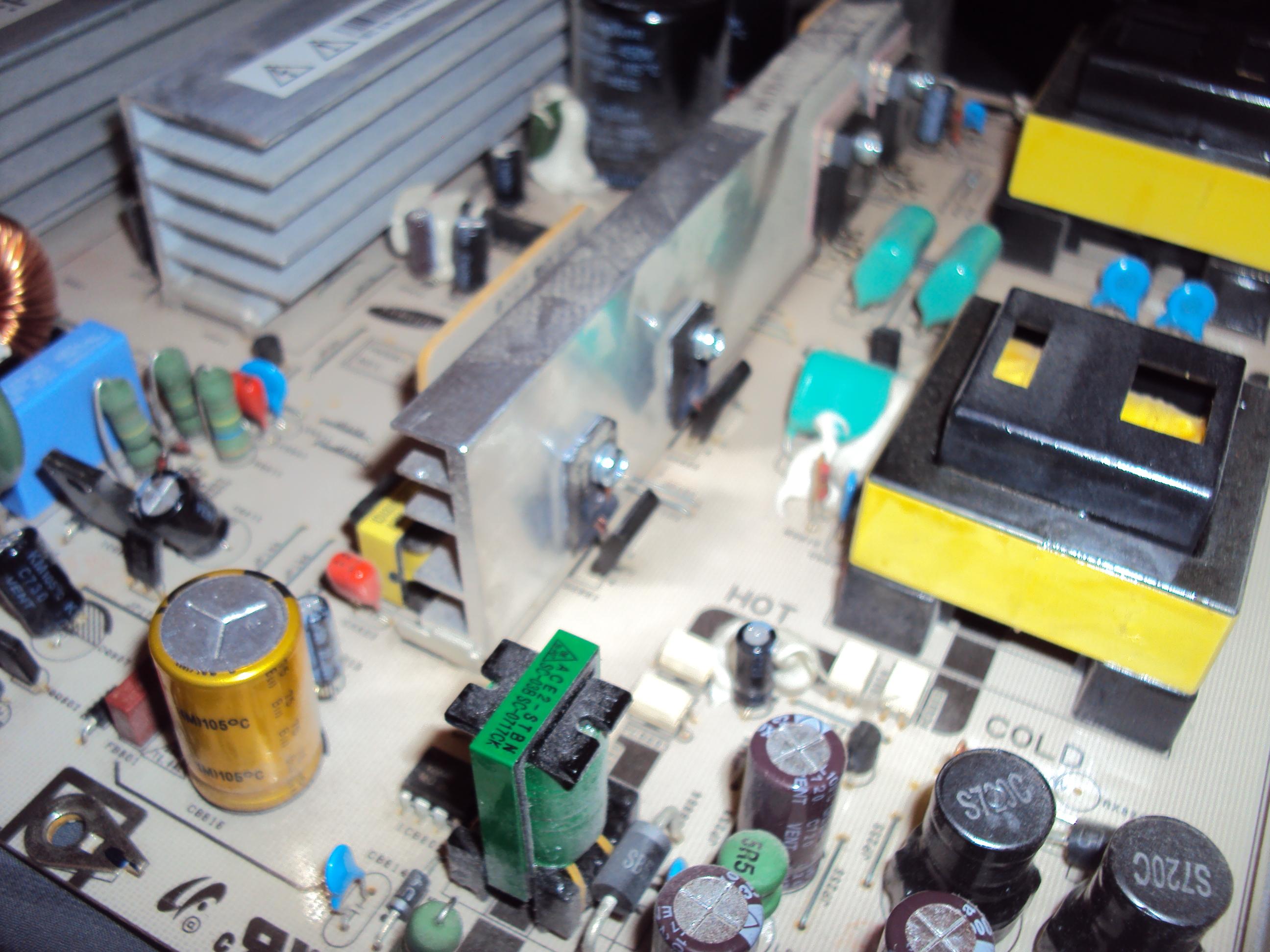

    Just got a 42 inch plasma that wont turn on, apparently repaired previously, that it would take x ammount of time to turn on etc, got told they soldered something other than that i don't know

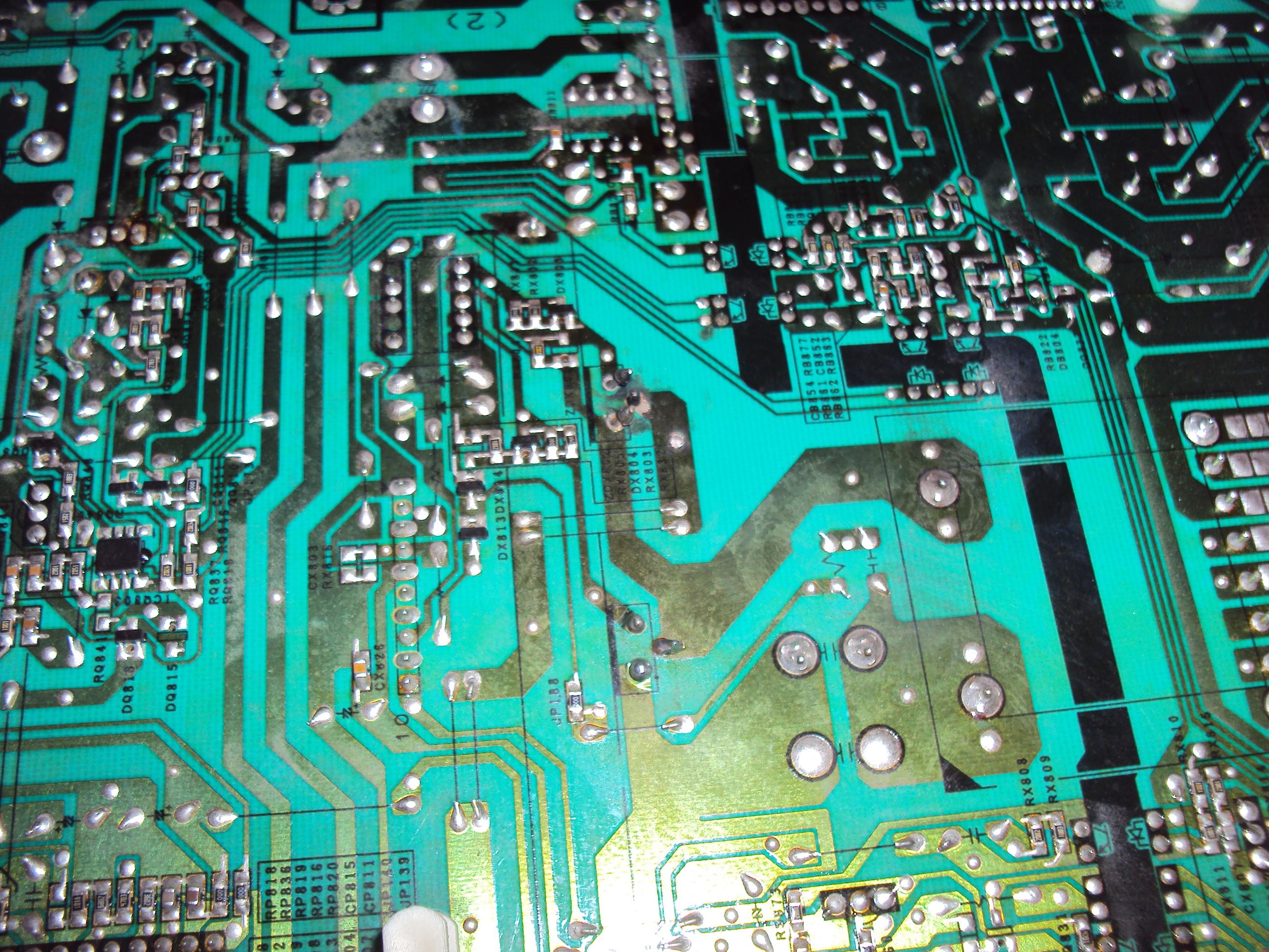

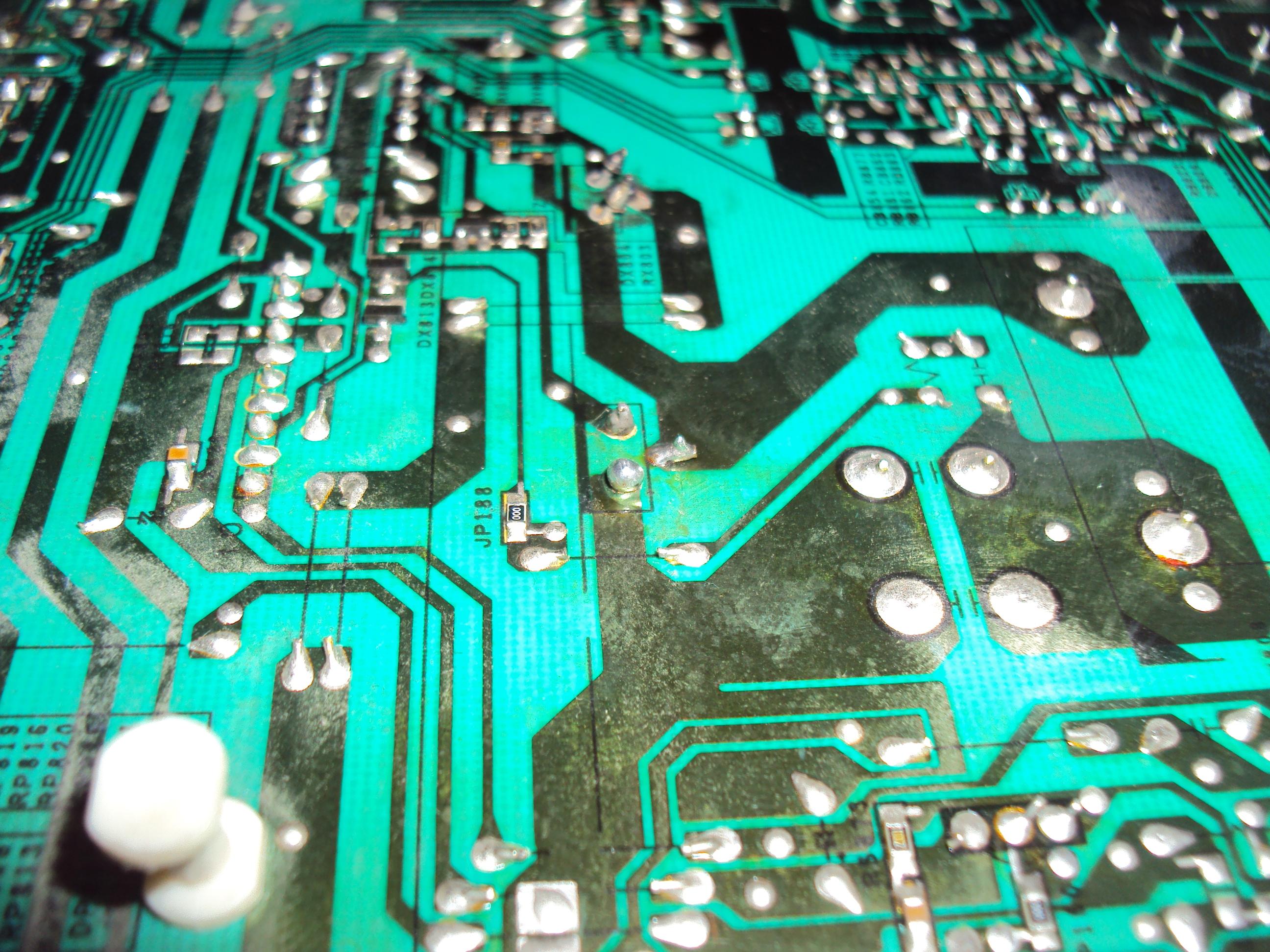

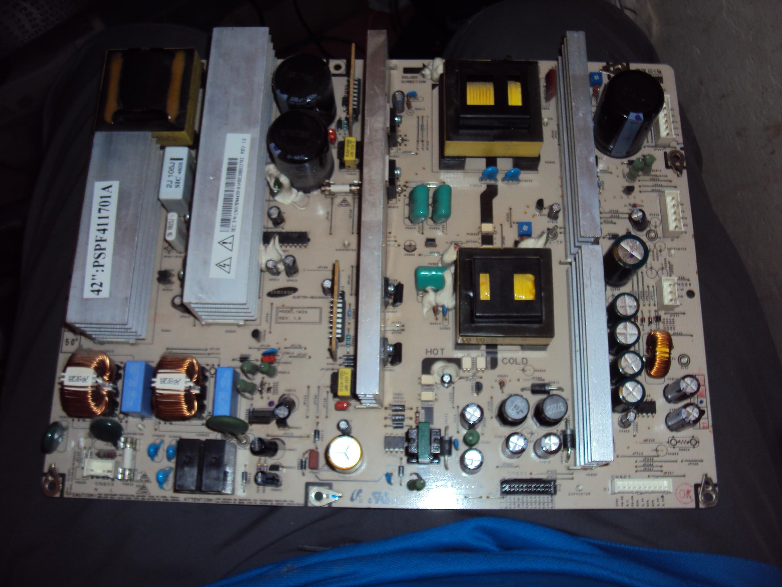

    anyway got the psu board out PSPF411701A and it appears someones done a bodge job on it previously from what i can see anyway
    looked through various places about checking the f803 fuse and the 801-802 mosfets but not sure if it's even fixable at the minute with the previous symptomns
    took some pictures anyway it looks like whoevers repaired it did poor soldering too

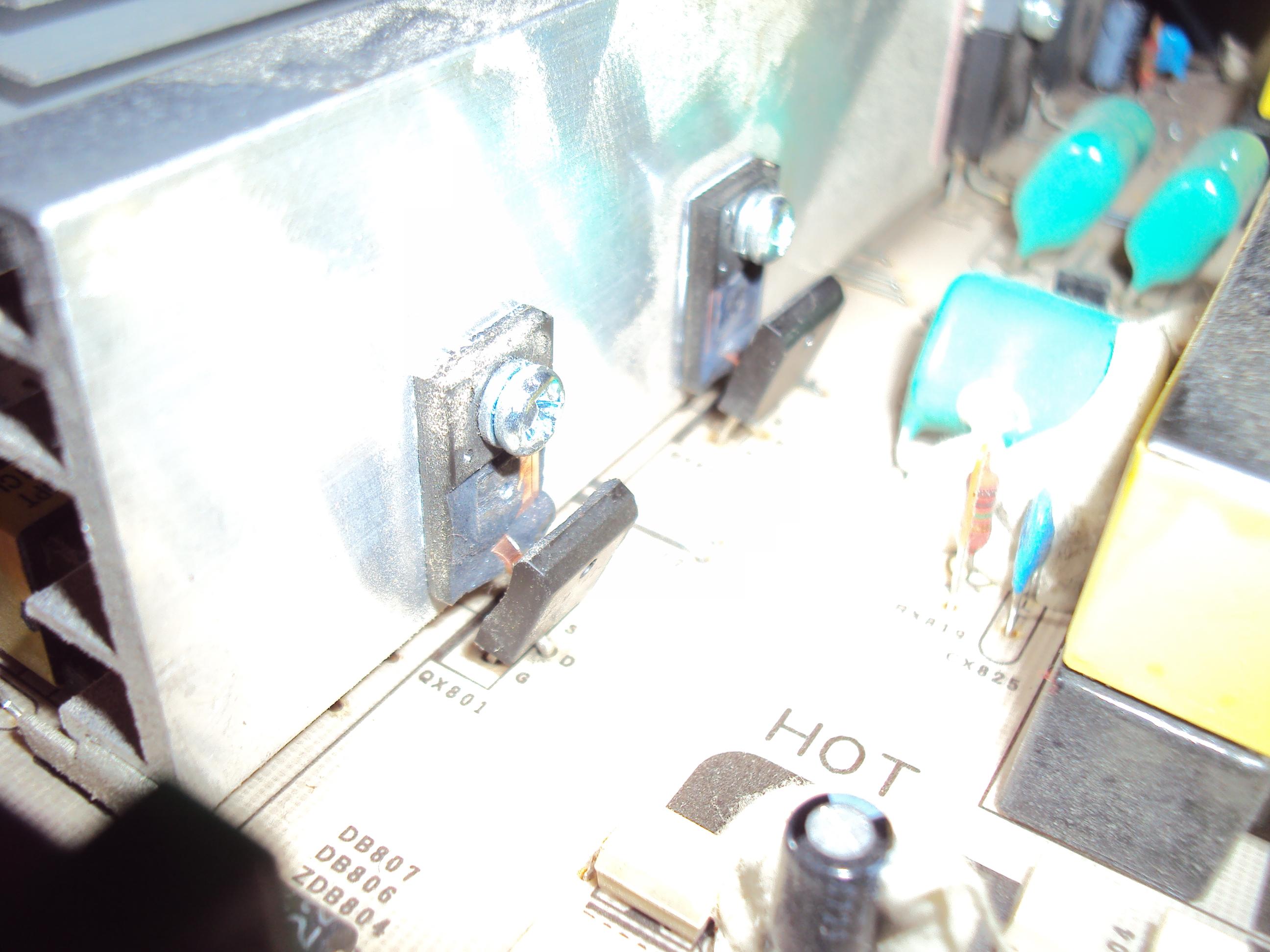

    Looks to me they're transistors which have literally blown apart.

    The signs of failure are usually visible with naked eye in the form of burned / blown open transistor QX801 and/or QX802 and usually burned pair of resistors RX833/RX802 and/or RX803/RX832 which are closely located to the transistors at the bottom of the board.
    Whenever the resistors are blown it is almost guaranteed that the SMD diode they are connected in parallel with is also blown.

                                  I don't have any genius ideas for you but on that heatsink you replaced the FETs on I had the same generation PSU for a 50" which had cracked solder joints and would go dead with flexing.
                                  maybe check out the remaining joints if you have not touched them up just in case it's something simple.

                                    not sure if i'm narrowing anything down here but plugged it in and didn't hit the power button and got my multimeter and started testing parts on the board
                                    nothing gets over 1v including fets and the 5.3v test point
                                    or am i way off here? and that voltages should only kick in when the set is turned on?

                                      You can take the swap this swap that route until you hit the problem, or start down a logical process, which I think is where you are with the power supply at the moment. First check you should be getting some outputs and if 5.3 volts is all you're getting chances are that is your standby supply, which is always there and separate from the main supplies. What we need to find out is if the other supplies are being pulled down by a short-circuit (no clicking means less likely to be the normal failure that a lot of people have had), a bad previous repair is focussing attention there as well, not a bad place to start. Time to do some basic supply tests, isolate what you can, and jump the standby 5volts to the PS-ON (or whatever it's called in this) and see if any other supplies come up. Can you send a photo of the low voltage connector area on the PSU board (the ones that connect to your main board) hopefully with voltage markings on them, then we can tell you how to proceed.

                                        Those two FET's have had a crisis, to me they appear to be on the Hot side of the VA supply, I wouldn't be probing around there with a meter, in particular any voltage on those is in relation to the hot ground only. They wont fail for no reason either.
