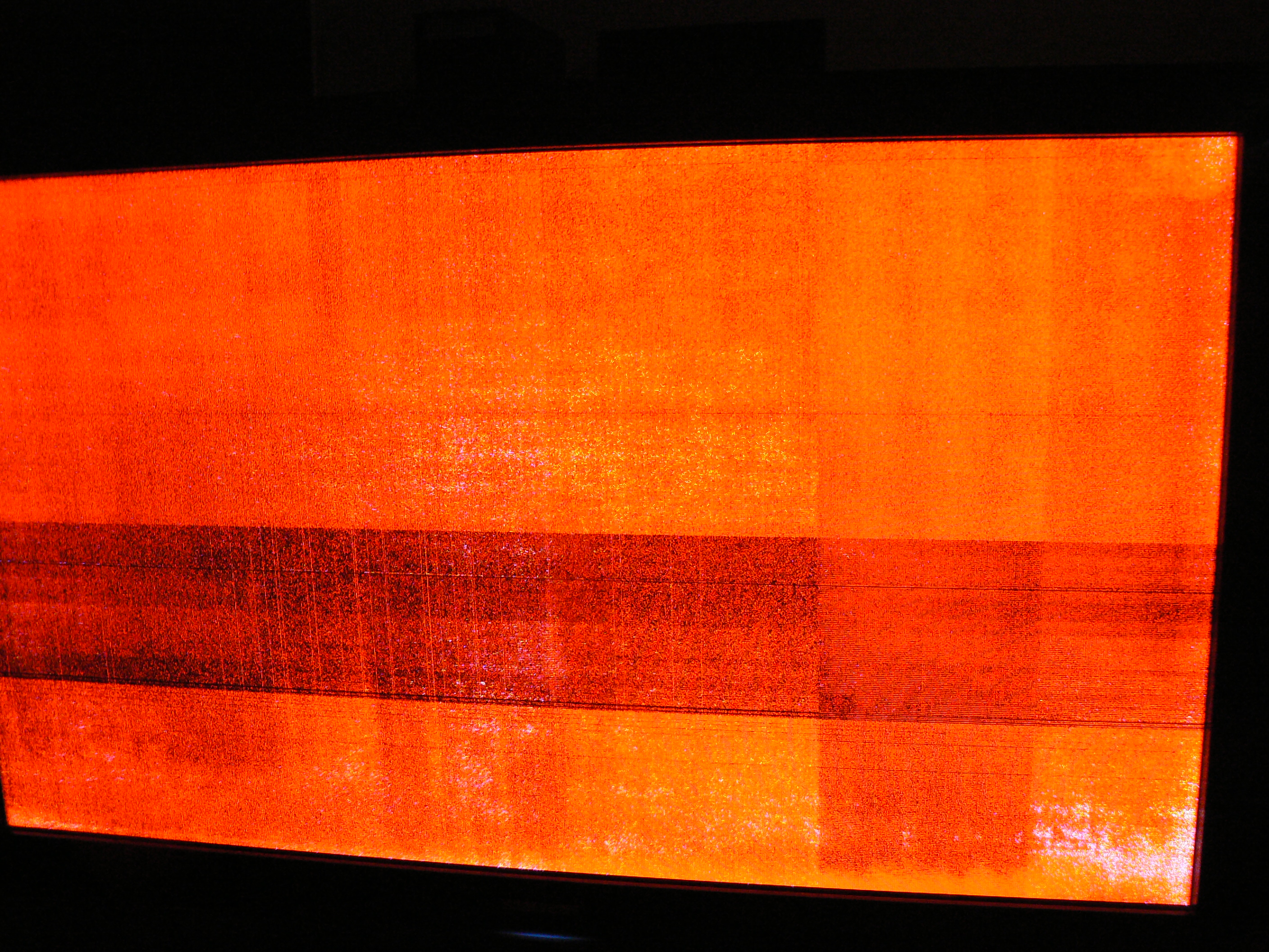

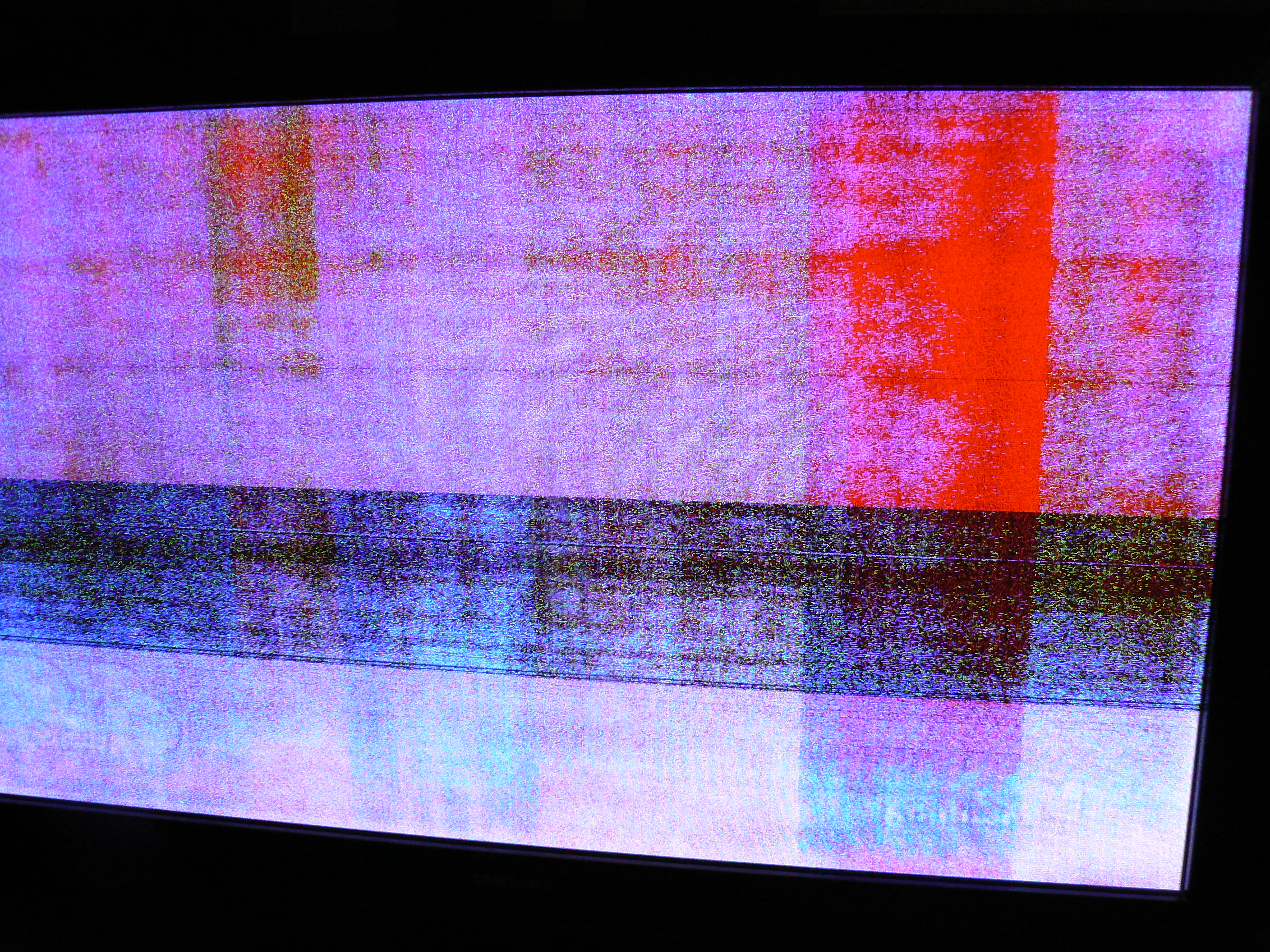

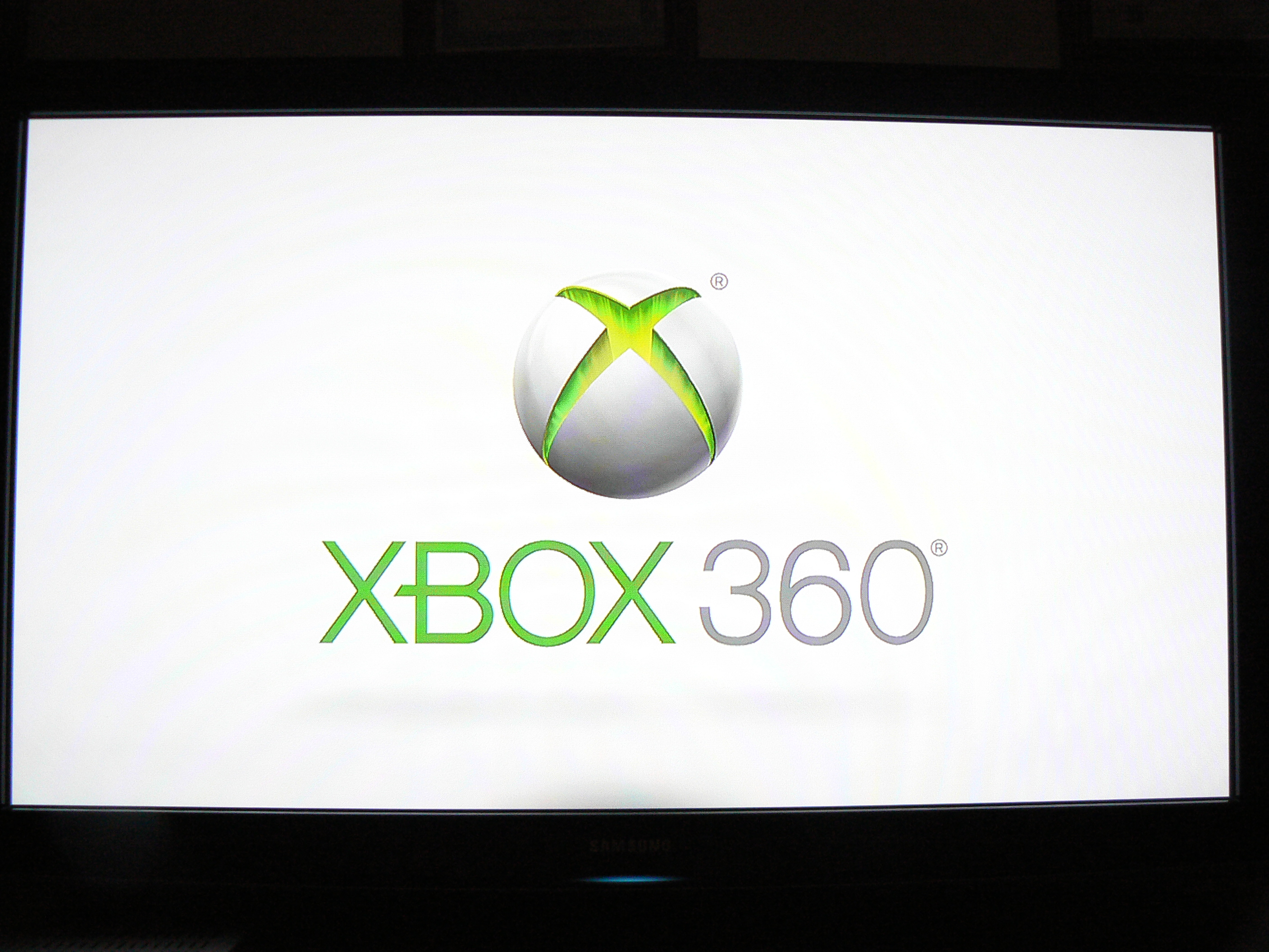

    I picked up this Samsung plasma PN50A450P1DXZA that had sound but no picture. The power supply tested good, but the Vscan voltage was bad and the Y-main was making a noise.

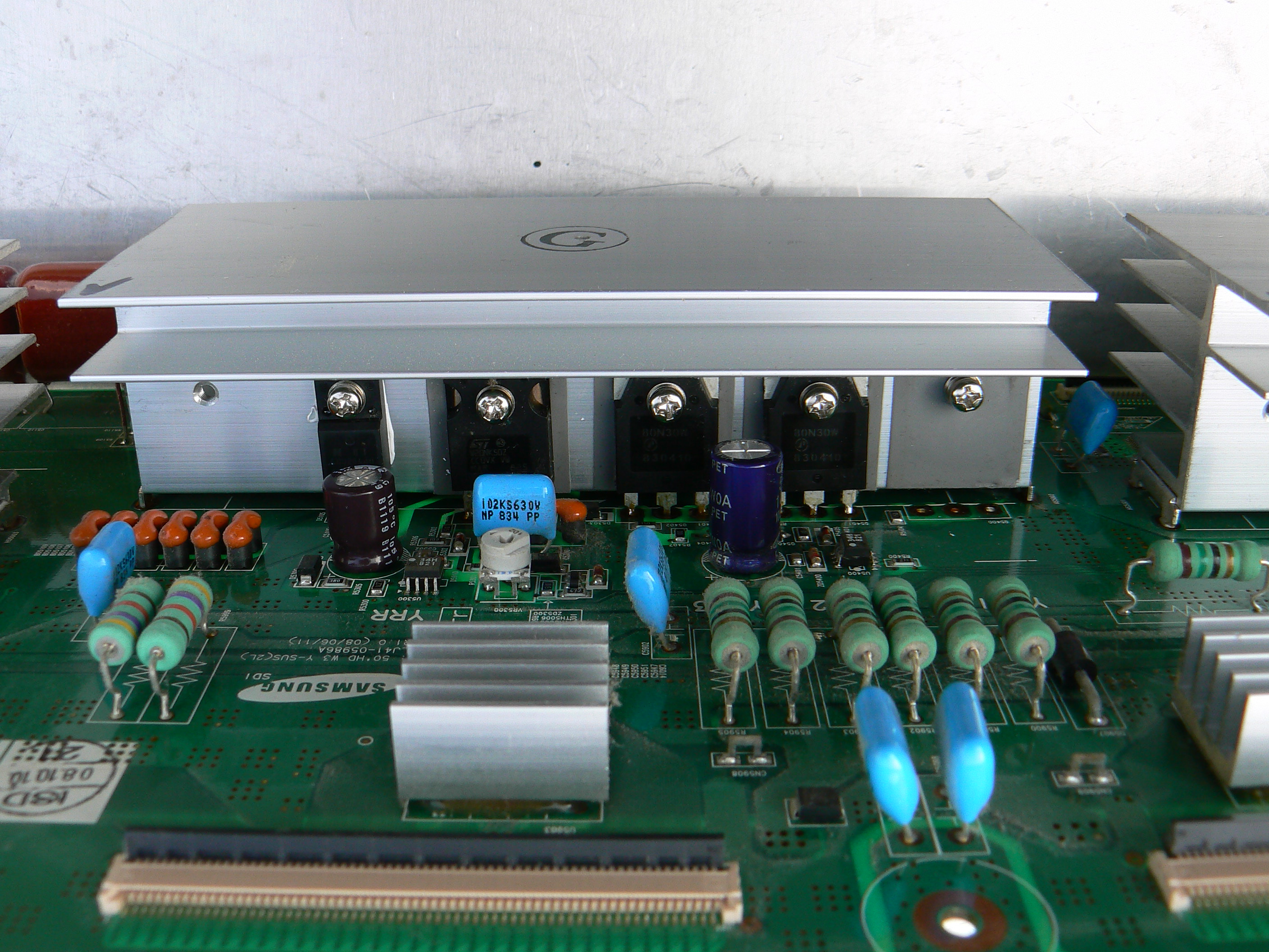

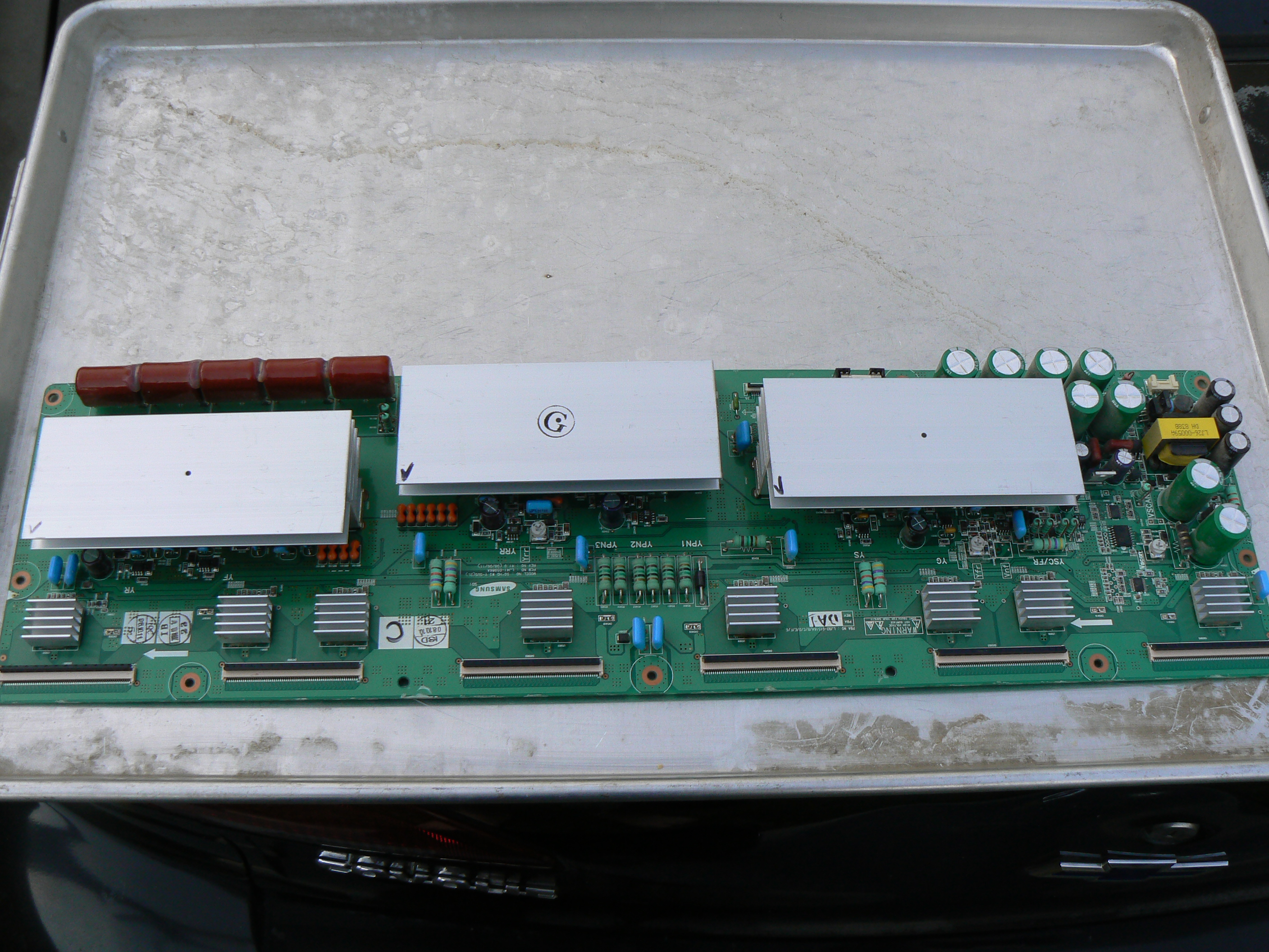

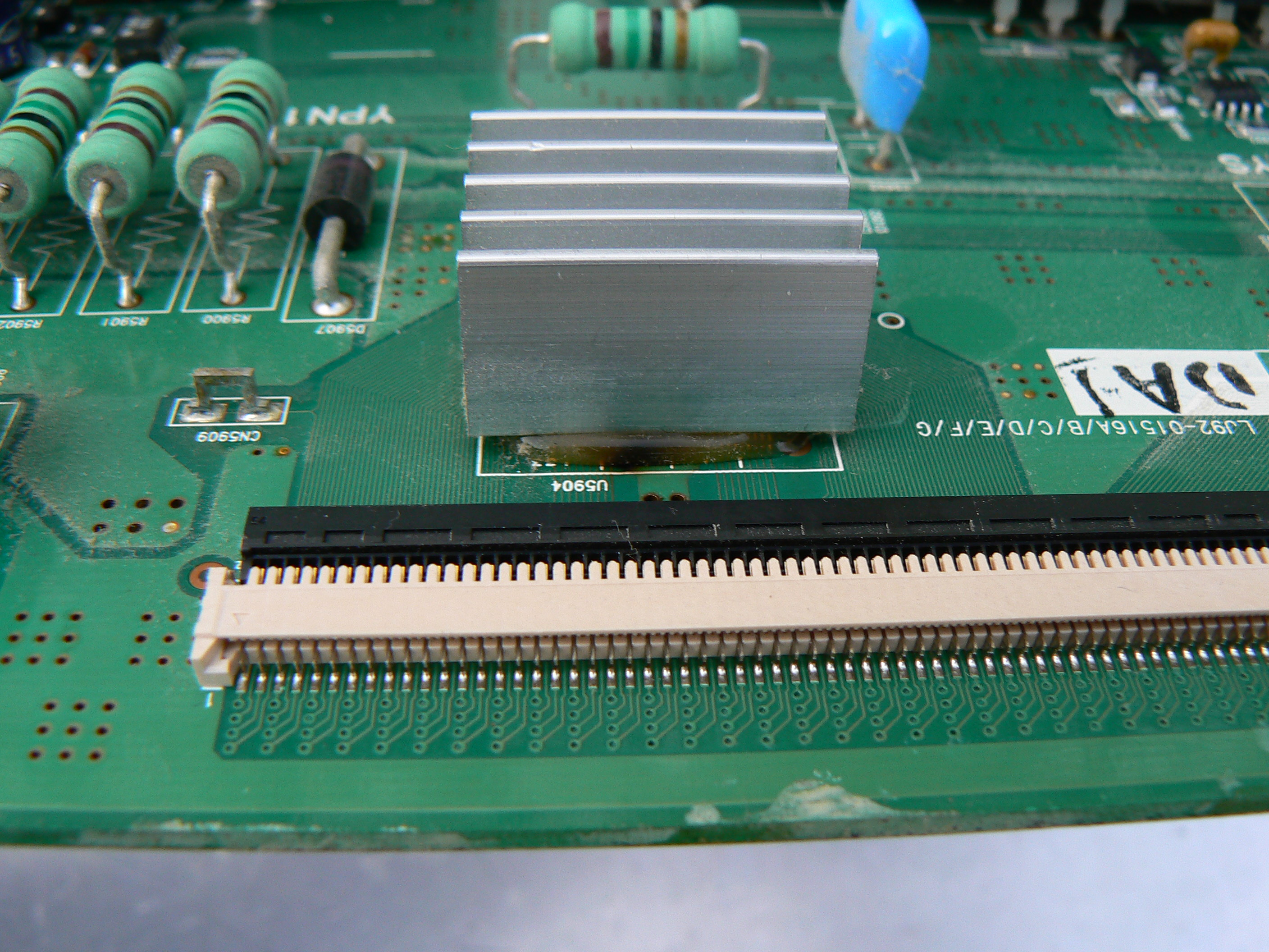

    I pulled the Y-main and found a shorted FET (80N30W) that was attached to the center heat sink. It was one of three ganged together so I decided to see if I could get something on the screen if I left the shorted one out. I would not run it like this but I figured it would be OK for testing. I also replaced a bad 63V 68uF cap that located under the over hang of this heat sink.

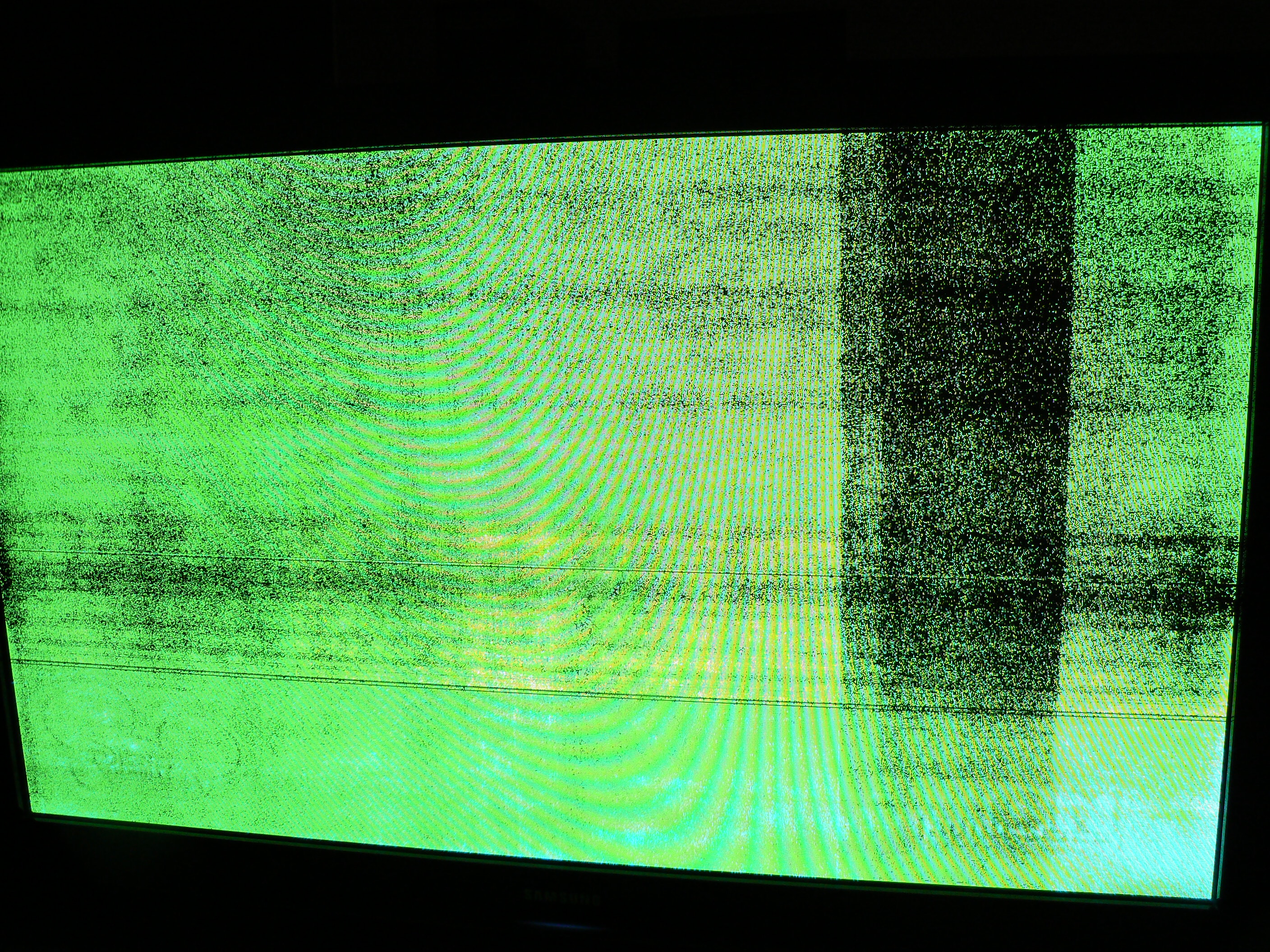

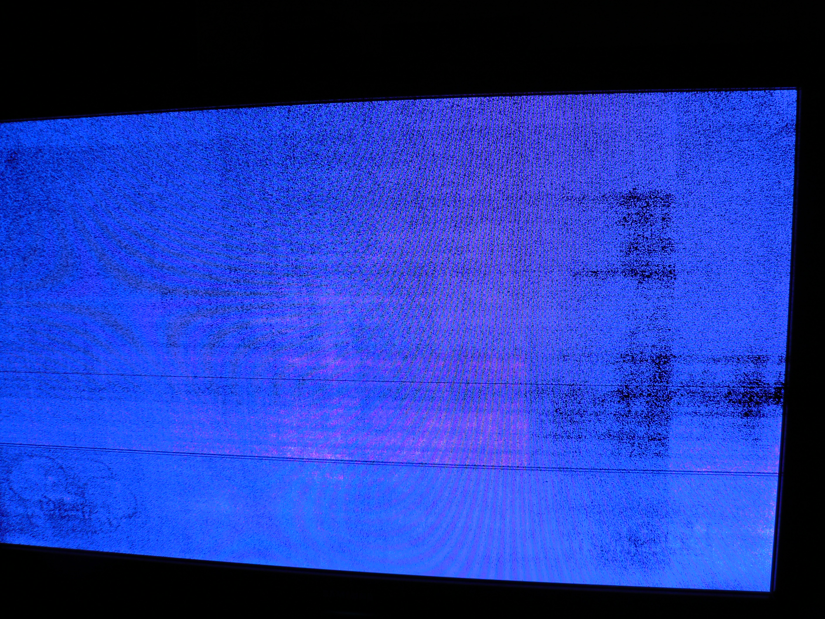

    After this the screen would turn on but it had a lot of issues and I could not even discern if it would show a menu. I thought that putting the control board into test mode would be the best way to tell if the screen was actually good. I know the Y-main is bad since one of the drivers gets way hotter than the rest and it shows heat discoloration.
    From my pictures, does it look like the screen itself is still good? Also, if the screen itself appears good, does it look like any of the other boards are showing signs of damage? I would like to repair this TV if possible but I do not want to waste time or money on something that will never work properly if I can help it. Any constructive input would be appreciated.

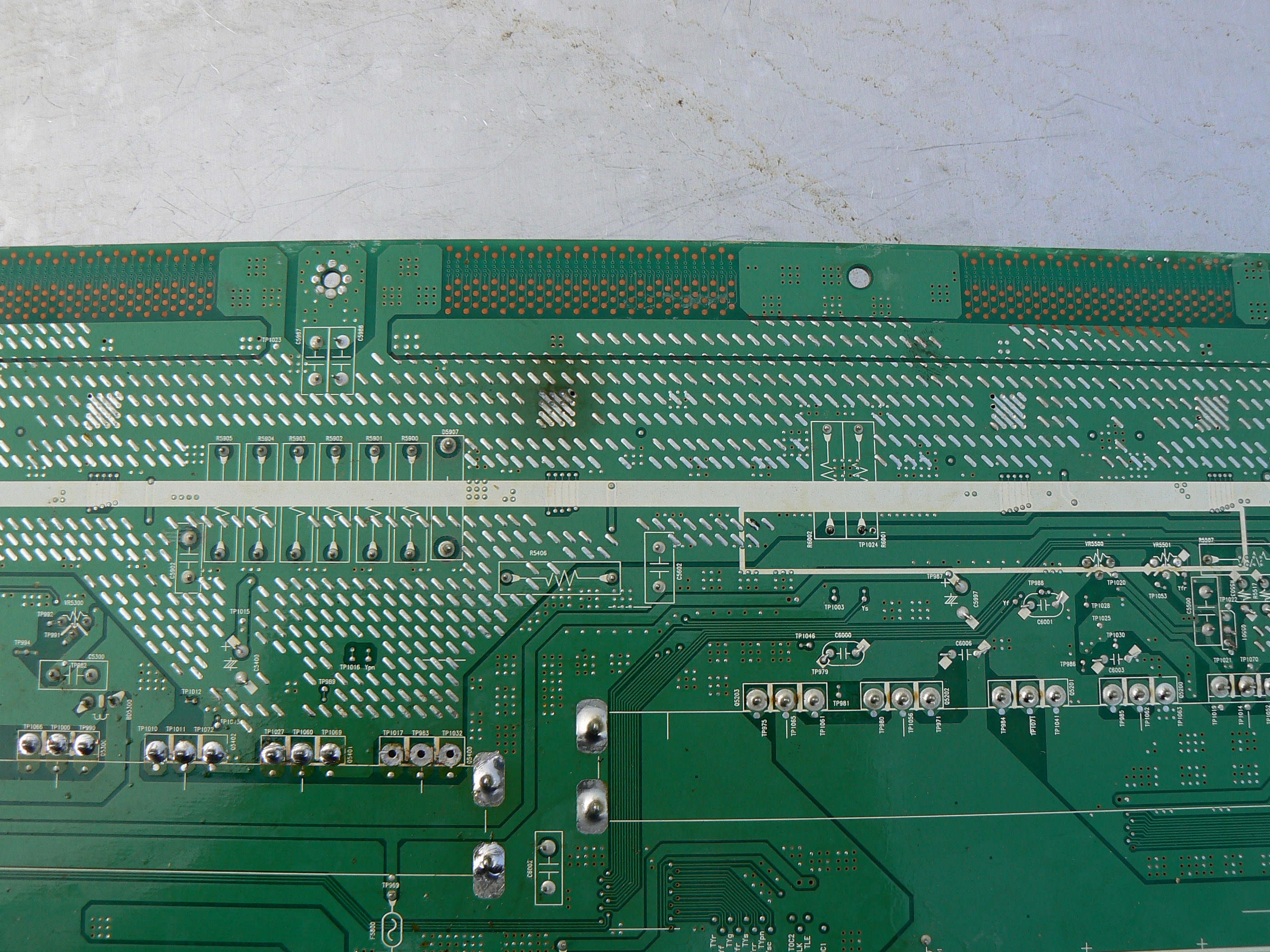

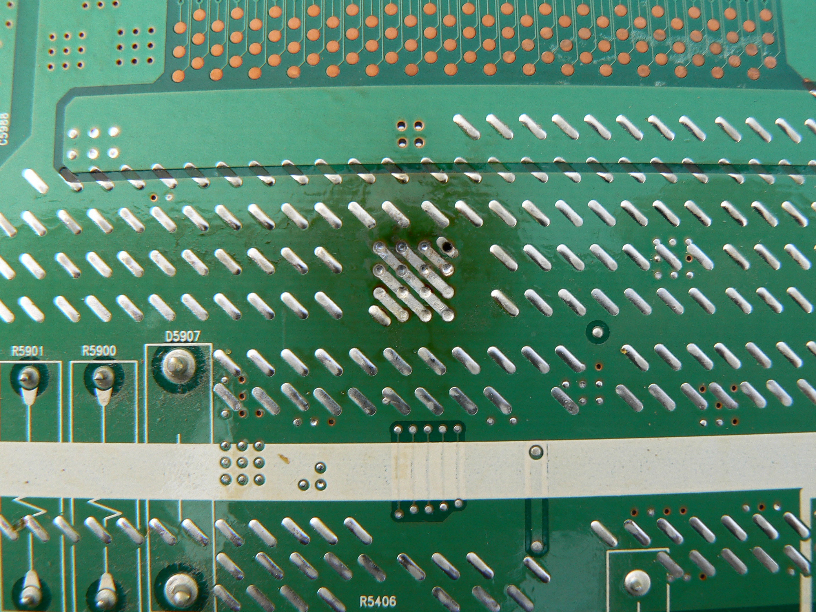

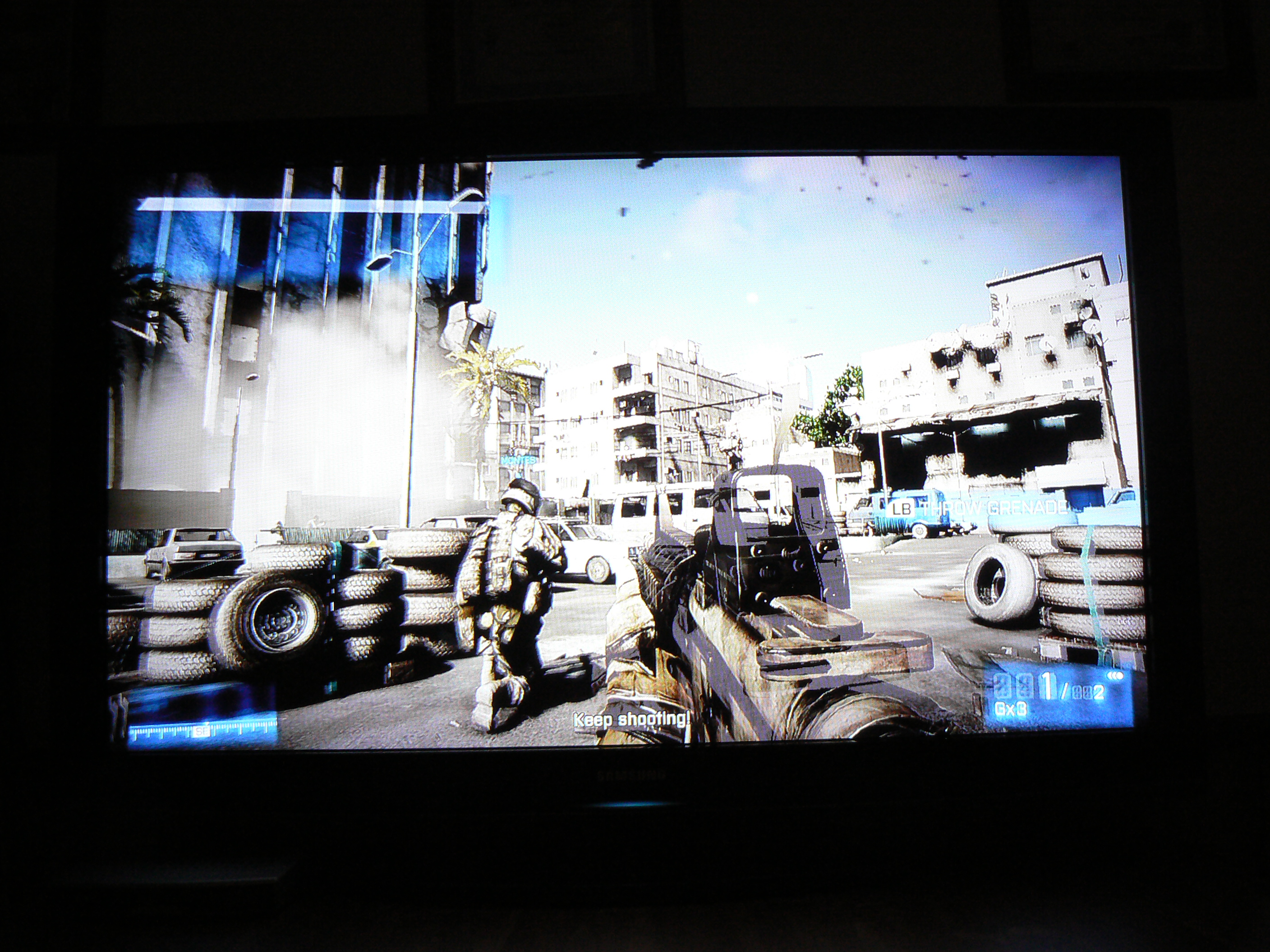

      I afraid I have a problem on the E-buffer but what exactly I am not sure. It seems to work somewhat, but not as well as the rest of the panel. This board is not replaceable so if I cannot figure out what is causing the vertical band then this TV is worthless.

        Well, I re-soldered the 1 ohm resistors on the E-buffer in the area of the dark vertical stripe. This seemed to fix that problem as I could no longer see a vertical band. I was going to take of picture of the somewhat improved image when it appears that the Y-main bit the dust completely. I now again get nothing on the screen. The only thing getting hot on the Y-main now is the driver that was going bad. Just seconds after powering on the set the heat sink gets so hot you almost cannot touch it. It appears that if I am going to proceed with this set I must acquire a working Y-main and hope the rest of the boards are working properly.

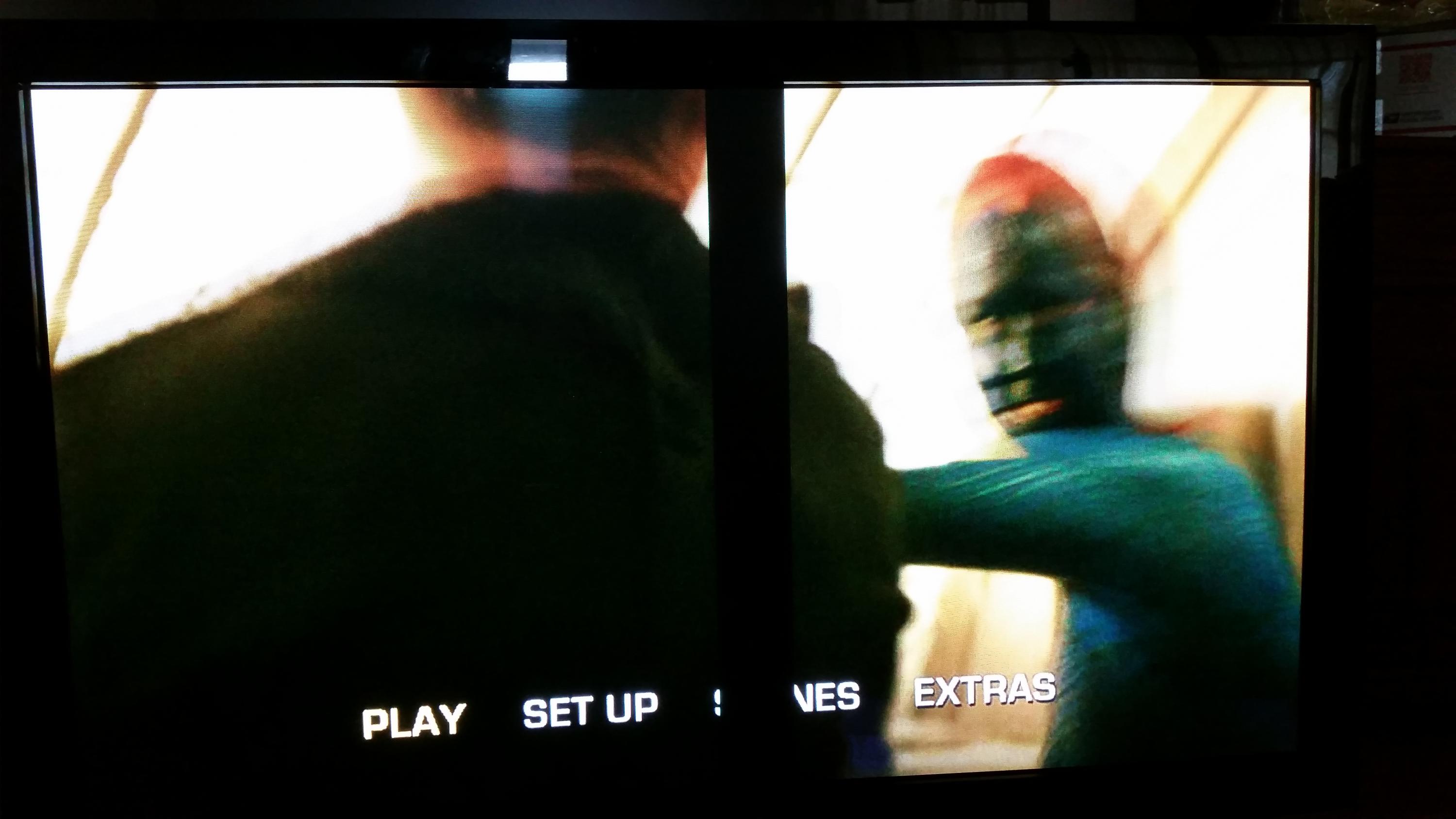

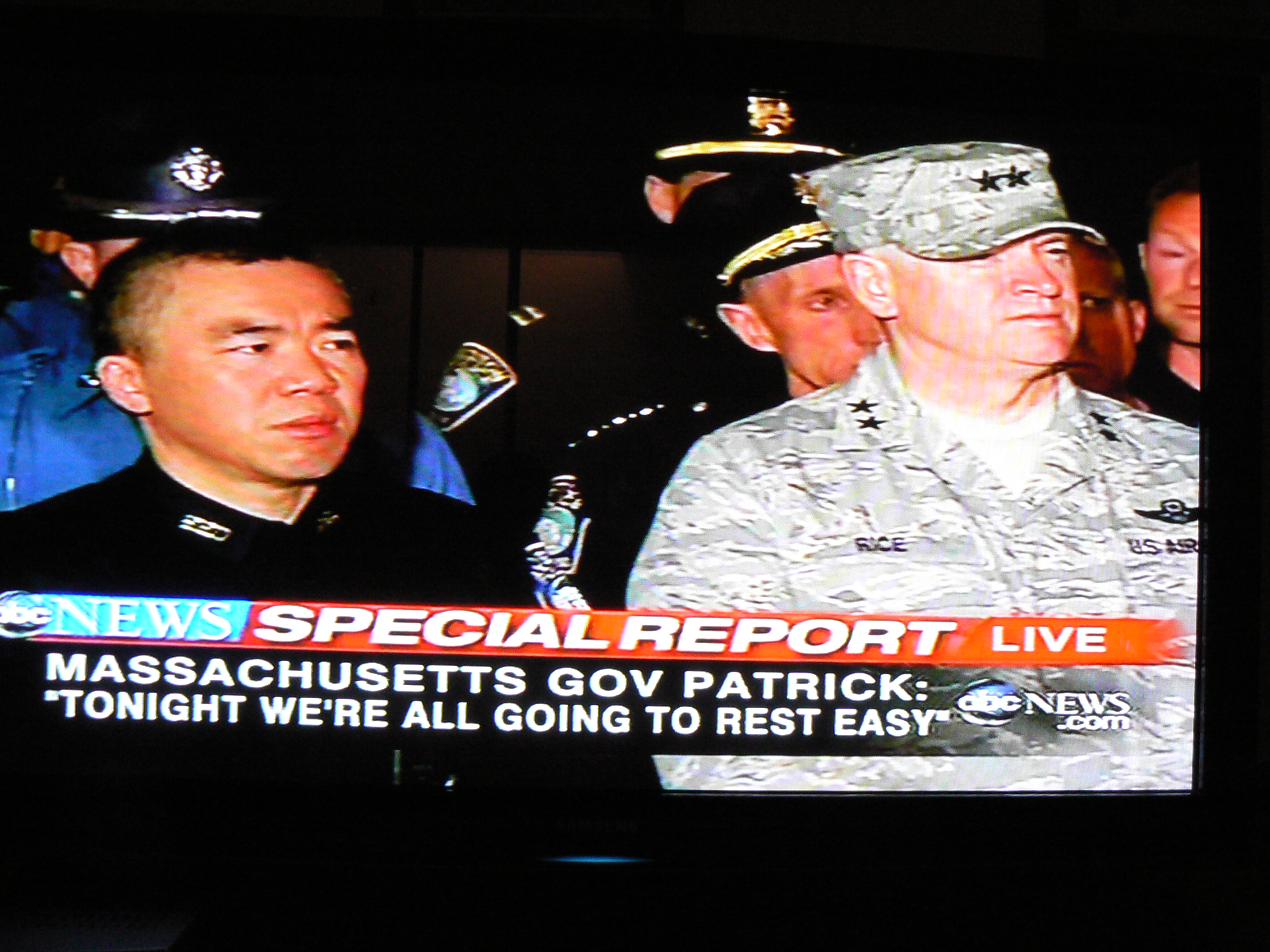

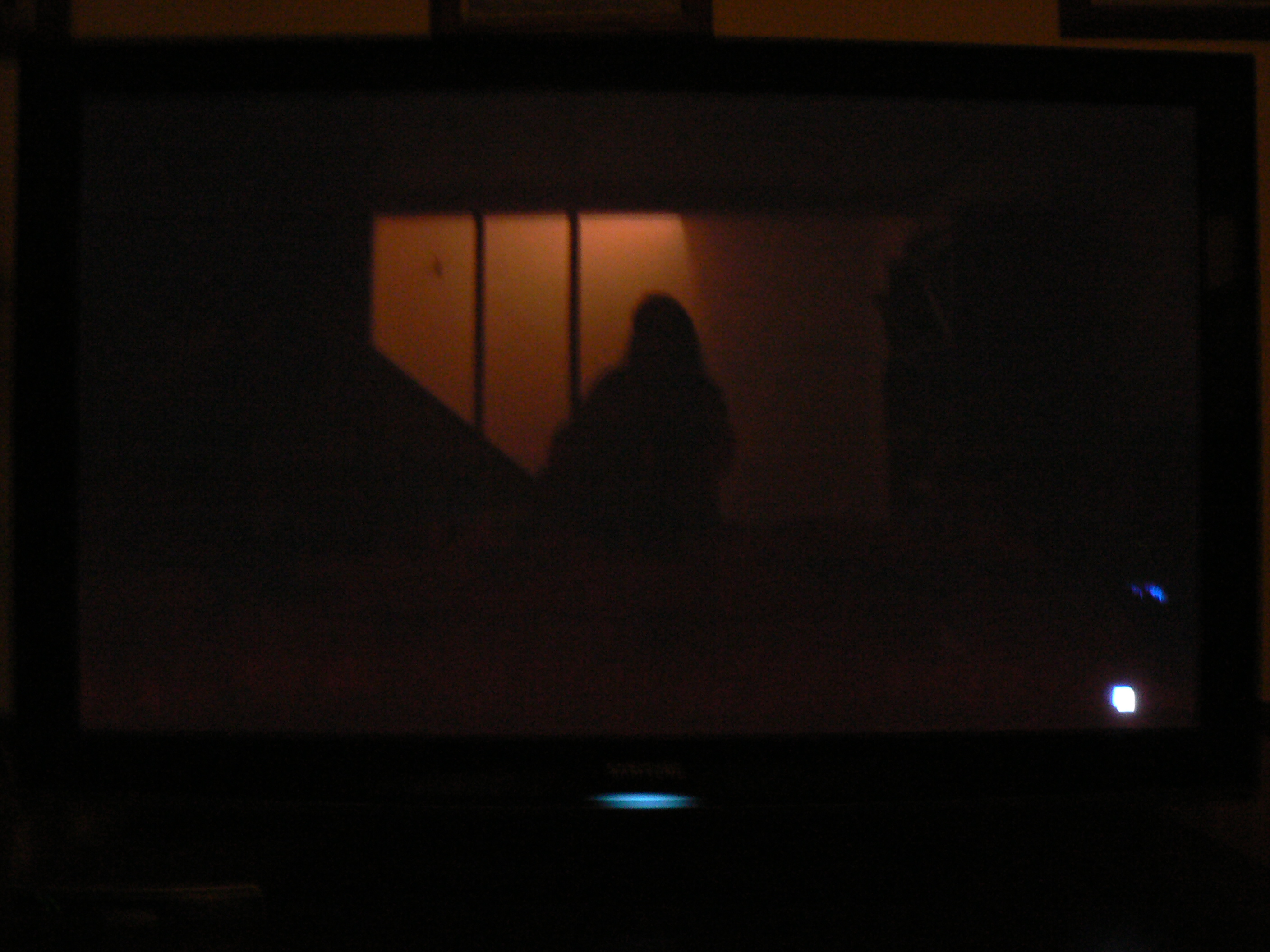

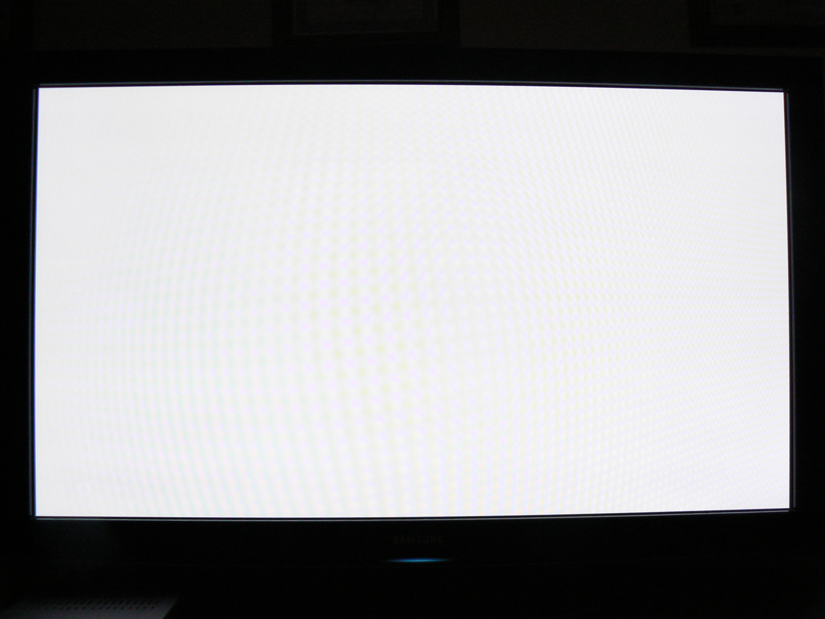

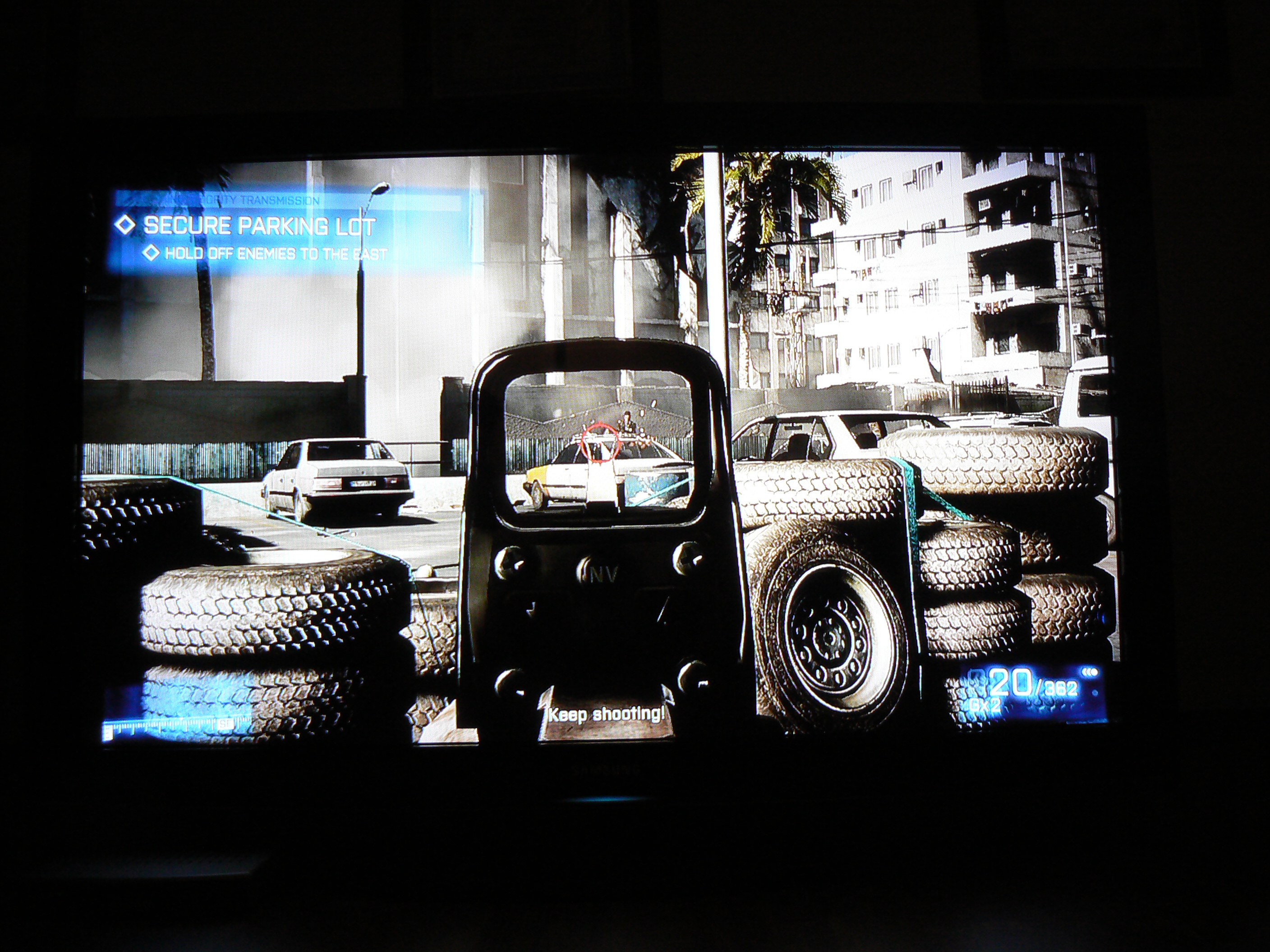

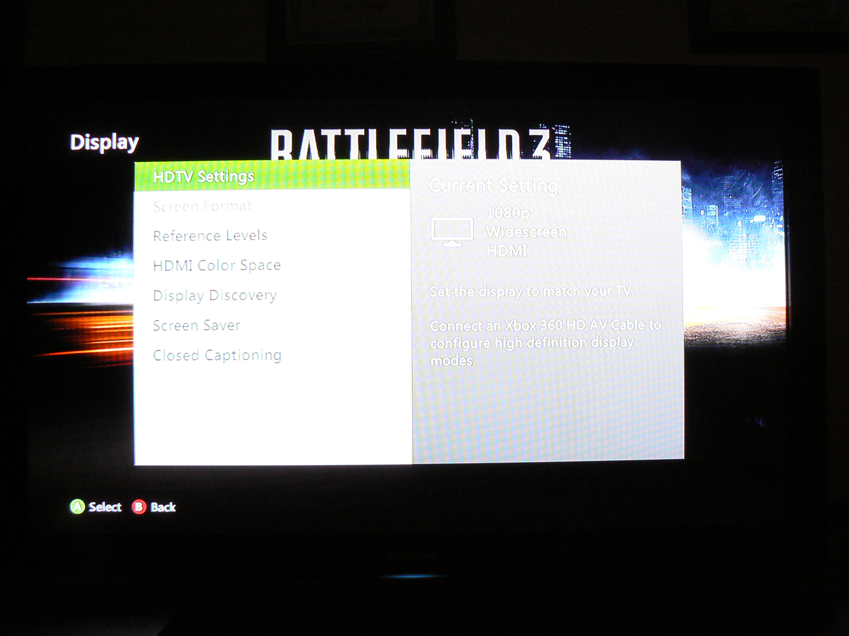

              I received my replacement Y-main today. I initially tested it in the control board test mode. On the green screen there was "sparkles" all over it, but adjusting the VS seemed to take care of this problem.

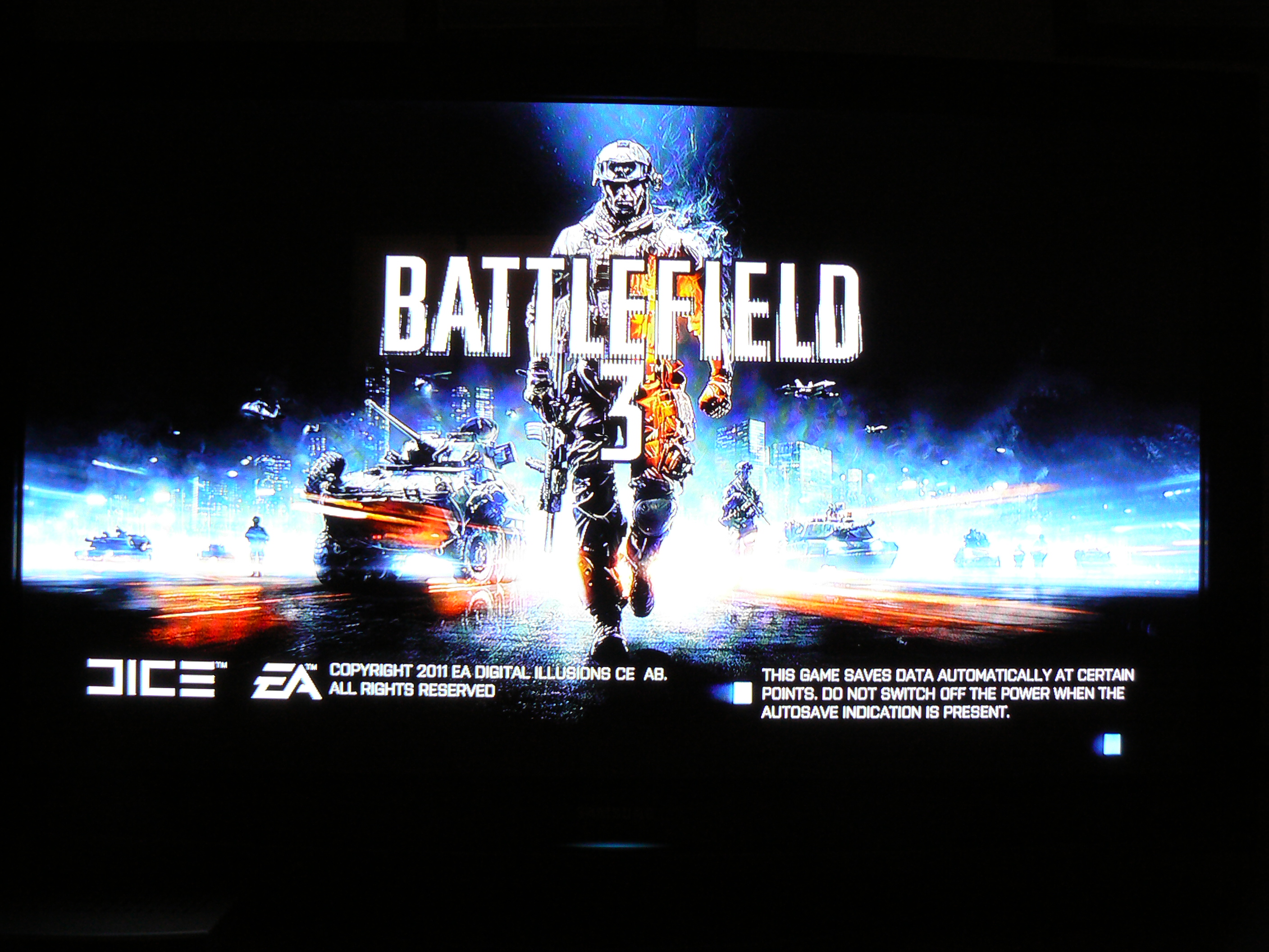

              Over all I am very pleased with it. I do have one concern and that is when the screen is black (like in the last picture) there is red showing up on the bottom third of the screen. It is not even, as it seems to rise toward the center of the screen. This does not show up during normal operation unless there is a lot of black on the bottom of the screen. If anyone has any ideas about the cause and possible solutions to this red area, I would love to hear them. I am not overly concerned with this red area, as this TV will mostly be used by the kids to play video games, but if it is a sign of an imminent problem I would like to address it.
                Re: Samsung plasma PN50A450P1DXZA
                A little bit of red on dark scenes = maldischarge. Play with Yrr/Yfr to taste; make sure Vs is at panel rating. (Don't touch Vs for maldischarge on these sets unless you absolutely have to.)
                Plasma repair is hard without a scope. There's nothing stopping you doing component level repair, but sometimes the parts are cheaper than the value of your time.

                  I found the page in the service manual about the V-RR and V-FR adjustment. It looks like it is best done with a scope so I will leave it until I have one. (I am currently looking to get a scope but I have not yet decided on what I want to get.)
                  I agree with your assessment of the component level repair cost. If possible I would like to do the repairs myself if for no other reason than the learning experience. However in this case, the original Y-main had a bad driver chip which would be impossible for me to change at this point so I had little choice but to get another Y-main. I was able to get one for $45 including shipping, so at that price, replacing it was the only sensible thing to do. I was just glad it was the only board with a major problem.
                    While a scope is recommended, it is not necessary. You can do it entirely by eye. Long term maldischarge is potentially damaging to the panel due to the sporadic, high-energy discharges in the panel. (Such damage would more or less be like burn in, or a darkening image.)

                      Since I do not know how long it will be until I get a scope I think I will try to do as suggested and adjust the V-RR and V-FR by eye. I tried searching for information on a good setup to accomplish this, however I could not find any suggestions. Therefore I have a couple of questions before attempt this process.
                      1. What would be a good image(s) to use while adjusting the TV? (still image, video, solid black, busy scene with lots of colors, etc.)
                      2. Which input would be the best to use while adjusting the TV? (cable, HDMI, etc)
                      I figure what you are looking at while doing the adjustment will greatly influence the final result. I would greatly appreciate any input on this matter.
                      Thanks!
                        The best scene is ordinary TV -- honest! That way you can see the effect on an ordinary, moving image. I have a slideshow of images I sometimes loop through but usually it's not that necessary.
                        As far as what I am looking at: Sparklies, image retention and black level.

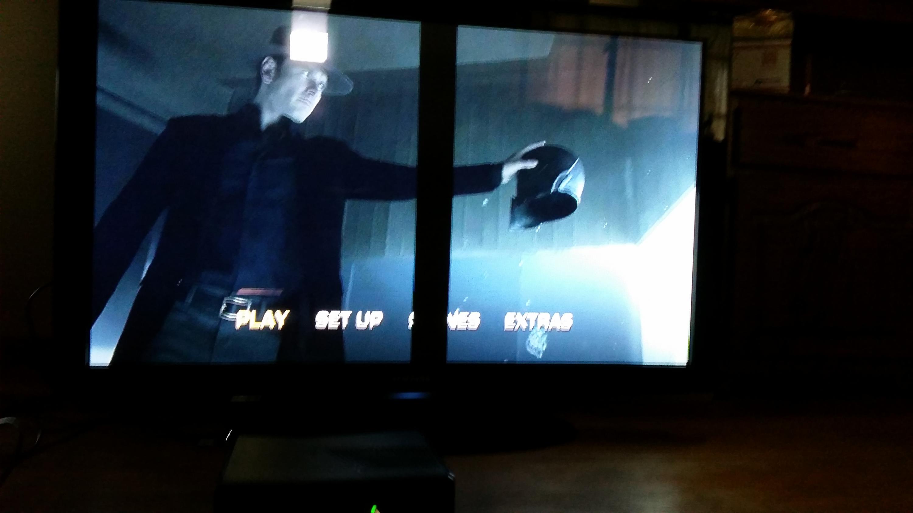

                              Hi im new. Im having a simular issue, same model plasma tv. Im fairly certain its the main center plasma board itself causing the black vertical center bar. Ive tested all inputs and its on top of all menus. Any tips on replacement? Whats the part called and how delicate a proceedure?
                                Two possibilites. Most likely is a bad plasma panel to be honest. It is common on these models. If it is not a panel issue it would probably be that center X board.
