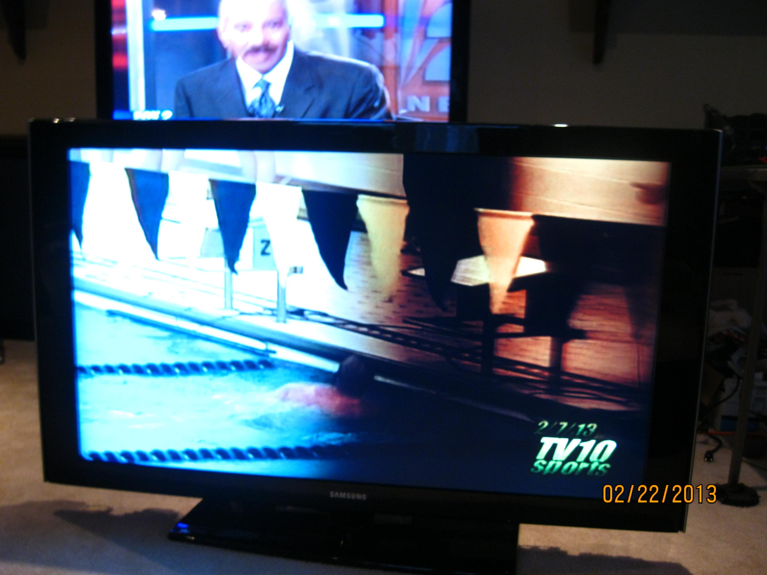

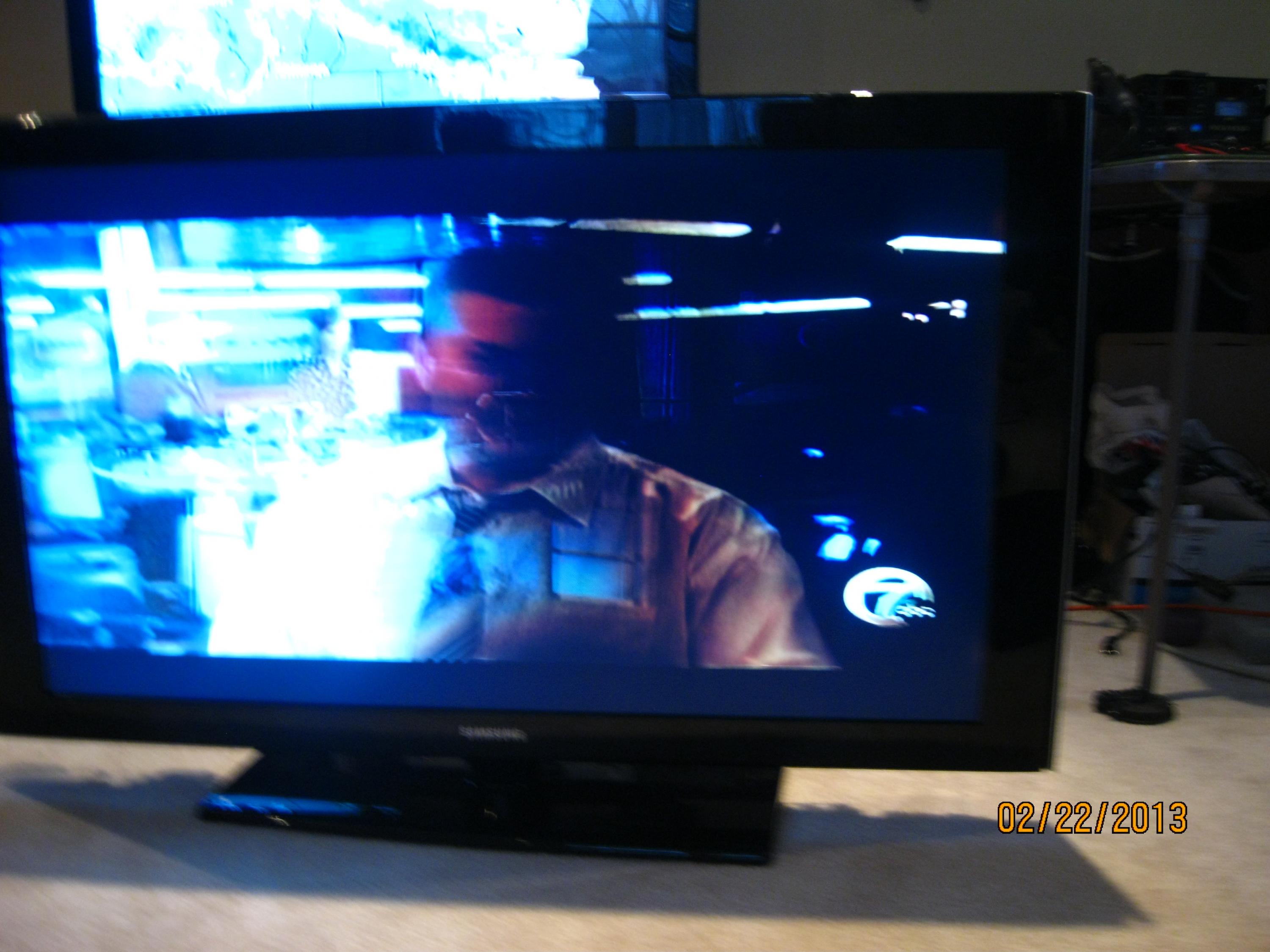

    Hi need a opinion on this set. Comes right on but left side of screen has horizontal bars halfway to middle of screen and reddish tint on right side of screen.Once its on for a few min it goes away and pic is good. Sometimes when switching channels it will come back with some ghosting on right side and then go away.I am thinking not the panel but could be wrong, seeing how its limited to the right side and comes and goes i am thinking tcon. Whats the experts on bad caps thoughts?
    Checked all caps visually no puffed ones, disconnected all cables and reconnected with no change. here are some pics of it on.Could not get horizontal bars to come back when taking pics just darkness and red tint.

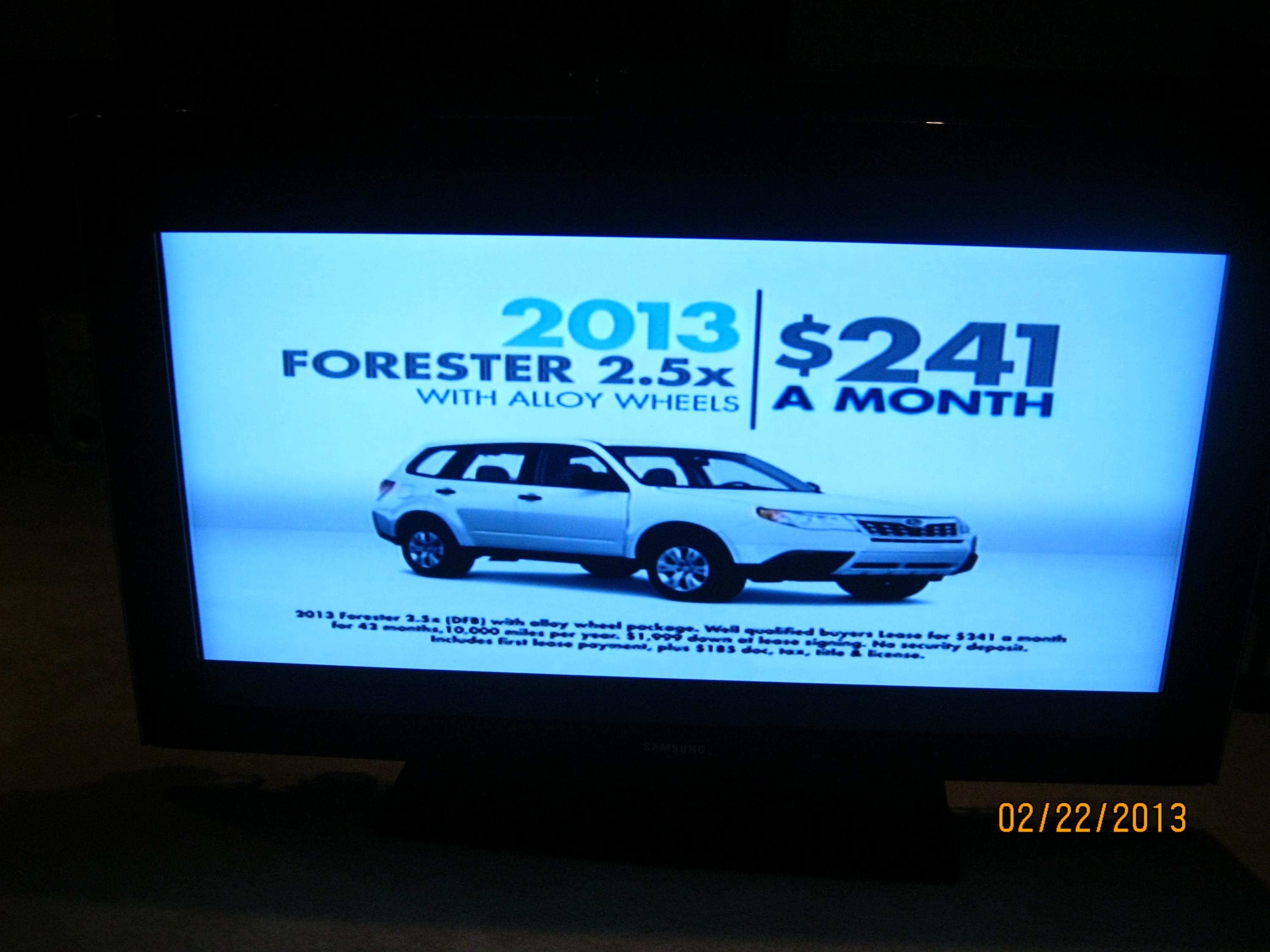

    Forgot to mention after 10 to 15 min on pic is perfect as shown in this pic

      Here is pic did not go through on last post.

        Definitely looks like bad tab bonds to me.
          Re: Samsung LN46A530P1FXZA
          Hi Tom respect your advise as usual and thanks for the reply. After your opinion on it being tab bond problem i started checking more thoroughly.When two thin horizontal lines start to appear it then gets darker on right side giving a light rap on right side of front bezel picture goes back to normal.So i turned it off and it starts over again.Another thing i noticed is that once i rap it and get the picture good re rapping on it does not make it go bad no matter how hard or where i rap it.
