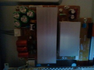

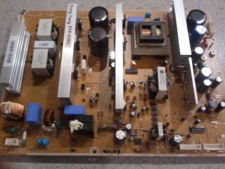

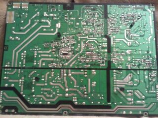

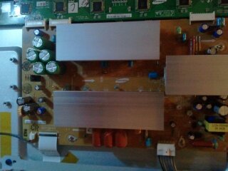

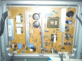

            Re: Samsung 42in Plasma shutting off
            Here's the pics, for the PSU, x and y board also. I also took a close pic of the back of the PSU board, would you consider this a cold soldier joint?
              We NEED bigger pictures to work with. I don't have these boards in front of me.
              • bjorkson
                • Apr 2012
                • 127

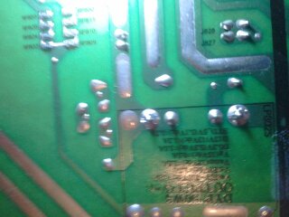

                Oh, sorry. I tried to take some, but don't have a camera, and took that on my camera phone. I took the PSU board out last night, look on th eback and I think there is a couple of solder joint I think is cold, but don't know. Can you post a pic of what a cold solder joint looks like?
                  https://www.google.co.uk/search?q=co...Aefm4QSZjID4BA
                  Mainly around the larger power transistors.
                  • bjorkson
                    • Apr 2012
                    • 127
                    Yes, I notice that also, there were some solder joints around the transistor that I saw holes on it. So, what I did was check all of them and just resolder it. Seem like the TV is up working for now. I had it on for more than 1 hr today, didn't shut off. Keeping my finger cross to see if that did it. Will report back if the problem reoccurred. Thanks for all your help.
