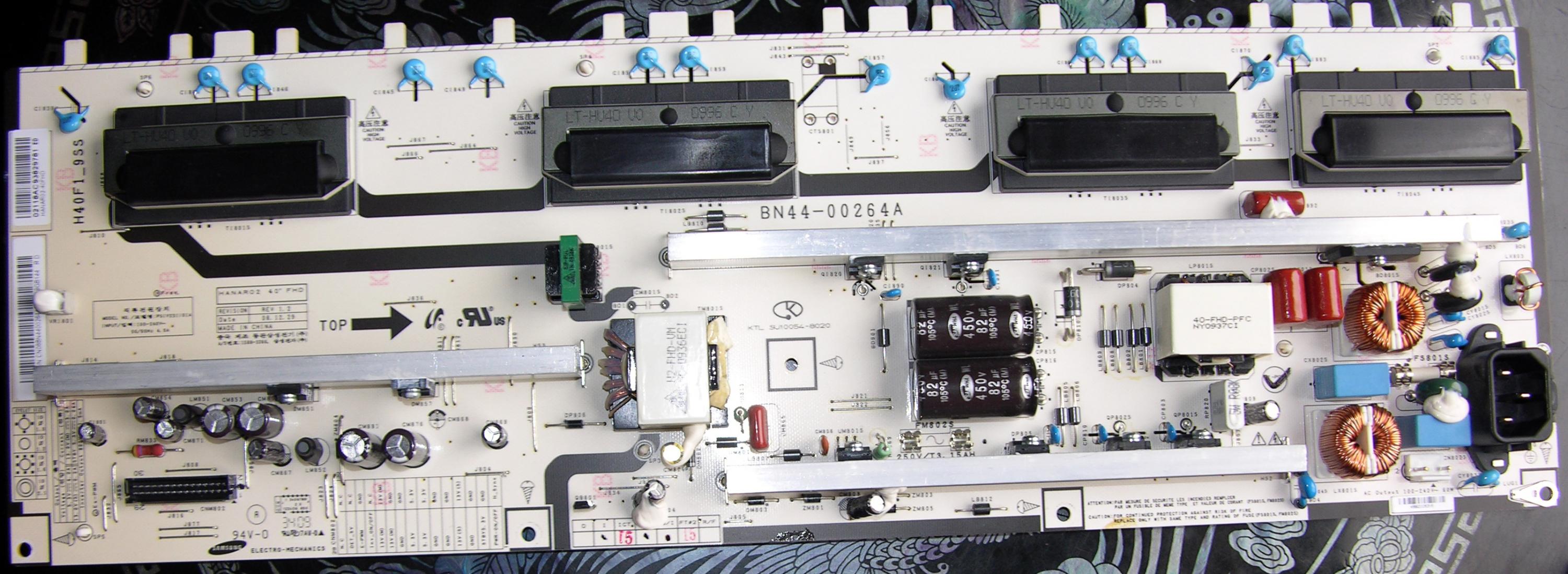

    Turned the TV on one morning and it immediately turned off, no red light or anything.
    Took the back off and replaced the blown fuse hoping it was just a power surge or something, although its on a surge protector.
    Blew the fuse immediately, again.
    No obvious blown caps.
    I checked the bridge rectifier and it seems good. [ .468 to .481 ]
    Not sure but I think I have to pull the mosfets out of circuit to test?
    Thanks for any advice

    Your prime suspects are shorted bridge rectifier, mosets and/or diodes.
    I test everything in circuit first and if I get any suspicious readings, then I desolder and verify out of circuit.

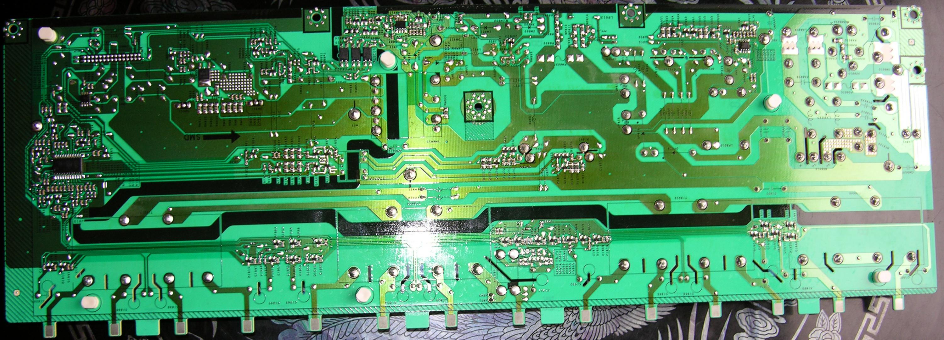

      Can we get a picture of the bottom of the board?
