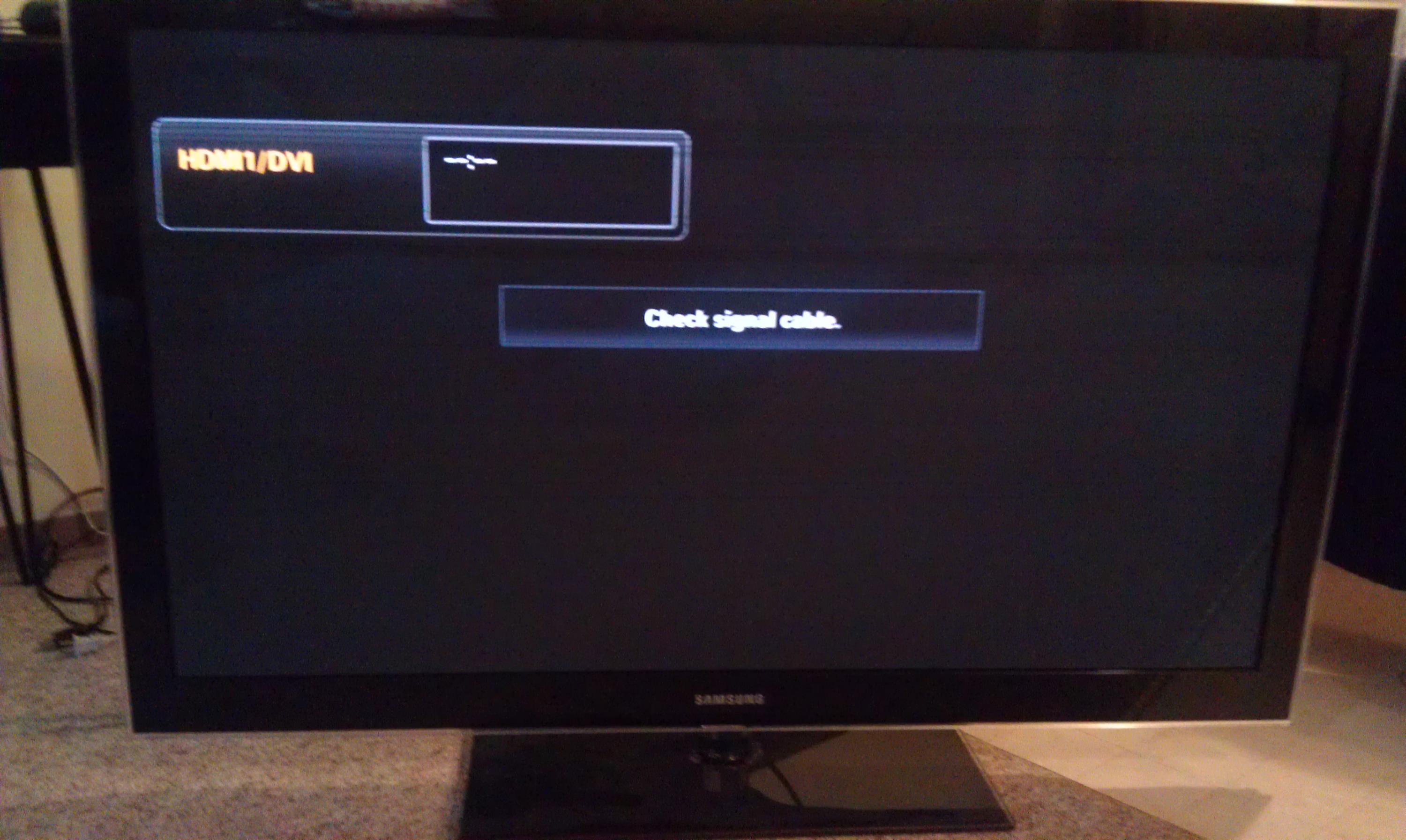

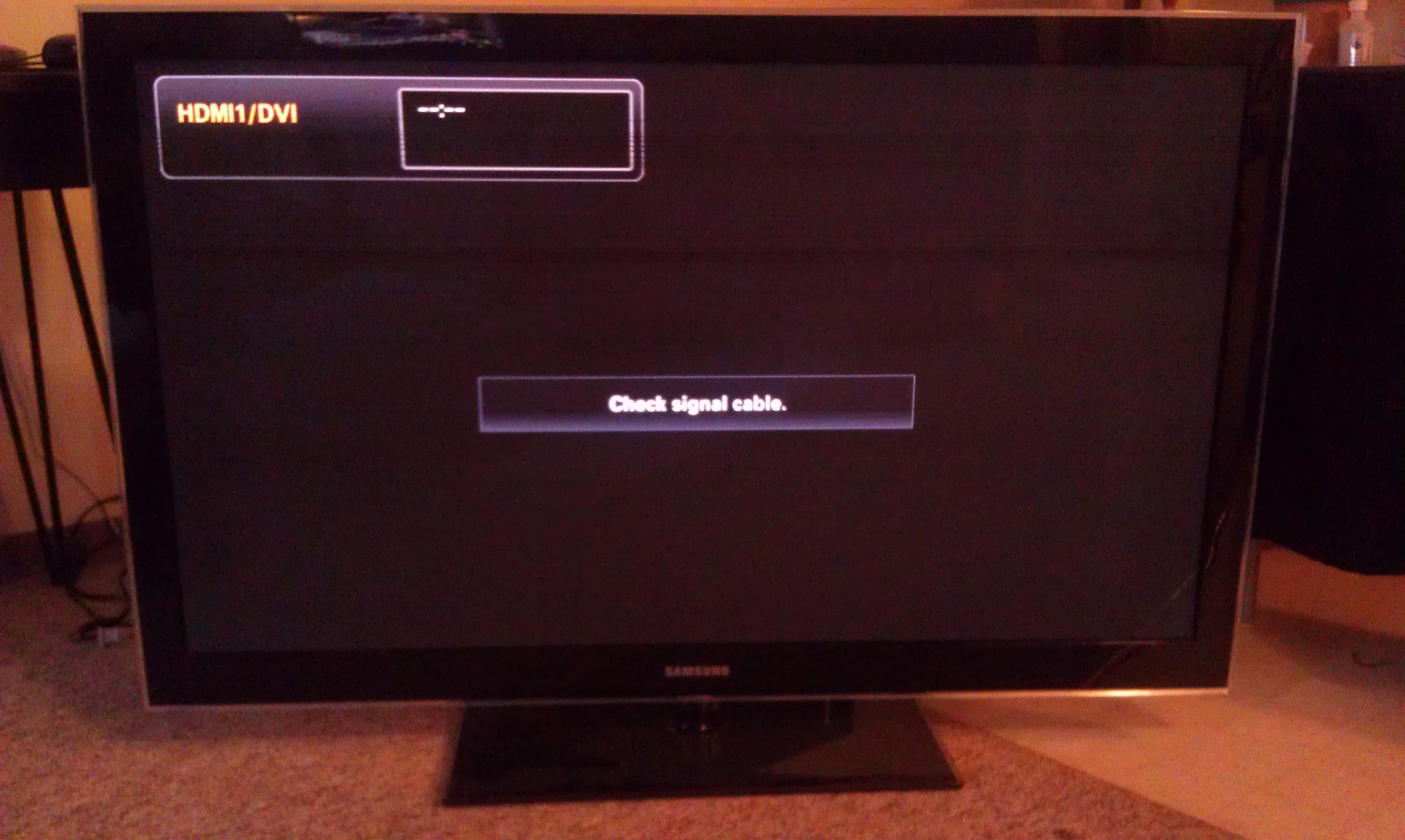

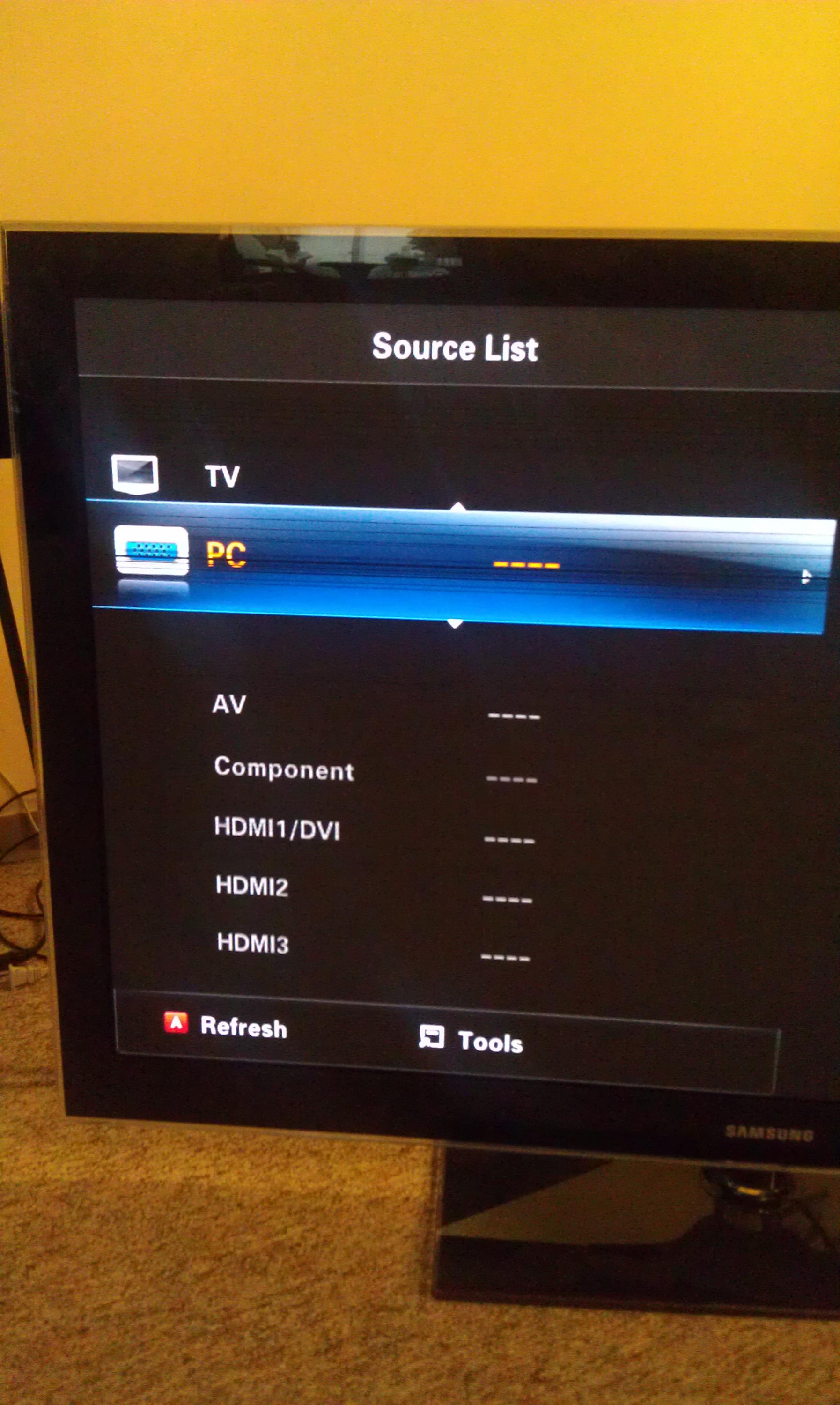

    Samsung PN50C6800TF

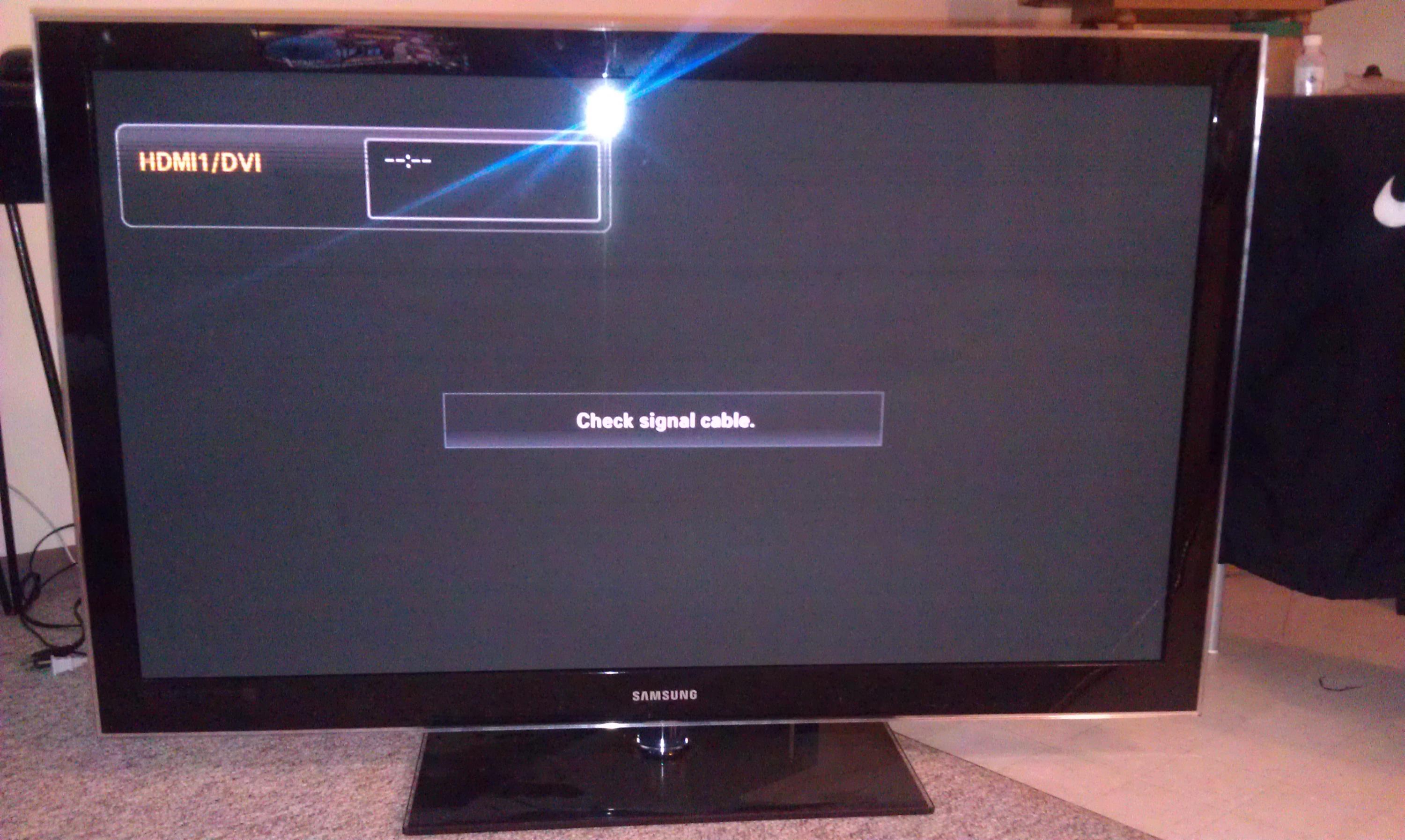

    not going to be working on it today ill upload more pictures when i start.
    issue with this set is black lines going horizontal thrue the screen.
    if anyone has any experience with this i would appreciate your input thank you.

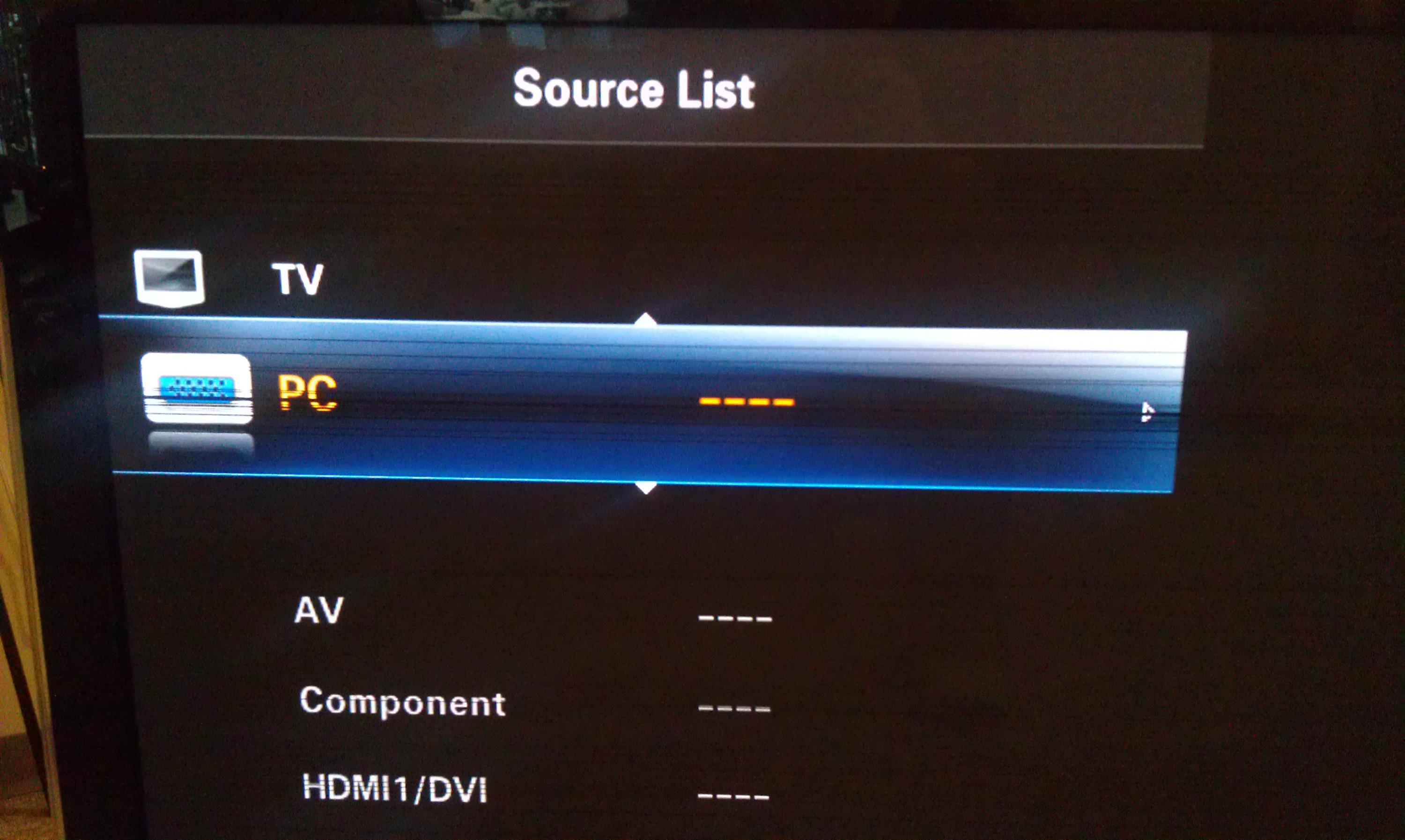

    Re: Samsung PN50C6800TF

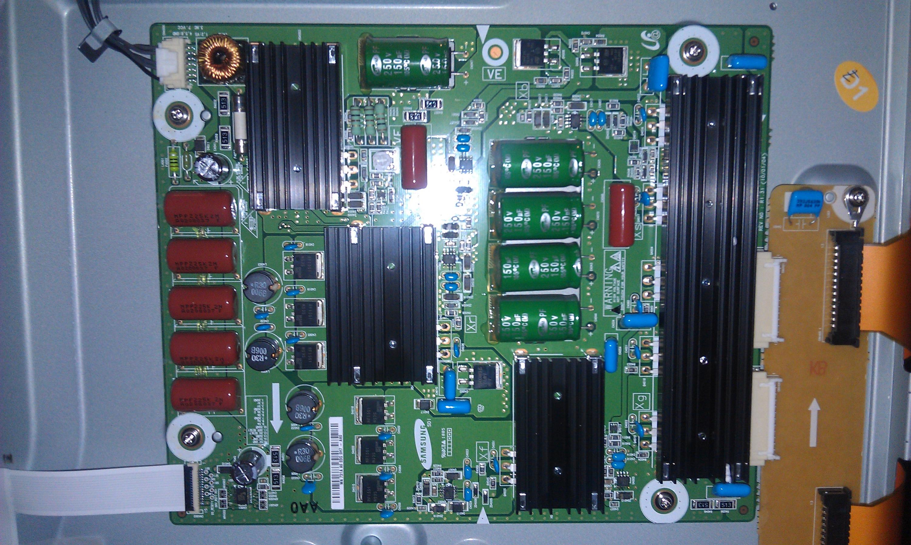

    here are some more pictures.
      Re-seat Y buffer cables. If that fails, replace the Y buffer.

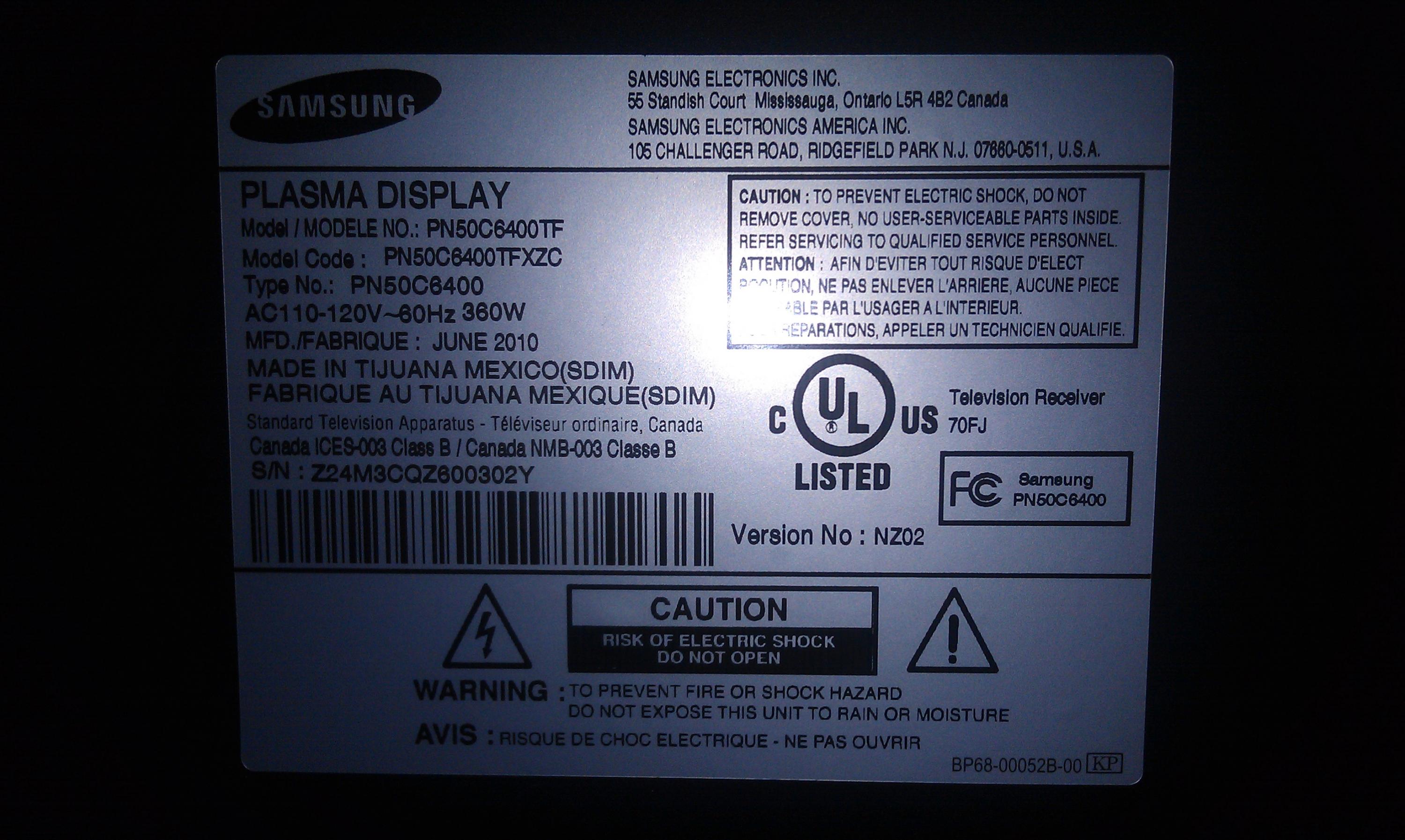

        also i messed up the model number its 6400 not 6800.

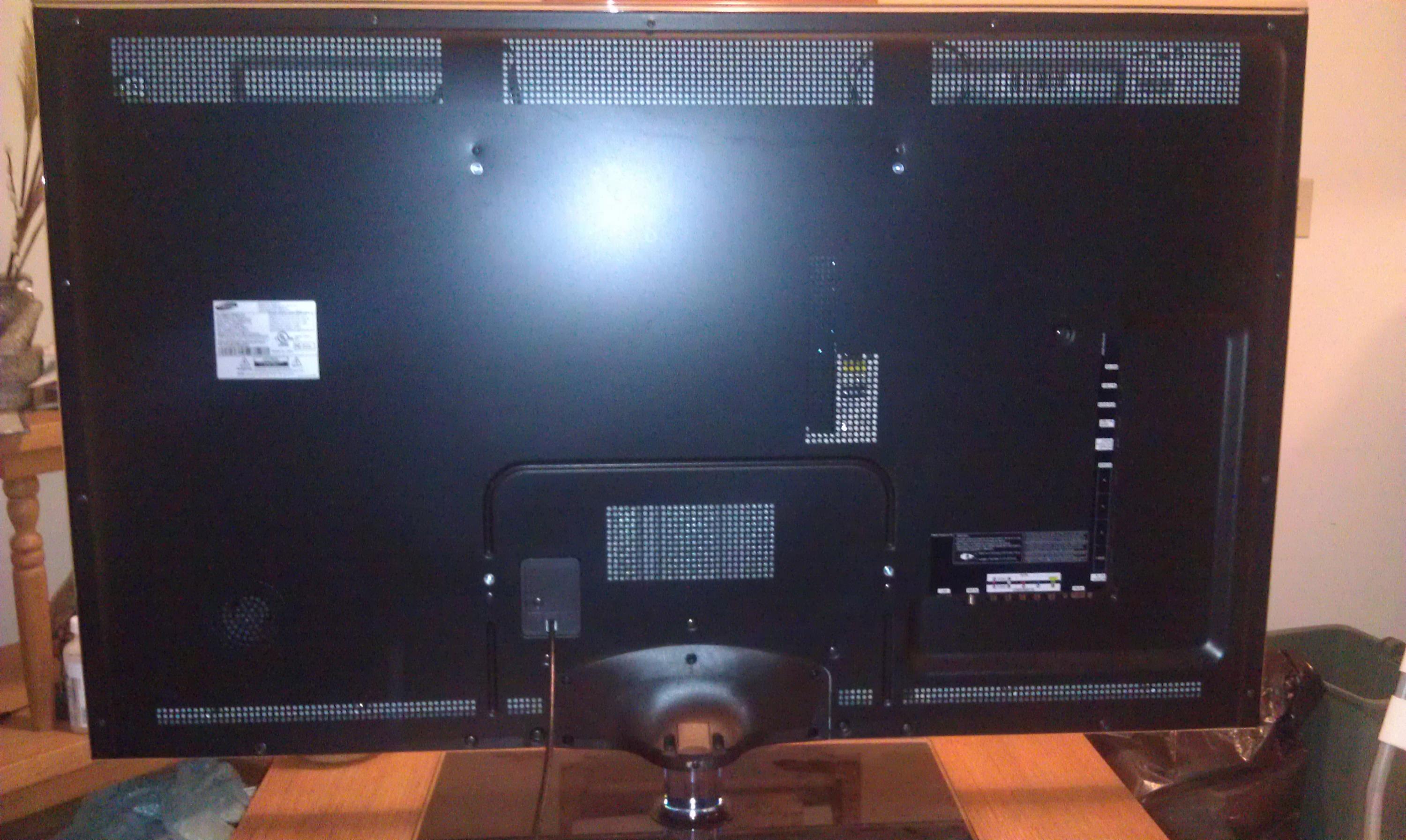

            • Phaihn
              • Jan 2009
              • 842

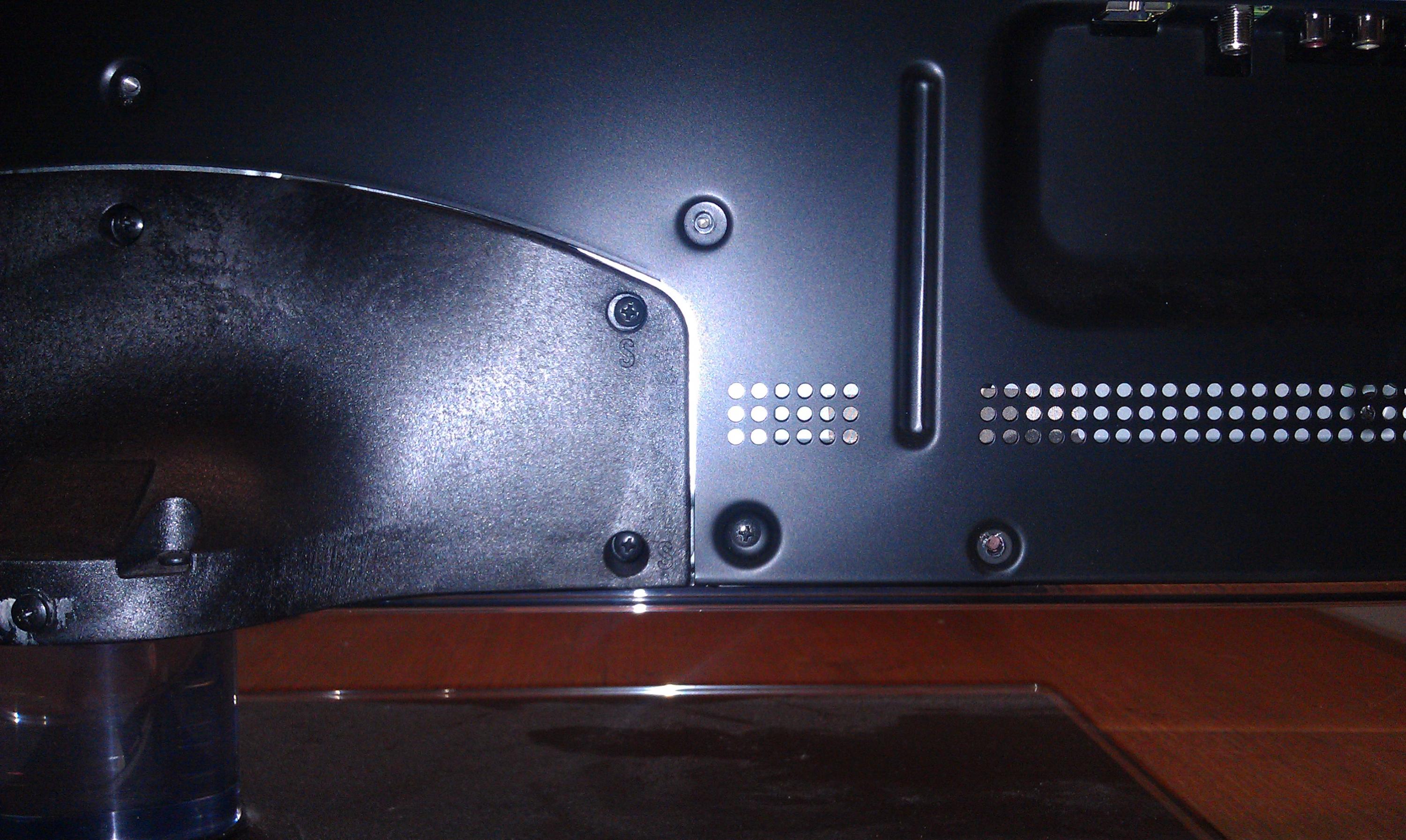

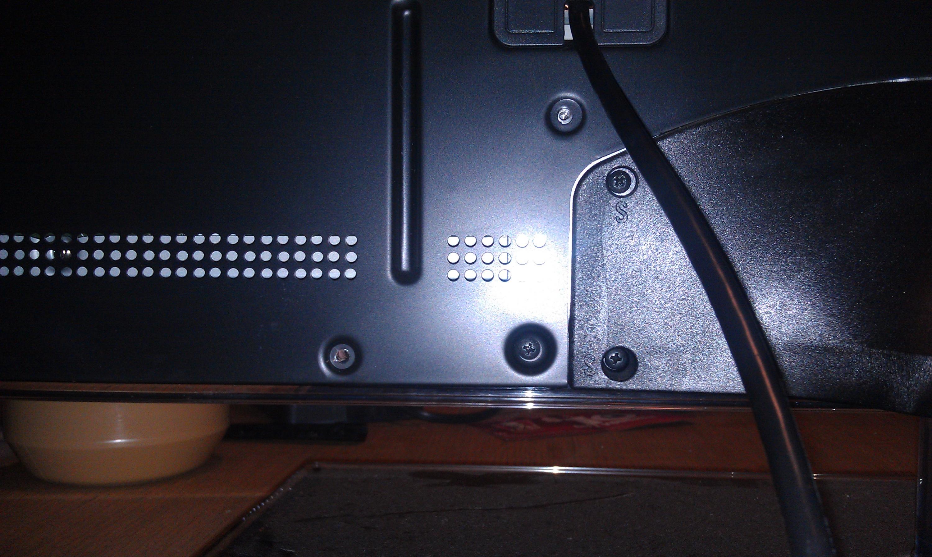

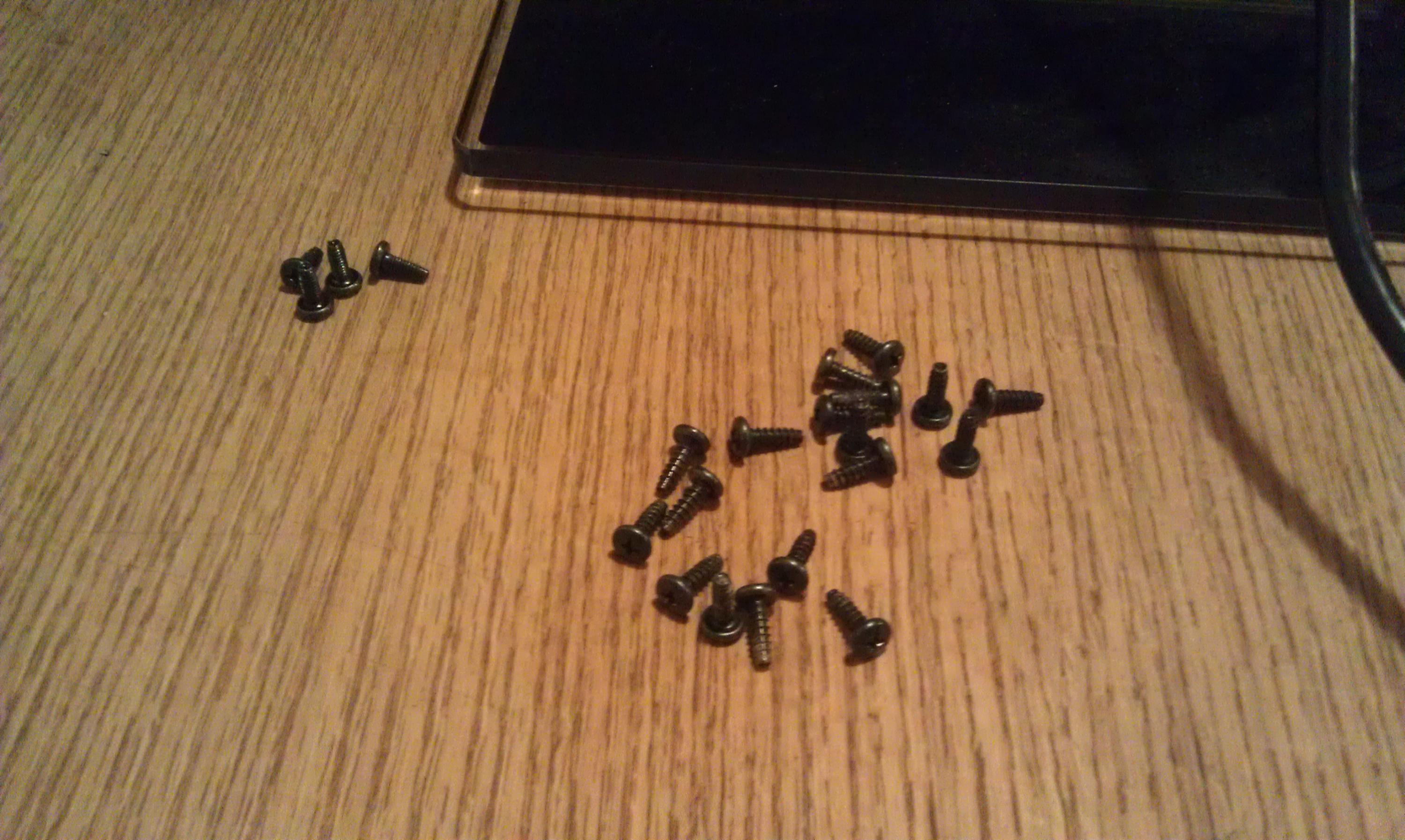

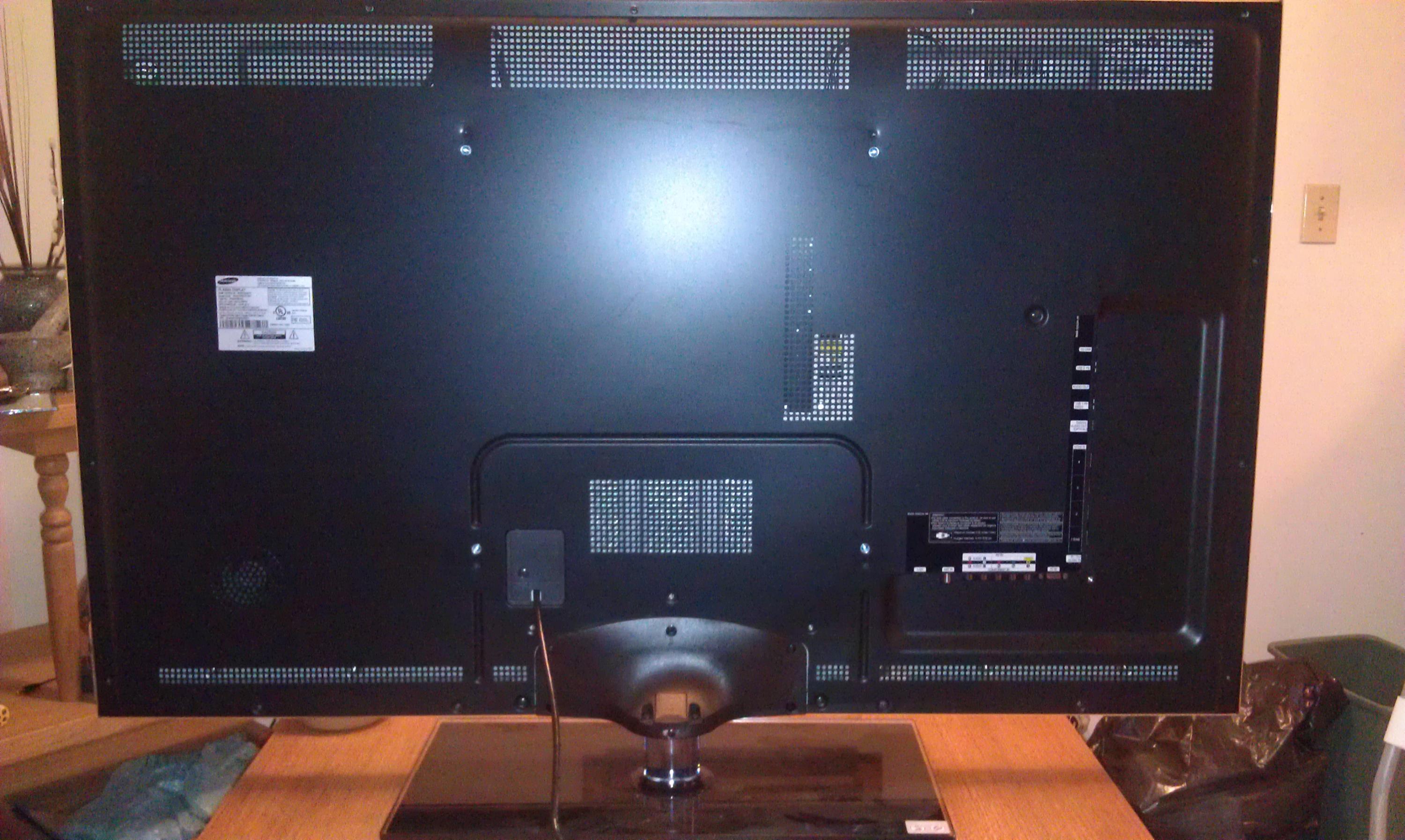

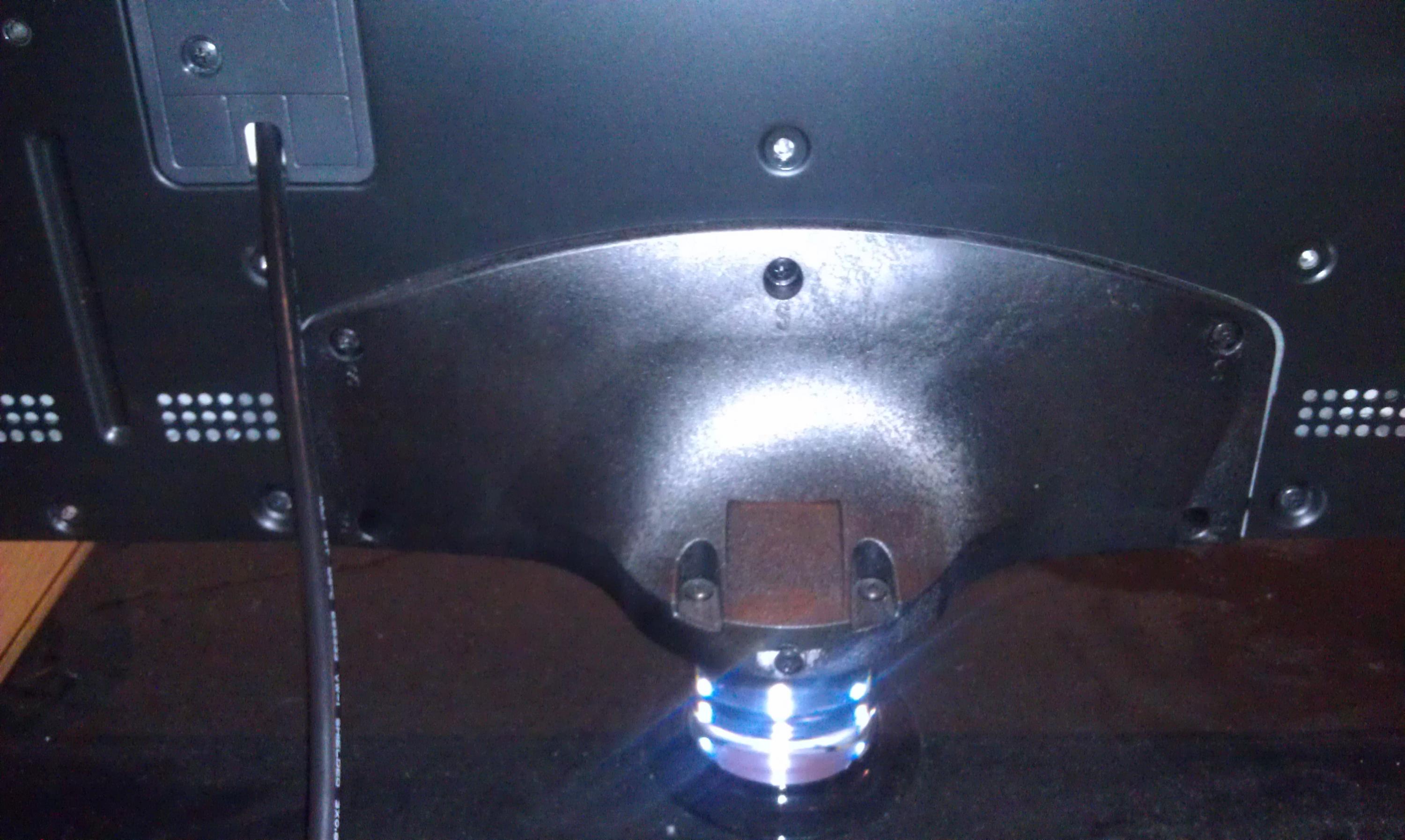

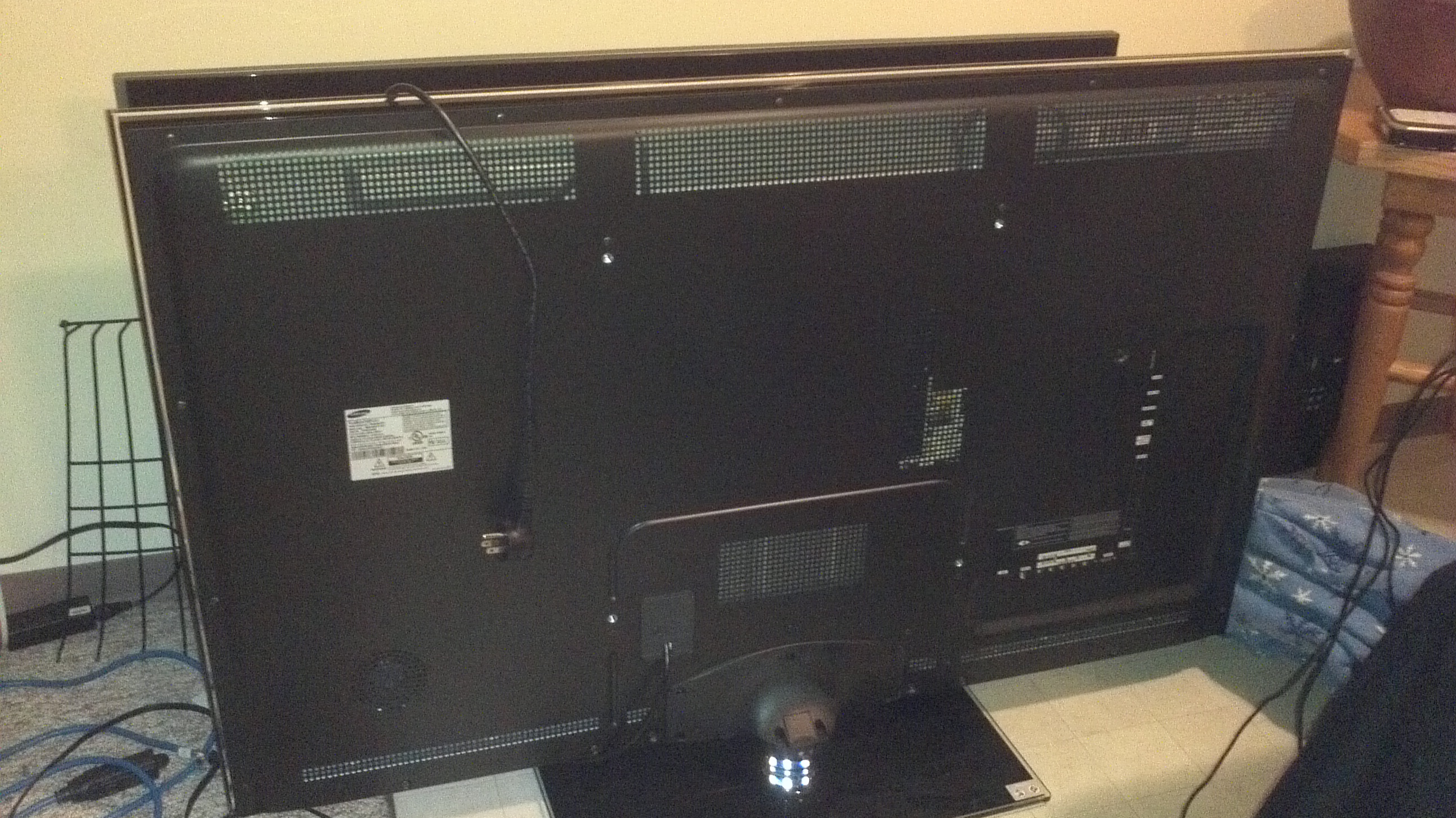

              2 screws on the bottom are turning but wont come out for me...
                Make sure you lie it down on a soft surface (duvet, bet, pillows, cushion...) when working on it.
                • Phaihn
                  • Jan 2009
                  • 842
                  got them out.

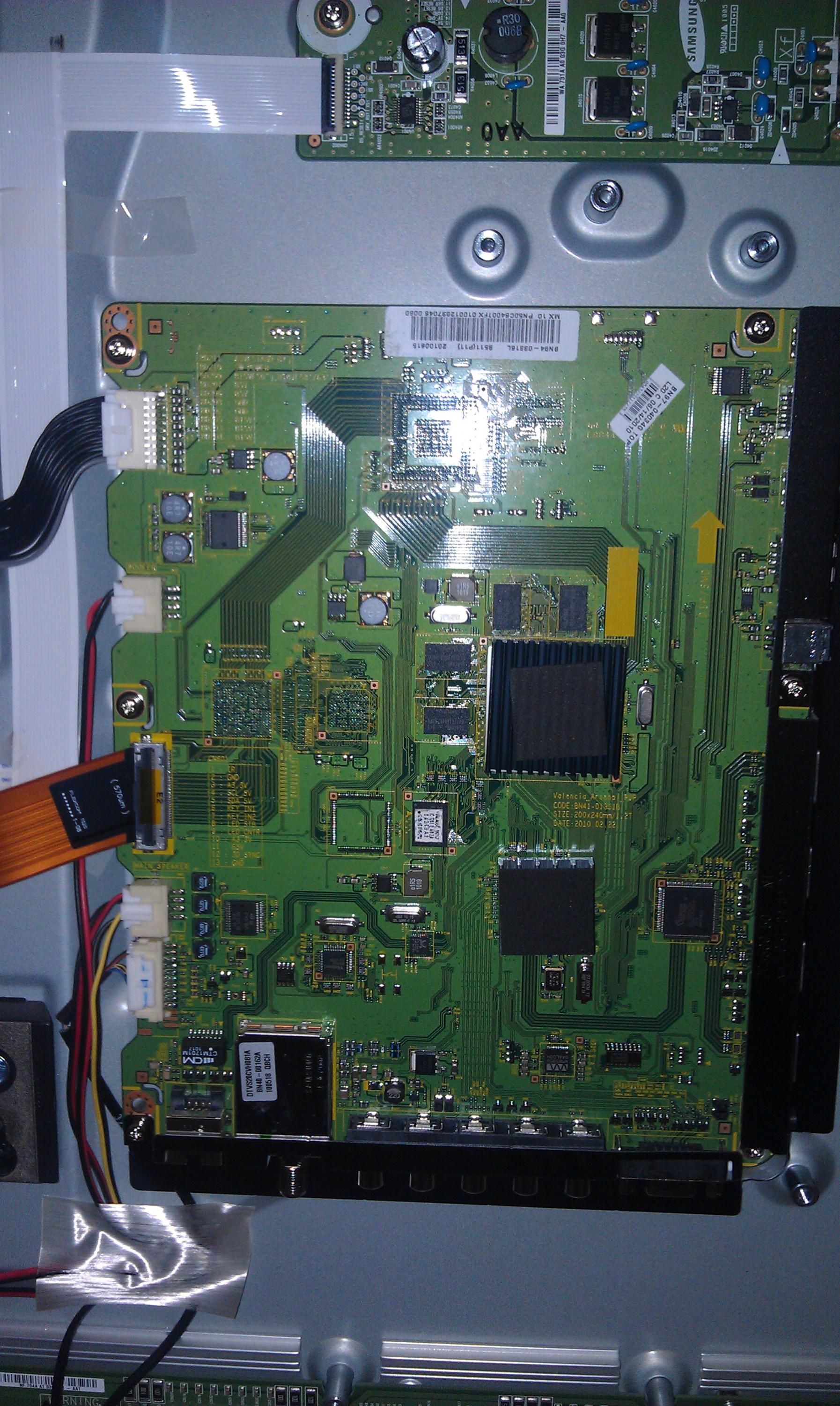

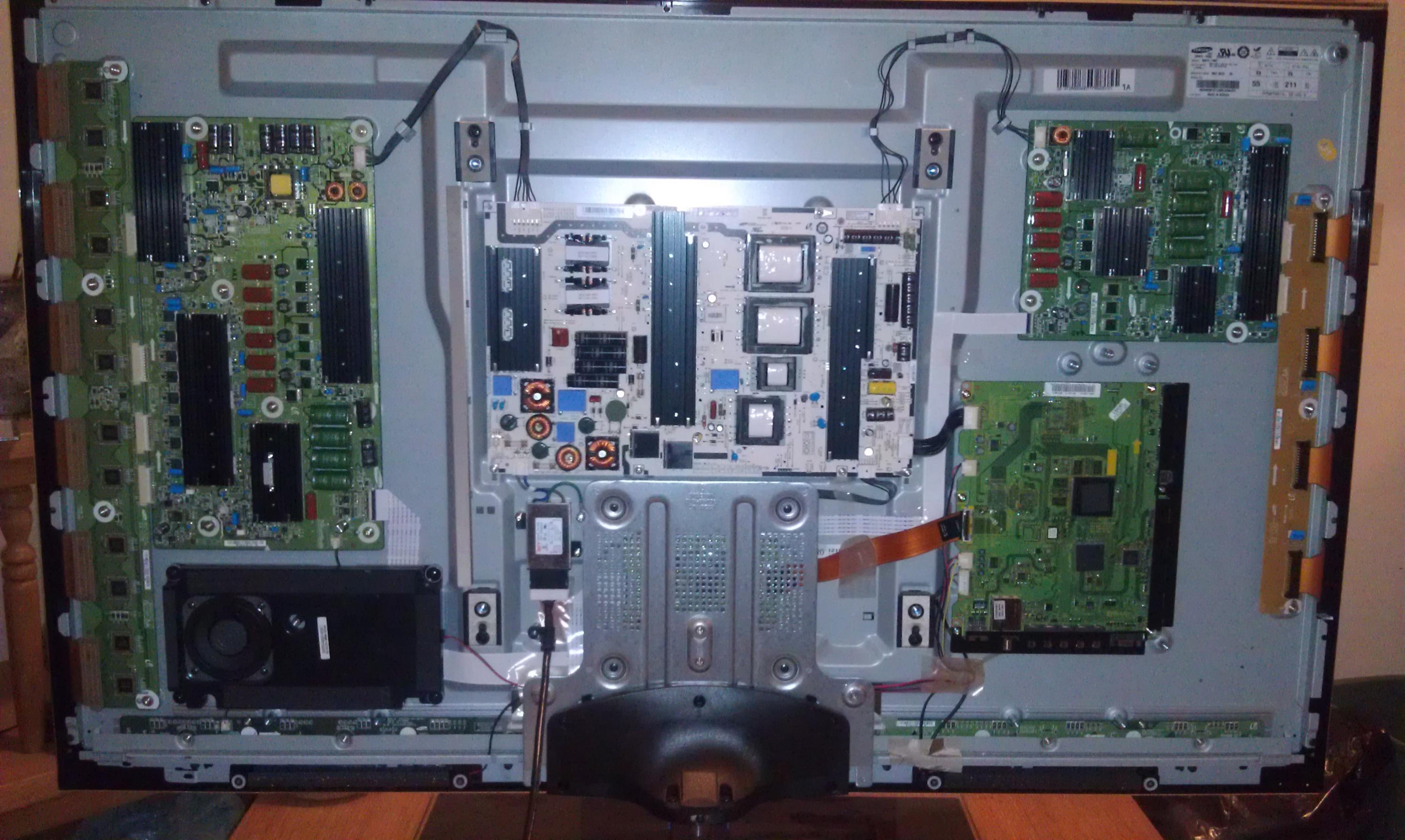

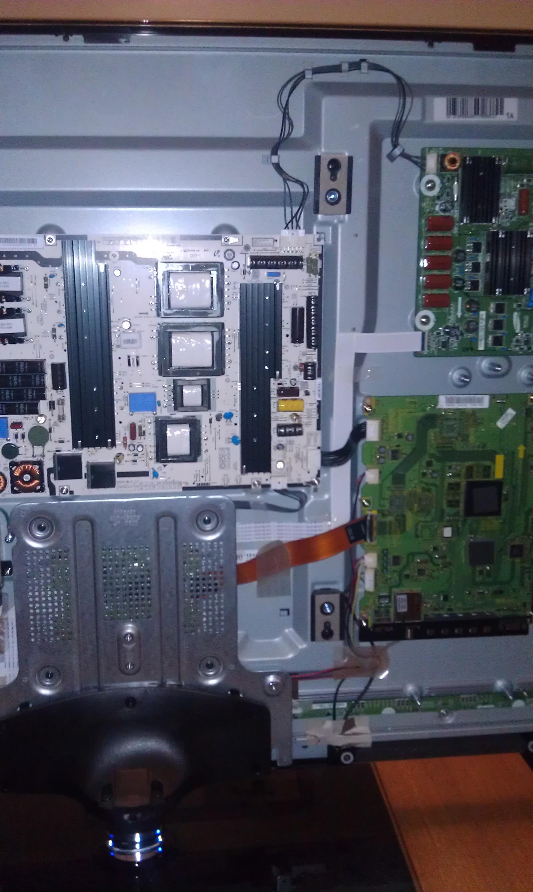

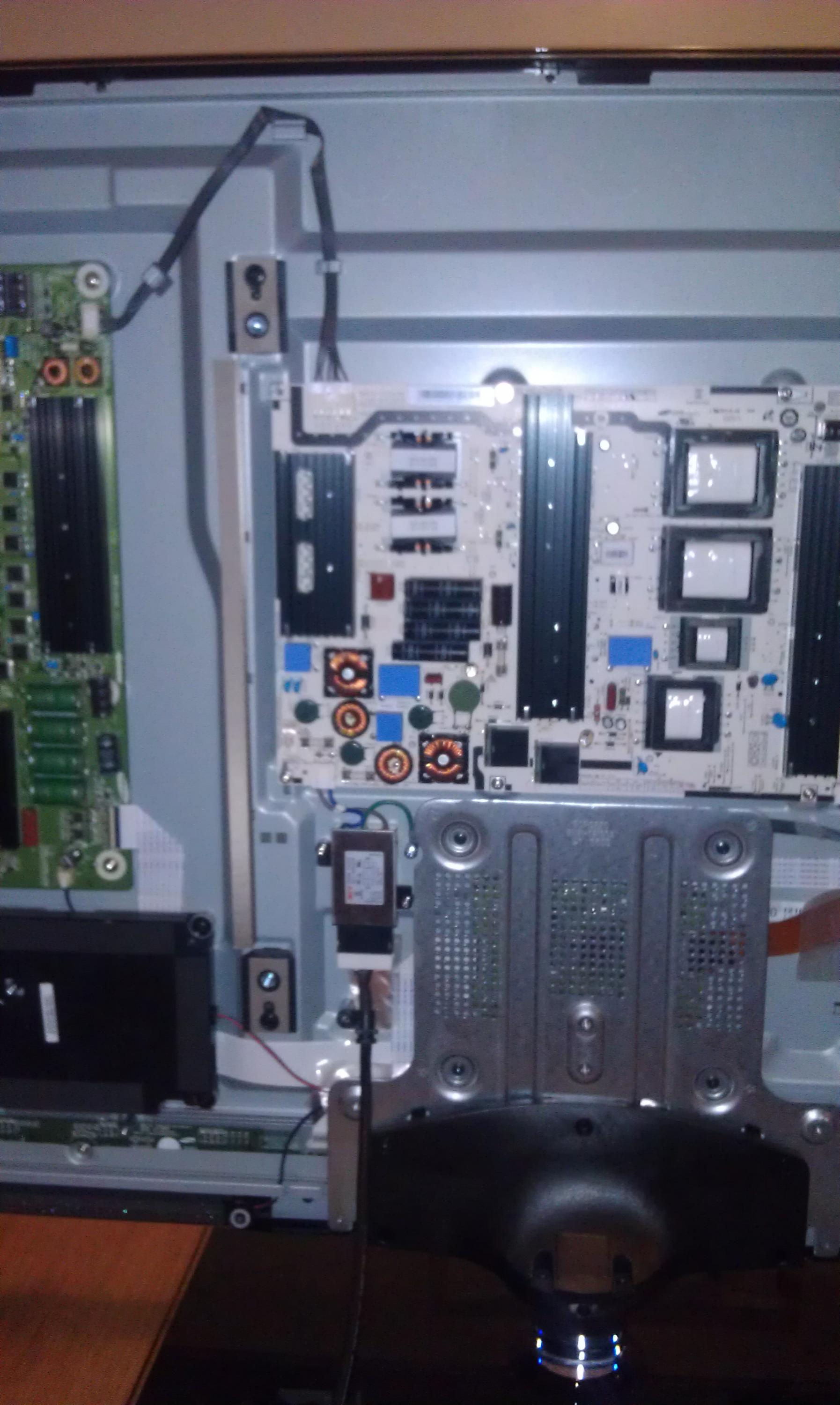

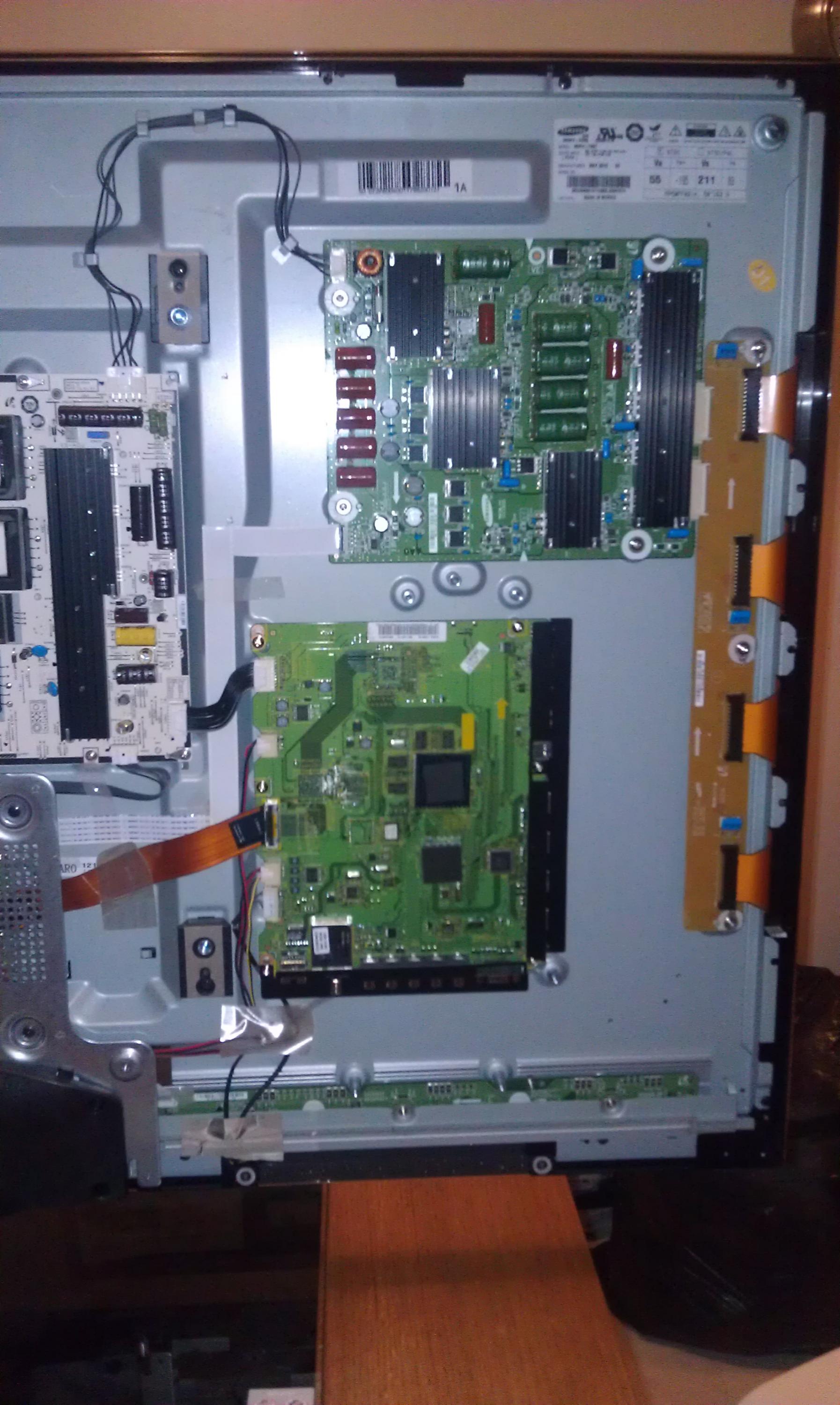

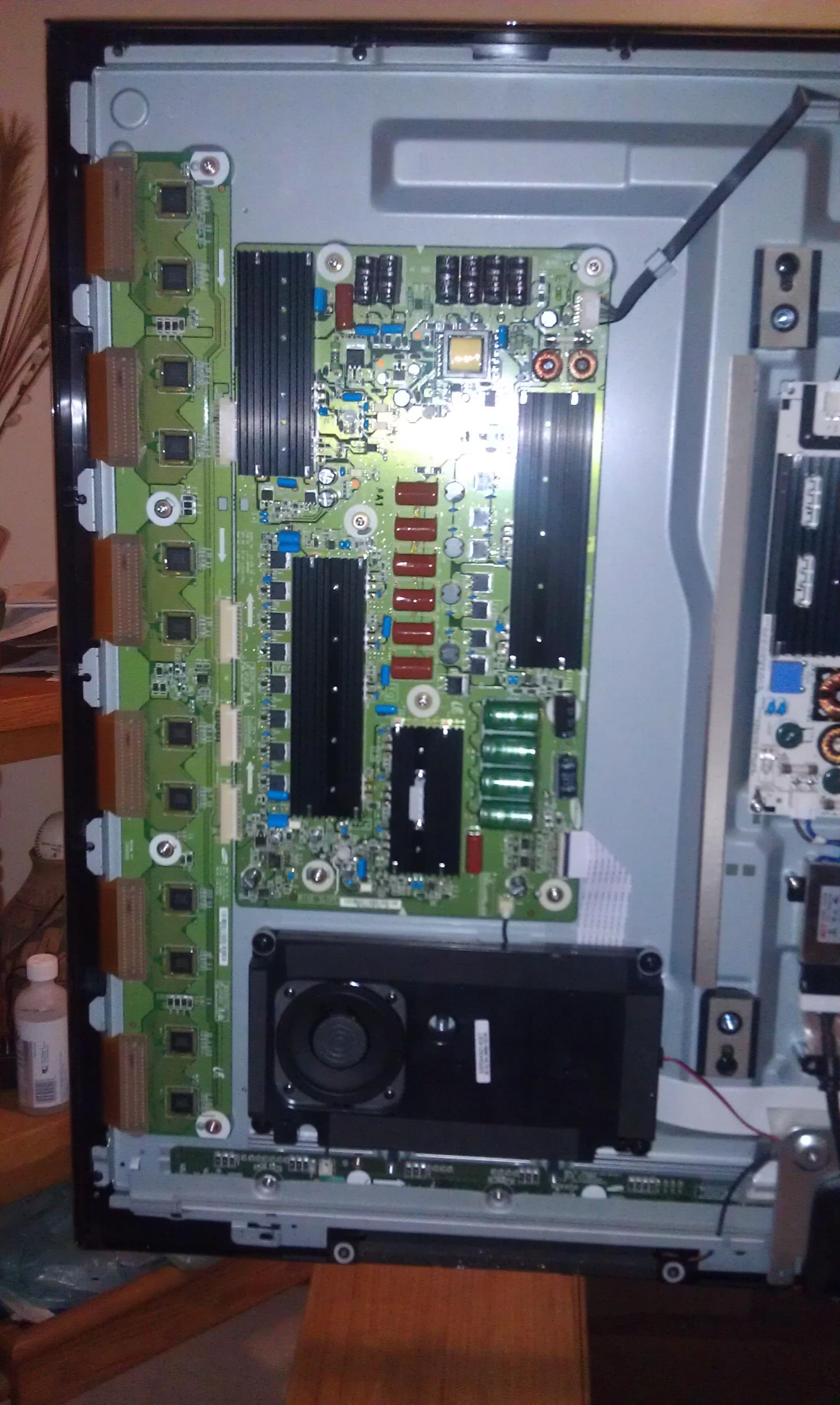

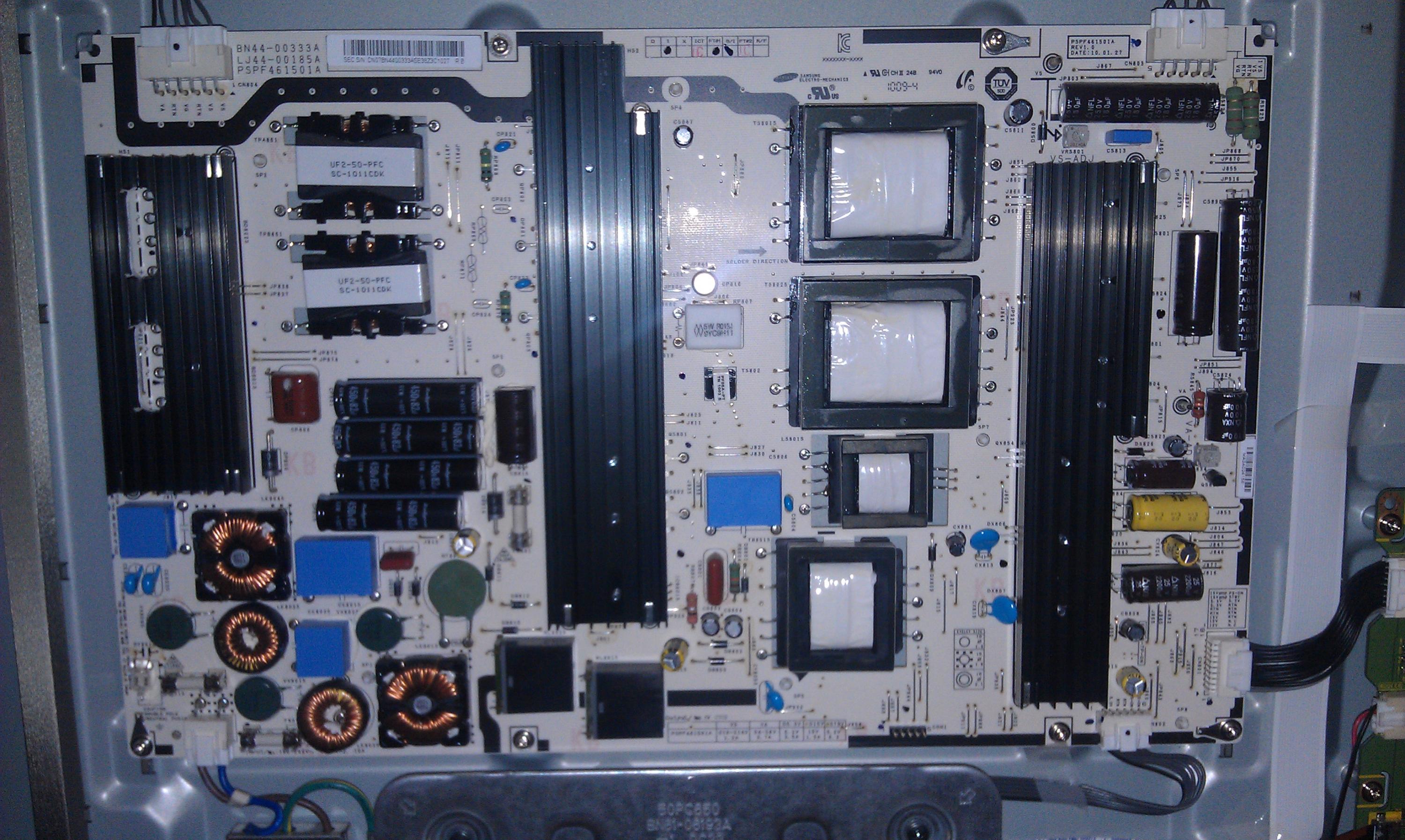

                    ok got it open.

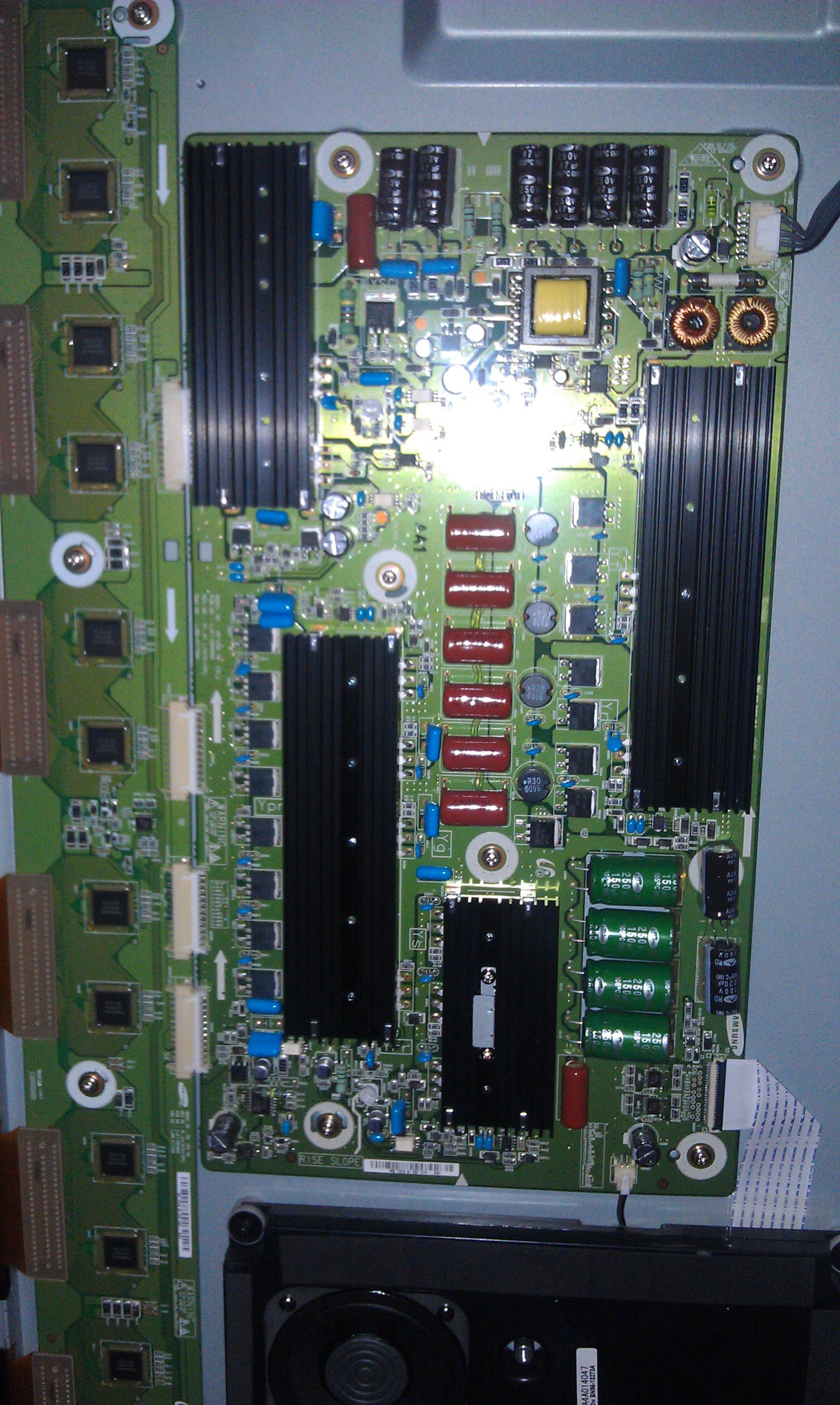

                    • Phaihn
                      • Jan 2009
                      • 842
                      ok i did that if the Y Buffer is the one on the Left.
                      made no difference so then i need to replace it then?
                      edit just relized what the Y buffer was tried reseating the connectors no improvement.

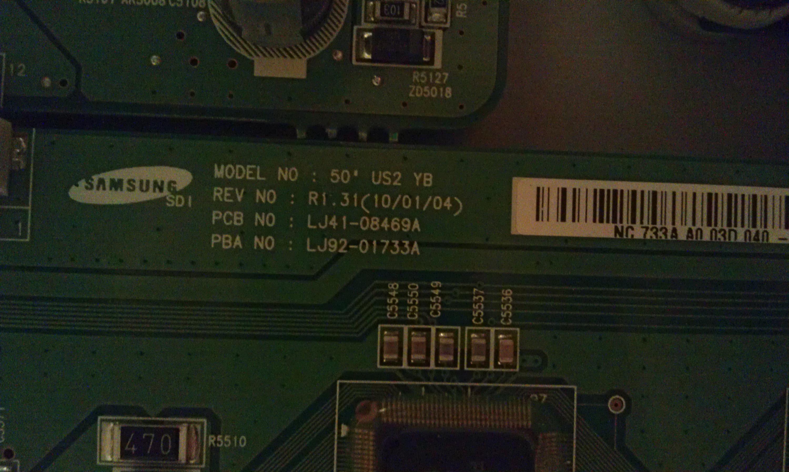

                        Looks like i found what i need but does anyone know whare else i could get one besides ebay?

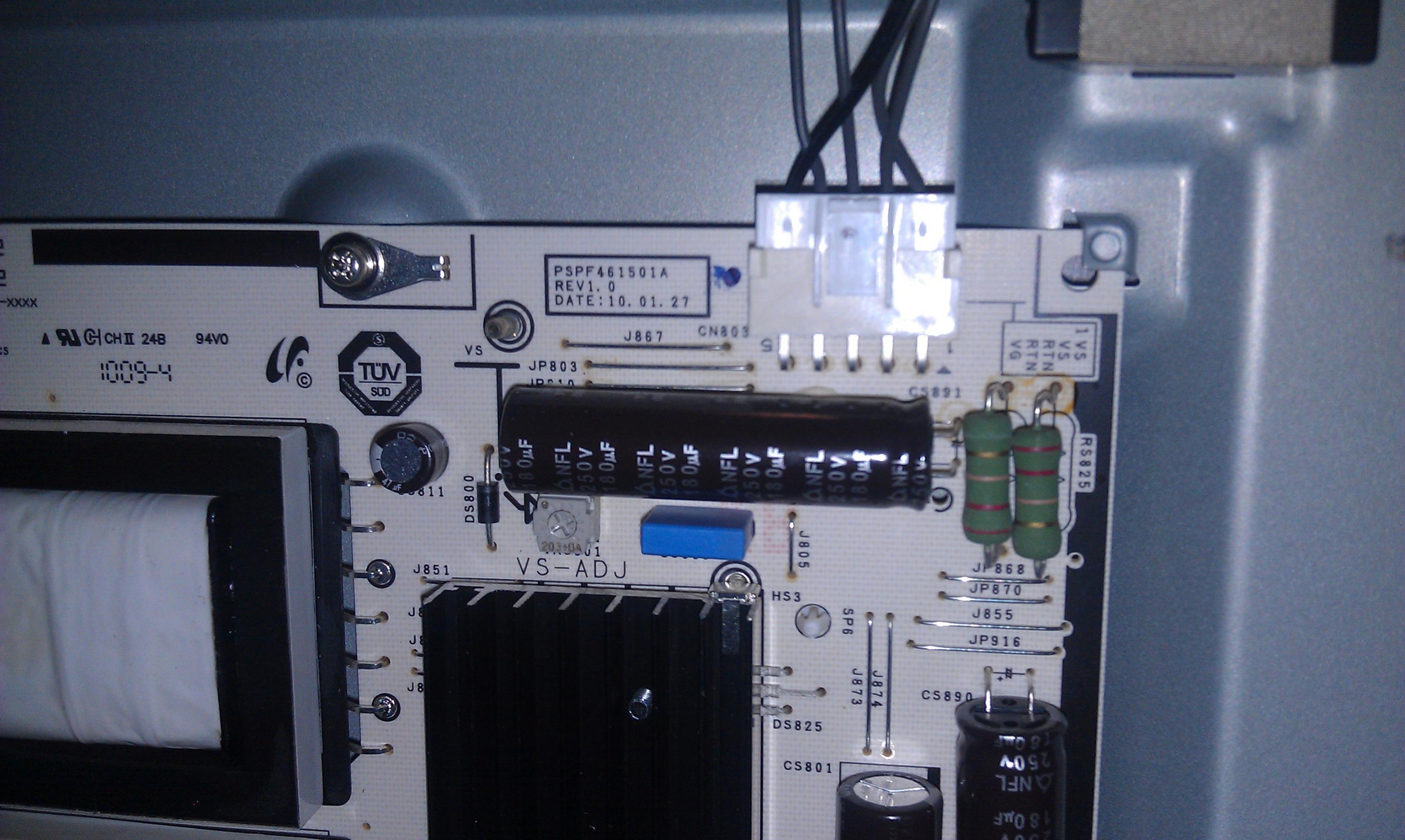

                        • Phaihn
                          • Jan 2009
                          • 842

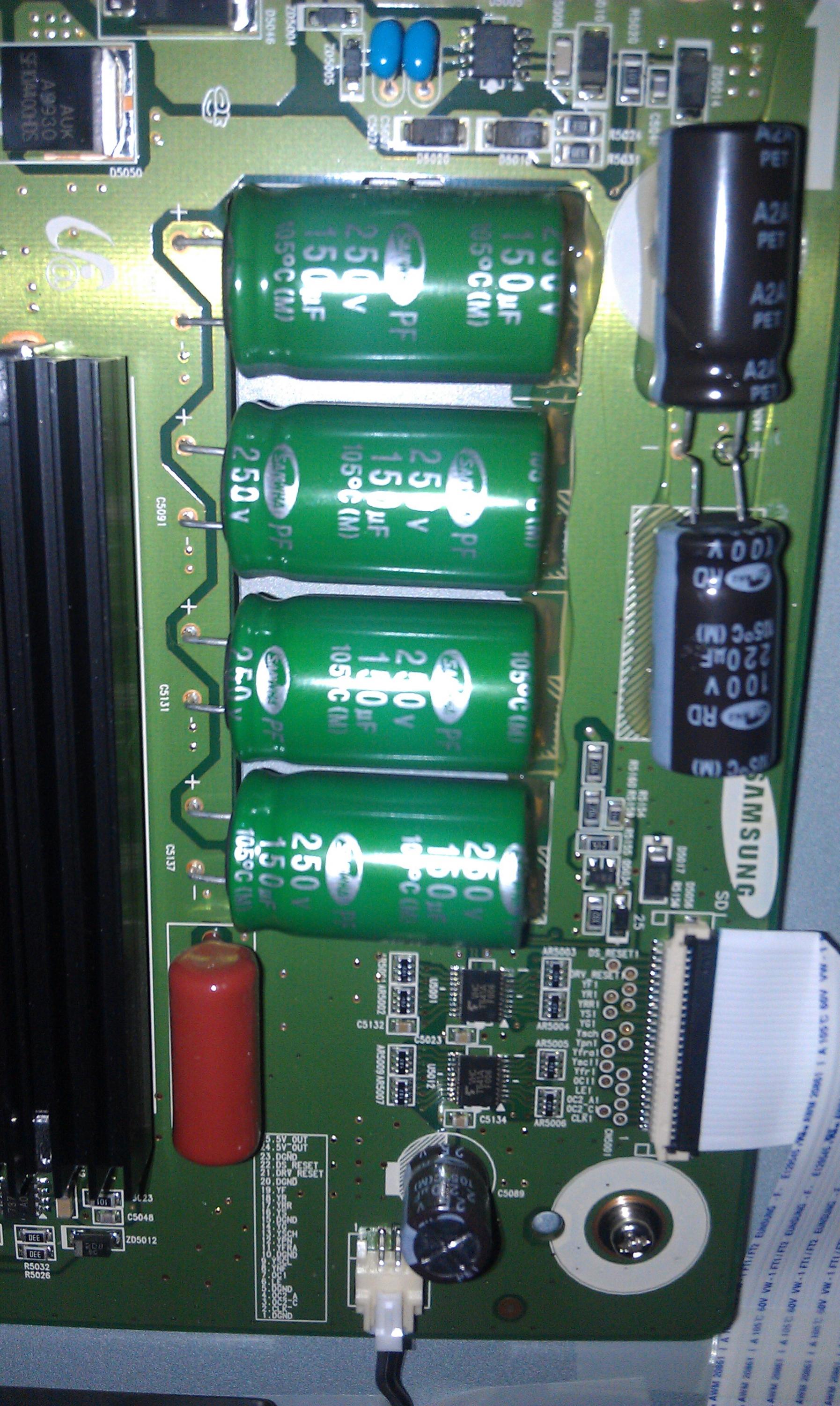

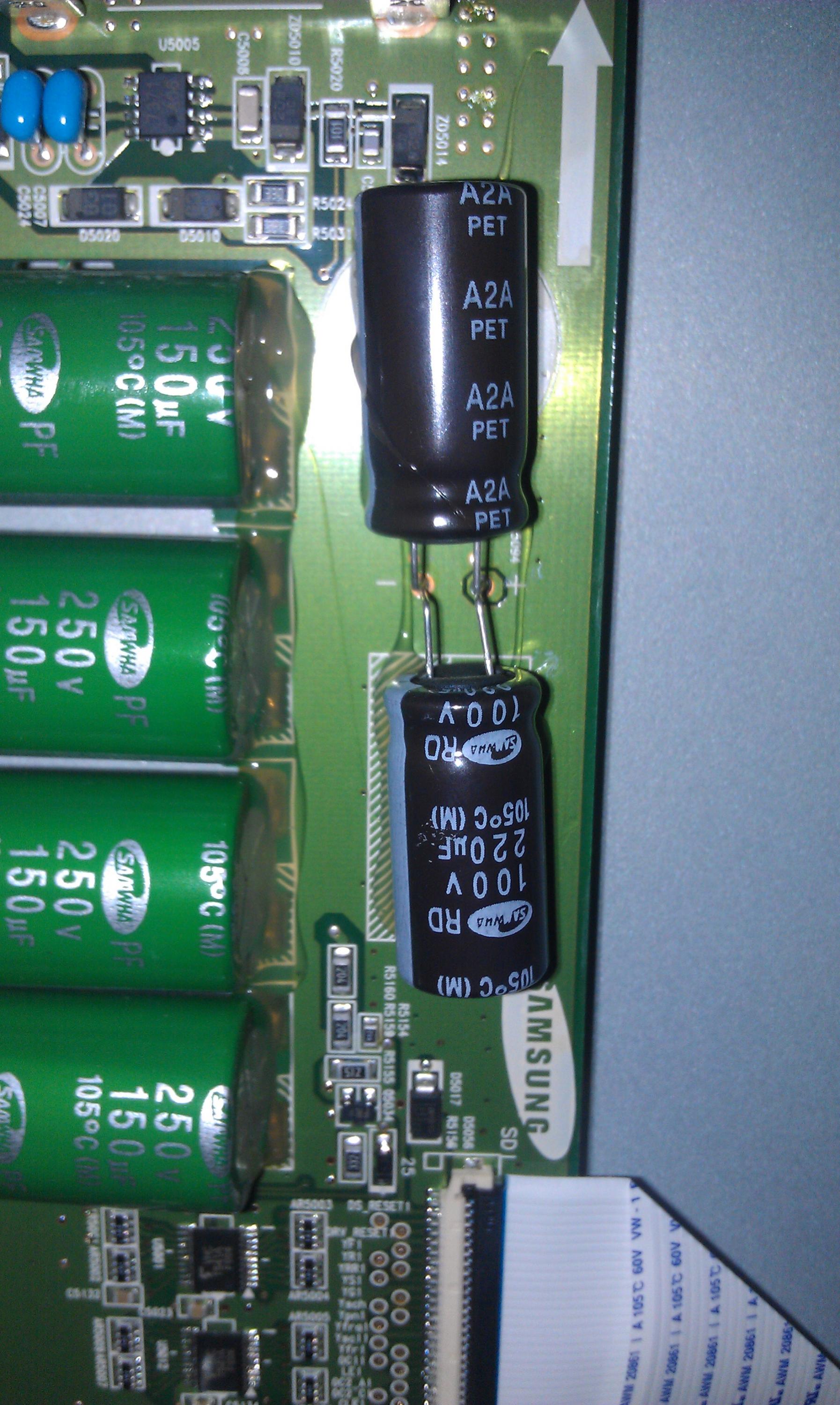

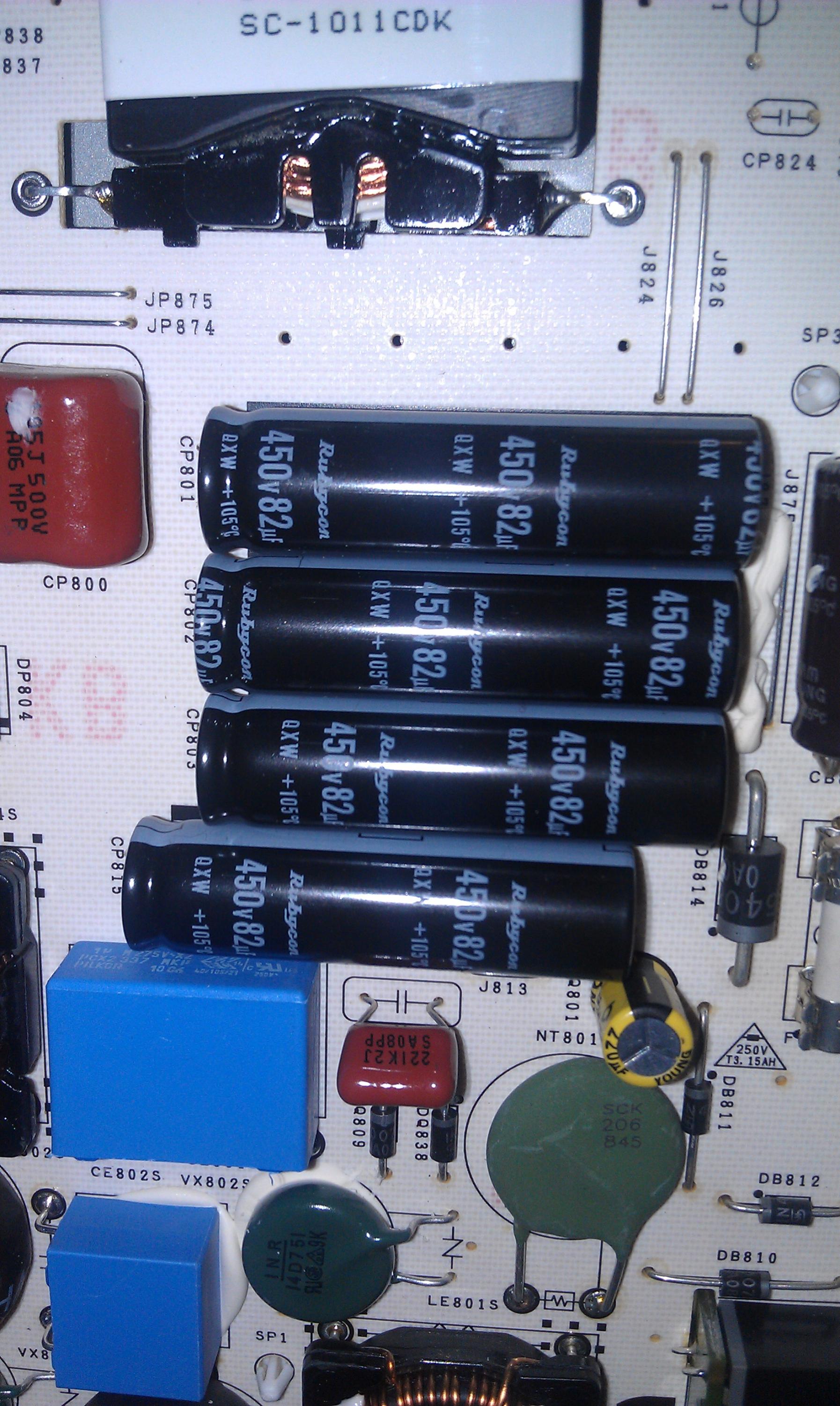

                          anyone know whos idea it was to solder 2 caps in the same connection can anyone tell what the point of that is?

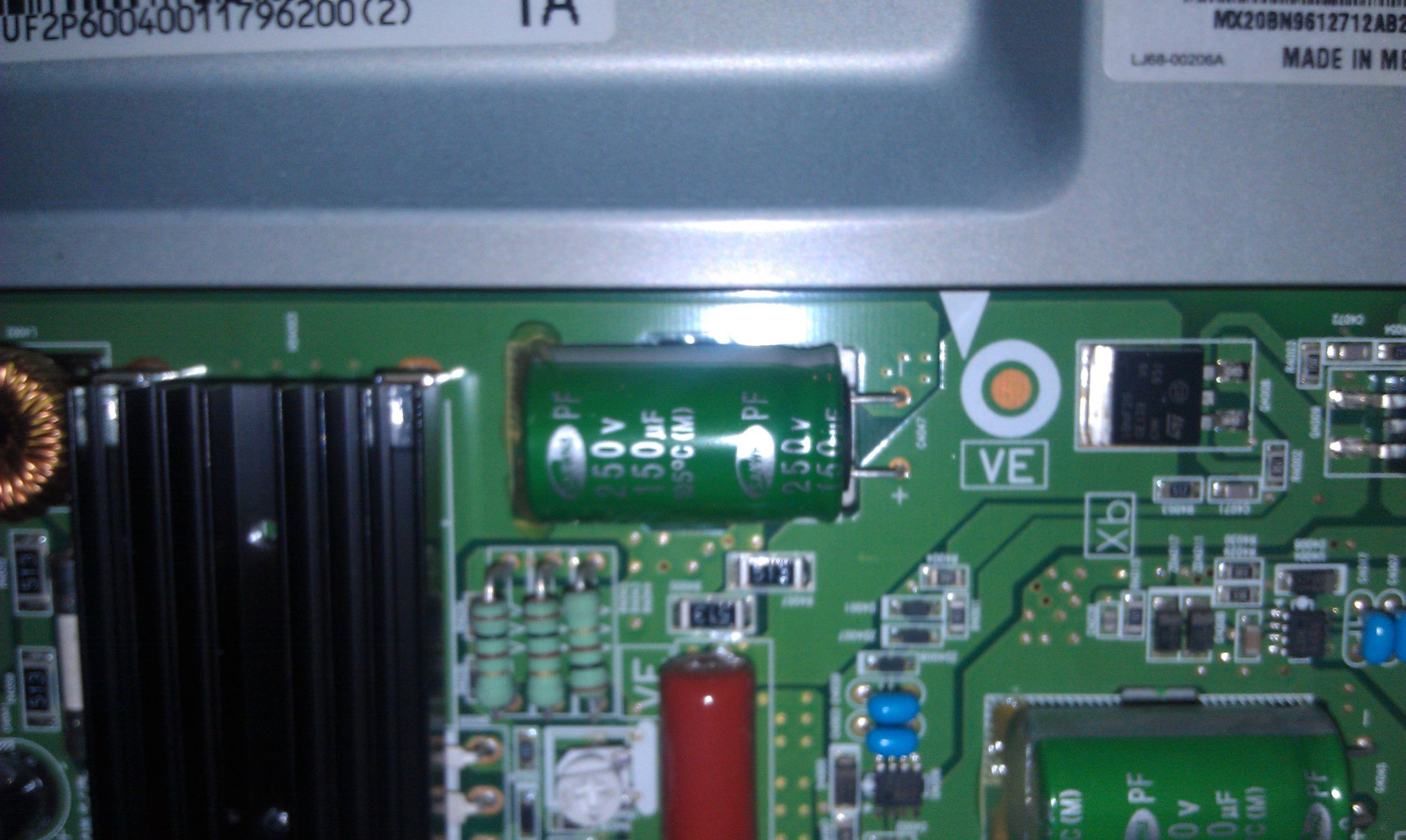

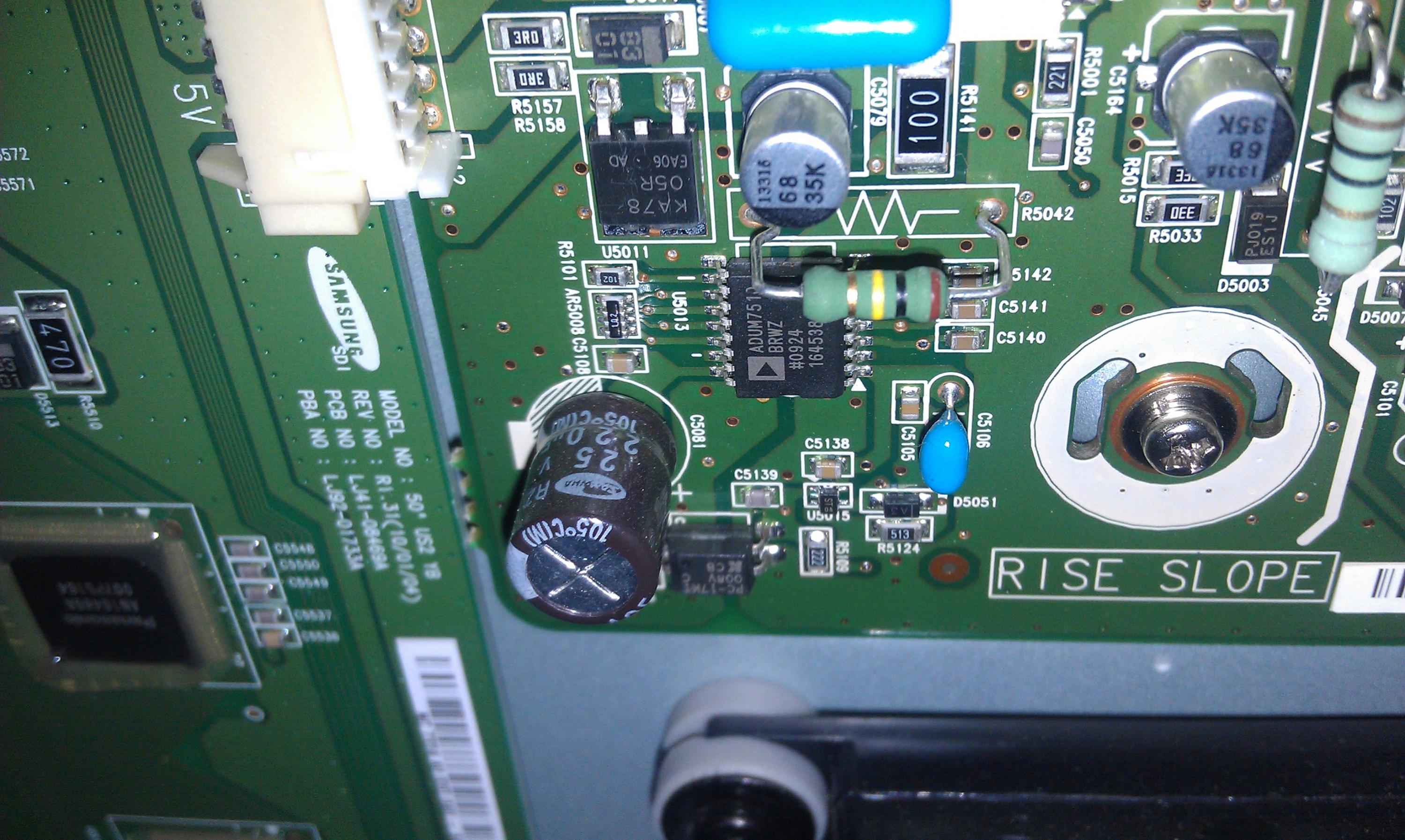

                            Maybe you should ask Samsung. Looks like they needed to tweak the design and didn't want to re-layout the board.
                            You successfully located the Y-buffer, so find the part number for it and replace it.
                              oh the numbers in the picture arent it?

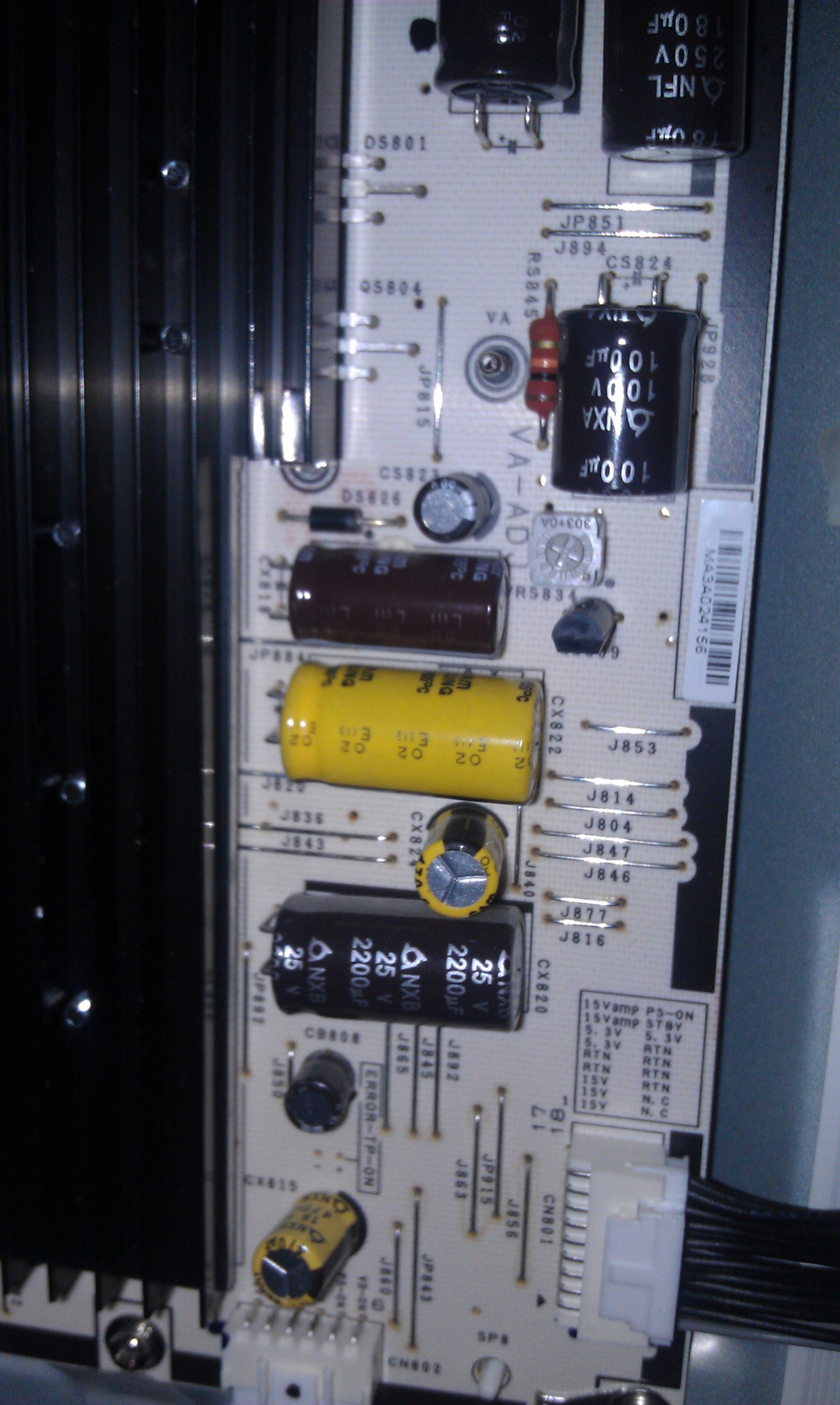

                                  No need to call Samsung.
                                  Just search for each of those numbers till you find it on eBay or somewhere, if you're lucky, it will be cheap.
                                  Hint: LJ92- or LJ96-xxxxxx is what you need. Always use PBA code.
                                  • Phaihn
                                    • Jan 2009
                                    • 842
                                    yeah i allready found that if you saw the lone picture above thats the part on this tv. edit nvm i see you seen it.
