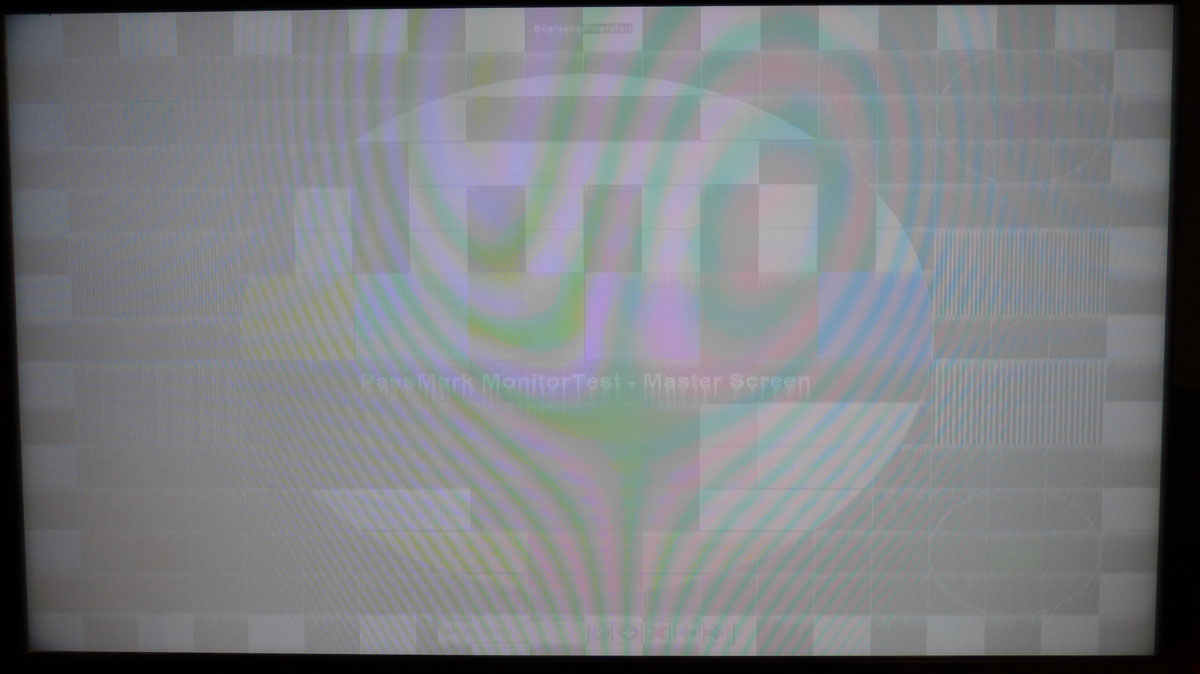

    Hi, I have a problem with this Samsung,
    the image is very bright and there are some vertical lines of different colours.
    I have updated the latest firmware -> no result
    Reset the factory defaults from service menu -> no result
    Changed all capacitors on Power board -> no result
    Checked and sprayed with isopropilic alcohol the LSVD connectors between LCD controller board and t-con, and between main board and t-con.
    Image is like in the file attached, for a detailed view : https://dl.dropbox.com/u/60894638/sm...sterscreen.jpg
    I also made a movie of tv :
    http://www.youtube.com/watch?v=oaWMRGlZ_kY&hd=1
    Re: Samsung LE37A656A1F HELP!!
    Bad panel or t-con; I have the 40" model. Does this model have the 100/120 Hz motion interpolation?
