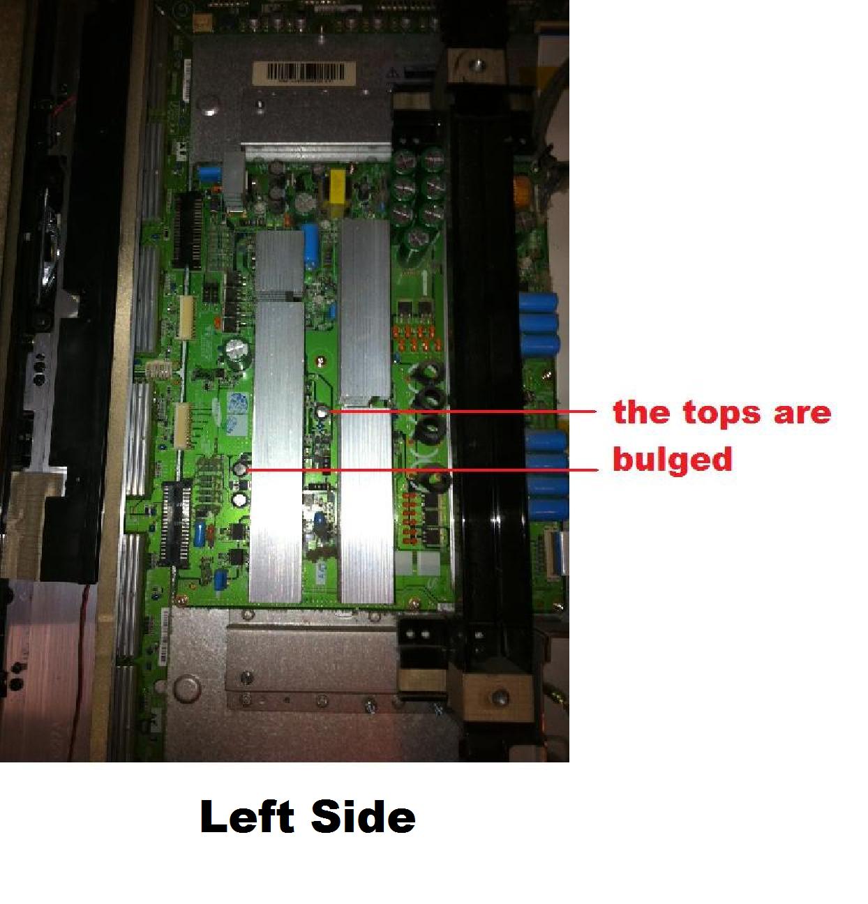

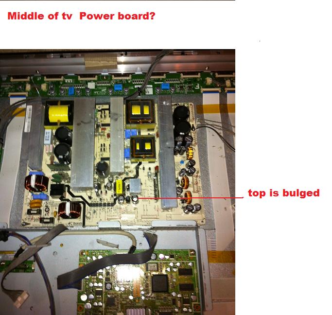

    Hello, I am Michael from Indianapolis Indiana. I don't know very much about tv's or any electronics. I am a race car mechanic, so I am fairly hands on. I have a Samsung FP-T5084 tv that will not turn on. When you try to turn it on. it makes a clicking sound then the red light on the front will blink until you unplug the power.
    attached are two different pictures that show 3 different capacitors that the tops are bulged out
    Do all 3 of these capacitors need to be replaced for the TV to work?
    I was able to remove the board that is in the middle of the TV with no problems.
    I am not sure where to begin on removing the board on the left side

    Yes, there is a chance that it will start to work by changing the bulging ones. But if you want it to work flawlesly from now on to the end of the world (or to the end of some other component) you should change all the caps on the powerboard. Though it's not necessary to change the 450V main filter caps.
    It's a plasma set so there's alot of caps and it could cost a bit to change them all. X-SUS, Y-SUS too where the caps are bulged.
