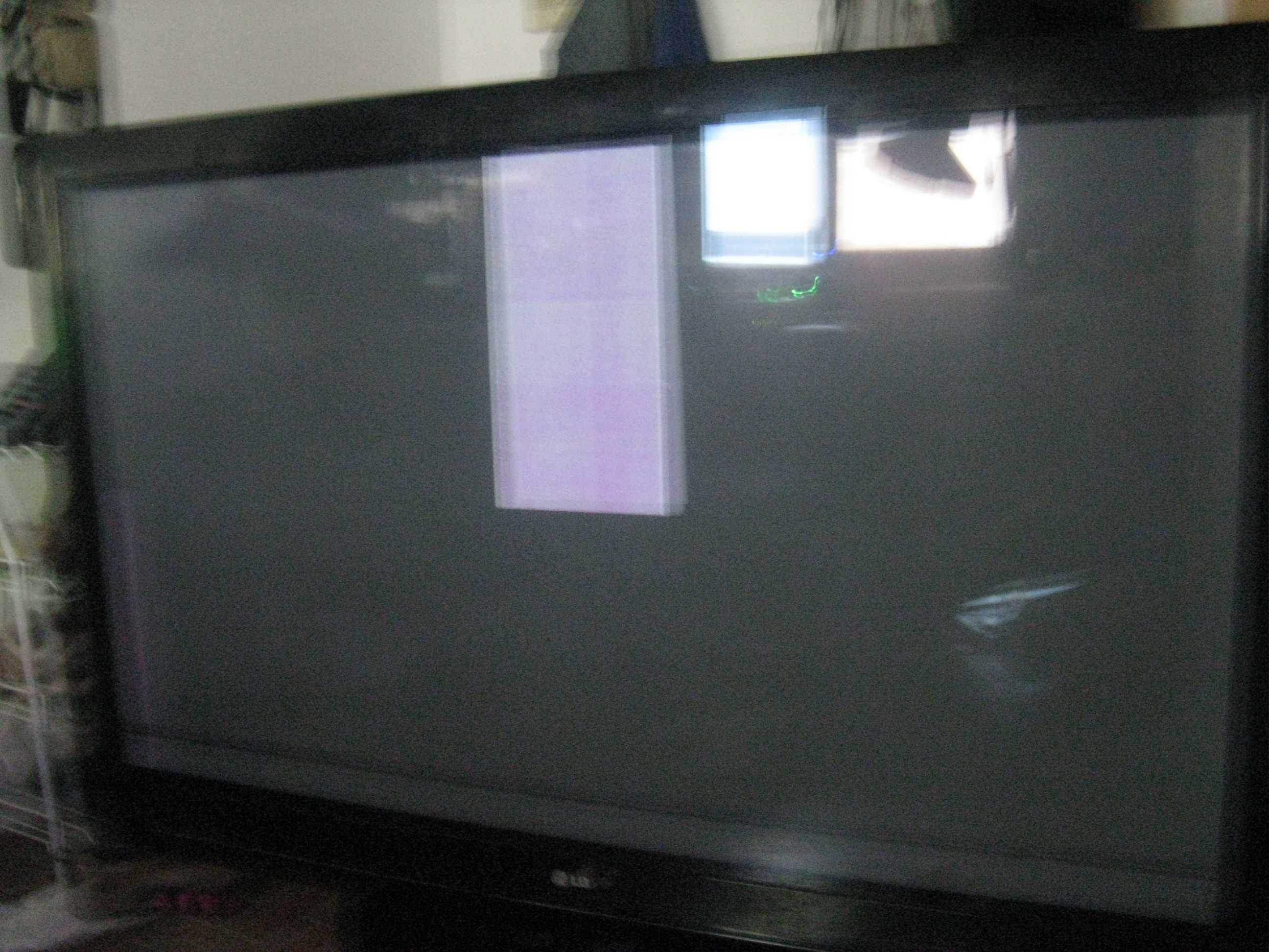

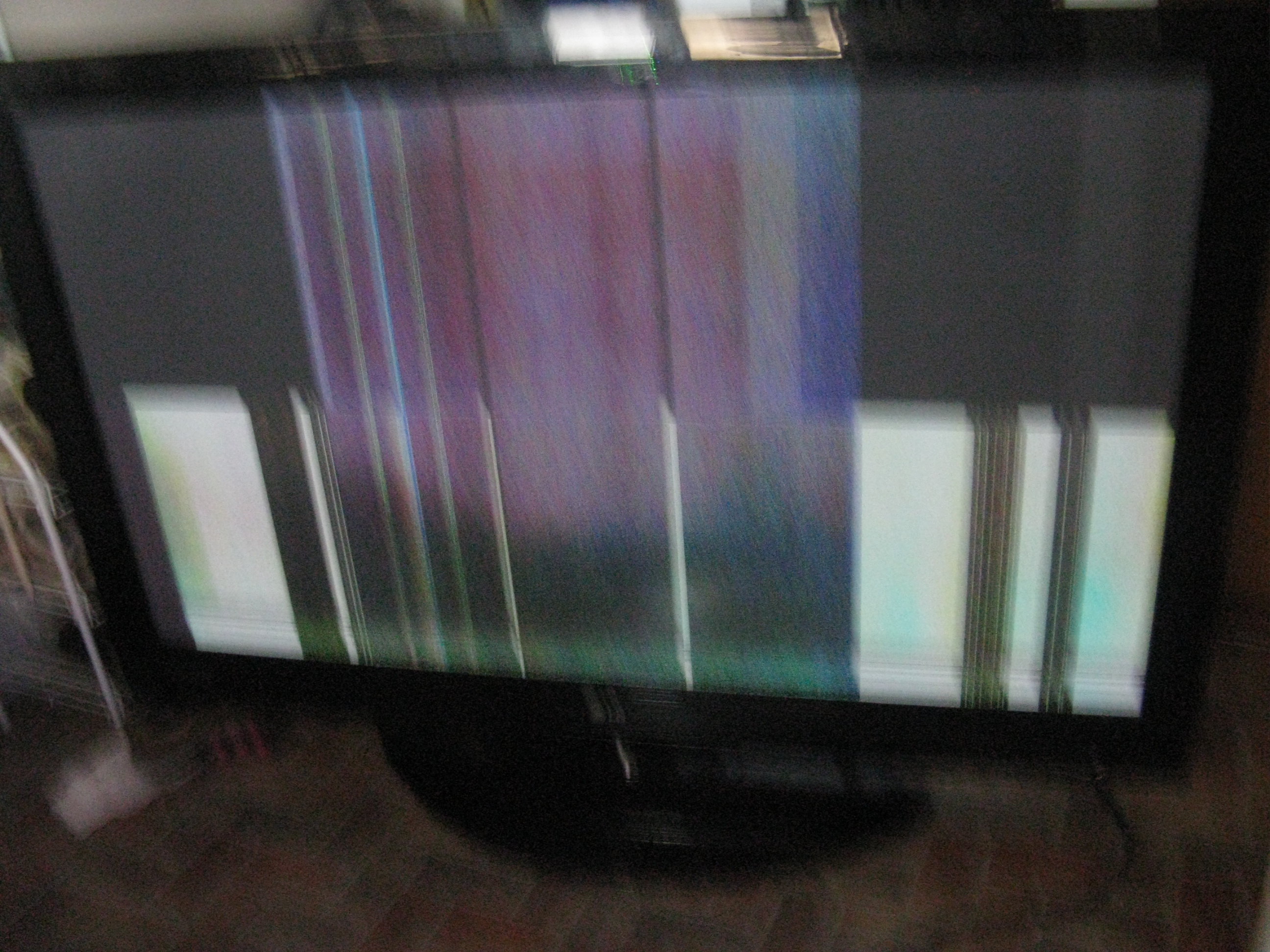

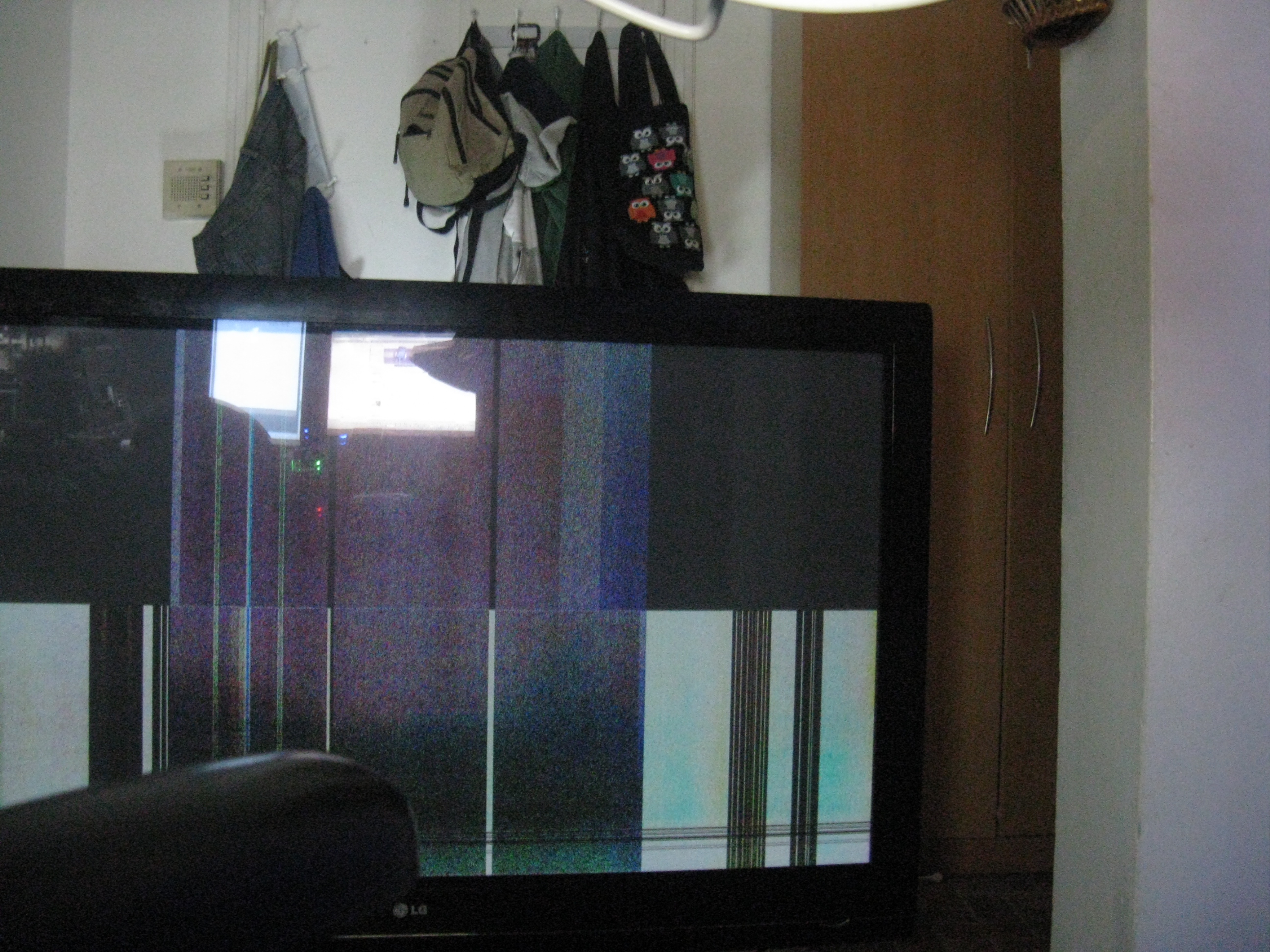

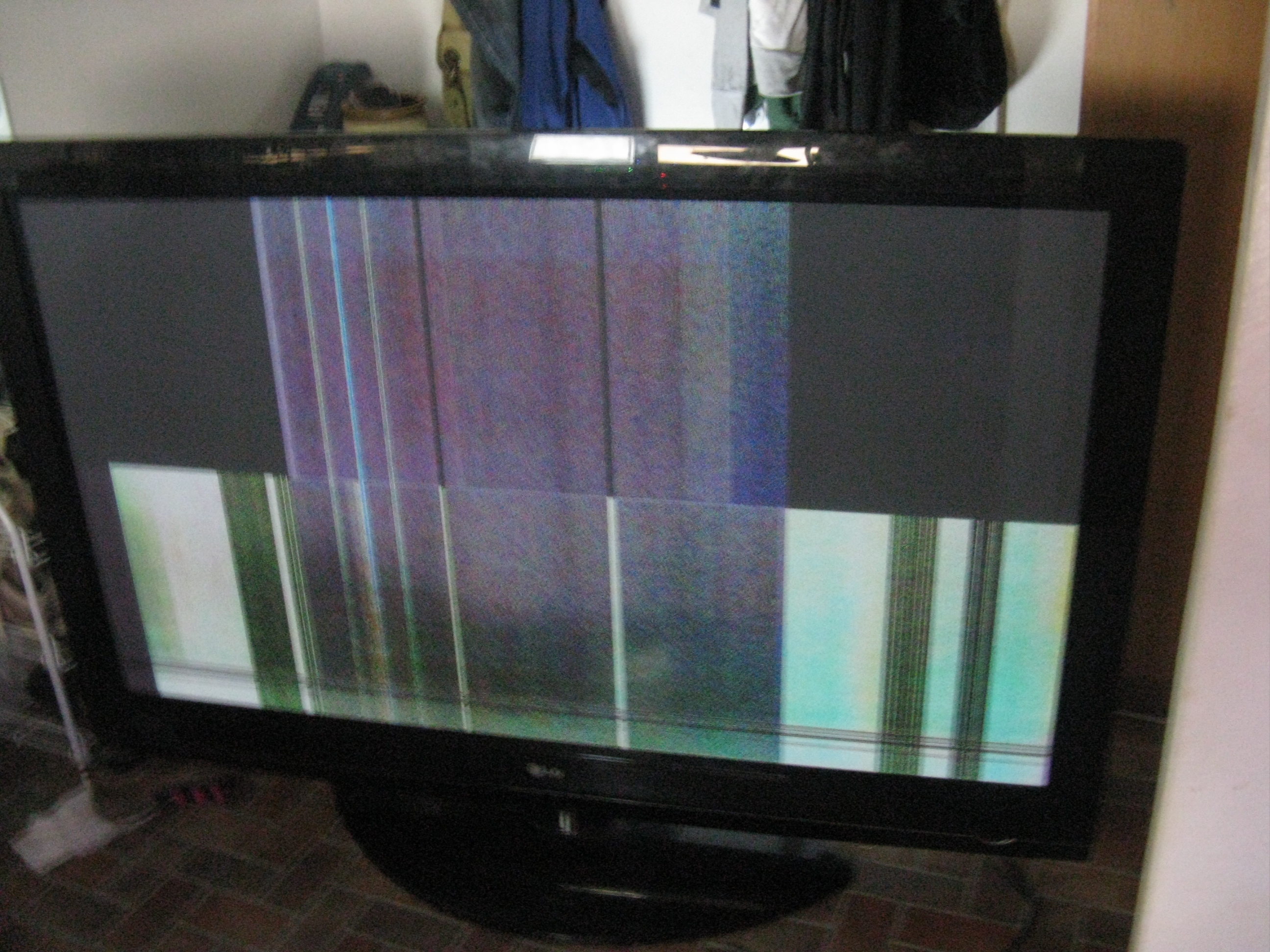

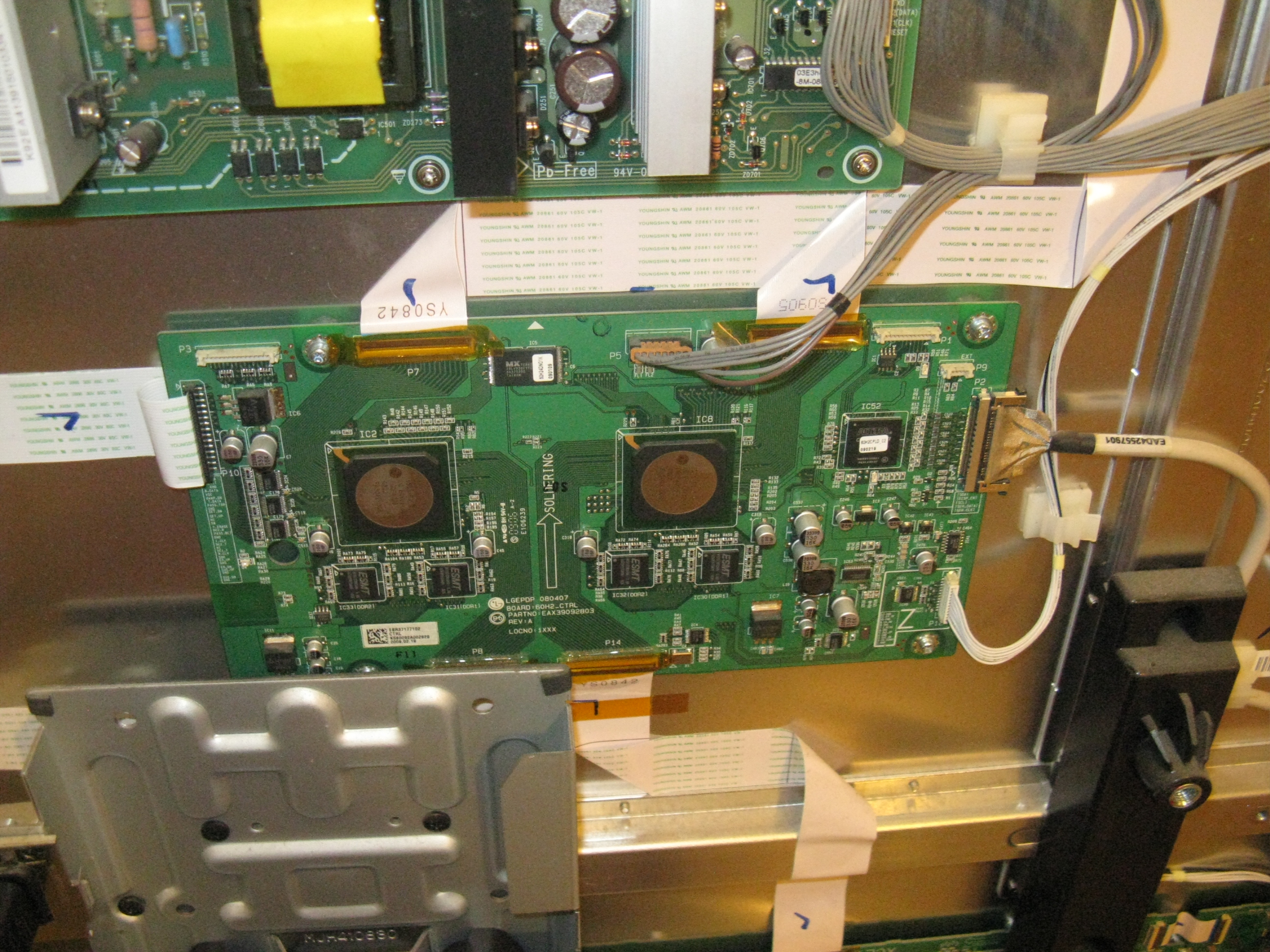

    i have a plasma 60 Ich LG with this stragege video defect. I have sound
    i attached some photos
    anybody can help me with an advice, please?
    Re: LG 60PG30F-UA plasma 60 inch defective image

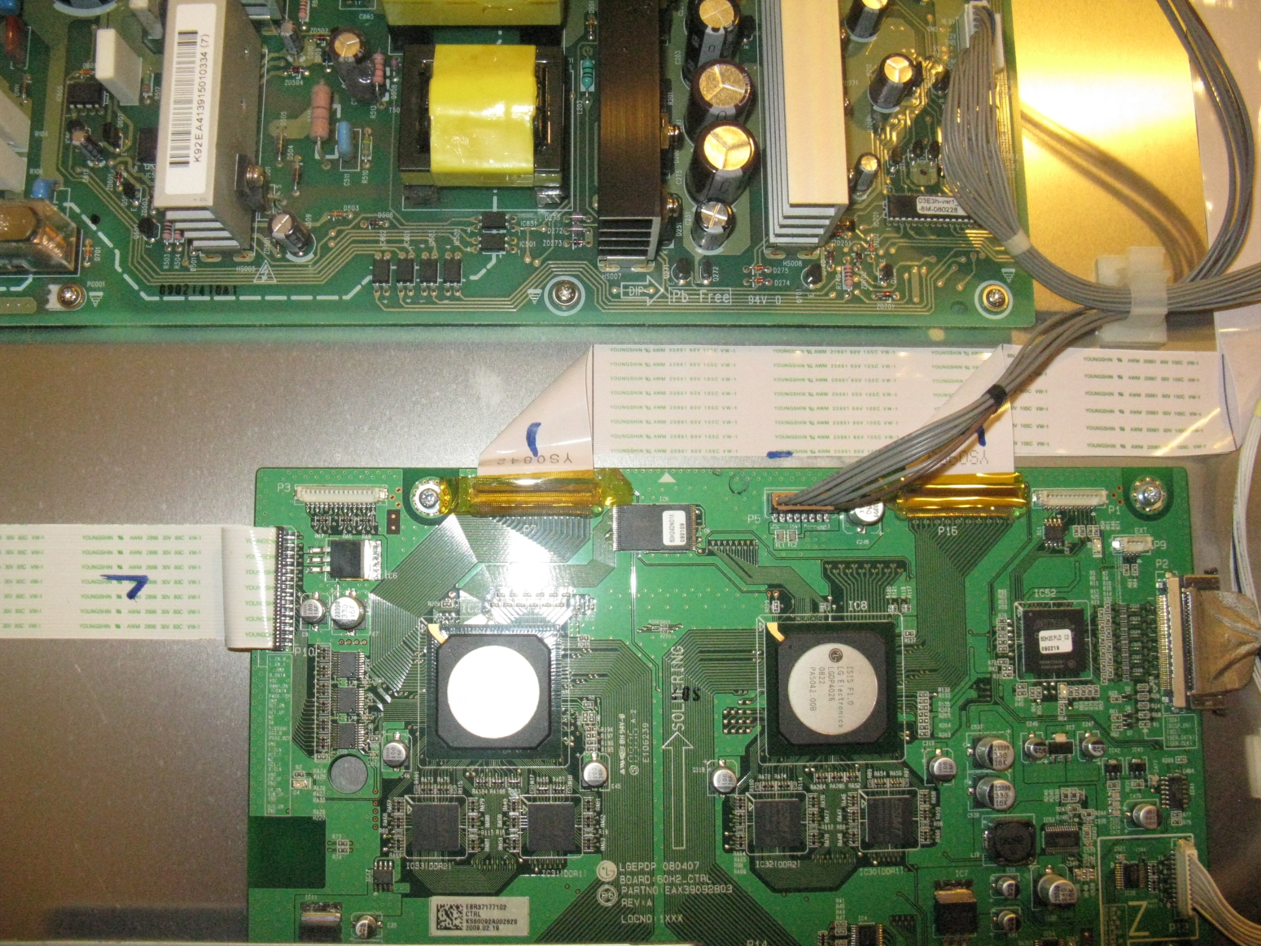

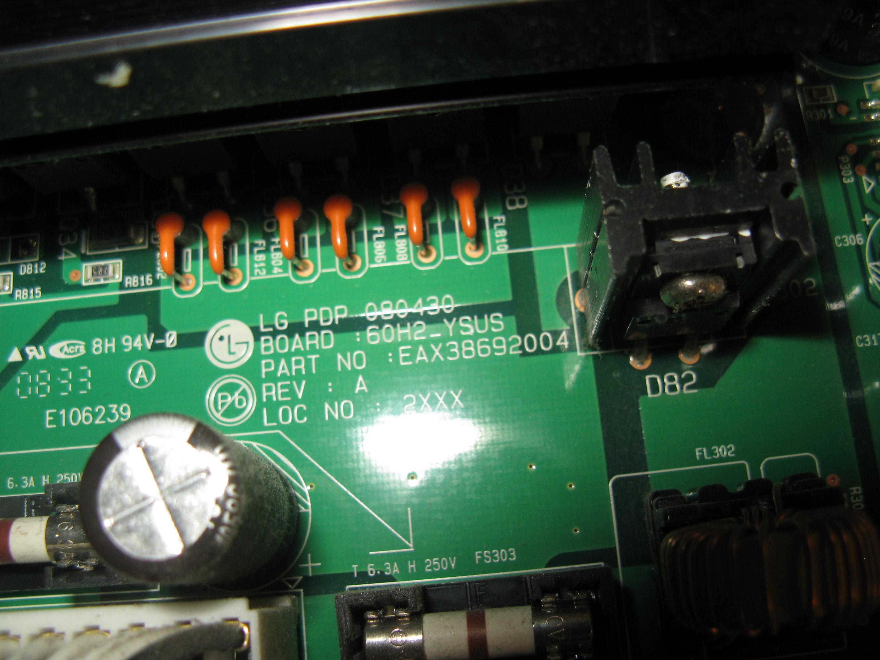

    It looks like a Z-sustain or control board issue.

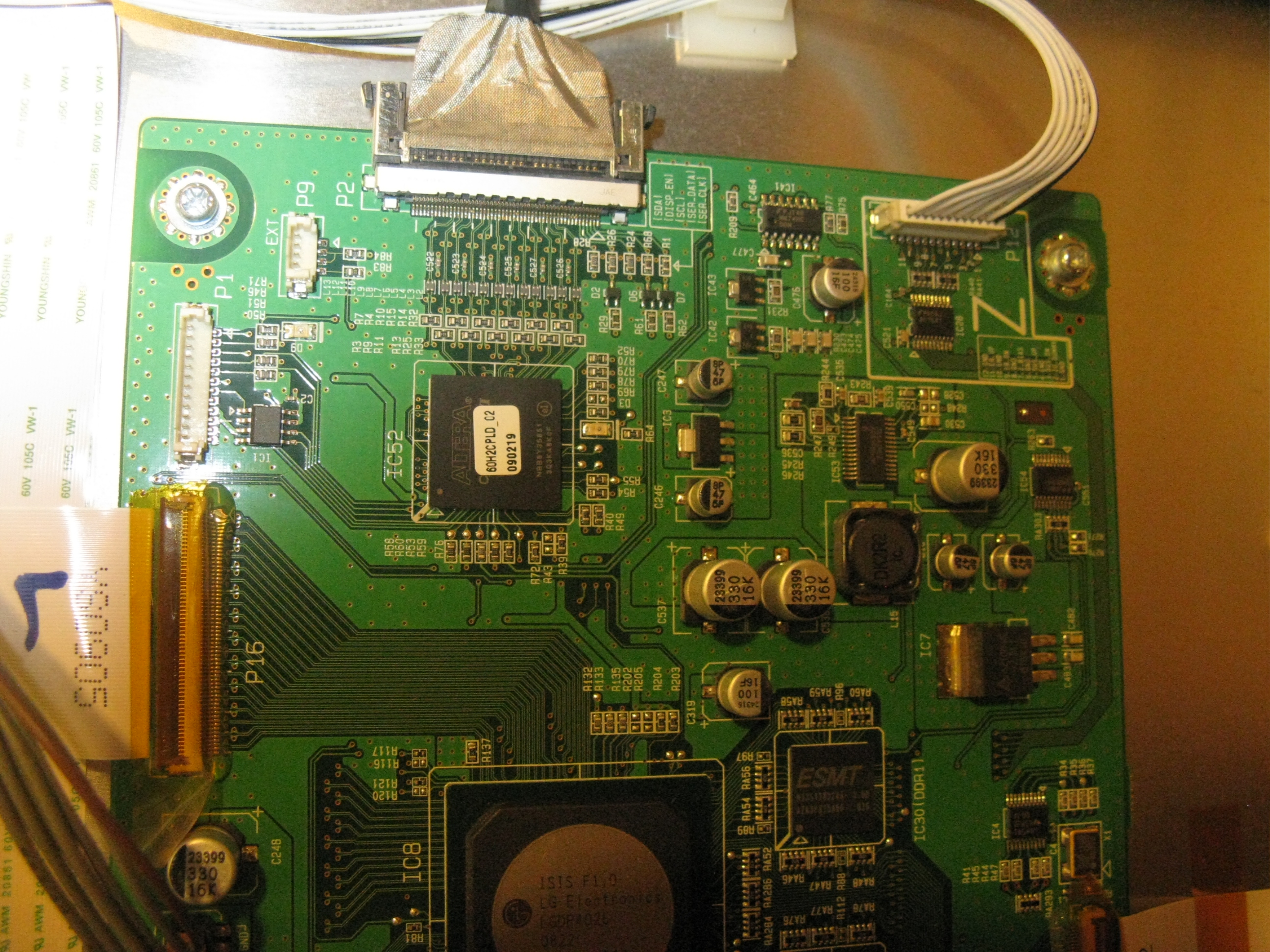

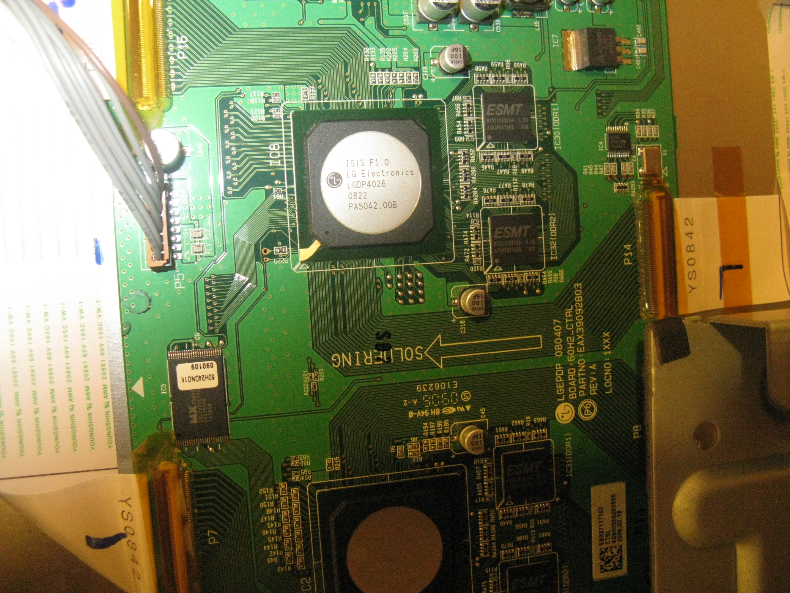

    Can you get closer, in focus (not blurry) pics of these?
    You may need to remove the boards and use daylight. Works best. If you can get a good picture without removing them try that first.

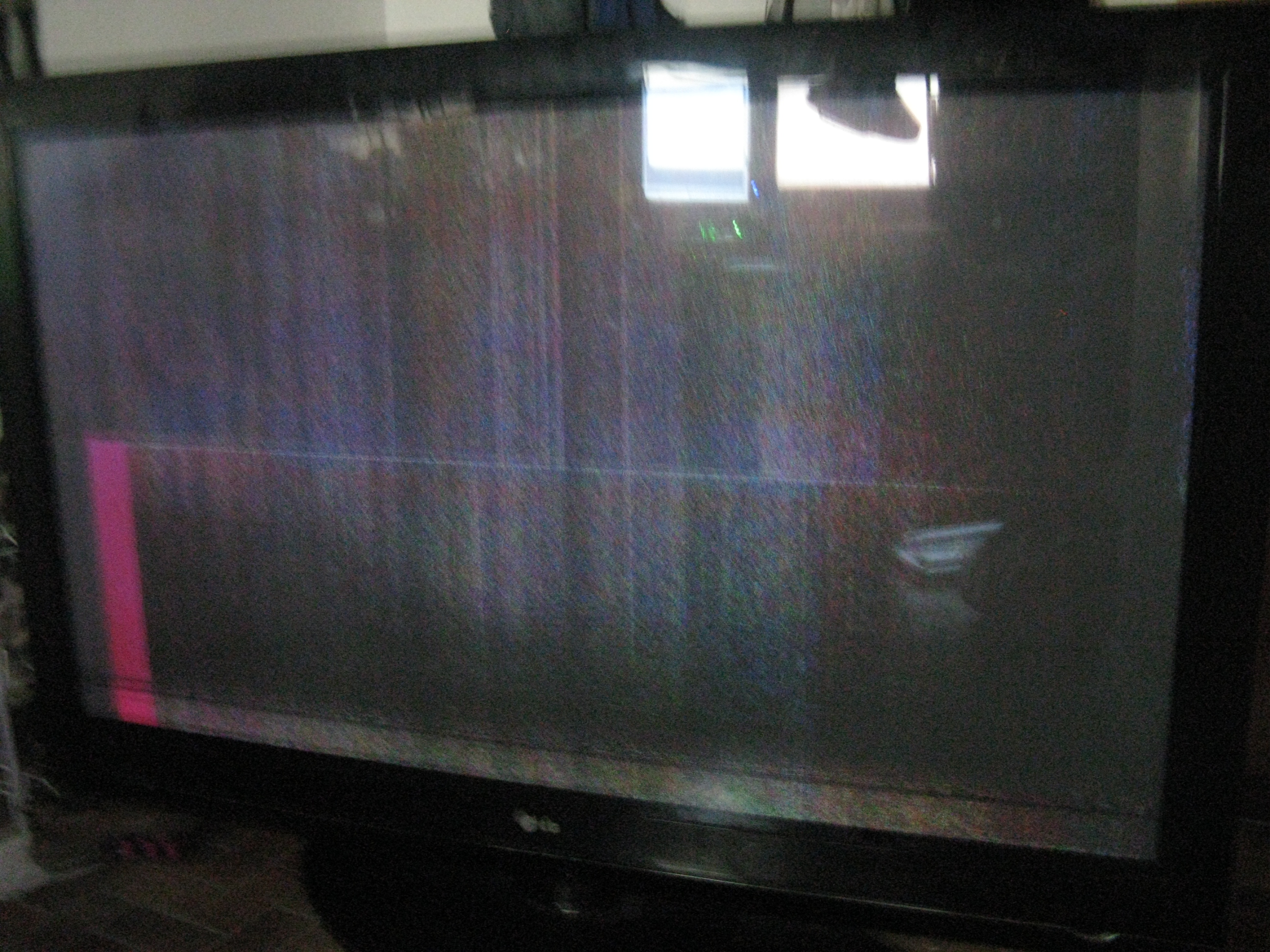

      how about the horizontal lines in bottom of the screen,. there are not moving, are permanently

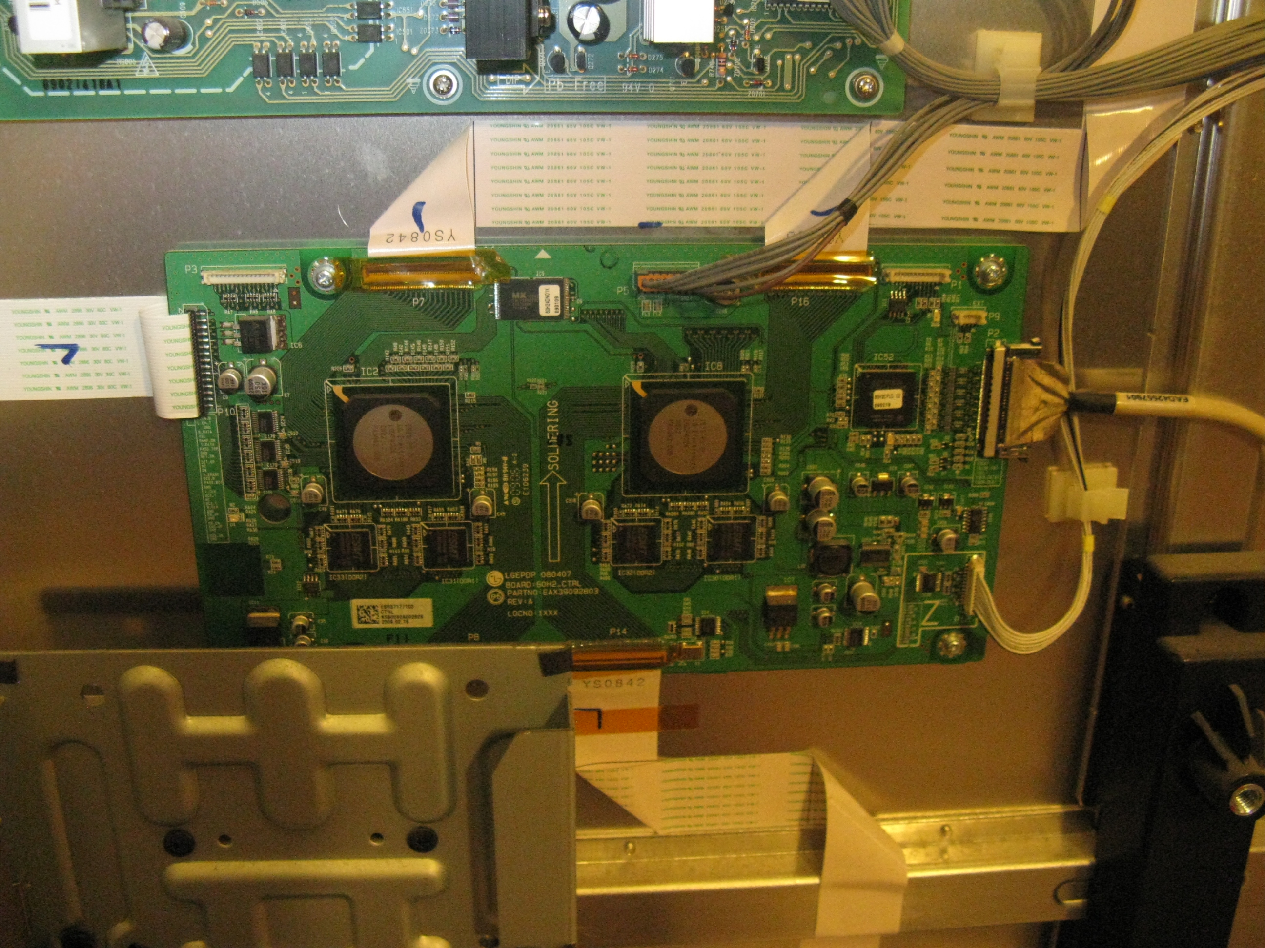

        another close photos

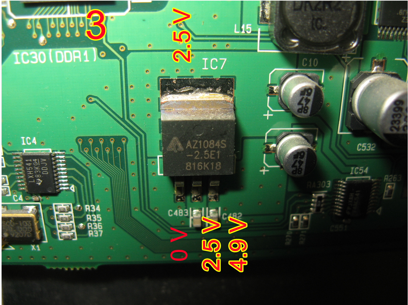

          It's really difficult to see anything on the screen with the camera shake.
          I assume you have a DMM (digital multimeter?)

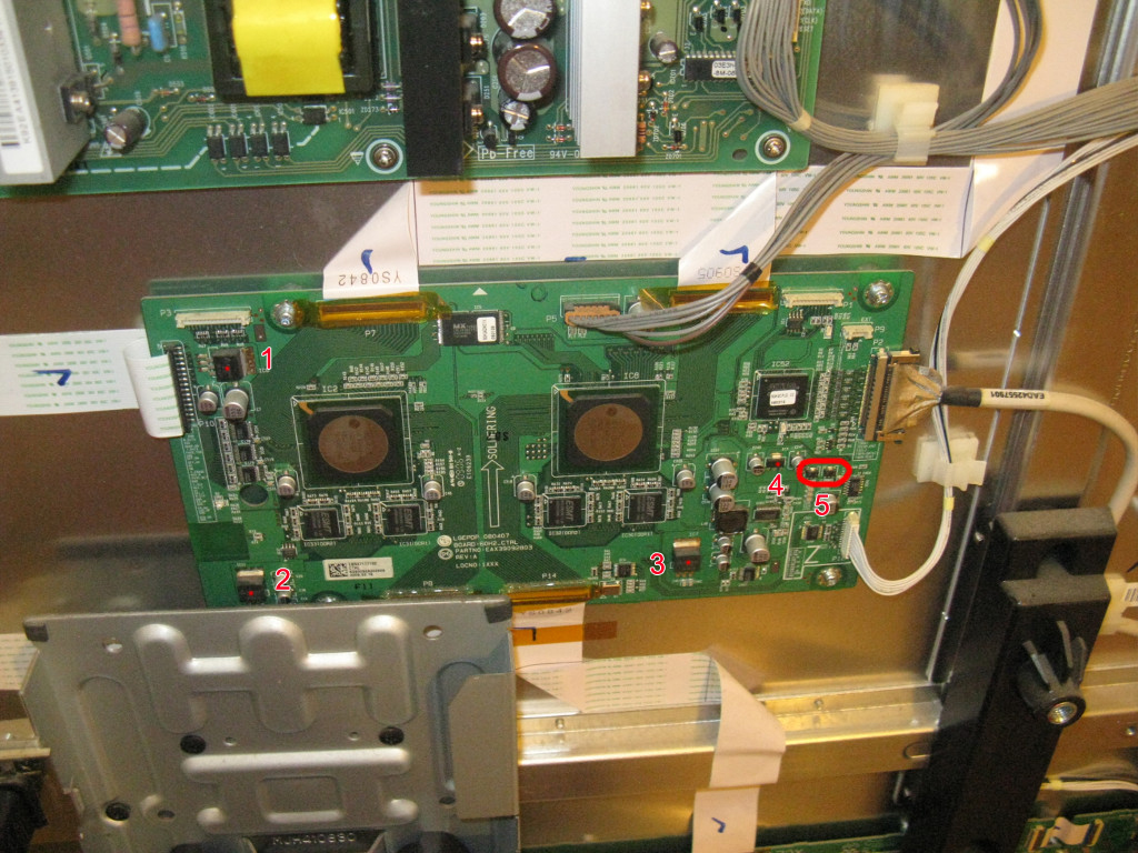

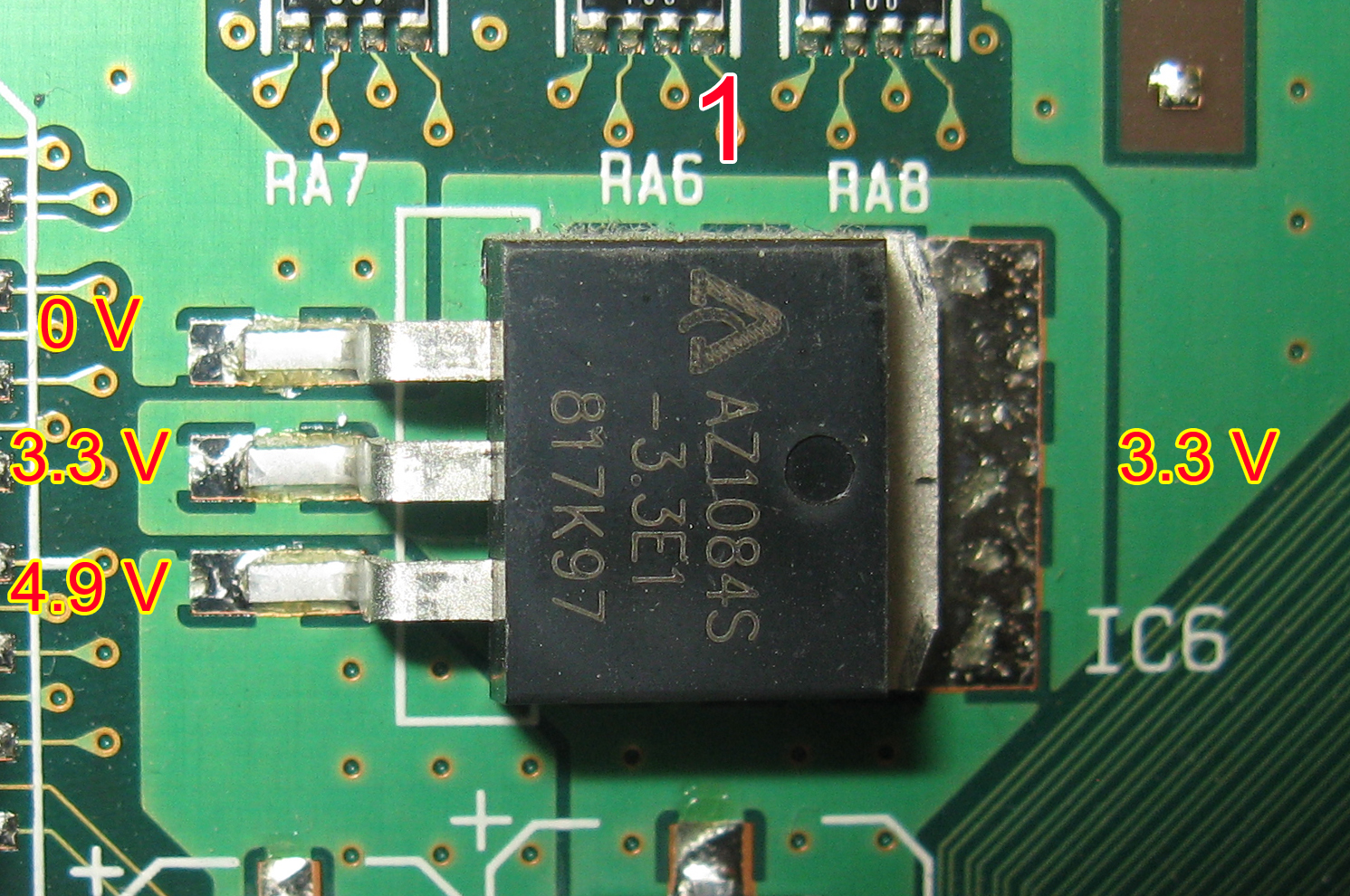

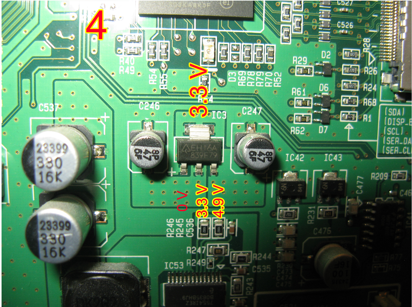

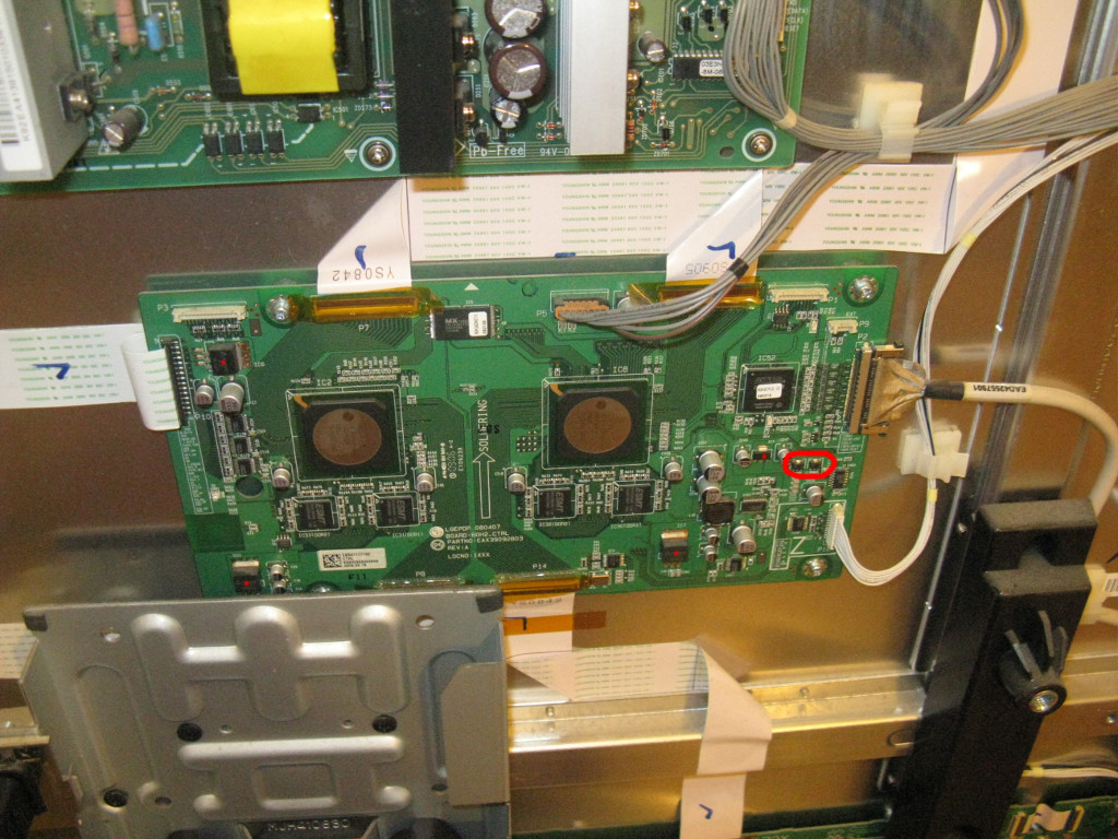

          I've highlighted some regulators with a red dot. Using a DMM can you check each pin of the regulators including the fat "tab" pin at the top. Check on 20V DC, with black probe in frame of TV, and with TV switched ON. For each device report pin voltage and device part number (e.g. APS1117-25.)
          I've also circled two devices, can you read off their part # please?
            ok
              I think your regulators are okay. (All measurements are good.)
              Were you given the TV with this fault, or have you owned the TV and it went wrong? Did it go wrong slowly (occasionally getting stuck with screen like shown, or after a few minutes going bad), or did it go wrong suddenly?
              It sure looks like a control board issue. But I cannot rule out bad buffer boards. The lowest price I can find the control at is $80. http://www.usefulparts.com/index.php...roducts_id=479 Very steep price.

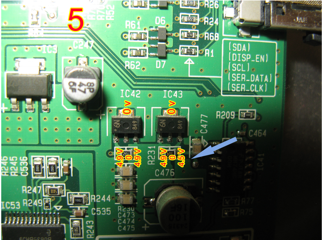

                Aha, IC43 seems to have a low output voltage.

                  That's assuming it's a voltage regulator...
                    Yes, is it? xD
                    Muh-soggy-knee
                      Originally posted by ben7 View Post
                      Yes, is it? xD
                      yes
                      it just him who have a slow voltage difference
                      and somebody give me the tv
                        Originally posted by nickmatine View Post
                        yes
                        Can you figure out what its connected to, or what it powers?
                        Muh-soggy-knee
                          It looks to me more like a power transistor than a regulator. I can't be certain.
                            Yeah, I got a lead to some sort of mosfet, but Im not sure.

                              how about the horizontal lines? there are always there, black, not moving (even the image change). Is the plasma panel defective also
                                It seems like both x-sus and y-sus are broken, but I'm no expert, tom66 is
                                Muh-soggy-knee

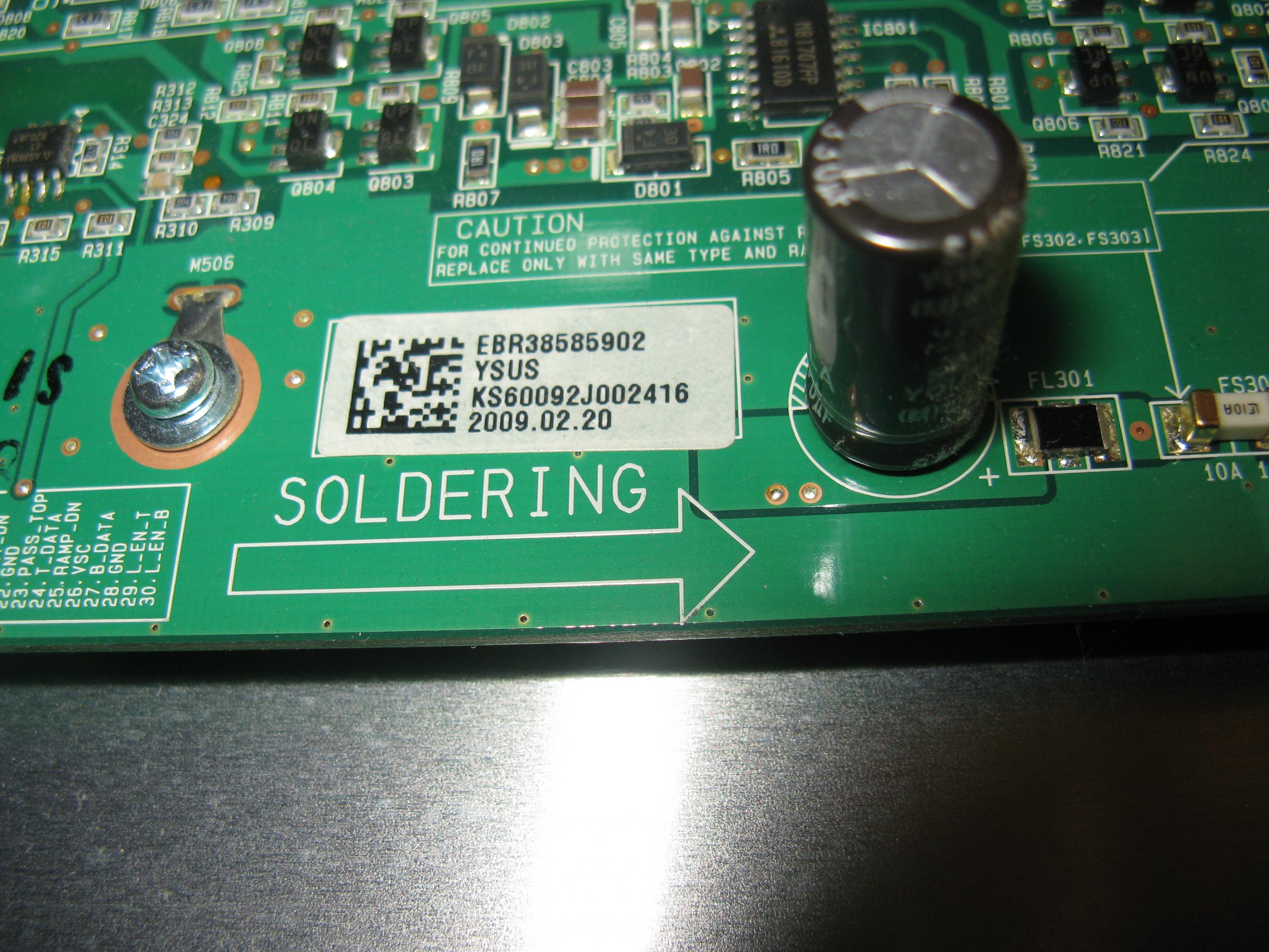

                                  Lines from left to right are okay, top to bottom CAN mean buffer but not always as a control board can cause both to go wrong. Do you have a part # for the buffers (left hand side of screen with the little black heatsinks on them.)
                                    this is for TNPAA4910
                                    FOR THE LEFTSIDE ARE TNPA4403
                                      Clarification on my previous post. Top to bottom can mean PANEL, but could be a control board issue. Your pics are of the Y-sus; the buffers connect to it thru the plasma panel.
