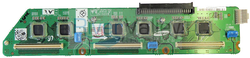

    Can anyone tell me or has anyone else used the y-buffers LJ41-03882A + LJ41-03883A from a Samsung Panel S50HW-YB01 and used them in a S50HW-YB02 panel which has boards LJ41-05122A + LJ41-05121A?
    I have and they have the same connectors and worked. I even had a top buffer from the early model with the later model's board on the botoom and it also worked producing the same image.
    If anyone has information on this I'd appreciate it thanks.
    Just uploaded some actually shots but had to steal the lj41-03882A picture as I don't have it with me.

      Just used this exact swap- works like a charm.
