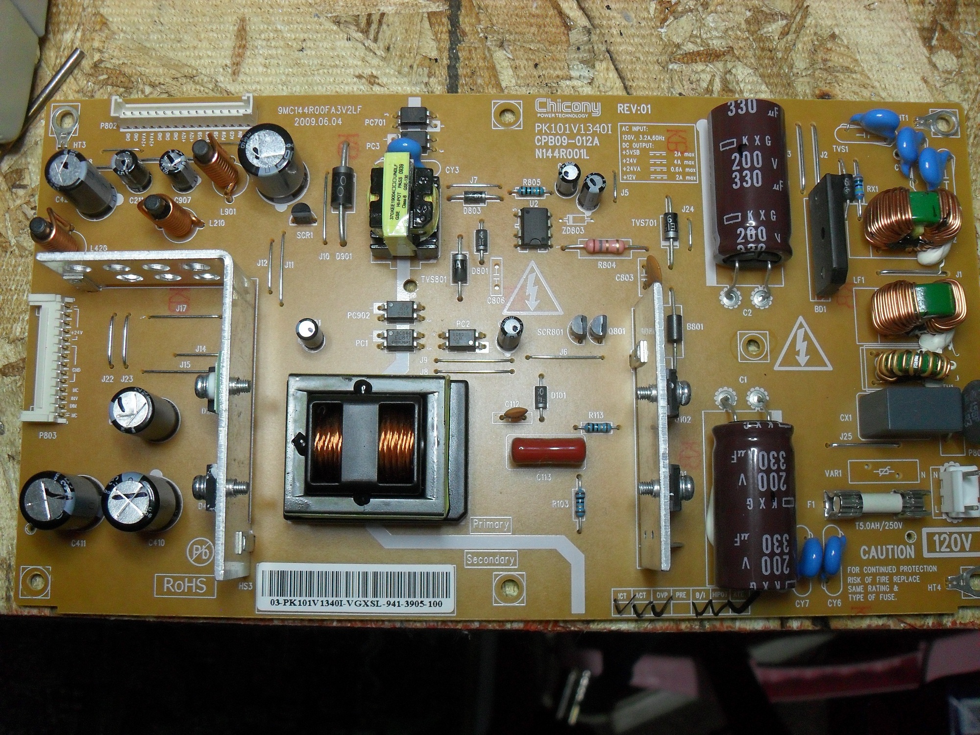

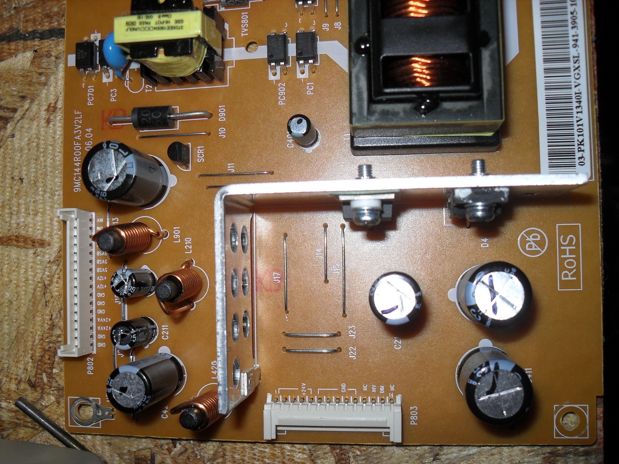

    Bought this a few days ago.
    1. Backlight is blinking off and on really really fast.
    2. Red light on the Input board is blinking off and on red and speaker on the right side facing down is making a popping noise.
    5V is all over the place.
    12V is all over the place.
    24V is at 23.5V
    165V on Both Big Caps.

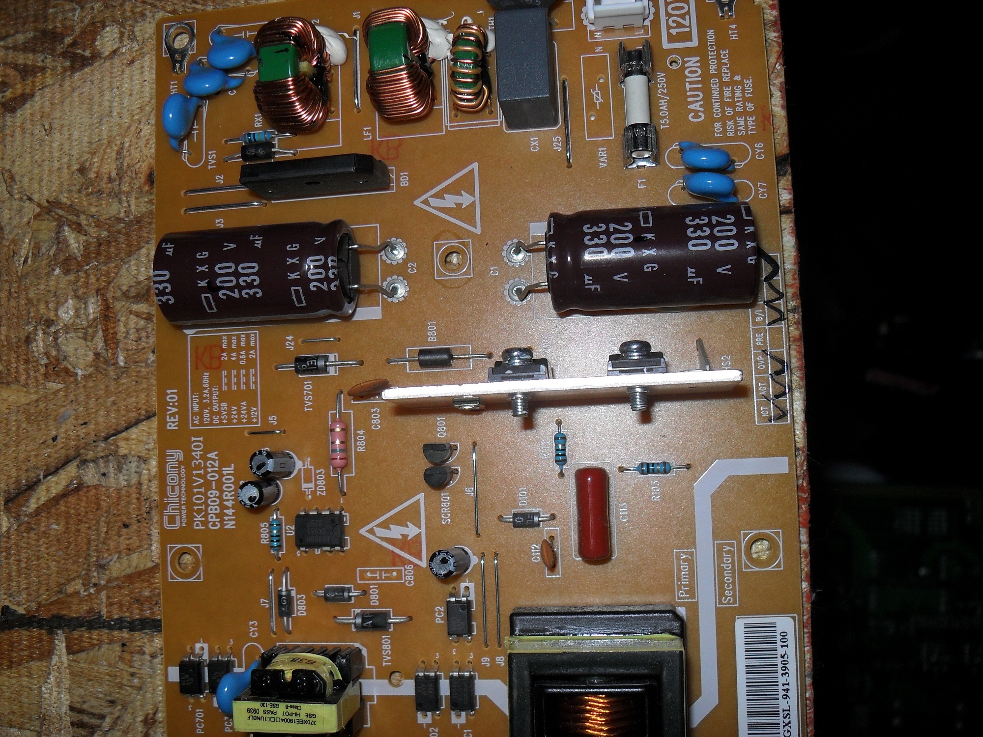

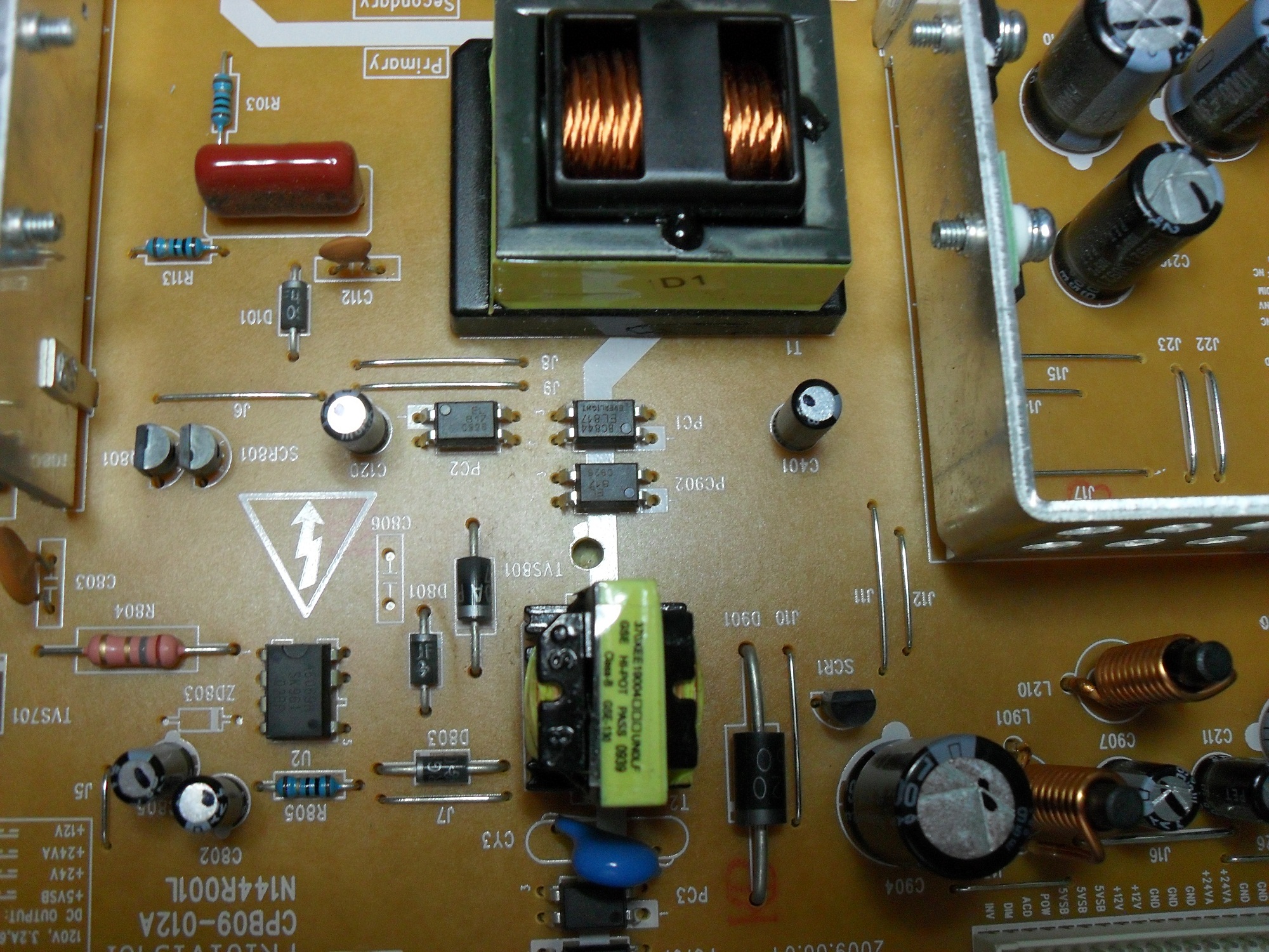

    i have a power supply from a TOSHIBA 32AV502R but its missing capacitors.
    photo to that power supply is http://assets.shopjimmy.com/media/ca...k101v1070i.jpg
    if someone could help me find out what caps it needs.
    Re: Toshiba 32av502rz
    Classic symptoms of a bad startup cap - one of the small ones on the side marked "primary". Likely the two small ones next to each other. Try replacing them as they are low cost (20 cents each...)

        Okay; I'm thinking that it's a shorted output diode, or an excessive load. How does the TV behave without the inverters connected? Also, check TVS801 for shorts.

            The layout of the PSU is conventional. The 5V standby is produced by the small transformer. The 12V and 24V are produced by the bigger one. The odd thing is, you say the 5V and 12V are unstable, but the 24V is not. That is very unusual. Can you double check the 5V is genuinely unstable? (How unstable... 0.1V or 1V or 5V ripple?)

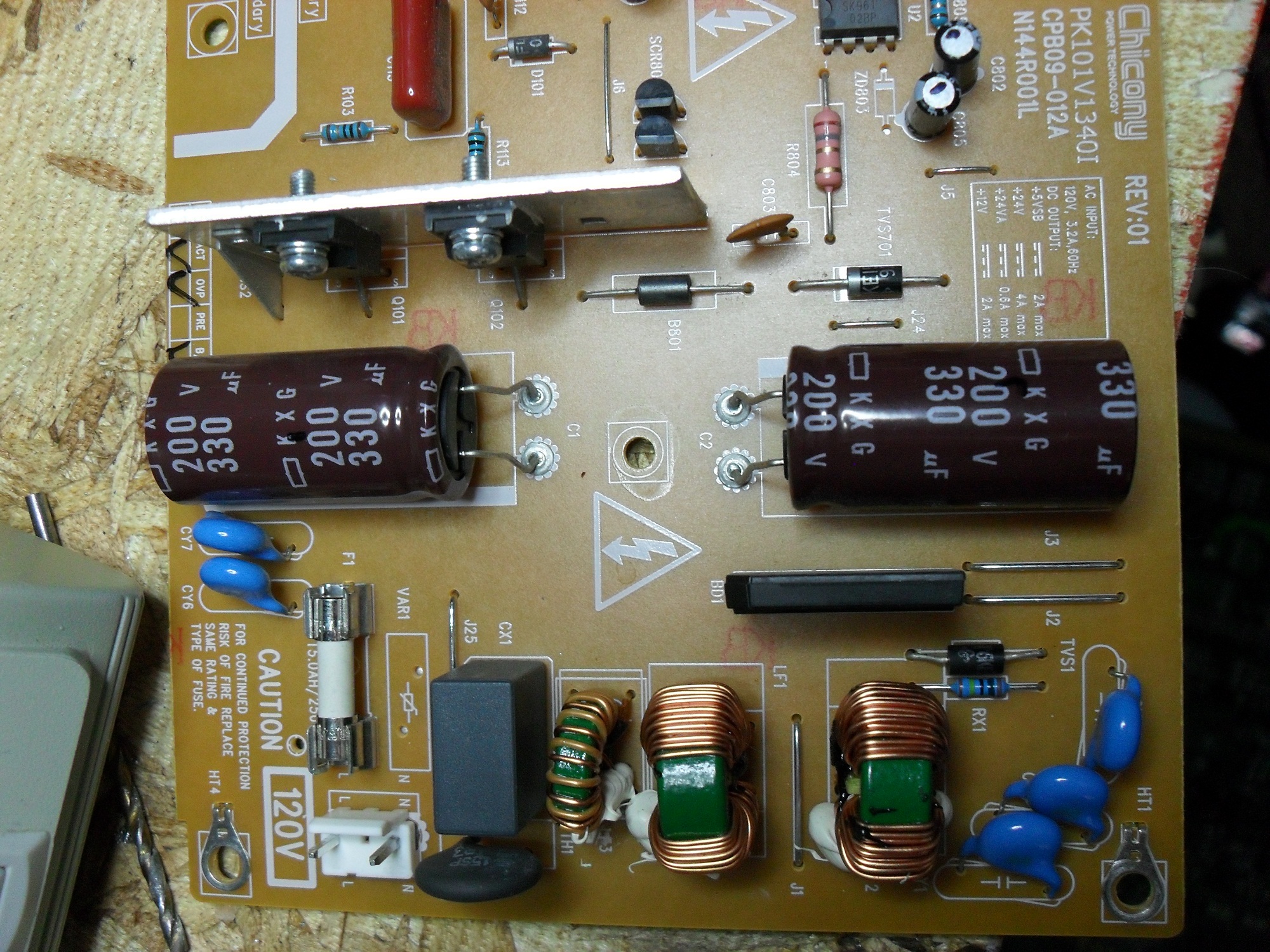

                    Okay from what I understand of these Toshiba PSUs the two big caps are wired in series and form a voltage doubler. I'm not sure why they do this. If one cap goes bad, it will cause the doubler output to drop out.
                    Check the voltage across from one negative terminal of the cap to a positive terminal. I *think* you should see about 330V.
                        Big caps go between 328 and 330v
                          Okay, so they do wired them in series as a voltage doubler. One more mystery solved, although why they do that escapes me. 328-330V seems okay for a doubler output.

                                      That seems okay. Is your other Toshiba board the same as this one? I'm suspecting the device SCR1; it's an overvoltage protection "crowbar"... If something is wrong with it, it may be firing too early. Does your other board have SCR1?
