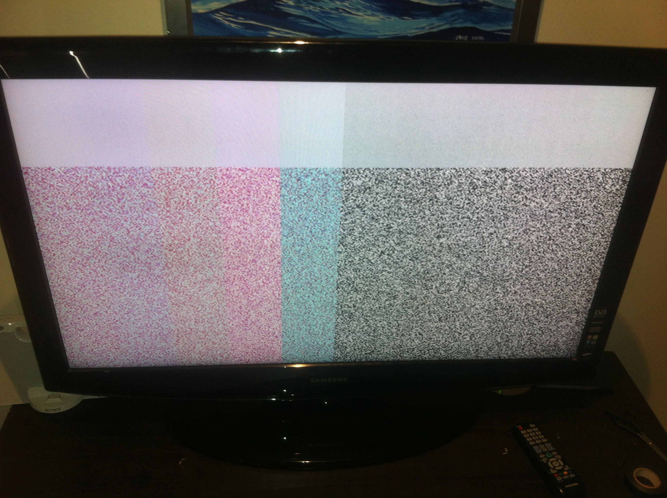

Samsung la40r81bd

    Ok Tom thank you i will have a look another thing i didnt mention is there is no sound

      Re: Samsung la40r81bd
      Ok I stripped it apart and unconnected the two ribbons on the t - con board and reconnected as you suggested ill share a another photo of what it looks like now I'm guessing I have to pull it apart again
