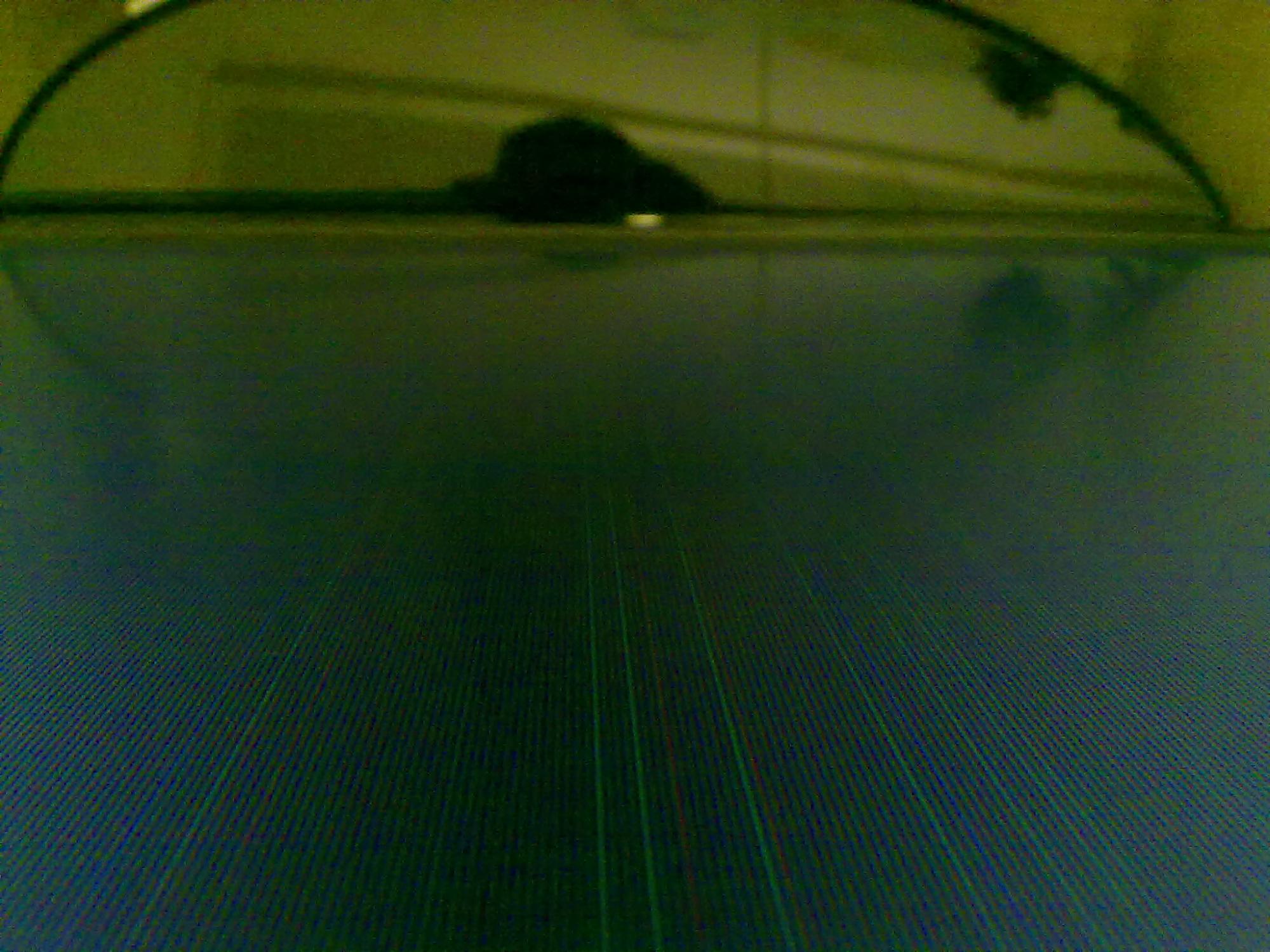

    Got this TV for a quite reasonable price! When plugged in and turned on, there is sound, but there are various multicoloured single pixel vertical lines on the display and no visible image as such.
    After leaving it to warm up for about 20 minutes and turning it on again, I did get a nice picture.

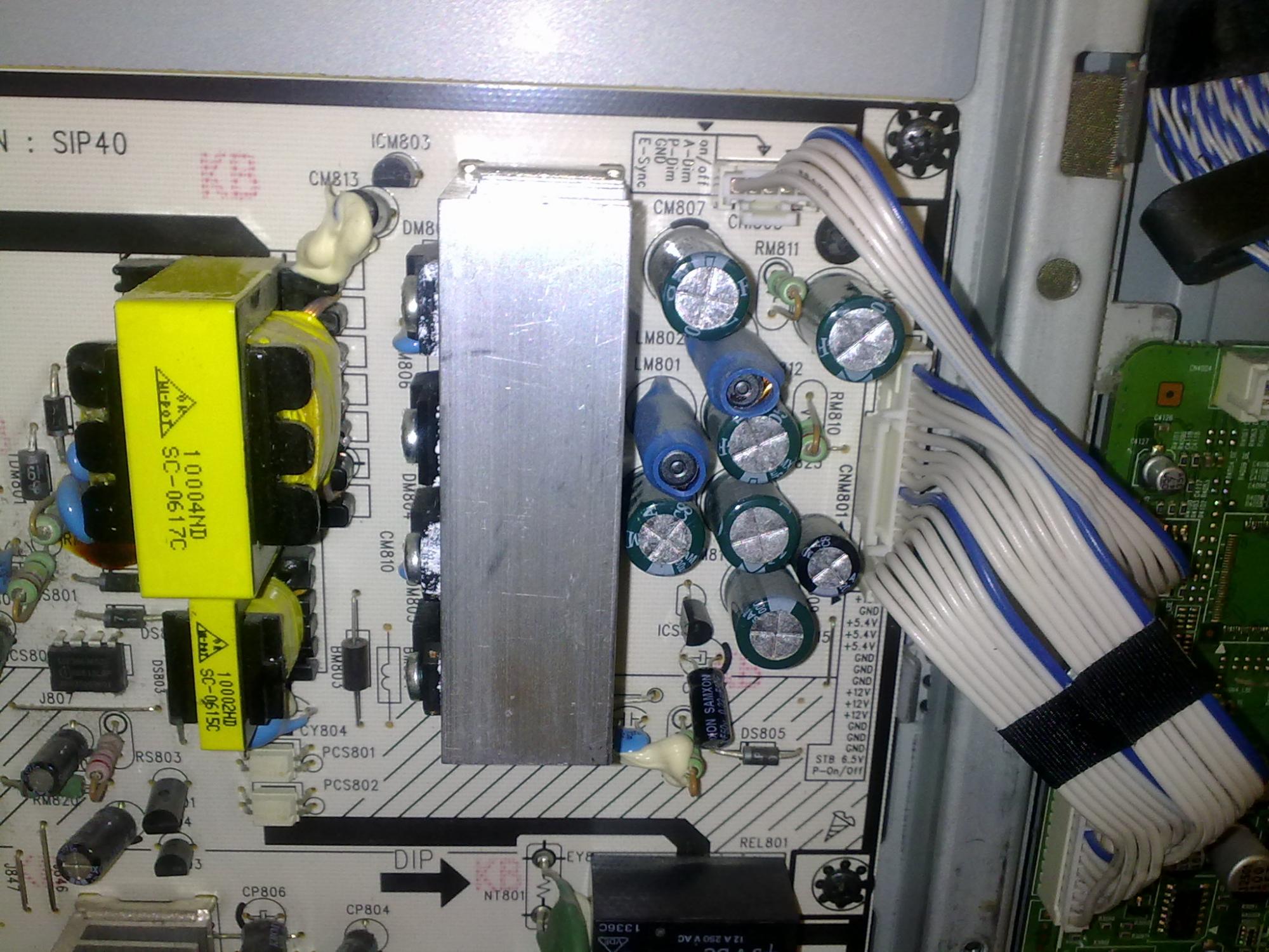

    I am thinking this is either a bad T-con (bad solder joint or maybe a bad MLCC/ceramic cap), or a bad cap on the PSU. None of the caps are bulging, but I'll test them with my ESR meter later. It doesn't have any problems turning on or off, it seems to be a later Samsung using Samxon capacitors instead (GF(?) series).

    Tested the capacitors. I'm getting 0.06 ohm ESR at worst for the 1000u/10V; this is just within specification, so I'm going to say the caps are most likely good, and give replacing the T-con a shot - could just be a bad solder joint under a BGA.

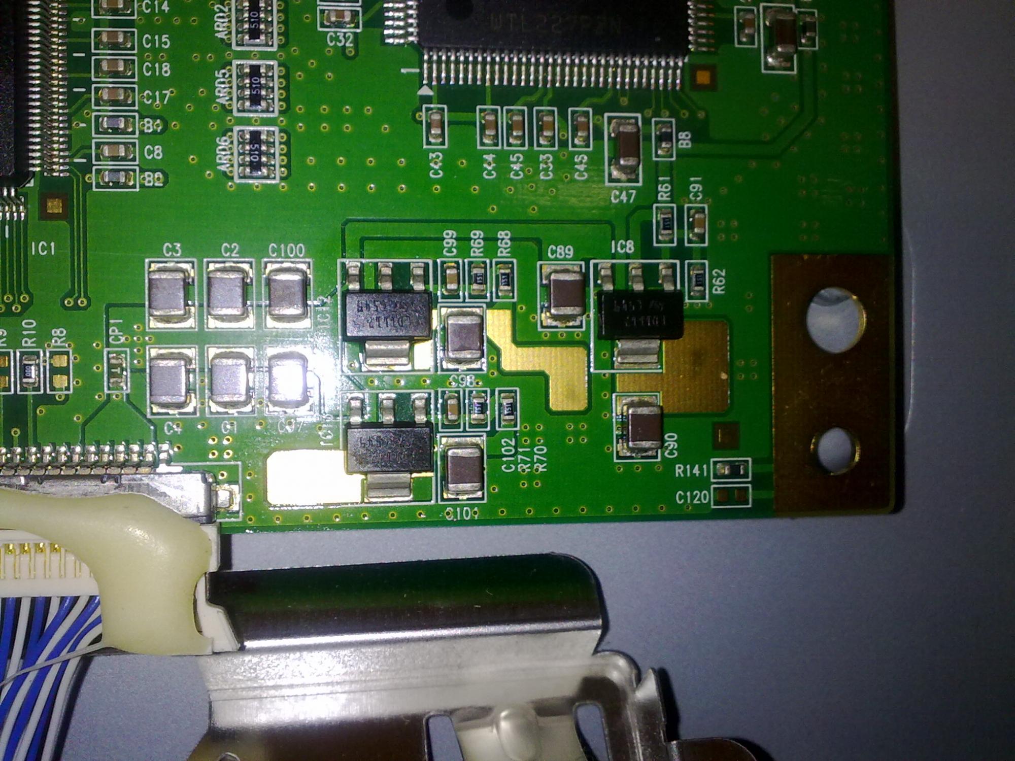

      I found a failed voltage regulator on the T-con.
      The part # is LD1117-C549. STMicroelectronics.
      Given the placement of resistors from the output to the ground/adjust pin, I'm guessing it's probably an adjustable regulator. These LD1117 regulators seem to fail all the time.
      Input measures 5.2V, output measures about 1.1V and adjust is 0.57V.
      There are two other regulators on this board, they test okay.
      I'm wondering if when the set warmed up, this regulator started working properly again?
      Also noticed the boost rail on the T-con sits at 4.3V, probably due to the main chip not working.

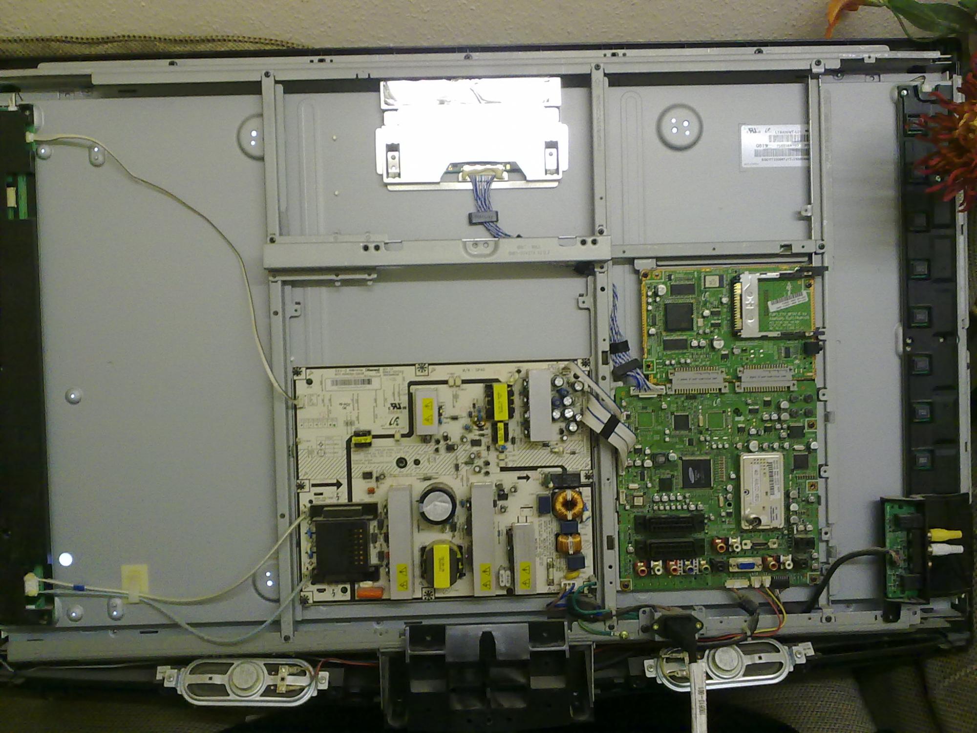

        Pics attached.

          Since the other regulators are rated for 2.5V output and the faulty one is too I decided to fiddle around with bridging it to one or the other, just as a test. Once I did this, I got a picture - although a bit flickery it doesn't surprise me as it's clear one regulator isn't up to the job of powering the load of two. I've ordered a new regulator & will post if it fixes the problem.

                Just fixed this TV. I did a REAL bodge job trying to replace the LDO but eventually got it on. My main problem was I lifted the ADJ/GND pad so had to run a jumper wire, but it's now working.
                I was at the office, where I only have a basic soldering iron, ideally I'd use my hot air station to remove the LDO then stick it on with a bit of solder paste and apply solder to the pins.
