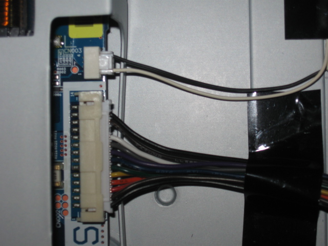

      Re: Toshiba 46xv640uz inverter
      Thanks, this is the left hand connector.

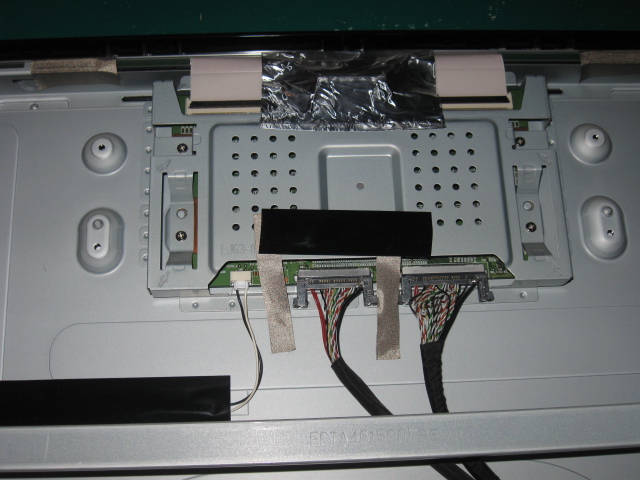

        There are two wires going to the real left hand connector. Where do they go?
        PlainBill
          They go to the board top center - t-con board?

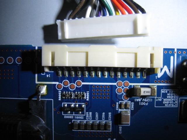

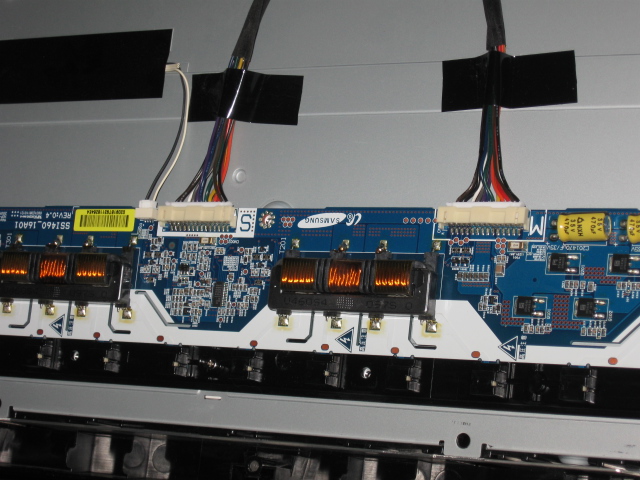

              Let me try this again. The picture of the left connector was excellent, but I see no signs of control lines. I'd like a similar picture of the right connector, and just for luck, one of the narrow connector.
              PlainBill

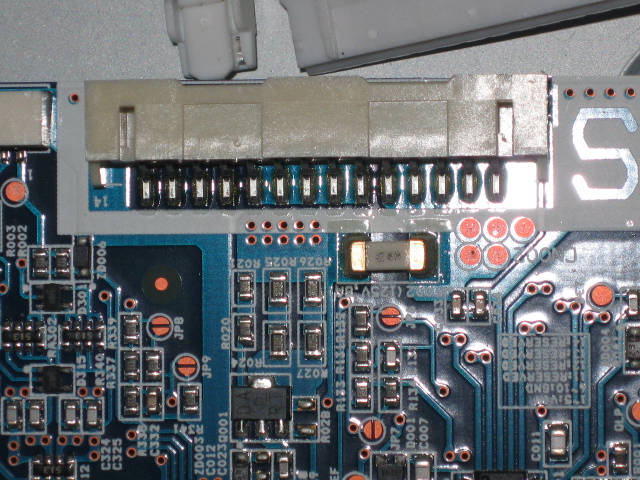

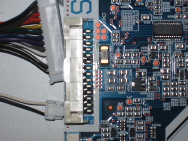

                Right connector and narrow at the inverter.
                  50% excellent, 50% incorrect, but it doesn't matter.
                  The connector with the big M (master?) next to it has 4 pins that obviously carry control signals. One of the methods of troubleshooting 'disappearing backlights' problems is establishing if the inverter is turning off, or being turned off. Pins 11, 12, 13, 14 are the control lines. What I would like to see is the voltages on each pin when the backlights are on, and when they are off.
