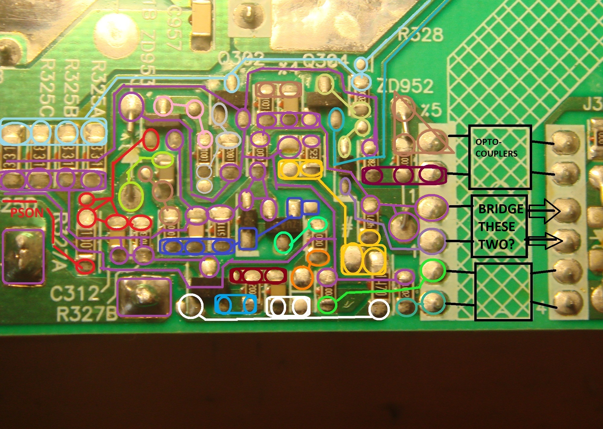

    There are a total of four opto-couplers (one is further up on the board), and they all face the same way (which I guess means the high voltage side can only receive signals but not send them, correct?). I have attached a hand drawn schematic that I am still in the process of completing.

      If the 2N7002 has a gate-source short it could be the problem. Check that.
      Q302 makes little/no sense in its configuration with a ground on both collector and emitter. Also, there needs to be a pull-up for the base.

        99.7k ohms between gate and source on 2n7002.
        I do not see a ground on the collector side of the Q302, do you mean the arrow I drew going up? That is a connection that goes to some components further away from this section of the board.
          I meant the emitter. I don't understand why there would be 5x330 ohm in parallel (=66 ohms) and then an NPN which may or may not short them out. Doesn't make much sense to me, but I didn't design this circuit.
          So the optocoupler is IC303. Can you try bridging the two pins on the primary, and seeing if the PSU turns on?

            IC303 is one of the opto-couplers, and the only one that I have gotten up to so far in my drawing of the schematic.
            Is bridging the two contacts on the primary side of the opto-coupler necessary, since I know that I can turn on the power supply with a pair of AA's?
            Also, the Q302 is a PNP transistor not an NPN.
