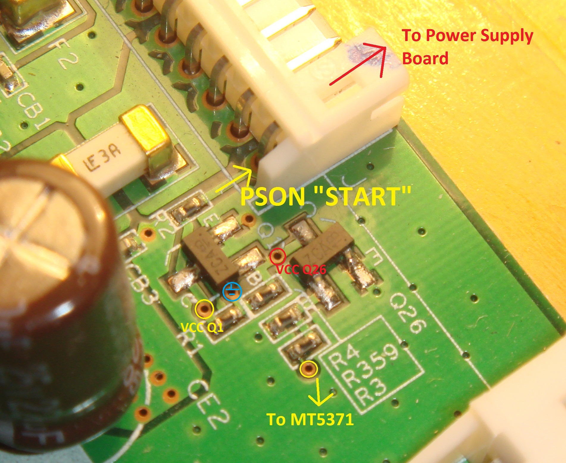

    I have attached an image of the back of the main board. There are no chips on the back of the main board, just a few SMD inductors and caps.
    Should I work backwards from the PSON pin on J1? There are a pair of BJT NPN transistors (MMBT3904L) directly connected to J1. Would my best best of finding the problem be to follow the traces leading into the PSON pin?

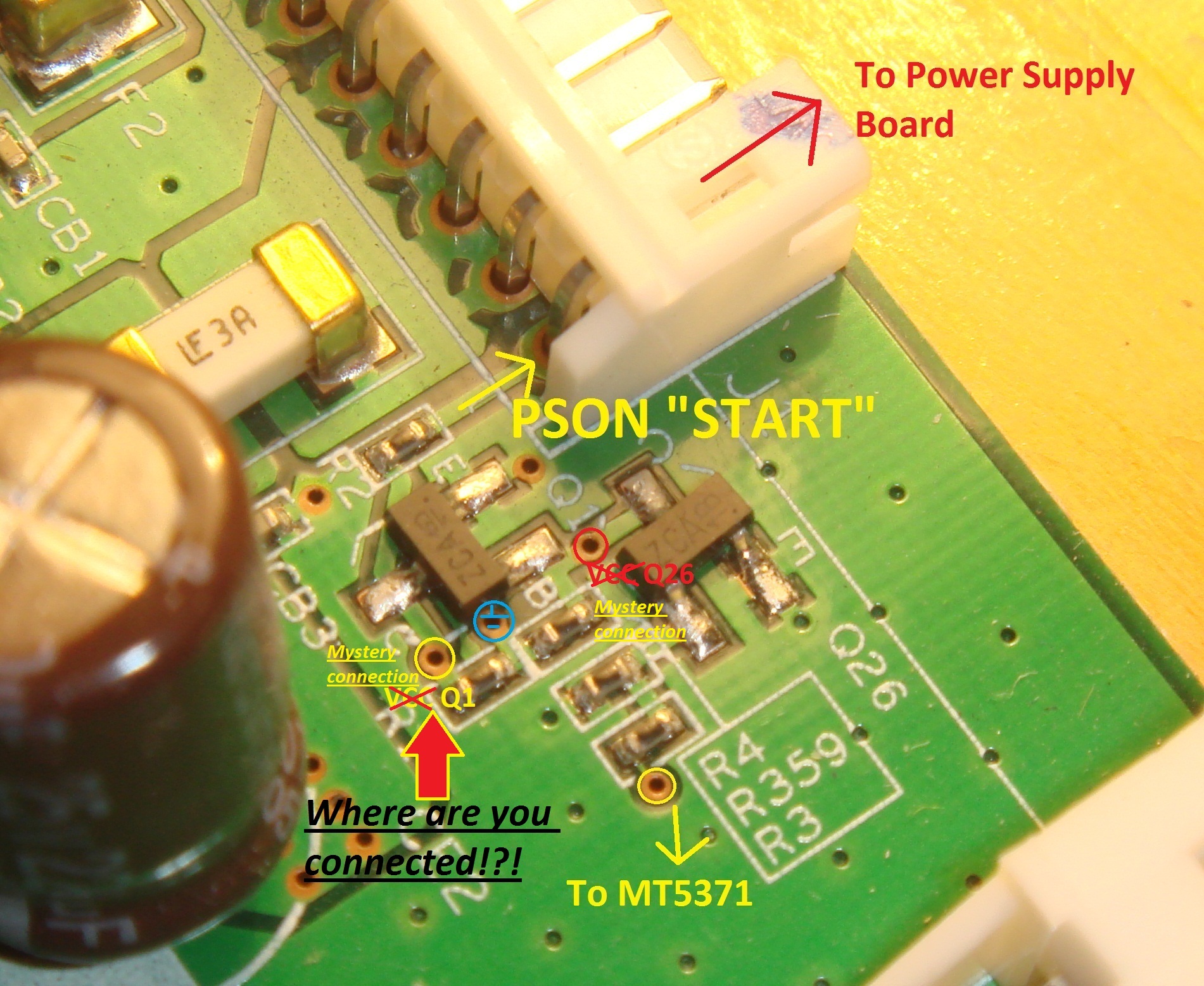

        The first thing I hit that J1 is connected to is R2, whose value matches the expected value from the service manual (560 ohms). There are then 2 MMBT3904L general purpose transistors. What would be the best way to check if they are functioning properly?
          #64
          Re: Vizio VW37 Power Supply PSON working but no 12v or 24v output

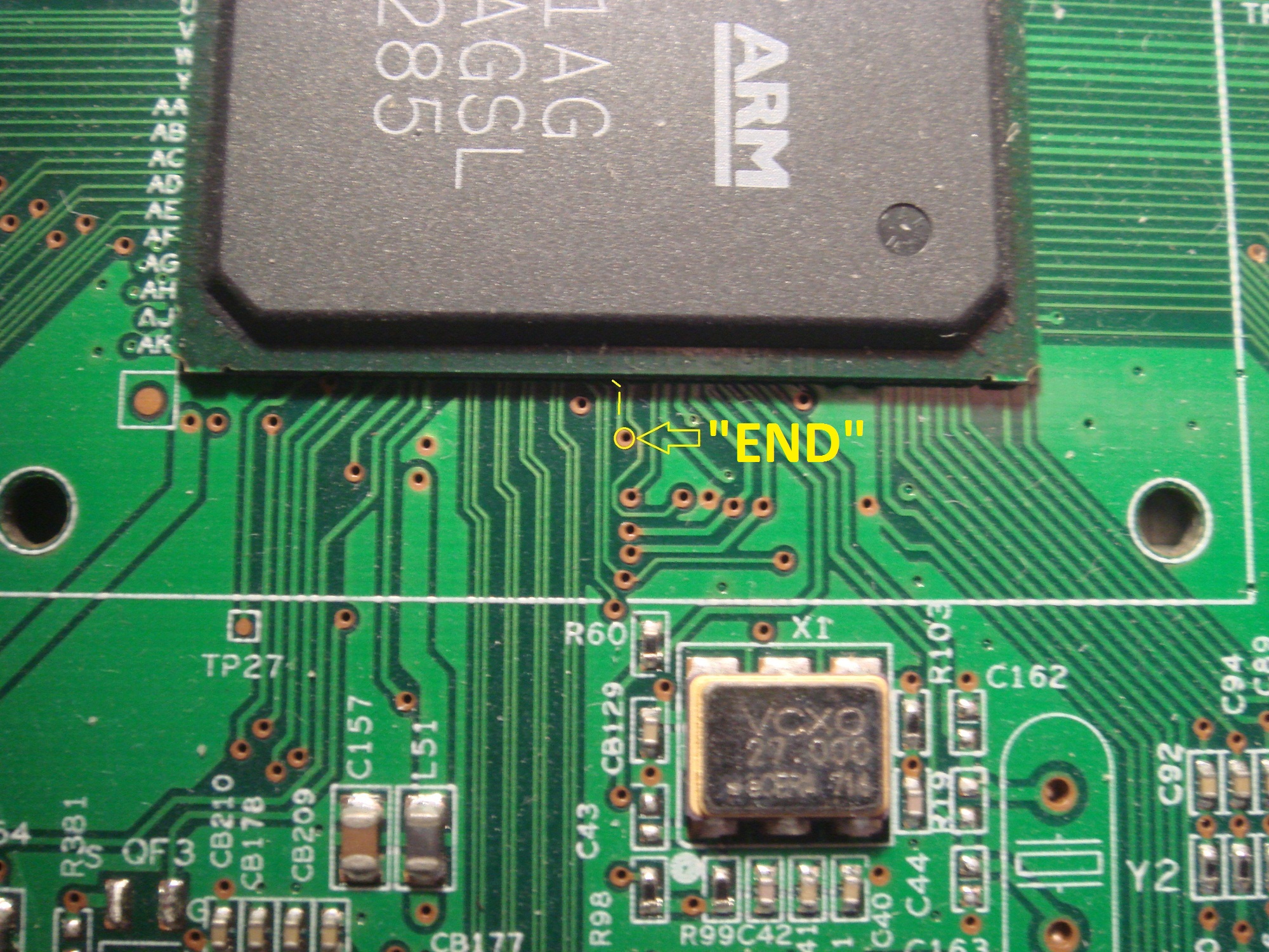

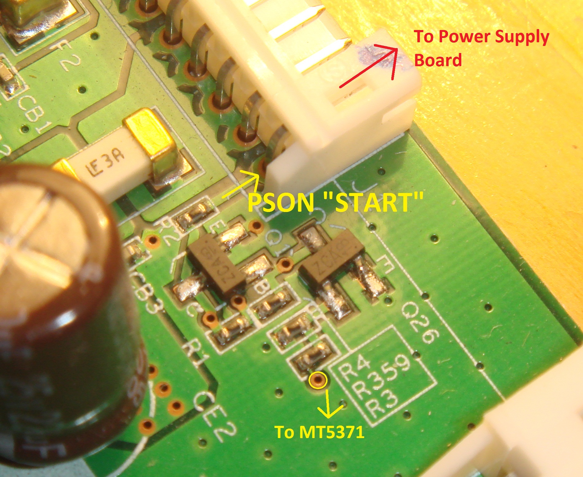

          I traced PSON from the the "start" at the jumper pin location to the the "end" at the main chip on the board (MediaTek MT5371). I have attached a hand drawn schematic. If you cant read something on it let me know.
          The PSON is connected from the jumper pin to a pretty basic NPN Darlington pair, and from there is connected to MT5371.
          All the resistors are within range of their expected values.
          What readings should I start looking for?
          The service manual has a few pages on the MT5371 which I am currently going through. I will report if I find anything indicating where the base of Q26 is connected, or what value it should be at.
            #65

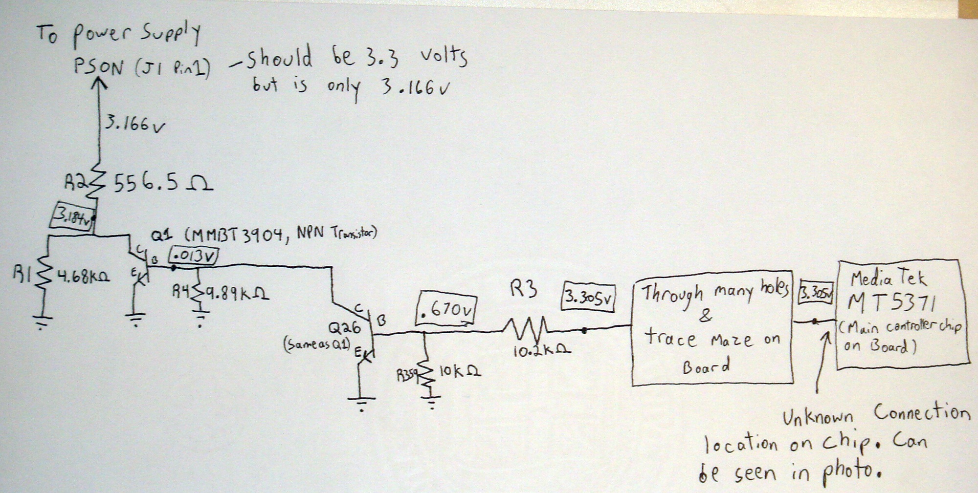

            I just took voltage readings at the various nodes. An updated circuit schematic is provided.
            I am hoping that these voltage values will instantly set off some alarms for someone reading this. I will have to dig out my old Electronics 2 notebook and will attempt to analyze the currents in the meantime.
            The 3.305v at the MT5371 makes me feel confident that I have isolated the problem to this very small portion of the circuit.
            So, ideas anyone?

              The circuit doesn't make much sense; Q26 pulls the base of Q1 low when Q26 is switched on, but what about when it is off? The base has no current to ever turn it on.
              Is PSON naturally high when disconnected from the main board? Otherwise, where does the 3.3V come from?

                Good points. Time for more troubleshooting. Adding a pull up resistor may be the solution.

                  The only thing I can think of is *maybe* it's a prebiased transistor with an internal resistor. If so, I can't see any way that circuit would have ever worked.
                  Maybe the 3.3V comes from the PSU, and this part is faulty?
                  Try tracing the PSON on the power supply - look especially for pull-up resistors.

                    I have updated the photos and schematics to include (what I think are) Vcc's now. I have also attached a simplified schematic (just showing the relevant voltage nodes) with voltage measurements for when the system is turned "off".
                    There are two through hole traces that I am pretty sure must be the Vcc's for the transistors. It looks like tom66 is right that when Q26 receives the 3.305v from the MT5371 it pulls the base of Q1 low. Pulling the Q1 base low pulls up the voltage at Collector 1 from .014v to 3.184v. Is this correct?
                    I have been having a real hard time finding out what the Vcc's are connected to though. I have swept a whole bunch of the board using the continuity measurement on my multimeter, but have not found any connections. I have been thinking of making a test probe device out of a metal wire brush soldered that I could use to check for continuity on large portions of the board, and then from there further localize it. Thoughts?

                      No; there must be a resistor there, not just a trace to Vcc, otherwise the transistor will short the rail when it turns on (and it will melt.)

                        Is it possible that the pull up resistor is located at a different spot on the board? I have no idea what the traces I labeled as VCC are connected to. Could there be the pull up resistor at the exit hole and then the connection to VCC?

                          Yes, but it would be rather strange. Is there any continuity between that node and the 3.3V or 5V rails?

                            Actually that may be the reason the exit hole is so hard to find. If my input to that mystery hole were connected directly to a voltage supply, I figure it would be relatively easy to find since it would probably be coming off a chip / covering a large area / connected to multiple things; however, if the pullup resistor were at the exit to the mystery hole, there would only be a really small area (one side of an SMD resistor) that would register as showing continuity.
                            How does this logic/reasoning sound? Is there anything I should try before extensively attempting to find continuity to the two mystery holes? Which mystery connection should I be more concerned with? I am thinking the one that is connected to Q1, since it is the one closer to the incorrect low voltage. Any general areas of the board I should look to try and find the exit to this hole?

                              I'm beginning to think you've got a prebiased transistor, but there could be some resistors under the board, or elsewhere on the board. It's possible the signal is used elsewhere i.e. to turn on/off the buck converters, so placement of the resistors elsewhere could be a layout decision.
                              One way to check if this circuit is working is to remove or lift one leg of the resistor from the MLTxxxx to the base, and inject a signal into it via a resistor of similar value. It should be possible to get it to vary from 0-3.3V.

                                That is pretty delicate surface mount work. It is doable, but I would rather try and not do something like that for diagnostics unless it is a last resort, since there would be a high chance of me messing something up.
                                We know that when the base of Q1 is pulled low, the collector voltage goes high. Base 1 goes from .689v to .013v when the TV is turned on, and this makes Collector 1 go from .014v to 3.184v. The base of Q1 is connected to ground through R4 - a 9.89k ohm resistor. What if I were to add another resistor of similar or lower value in parallel with R4 to make the base of Q1 go even lower. If I were to add another 9.89k ohm resistor in parallel with R4, the voltage should theoretically drop by a half - making the base voltage of Q1 be around .006v, then if the voltage at Collector 1 rises at all, we will know that the problem resided with Q26(or its associated resistors).
                                If the voltage at Collector 1 does not rise, even with its base value being halved, then we will know that the issue has to do with whatever VCC is supplying Q1 not being high enough. The only problem I see with this test is putting twice as much current through the collector of Q26, in order to half the voltage at Base1.
                                The only other thing I can think to do would be to somehow find out whatever is connected to the mystery hole that is providing voltage to Q1, and seeing if I can diagnose anything from that end. If I were to do that would there be a method to finding out where it is connected, or just do random continuity tests on everything on the board?
                                All the help everyone has provided me has been hugely appreciated.

                                  I don't think 0.014 vs. 0.006 is going to matter to the transistor. And 3.184 is enough to saturate the transistor, provided the base resistor is not too high.
                                  Try tracing that hole - it is going to involve random probing unfortunately, unless you have a schematic.
                                  There is also the possibility that some component on the power supply is dragging down this voltage, although it would be a rather strange failure.
                                  If you get tired trying to fix that circuit, you could always wire up a pair of logic inverters on a little piece of stripboard to replace them. Make sure the inverters support a ~1.5V DC input.
