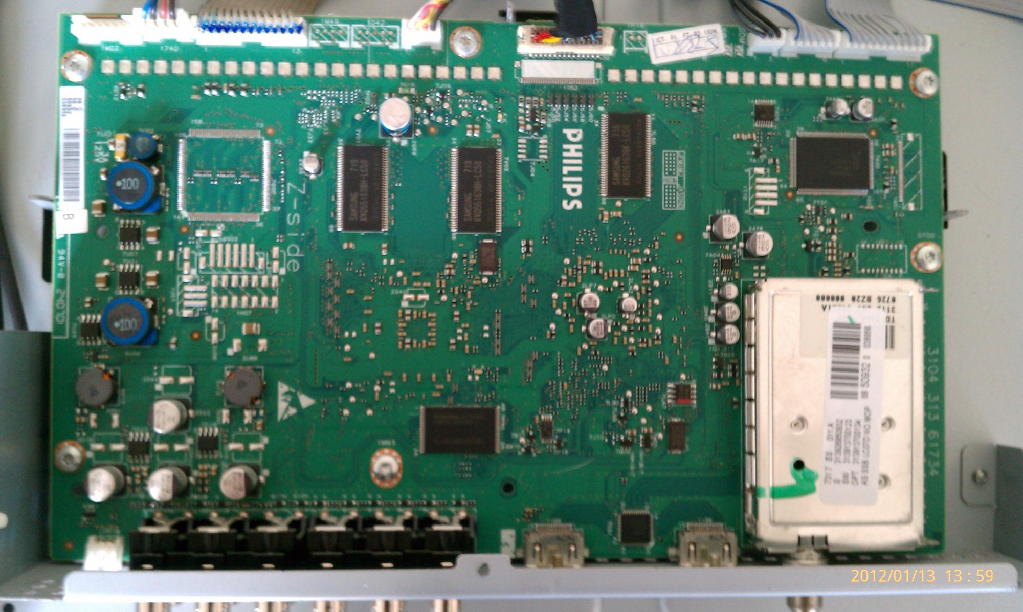

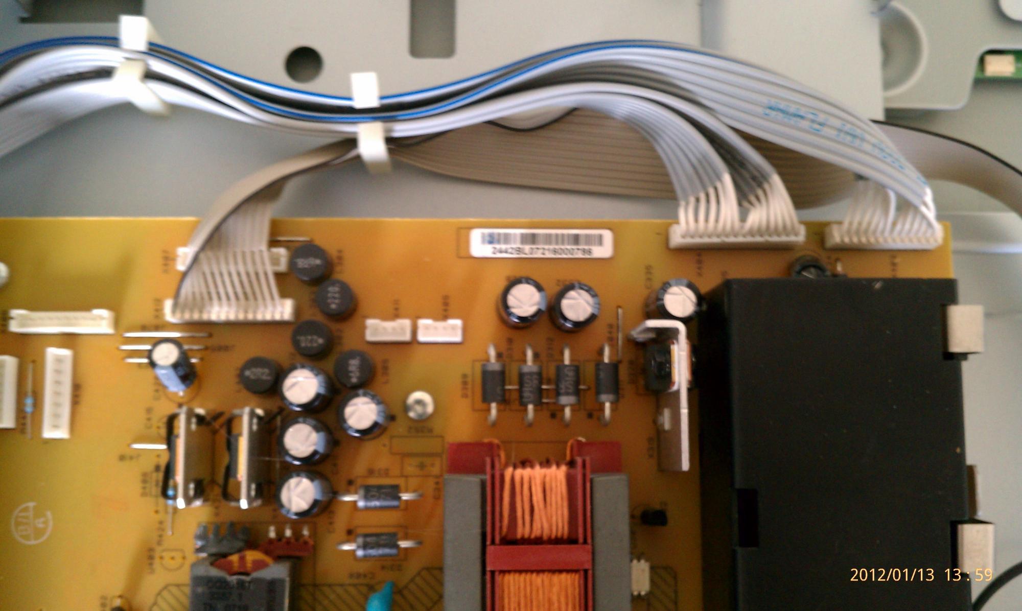

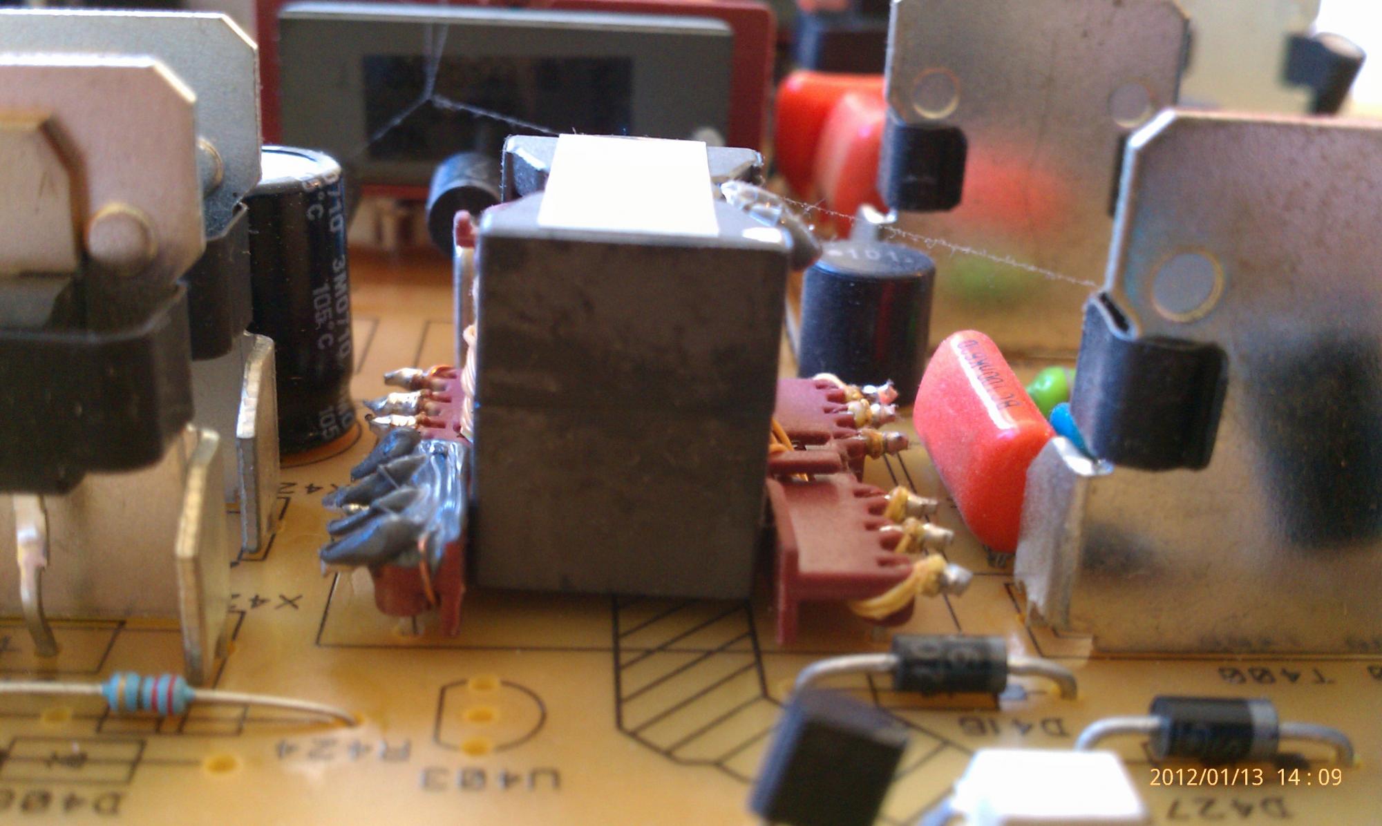

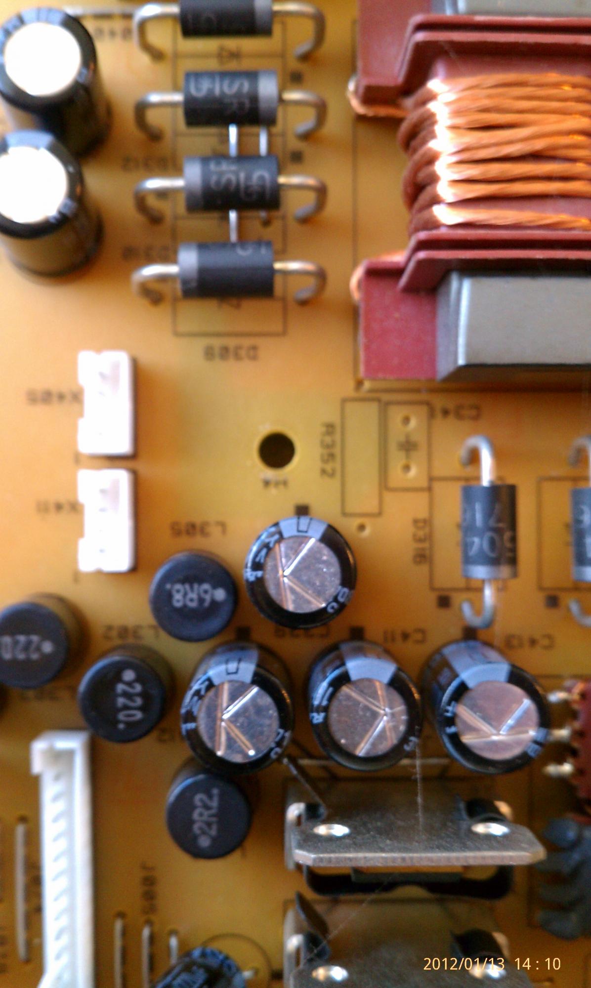

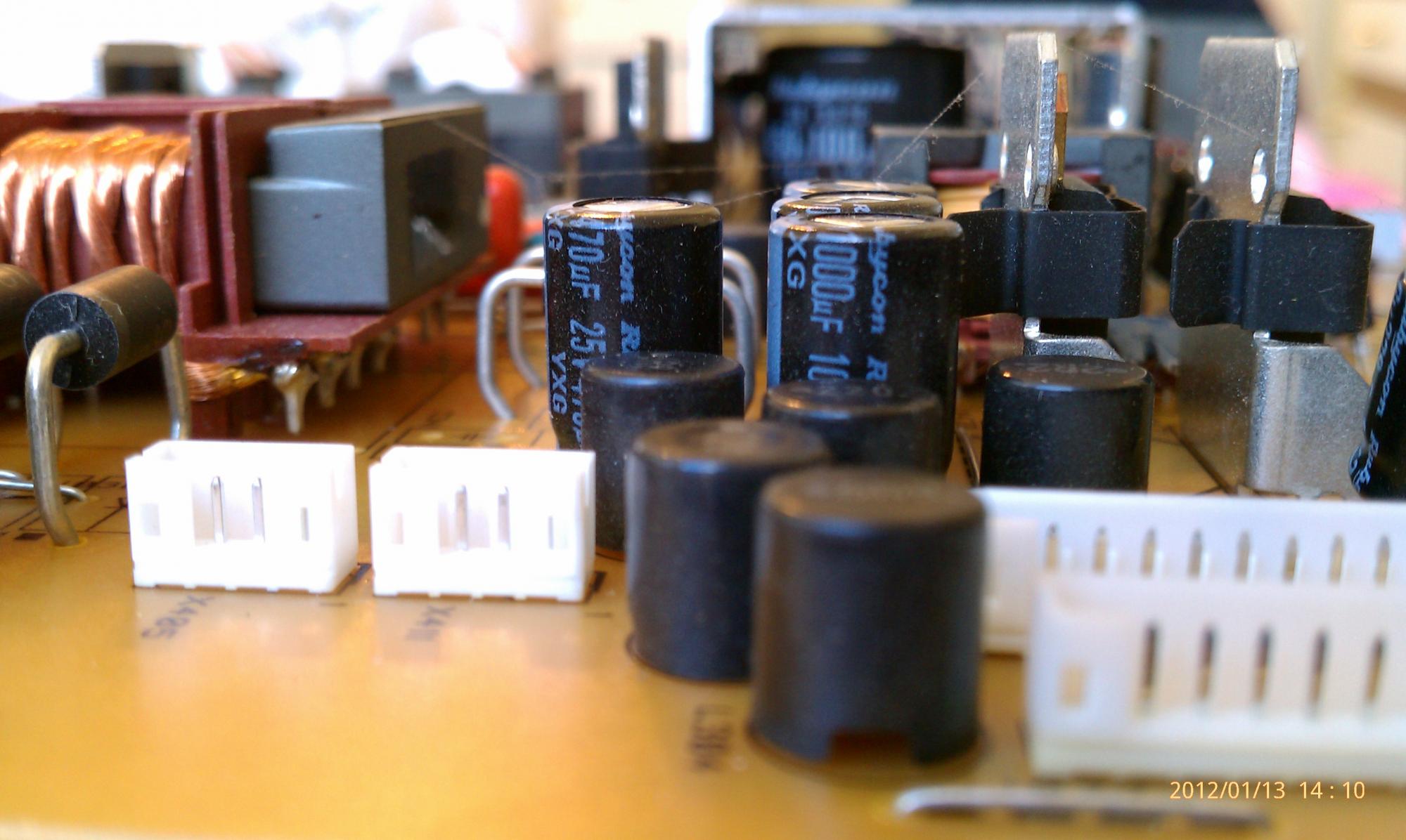

    Normally, we don't see too many bloated caps on the main/logic board, but you have 4 which suggests the caps are really poor quality brands and/or the TV runs really hot.
