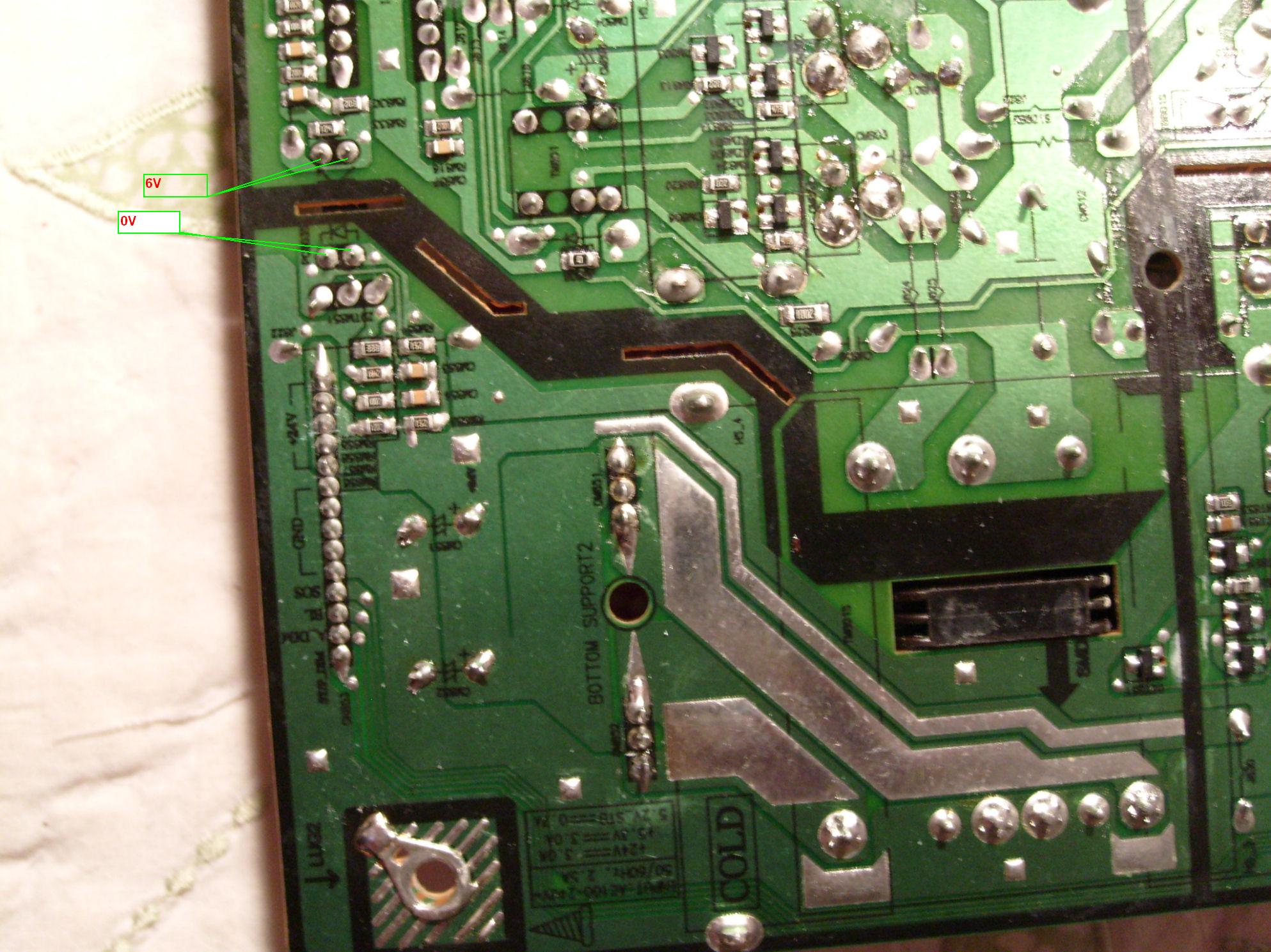

    I recently acquired a 245BW with a no picture issue.
    Took it down and did a thorough visual inspection on the PS finding an open (burnt in the center) resistor (RM801).
    That didn't fix it so went on to voltage checks.
    Found that 24V was not reaching the output connector.
    My question is: with 6V reaching the opto (PC803S), shouldn't I be seeing something besides 0V on the other side?
    I suspect a toasted opto and am simply looking for confirmation/guidance from someone with more experience in these matters.
    Thanks in advance,
    Sam

          I'm looking at 6V on the input side of the opto (PC803S) and 0V on the output side. If the opto is fully functional, what approx. voltage should I be seeing on the output side?

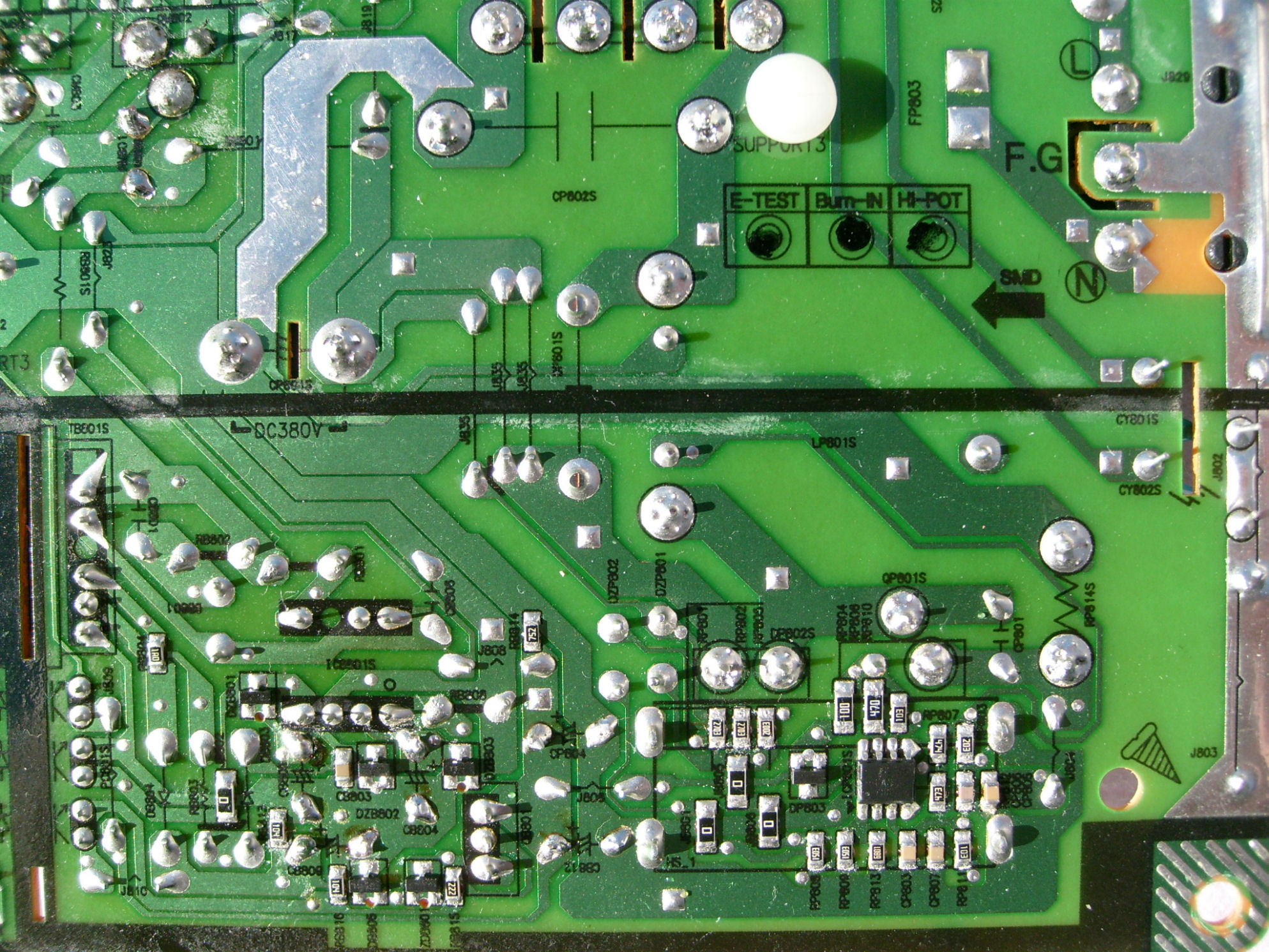

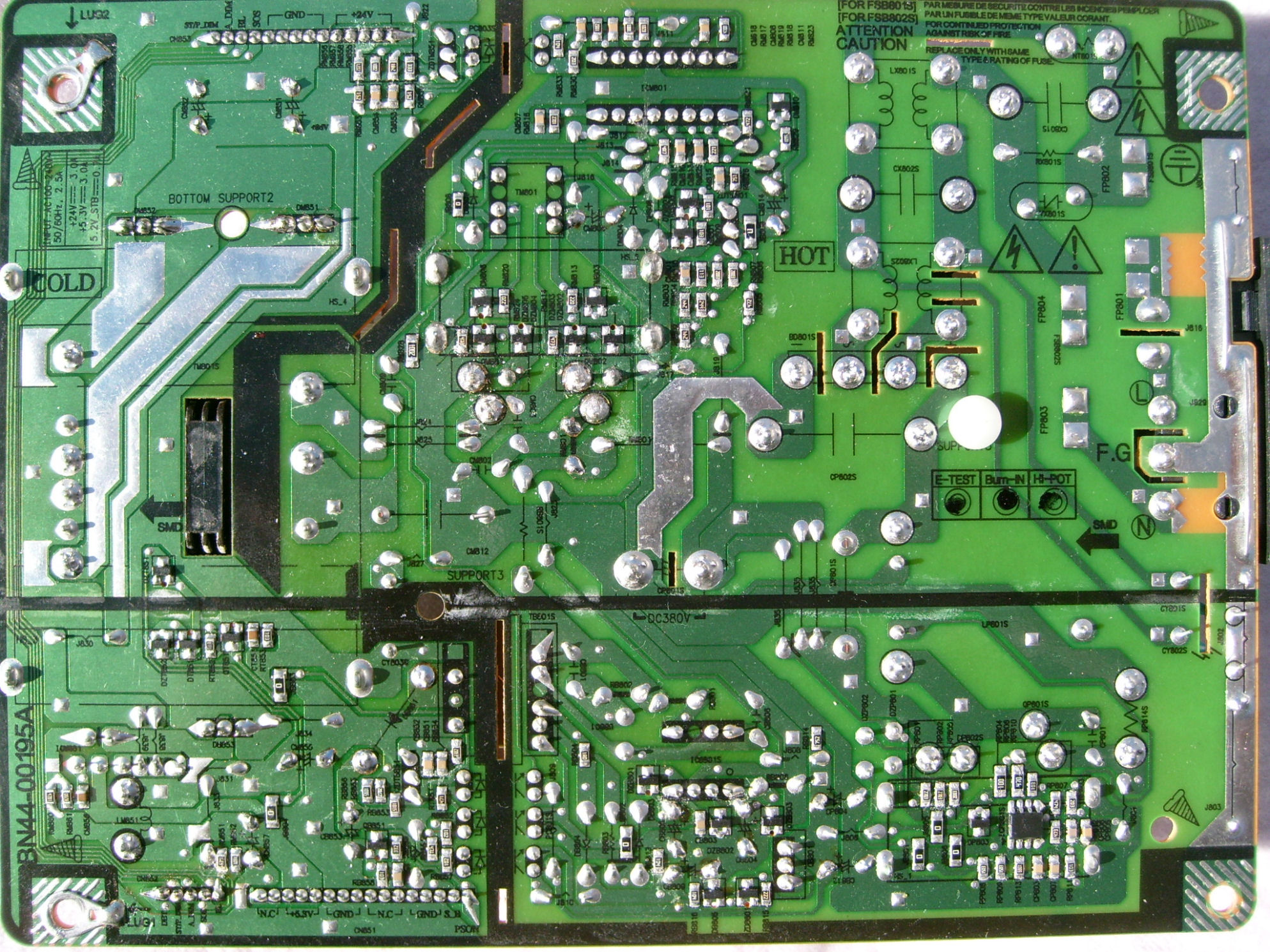

                Which opto is PC803S? This board has four. Two are obviously for regulating the main and standby supplies. One should switch the main (24 volt) supply on and off. You should be looking at the voltage across the input pins and using that to figure out what the output should be.
                PlainBill
                • Sam I Am
                  • Jun 2010
                  • 115
                  Re: Samsung 245BW
                  See pic #4.
                  • PlainBill
                    • Feb 2009
                    • 7034
                    Re: Samsung 245BW
                    Originally posted by Sam I Am
                    See pic #4.
                    That appears to be the feedback (regulation) for the 24V supply. Those voltages could be normal for a SMPS that's being held in shut-down.
                    PlainBill

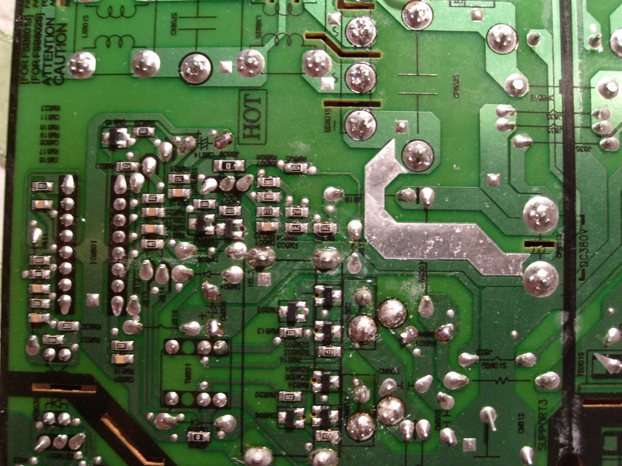

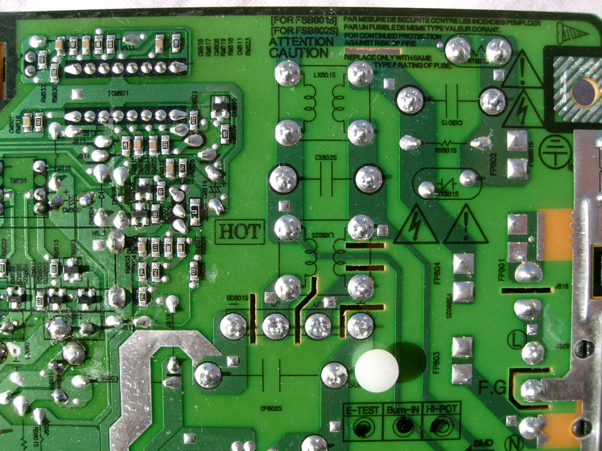

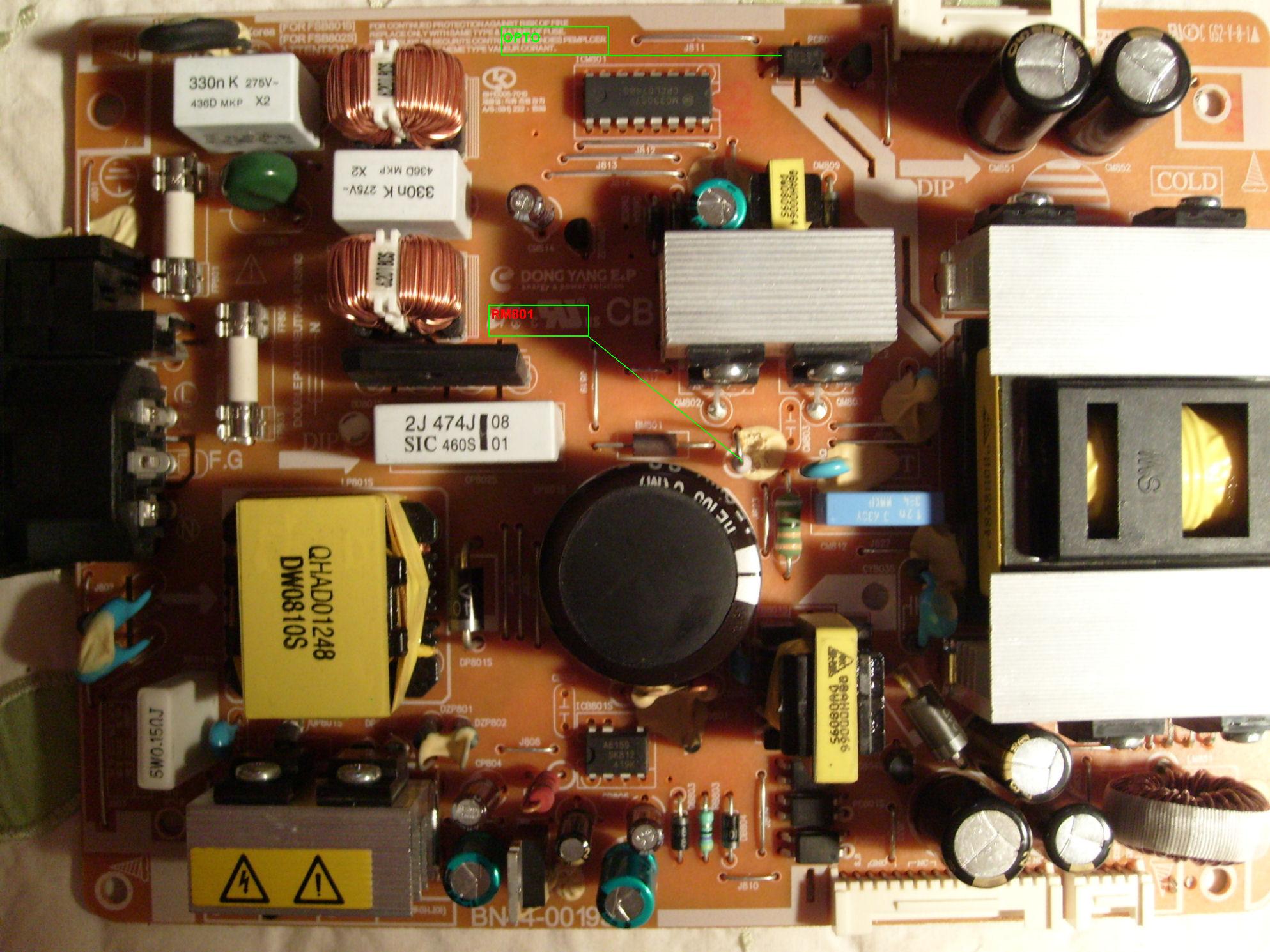

                        Now lets look at the problem from my end. What do I have to work with? A few fuzzy pictures. Even the rudimentary information available from the connectors is unreadable. So I say 'Screw it!!'. If someone can't be bothered to provide useful pictures, I'm not going to waste my time.
                        PlainBill
                        • Sam I Am
                          • Jun 2010
                          • 115
                          Re: Samsung 245BW

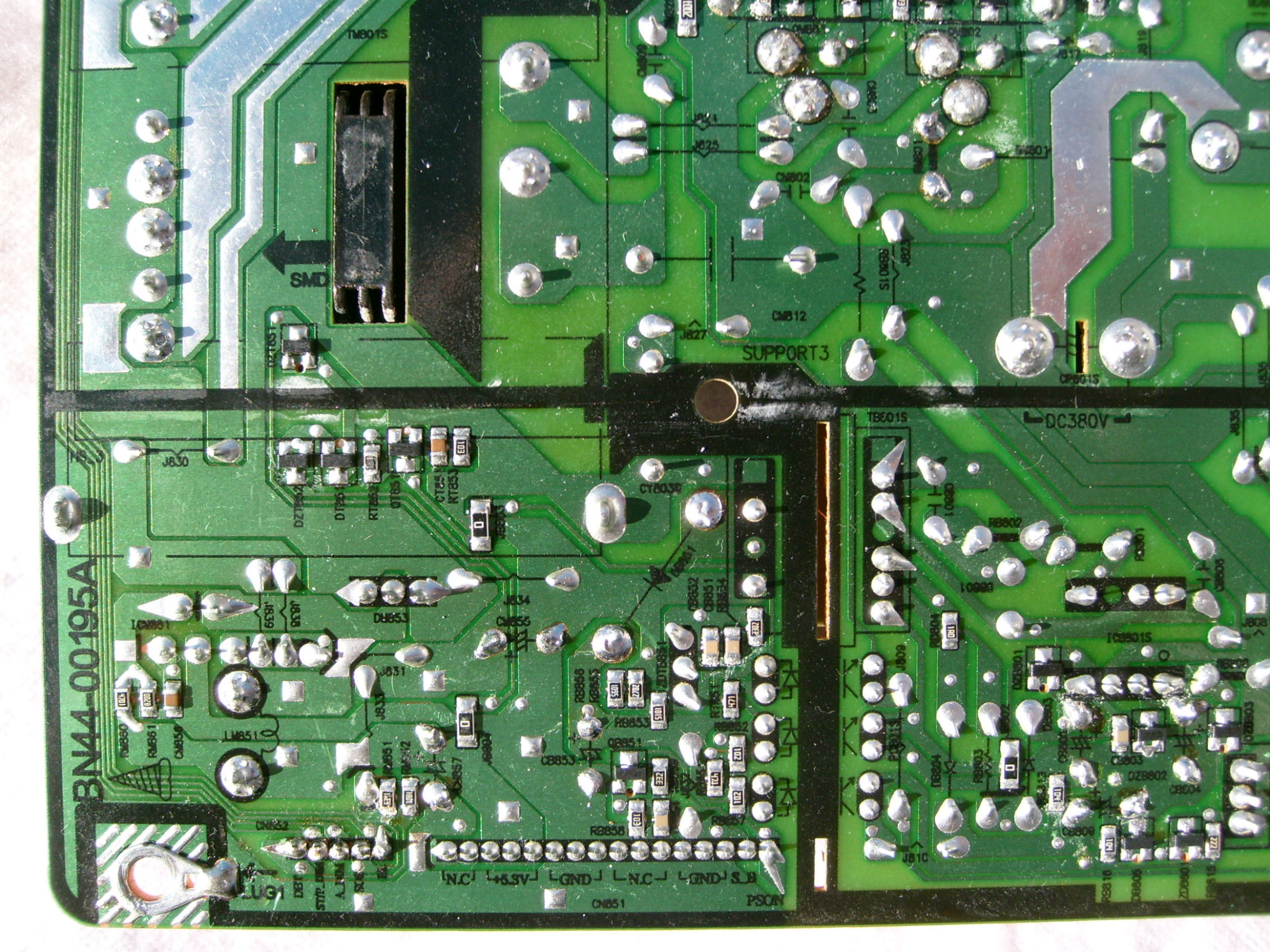

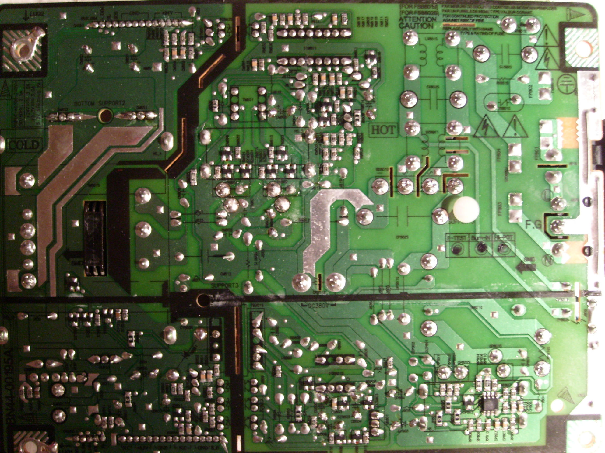

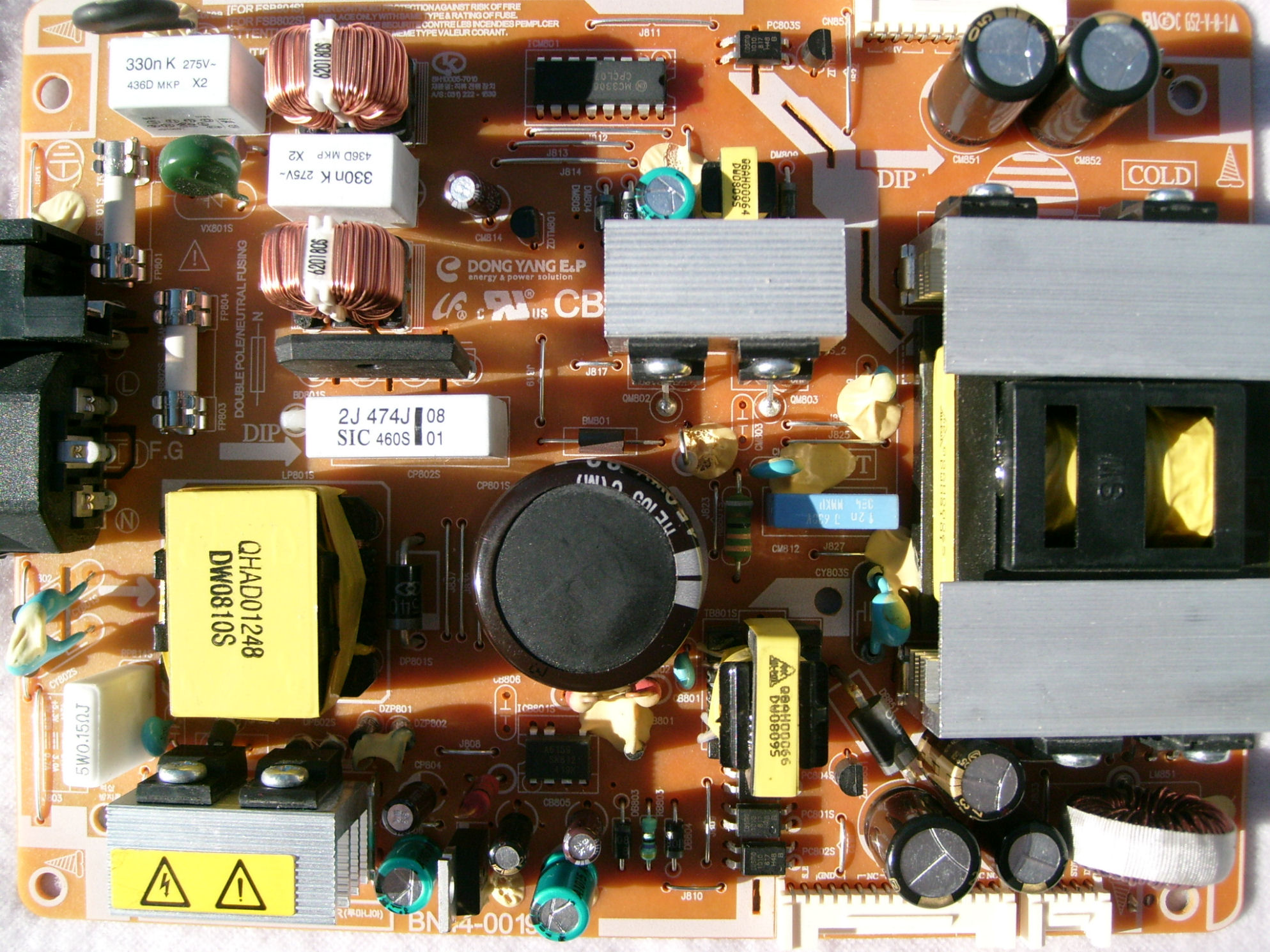

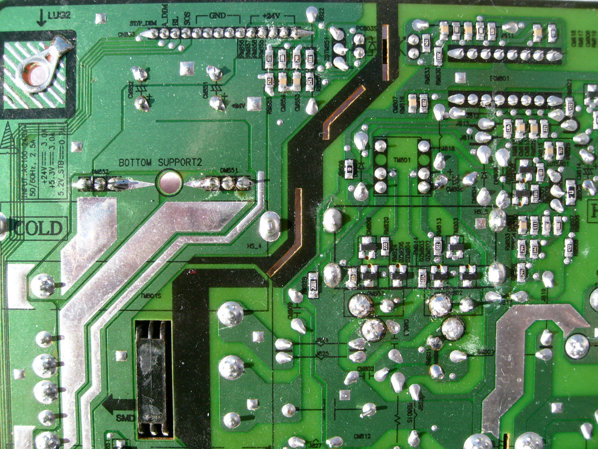

                          Sorry about that.
                          Ask and ye shall receive... I always say.
                          Here is the front, back, and four quadrants of the back.

                            On CN851? the last two pins appear to be S_B and PSON. Does either change state when the TV is turned on?
                            If either does, do the voltages across pins 1 and 2 of the three optoisolators in that area also change?
                            What is the part number for ICM801, the 16 pin IC?

                                Well.... this is about the best I can do at the moment.
                                As far as the voltages:
                                S/B is 5.2V off and 5.2V on
                                PSON is 0V off and 3.2V on
                                Opto (PC802S) closest to CN851 at Pin #1 is 5.2V off and 1.2V on
                                Pin #2 is 4.6V off and 60mV on
                                Next Opto (PC801S) at Pin #1 is 4.9V off and 4.9V on
                                Pin #2 is 3.9V off and 3.9V on
                                (Both of these voltage readings dropped a few mV when cycling from off to on)
                                Next Opto (PC804S) at Pin #1 is 5.2V off and 5.2V on
                                Pin #2 is 4.5V off and 4.6V on
                                (Both of these voltage readings dropped significantly when cycling from off to on before settling at the above readings)

                                  ICM801 shows MC33067P. See attached.
