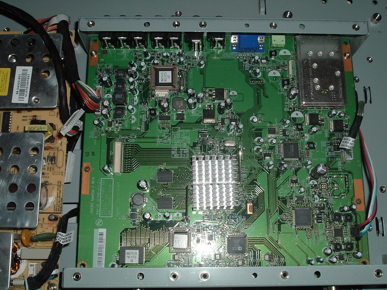

              Unfortunately, the new mainboard worked same as the old. Same exact thing keeps happening. No difference at all. Even tried flashing the new mainboard, but it was to be in vain.
              I am completely stumped. Unless there is some logic on the mainboard that senses anything out of tolerance with the inverters and/or the display driver board, there's nothing left to replace! ARRGHH!!!
              Does anyone know if it's possible to have a bad component on either the display driver board or the inverter board(s) and still have the TV come on and display just fine, but be out of whack just enough for the mainboard to sense an error and lock up the display like this?

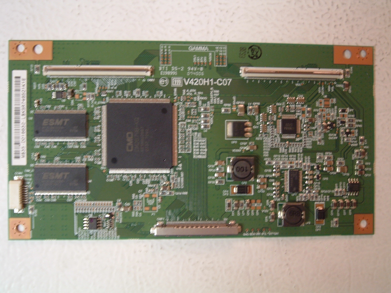

                                I have recently started to get a lot of Westinghouse TV's recently. This problem is sounding like it may a Tconn board problem. If you search ebay with your set's model number, you'll find a board for 18.95 with free shipping. This is the best advice you can get without providing pictures of anything.

                                  So you think a bad Tconn might be making the mainboard react in such a way?
                                  Just out of curiosity, could you enlighten me as to why you think this? Trying to learn here.

                                    Hi Dgtech - just bumping this thread to get your attention. I was hoping you could enlighten me on your last. Thanks.

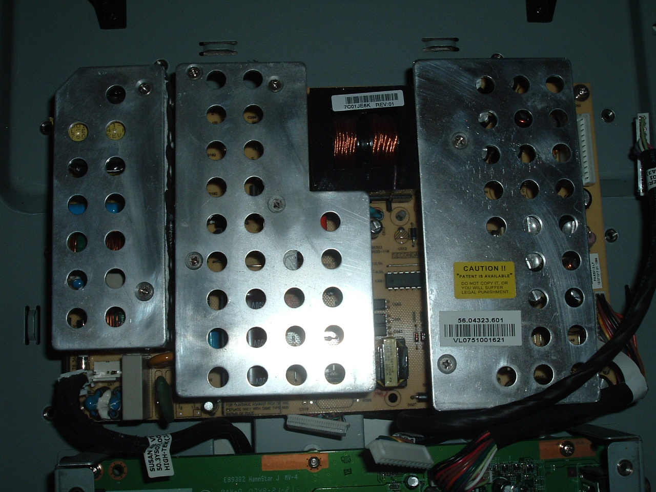

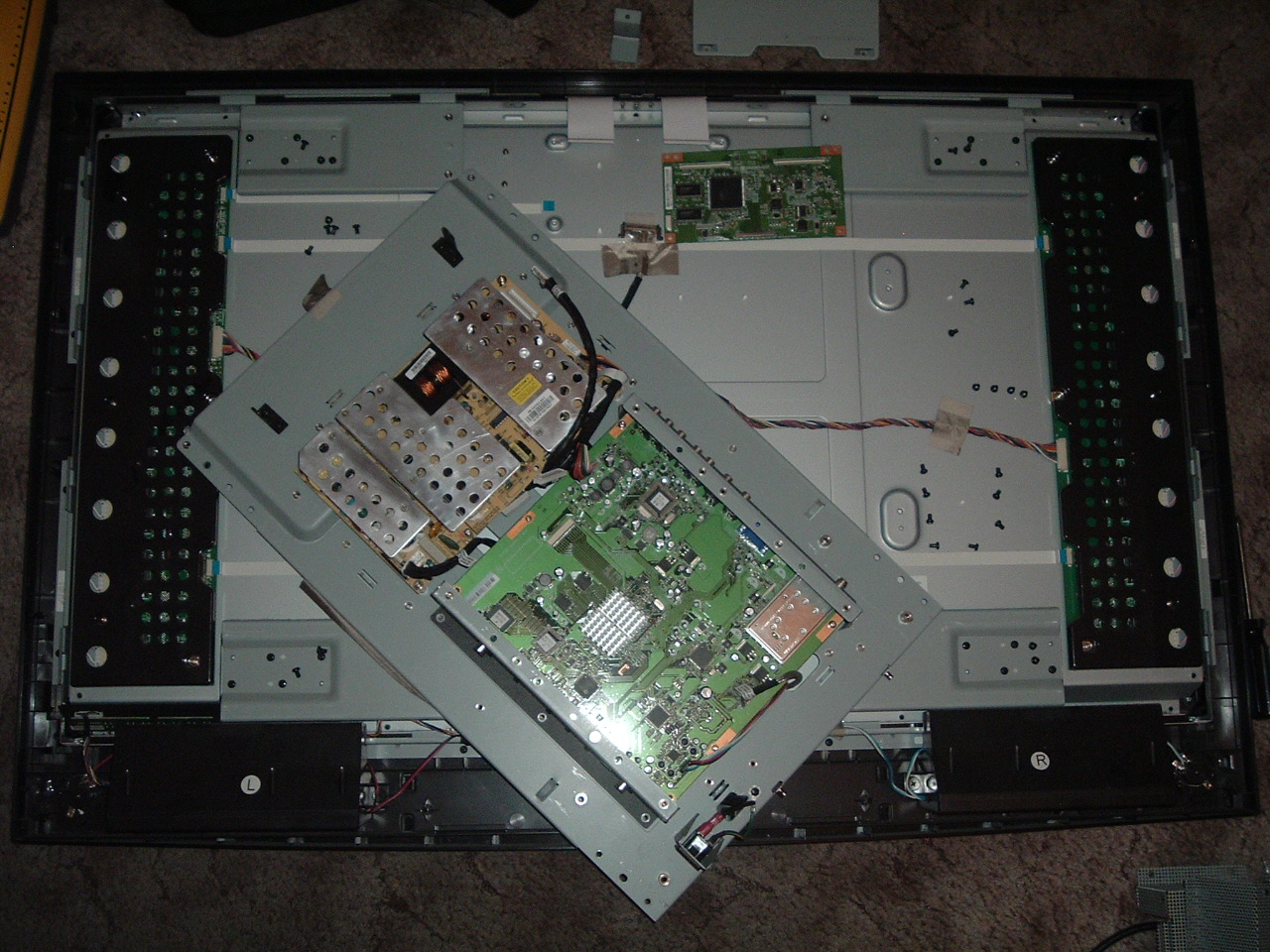

                                      Pictures of the boards would really get you better and faster responses....you may feel that because there are no physical signs of failure that pictures shouldn't matter. The people who want to help you can get a better understanding as to what the layout of your TV is, as they are not all built the same. Just trying to help.
                                      • stevekasian
                                        Old N00b
                                        • Dec 2010
                                        • 182
                                        • USA - West Side!
                                        Re: Westinghouse TX42F430S 42" 1080p LCD TV
                                        As requested:
