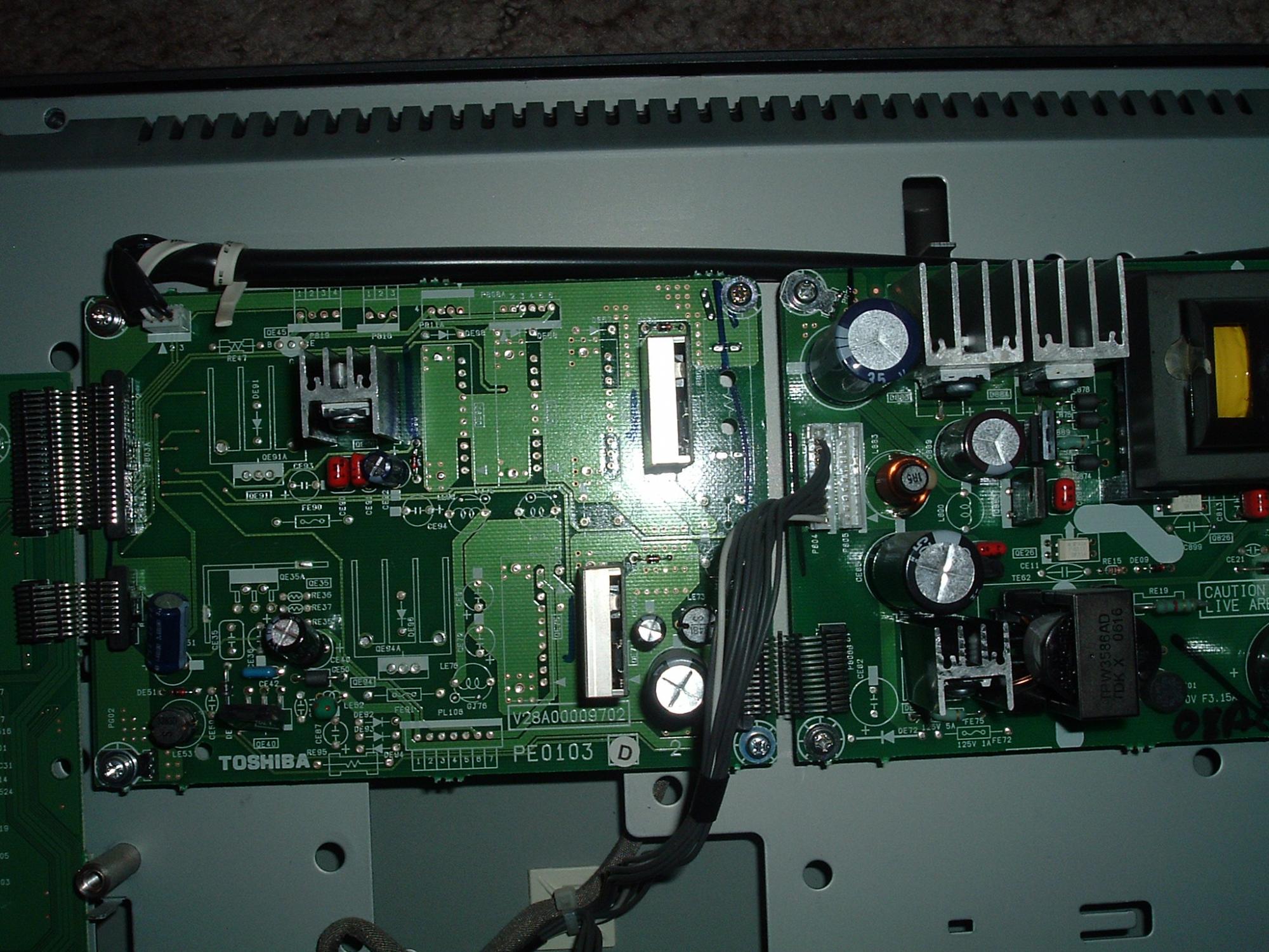

    Pics? Please post using manage attachements.

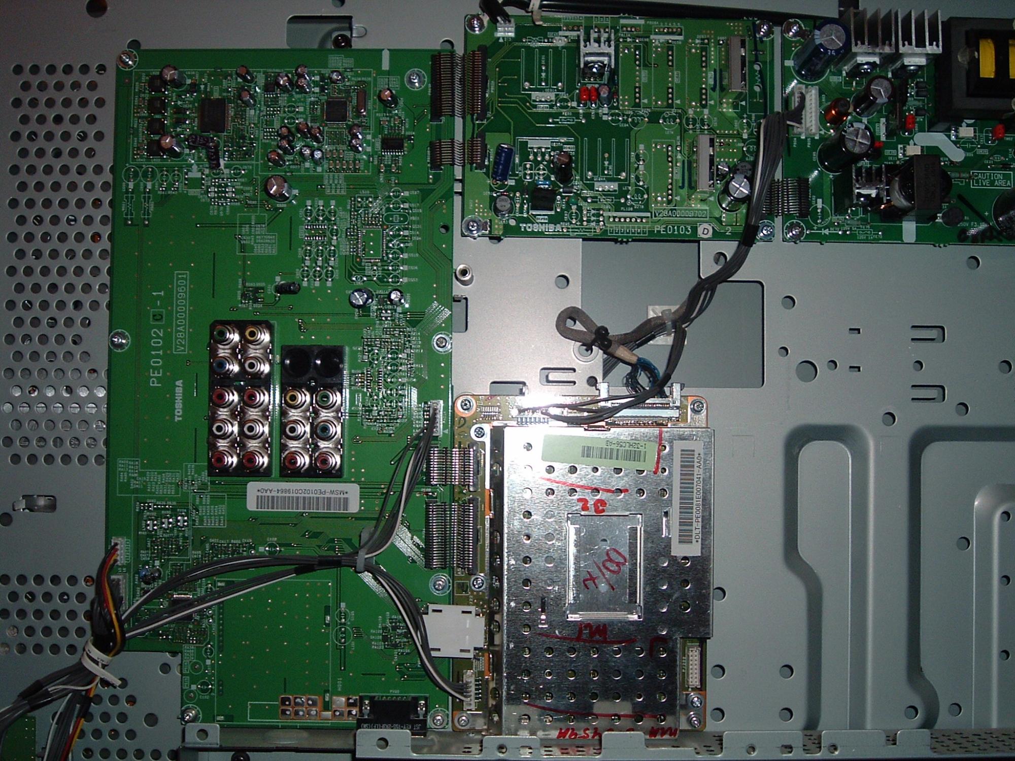

        We generally want to see an overall pic showing how all the boards are connected. Then we want an individual pic of each board.

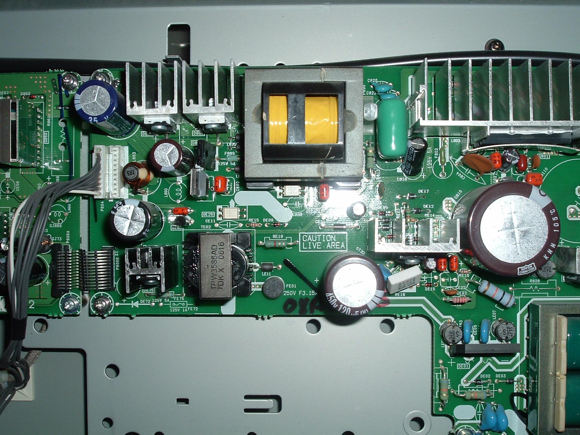

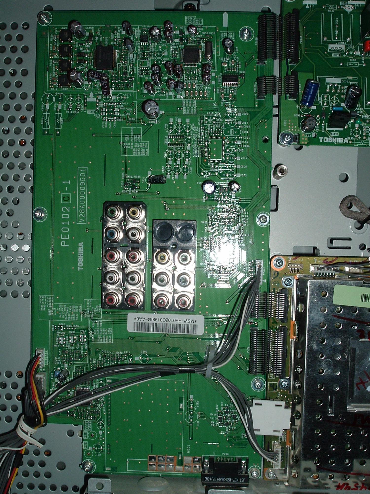

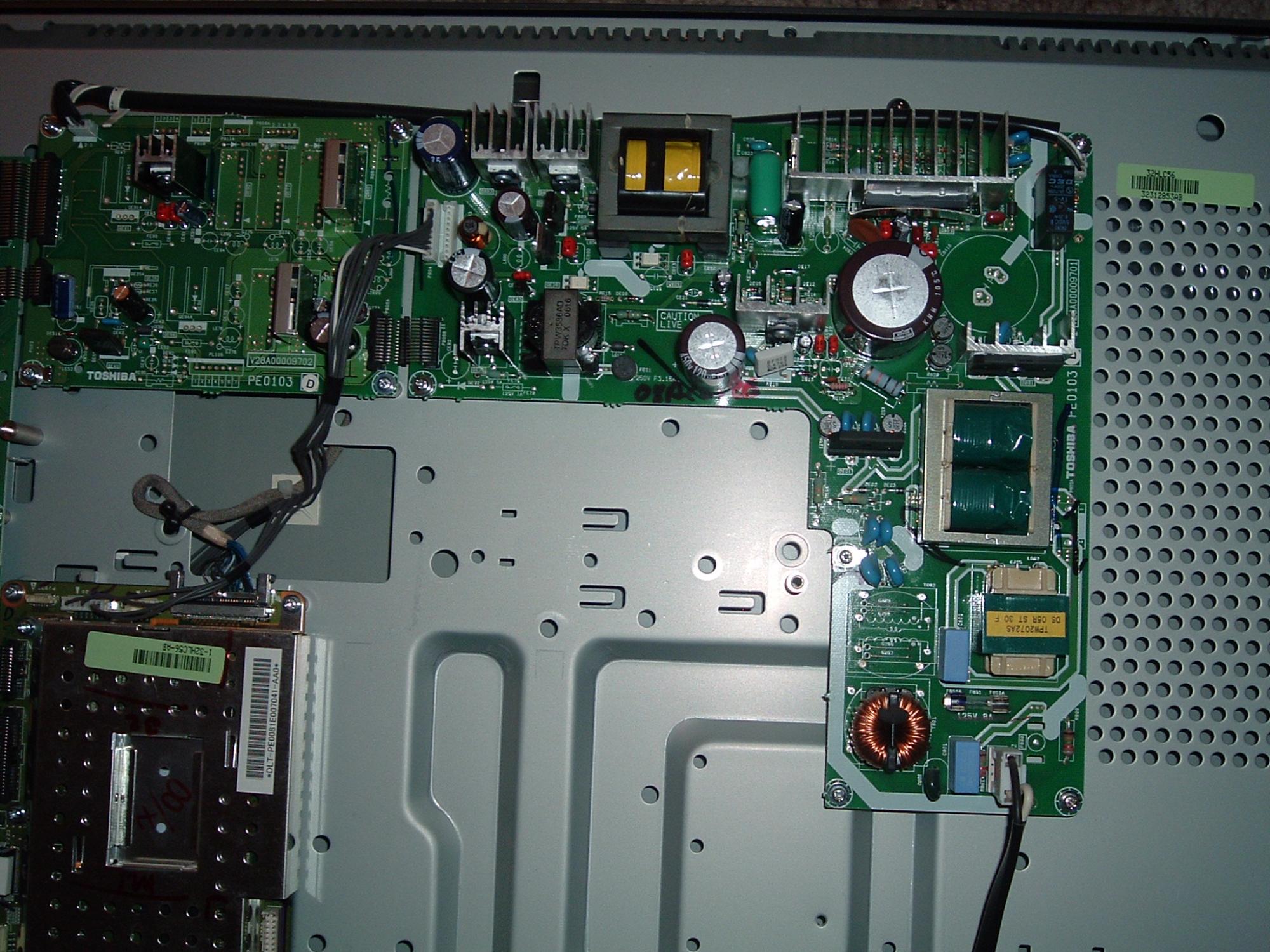

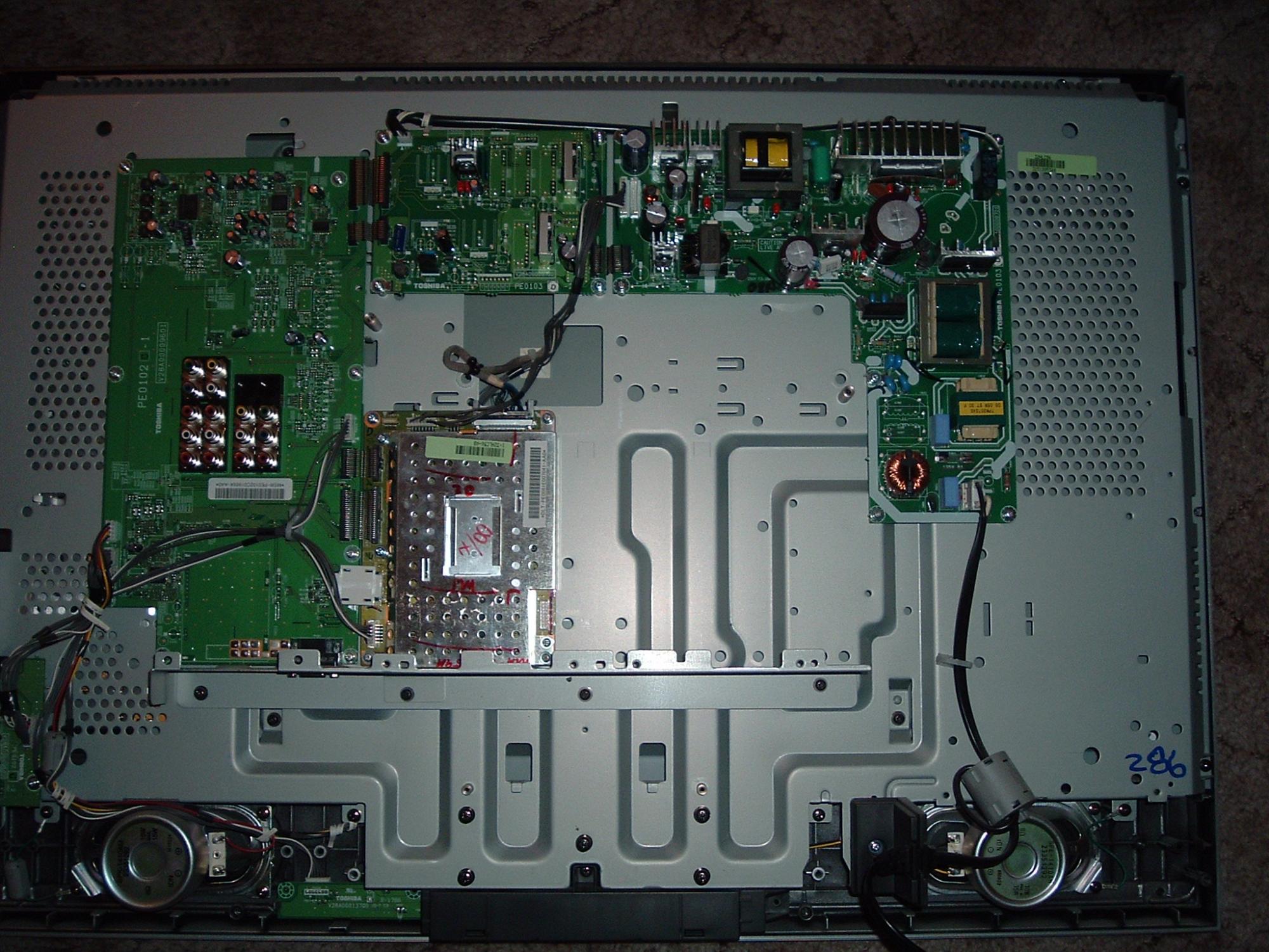

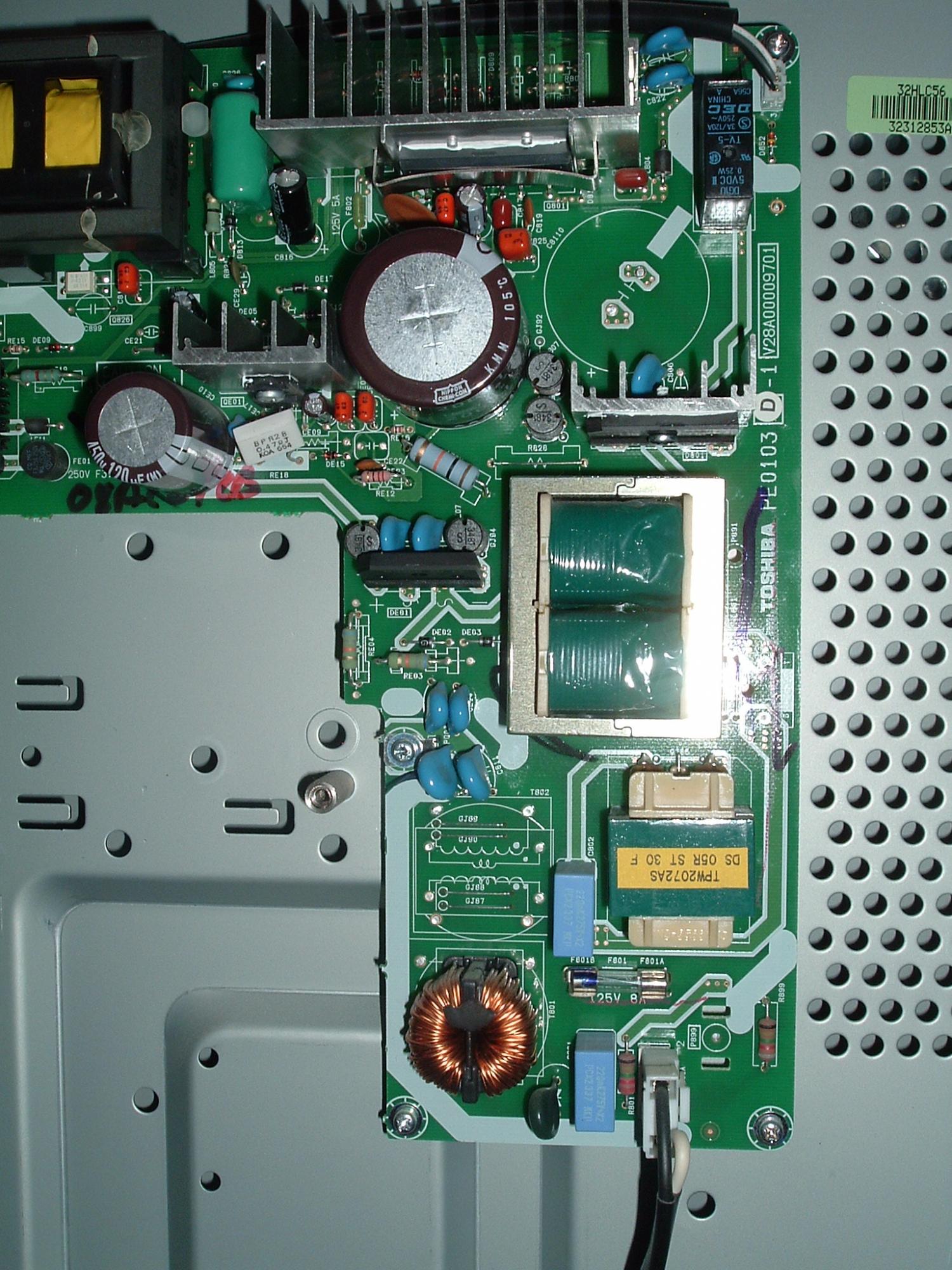

          Re: Toshiba 32HLC56
          Ok. Thanks.
          Here is an overall layout and some closer shots of the boards on one side. I'll post some of the opposite sides of the boards as soon as I get them off (unless I shouldn't remove them all just yet - please advise).
          It is woth noting that the screen just shut off one day and never came back on, except for the little .3 second lighting of the backlight at power-up. No intermittent problem before hand and it does the exact same thing every time.

            Re: Toshiba 32HLC56
            Check the fuses on the power board first to make sure they all read less than 1.0 ohms.
            I see FE75, F889, F802, and F801 on the power board (upper right). There may be more and check for fuses on the other boards as well.

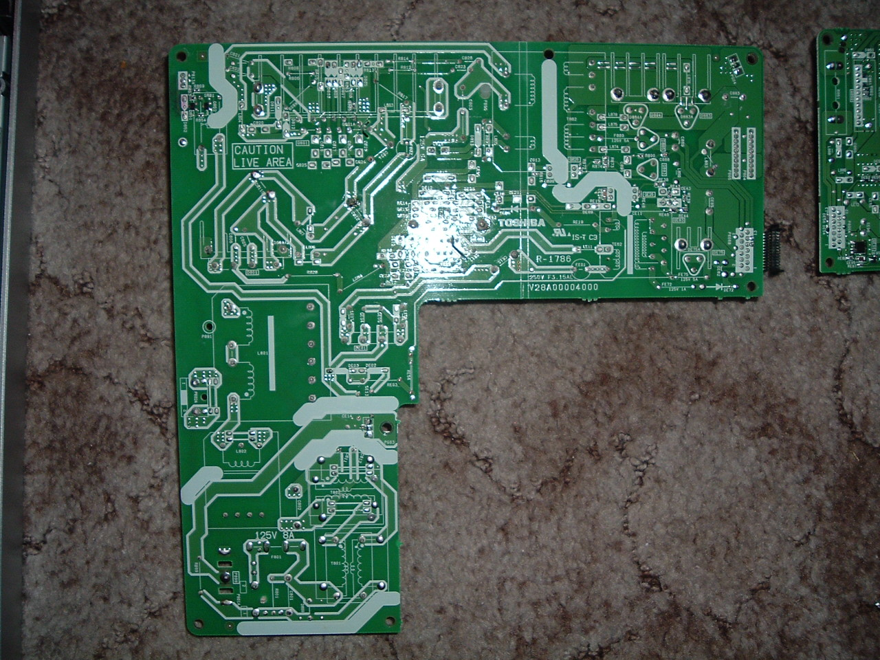

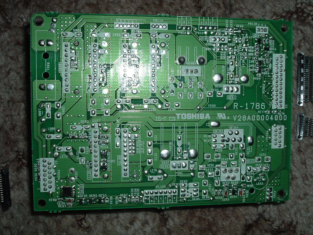

              Re: Toshiba 32HLC56
              Ok. Checked all boards. There was only a main power fuse other than the ones you mentioned. All measure .1 ohm.

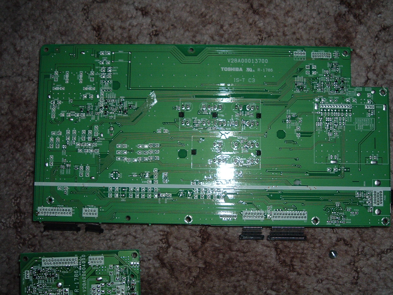

              Here are some picts of the back of the boards. Plz let me know if you would like higher resolution images.

                This sounds like 'two seconds to black', but I don't see any sign of an inverter.
                My suggestion is to hook up a known signal - DVD player or video game - and step through the inputs until you hear the sound from the speakers. See if you can see anything on the screen if you shine a bright light on it.

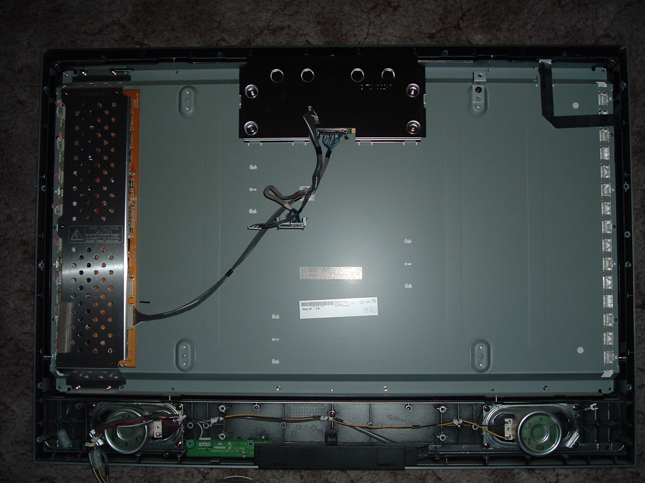

                    The first step would be figuring out where the inverter is, and posting a picture of it. If this is a multi-transformer inverter, a shorted secondary winding is a common problem.

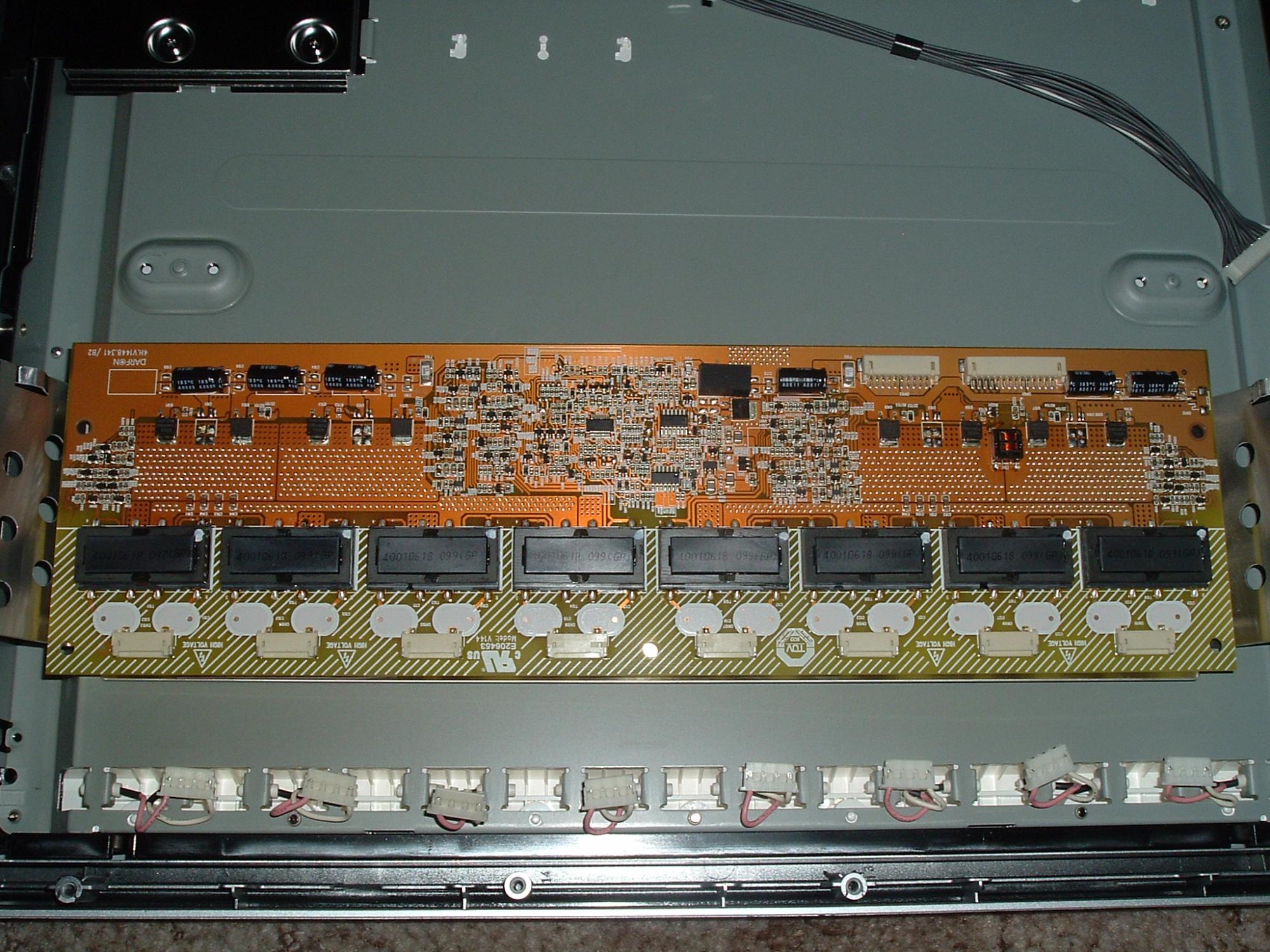

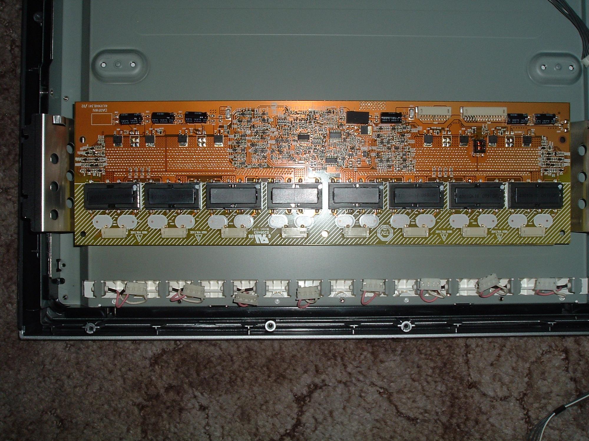

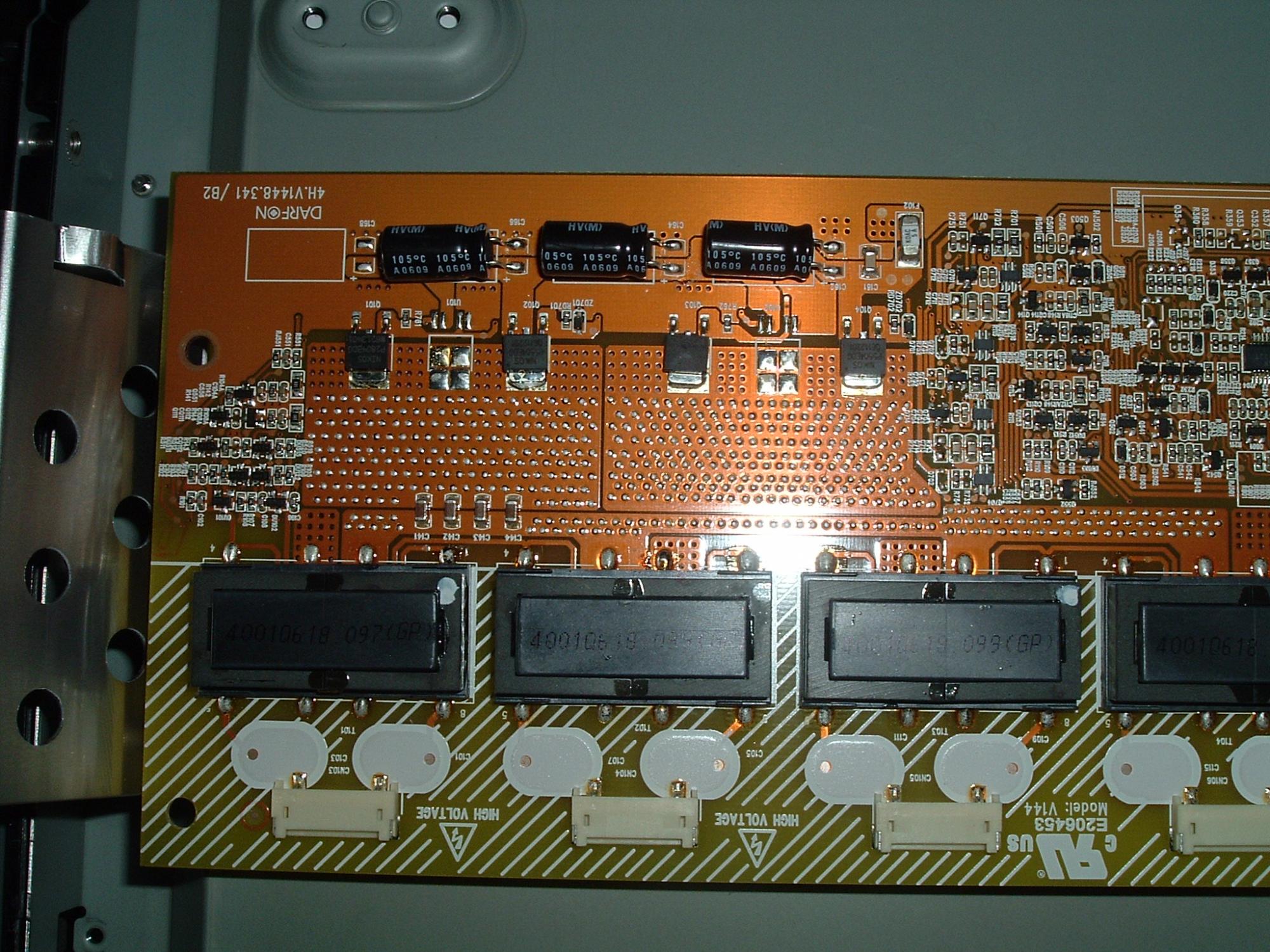

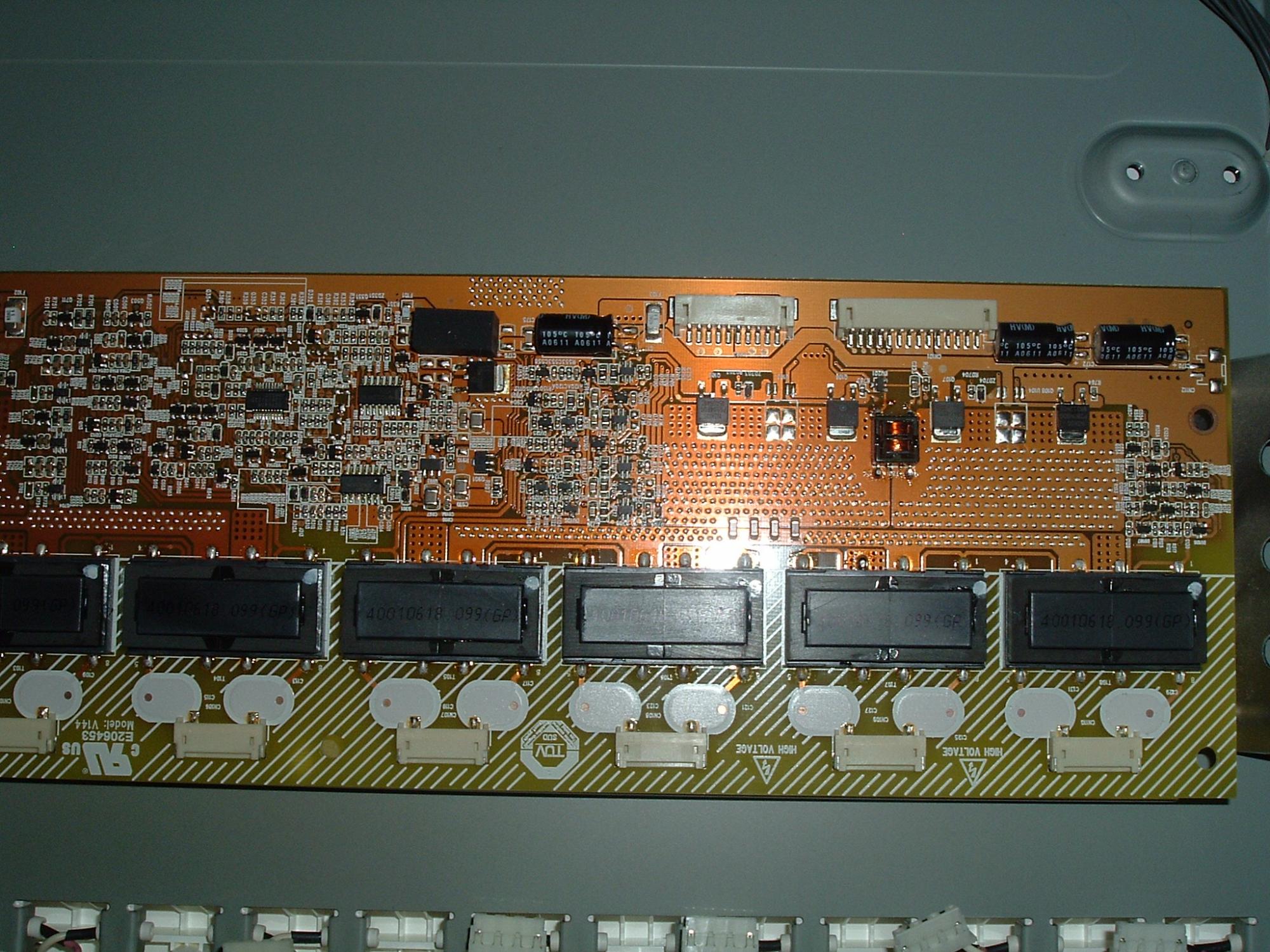

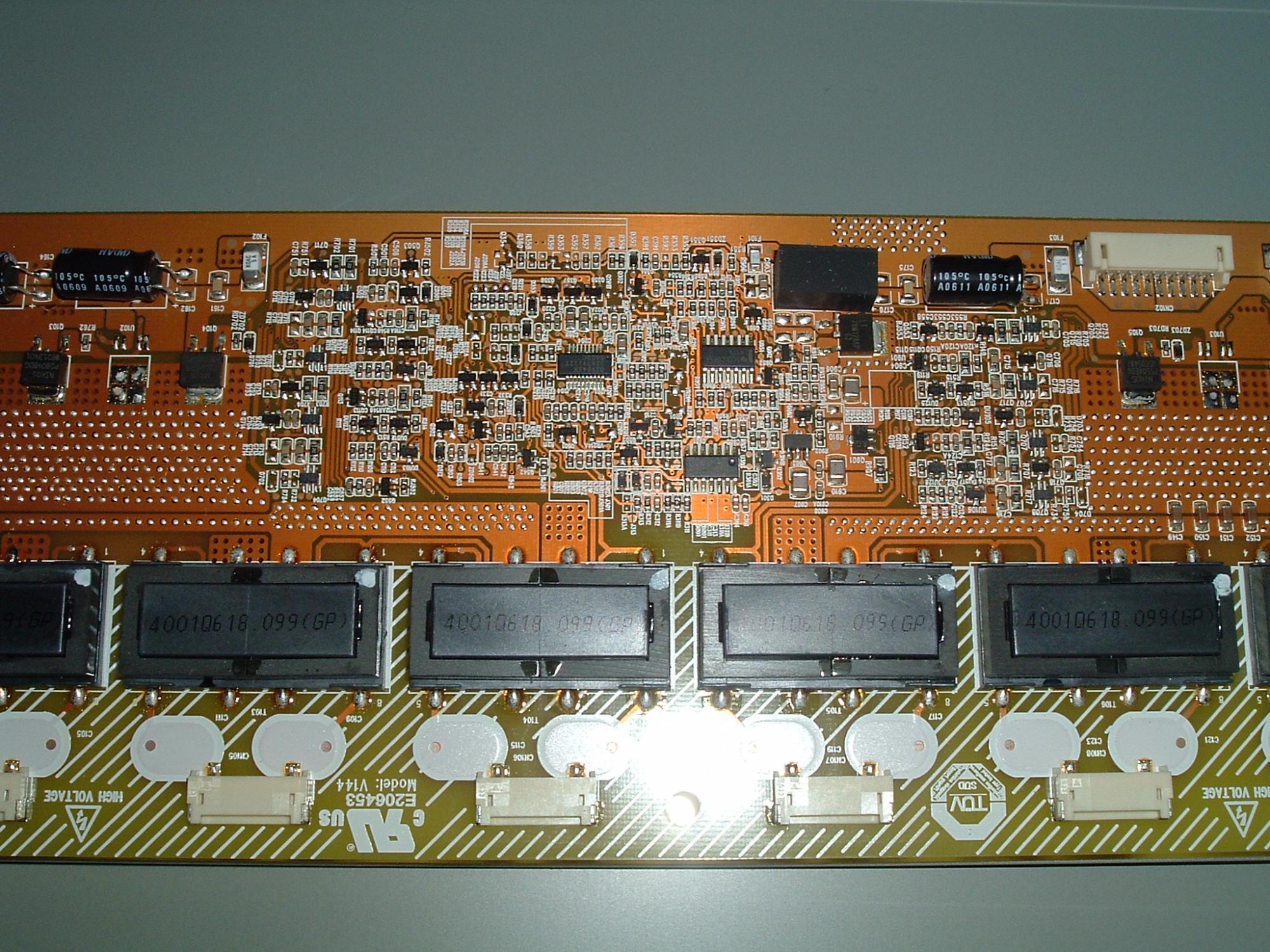

                        Re: Toshiba 32HLC56
                        Ok, found the inverter. Behind the chassis plate the other boards are connected to. Here is a layout pic (not sure what the board is at the top) and some macro picts.
                        Thanks,
                        SK

                          Re: Toshiba 32HLC56
                          With power off and lcd unplugged, check the secondaries on the inverter transformer. I believe you should test S1-S2 and S3-S4 on 2000 ohms (if manual dmm). Test them all and list the measurements here.
                          Secondaries are identified at
                          http://lcdparts.net/TransformerDetai...ProductID=2727

                              Re: Toshiba 32HLC56
                              All transformers check good, except T103. S1 & S2 measures open circuit on all scales.

                                        Re: Toshiba 32HLC56
                                        Thank you for the heads up on that auction retiredcaps! Mucho appreciatado.
                                        I removed the transformer and, sure enough, there is a burn mark in the windings.
                                        I've contacted the ebay seller and we'll see what happens. Thanks again!
