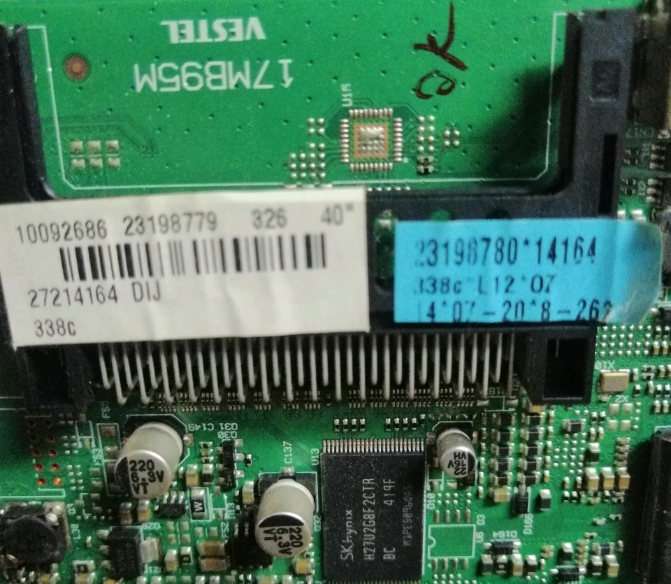

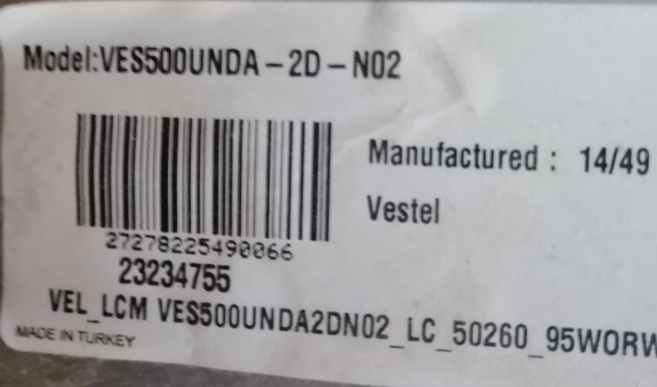

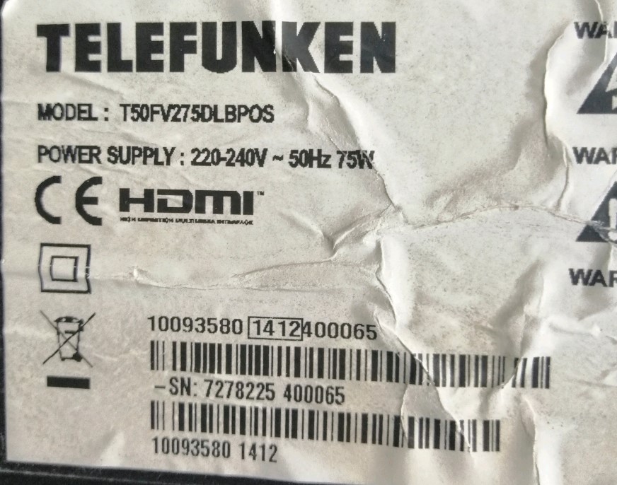

    Hello
    I have a problem with a Telefunken LED TV that only flashes a blue LED.
    No lighting, no sound.
    Someone changed the contents of the 25l1606 flash.
    Do you have complete flash content and NAND content.
    T50FV275DLBPOS
    Vestel 17MB95M
    panel VES500UNDA-2D-N02
    Please give me the steps to solve the problem
    Thank you.
