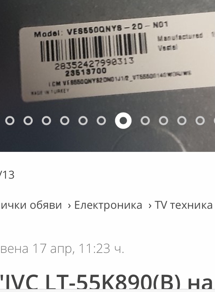

    Re: question for the type of led strip on jvc lt55k890a
    VES550QNYS-2D-N01 matrix

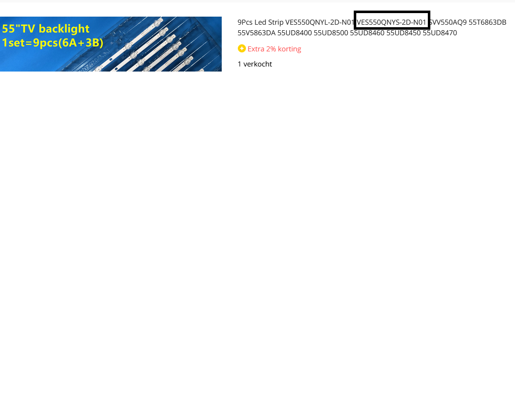

      so sir the packet is this do you agree ?
      https://nl.aliexpress.com/item/40000...yAdapt=glo2nld
      • kasfamily
        • Aug 2014
        • 774
        • Russia
        Sorry, I 'm not sure exactly, one letter is different.
        • Xristakis795
          • Mar 2021
          • 162
          • Greece
          sorry sir
          do you remember or you can check from your foto if the packet include 9 led stips as mine ?
          on the web page i send you it has the same code as you send me
          i can understand what letter is different ?

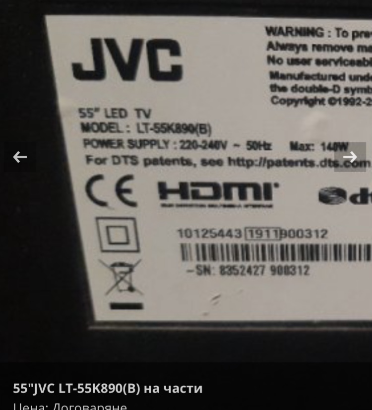

            TV model with the letter B
            • Xristakis795
              • Mar 2021
              • 162
              • Greece
              aa understood
              i think that is not problem
              must be the same
              thanks a lot sir
