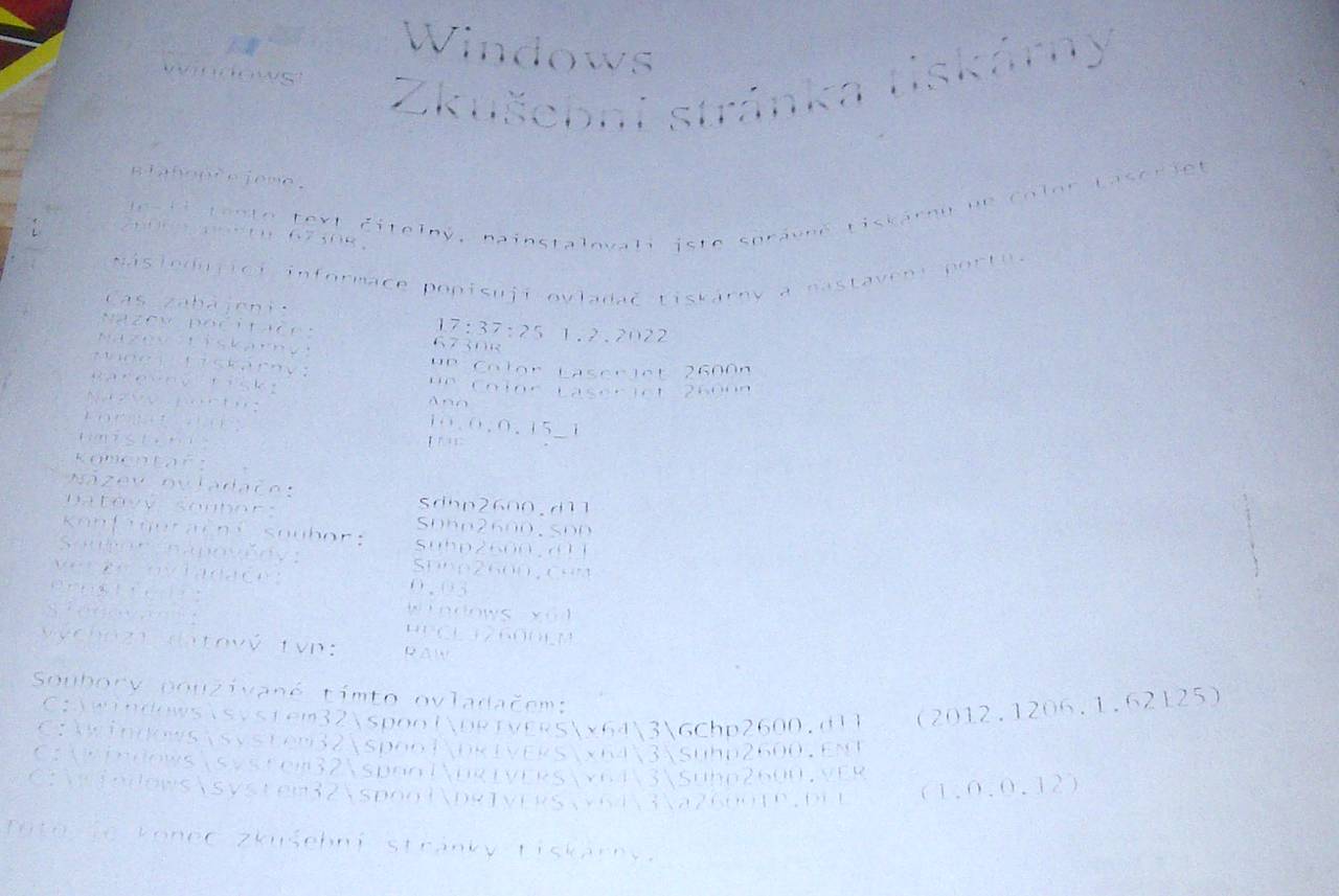

I've realised what I described there was problem with yet another (3500/3600 series); this 2600n of mine prints very very faint pages, especially on black and magenta, yet reports most cartridges at 40-50 %, any idea? laser assembly was cleaned not that long ago before it started doing this (besides, that's usualy problem with magenta, not key), in the meantime a new key cartridge was installed and printed to about half capacity and than it gradually started doing this to a state it is almost invisible
So what happened is this:
