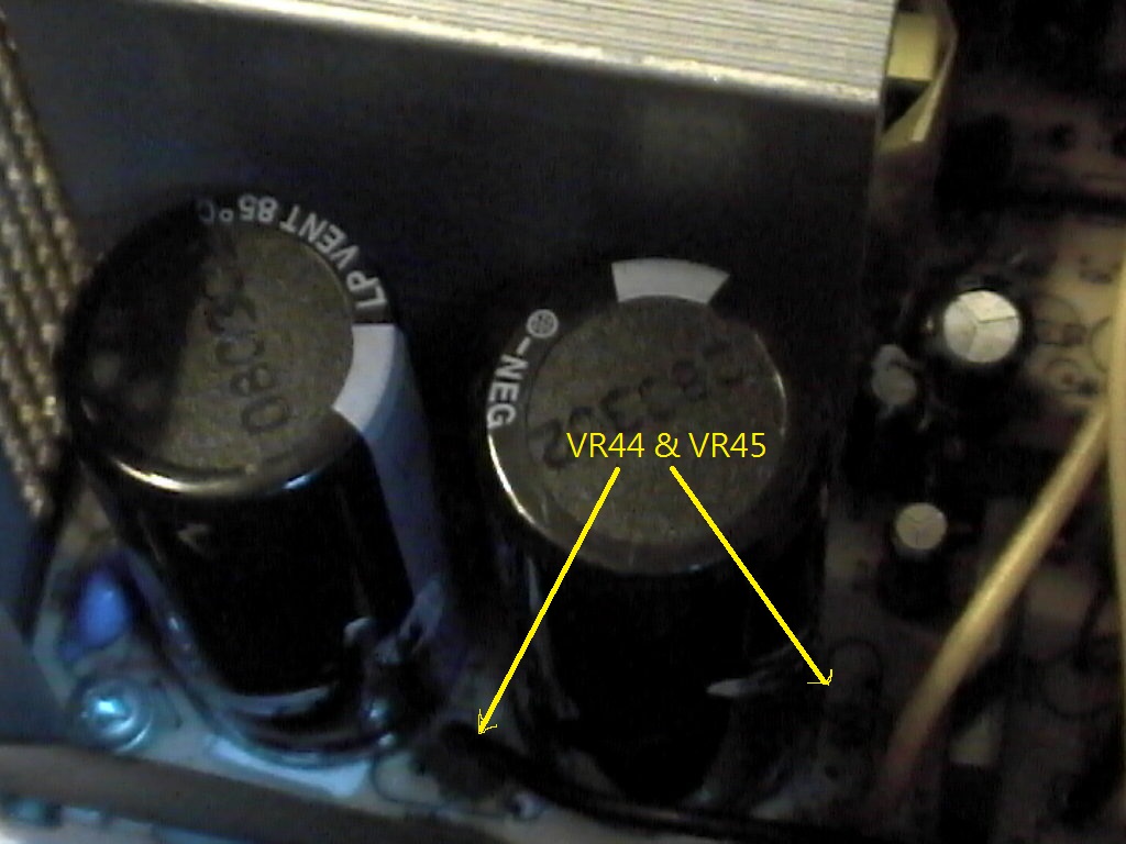

            I found that the resistance between EN/UV and S of TNY276 is only 320Ω. Therefore, no 5Vsb. I think it is burnt out.
            I will buy one next time I visit the shop.
            Besides, I found there are two Varistors, each across the big Cap, 680U 200V. One had burnt out. The other show that it is TVR10241. I am just wondering why it use a 240V varistor. Can I replace them with two 180~200V varistor?
            Many thank in advance.

              What brand is the 680 uF/200 volt capacitor? Show us some pictures of your power supply - I don't think I have seen that model Bestec.

                Re: Looking for a Bestec ATX-300-12E circuit Diagram
                Thanks for your reply.
                Capacitor is CapXon as attached. The varistor is VR44 & VR45
