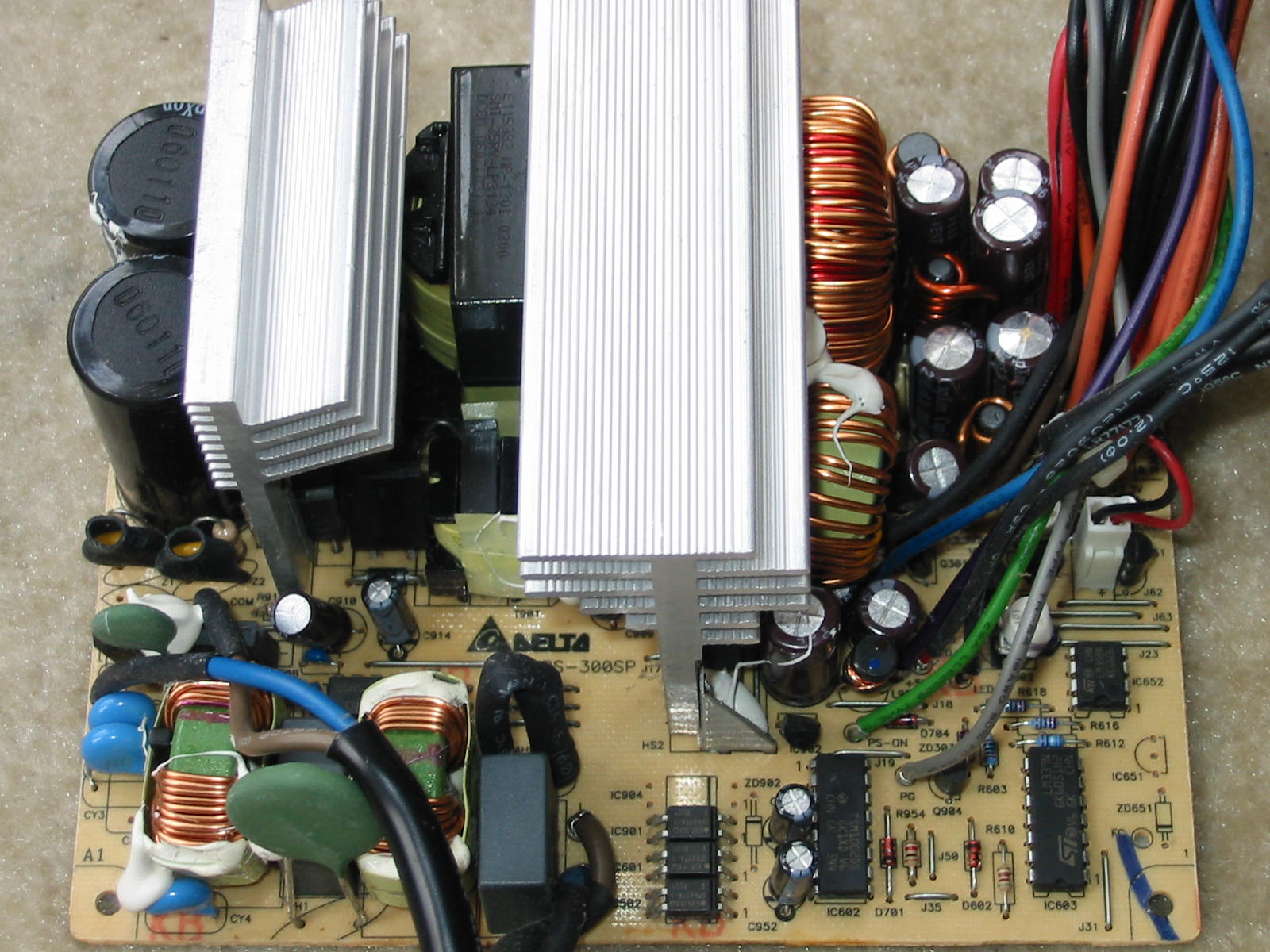

    Now let’s look at the rest of the PSU.
    https://www.badcaps.net/forum/attach...1&d=1616221145
    When it comes to good heatsinks, these older PSUs from Delta (and HiPro) from the early 2000’s are pretty much as good as they get. No wonder the PSU weights a ton. And remember, this one is rated for only 300 Watts (though IMO, these units can probably peak up to 350 Watts without problems.) The transformer and output inductors are also quite big. And on the output side, we see quite a few 12.5 mm caps, which is always nice when it comes to recapping these PSUs (which, BTW, tend to suffer from bad caps a lot less frequently than the newer units.)
    Anyways, here is the primary side:
    Input caps are 2x 200V, 680 uF Rubycon USR units - more than adequate for the power rating of this PSU. The little toroid inductor in the corner suggests this is a single-transistor forward design. Though not visible in the above picture, there are 2x 2SK2654 MOSFETs in TO-247 cases in parallel attached to that primary heatsink. Also, the main PS transformer does not use 35 mm wide core, but 39 mm - very nice!

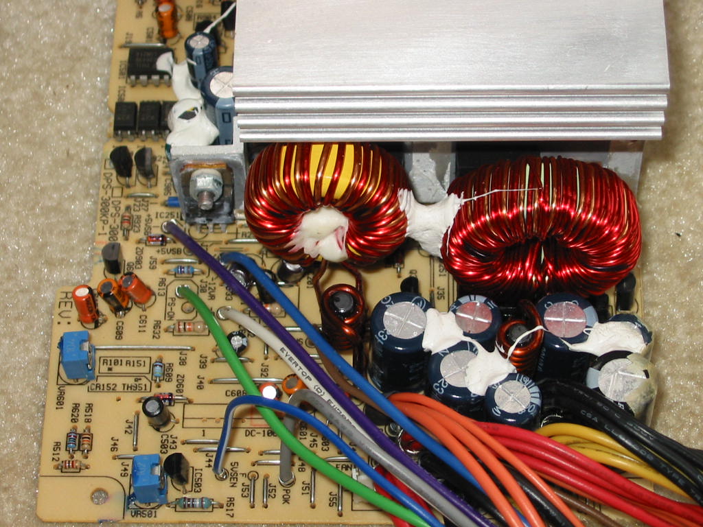

    Next, the secondary side…
    The output caps may look small at first, but that’s only because they are dwarfed by the output filter toroids. On that note, the main PS output toroid is a T130-52 (i.e. uses Micrometals -52 core material, as the light green color with one side painted blue shows.) The 3.3V rail toroid is only slightly smaller and uses -26 core material (T103-26, I think.) All in all, very good job there. Back to the output caps… again, no less than 4 of the output caps are 12.5 mm in diameter. Now the cap choices aren’t the best - mostly Ltec LZG. However, there is a single Rubycon YXG in there on the 12V rail (I guess Delta knows where it counts, as this PSU was installed in an early P4 MicronPC that drew power primarily from the 12V rail.) Another interesting thing to notice is the “5VSEN” (5V sense) line, in addition to the standard 3.3V sense line - Delta really wanted to make sure this PSU’s 5V and 3.3V rails performed top-notch.
