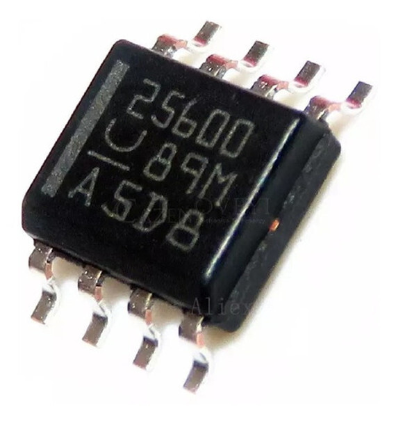

    Hello I am trying to repair the power supply board from Samsung bn44-00384a (date 2010) and I am trying to identify one chip with printed batch number and not the actual name of the IC.Maybe you could help me idetify the chip?
    i read something like 2560D but google shows nothing.

      bonjour Ucc25600
