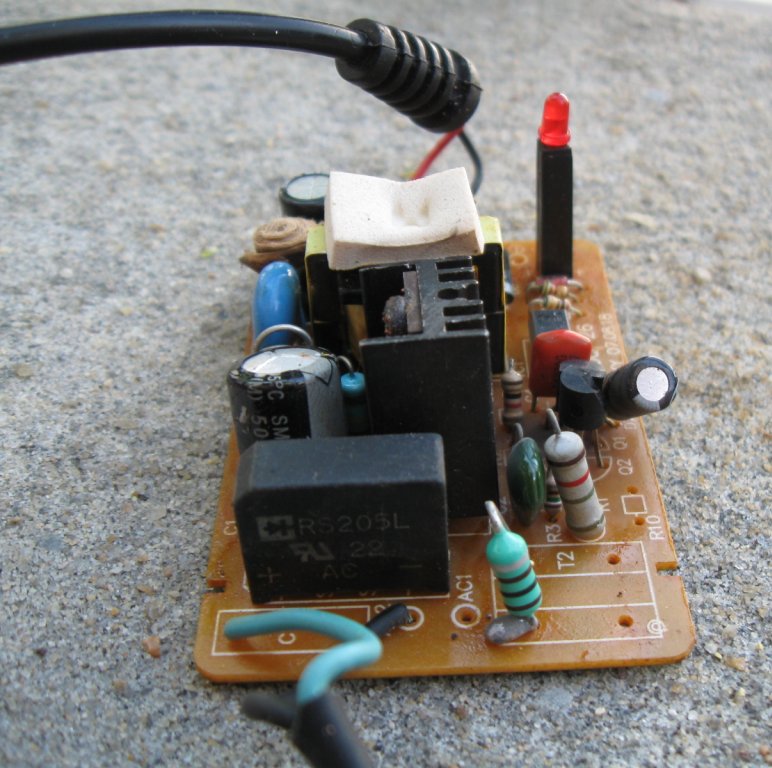

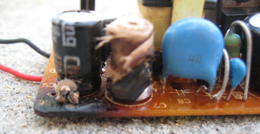

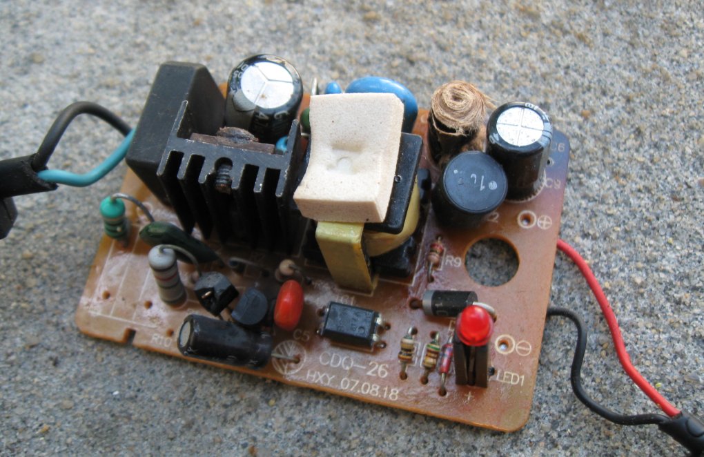

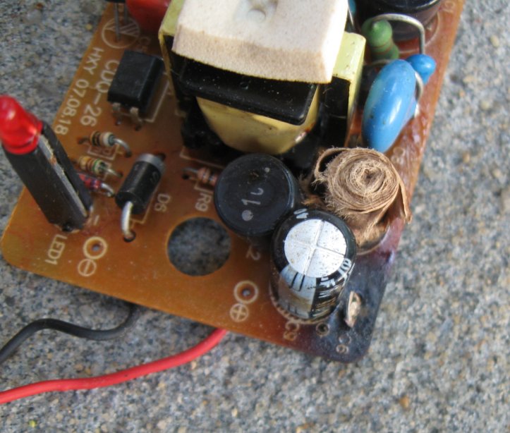

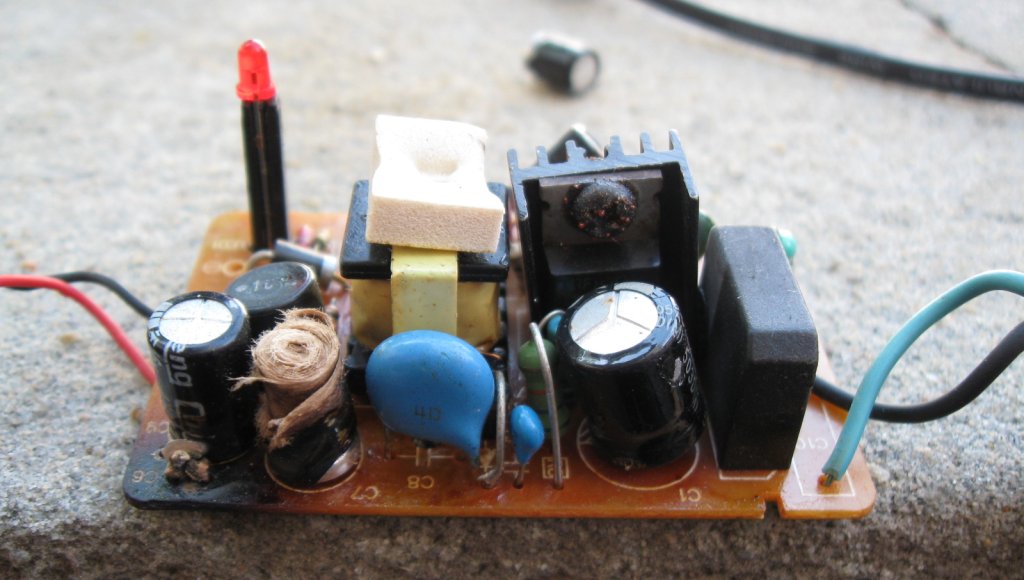

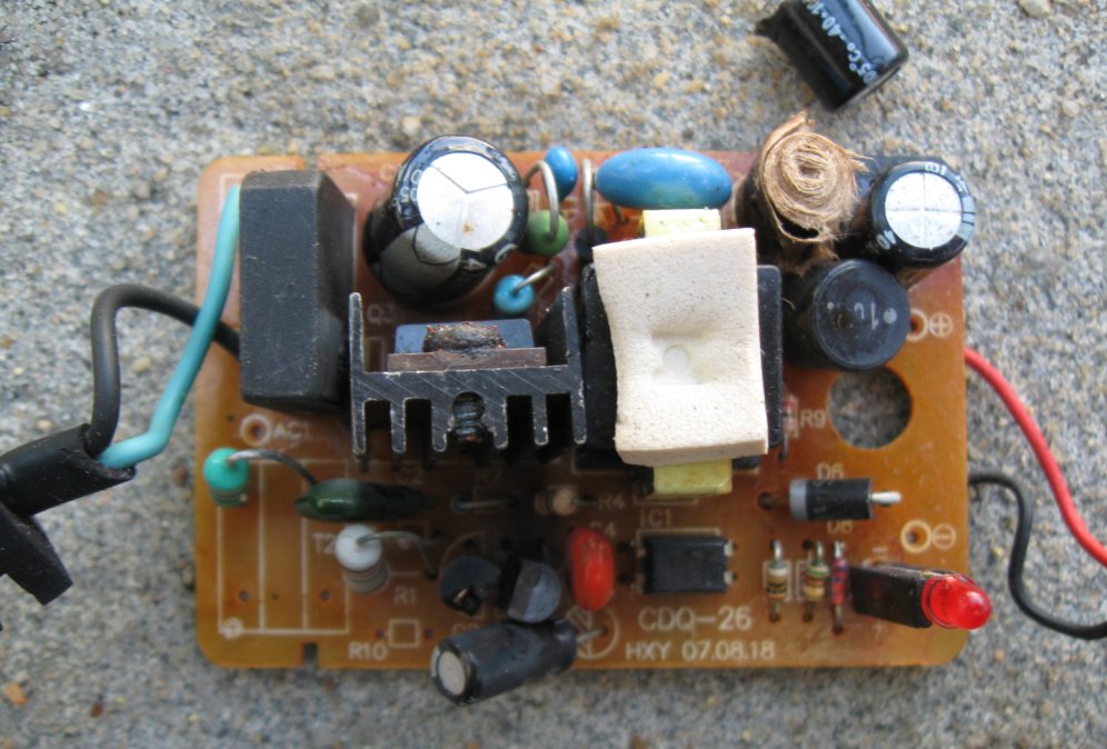

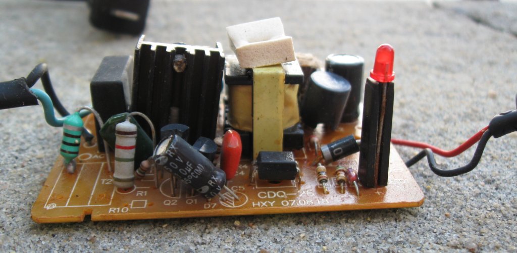

Security Camera Power Supply Carnage worth fix
Re: Security Camera Power Supply Carnage worth fix
I wouldn't bother to fix it, it seems to be a plain regular ac to dc adapter, probably 0.5-1A output.
Figure out the voltage and current (should be on the back of the security camera) and for a few dollars you can get a wallwart adapter, take out the pcb that's inside and just transplant the cable with the output jack on your new pcb:
See http://www.digikey.com/product-searc...dapters/589898 -
Horrible quality junk. Not worth repairing, unless you just want a learning experience.
I'd keep the heatsink for a spare, though."Tantalum for the brave, Solid Aluminium for the wise, Wet Electrolytic for the adventurous"
-David VanHornComment
Guys thanks on advice, you are correct it's a 12V adapter amps not sure but in the range or .5 to 1A.
I might be cheaper to buy new one then replace some parts on this and still end up with crap.
going to remove some parts to keep and junk the restComment
