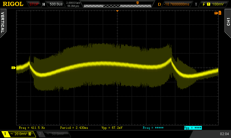

    I got this passive Zen to have a look at it. It had problem to turn on with no load. This seems to be a feature more than a bug, or to be precise, it has to have some load on either +12 V or +3,3 V. If there is load only at -12 V or +5 V (or higher than on other rails), protection kicks in.
    Other than that, there was bad cap at +12 V. I have filled it with Samxon RS 3300 uF/16 V, it was tough due to D8 positions but I made it. I've accidentally changed polarity of one at +3,3 V, this is good now, but there is still incredibly huge ripple (more of it on other rails actually) and I don't really know what to do with that.
    Total capacitance is aprox. 14,5 mF/+12 V, 6,5 mF/+3,3 V, 7,5 mf/+5 V, 700 uF/-12 V and 4,5 mF/+5 V SB. But other rails than +12 V are very noisy, check screens. It uses one output rail and magamps for both +3,3 and +5 V. Do you think it's bug or future as well? It get's better without load at -12 V but it's still out of spec by almost 100 %…

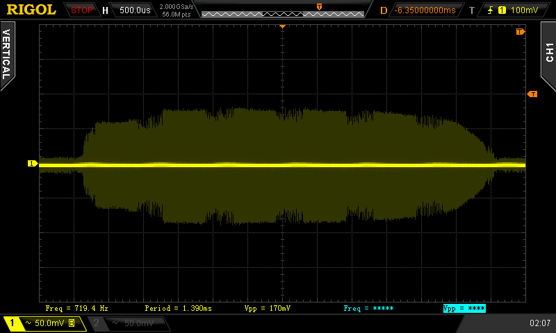

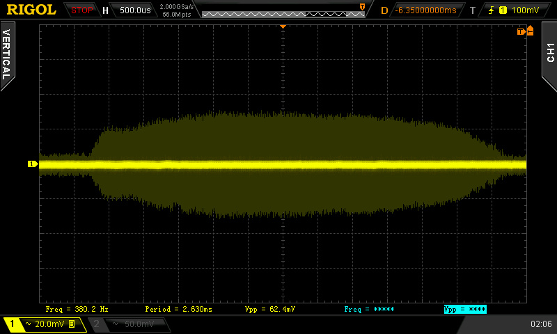

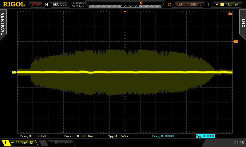

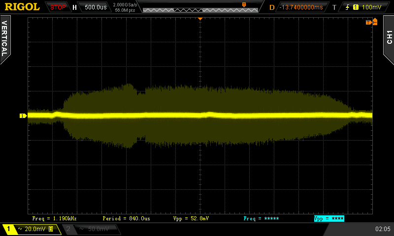

    I've been playing around with it and it seems like the problem is in the switching part. The ripple seems to be at 108 kHz (double the swtching frequency), measuring it directly in molex revealed it is there and the decoupling caps are just able to filter part of it out, making such blocks you can see on the images.
    Adding 3300uF did not help at all.

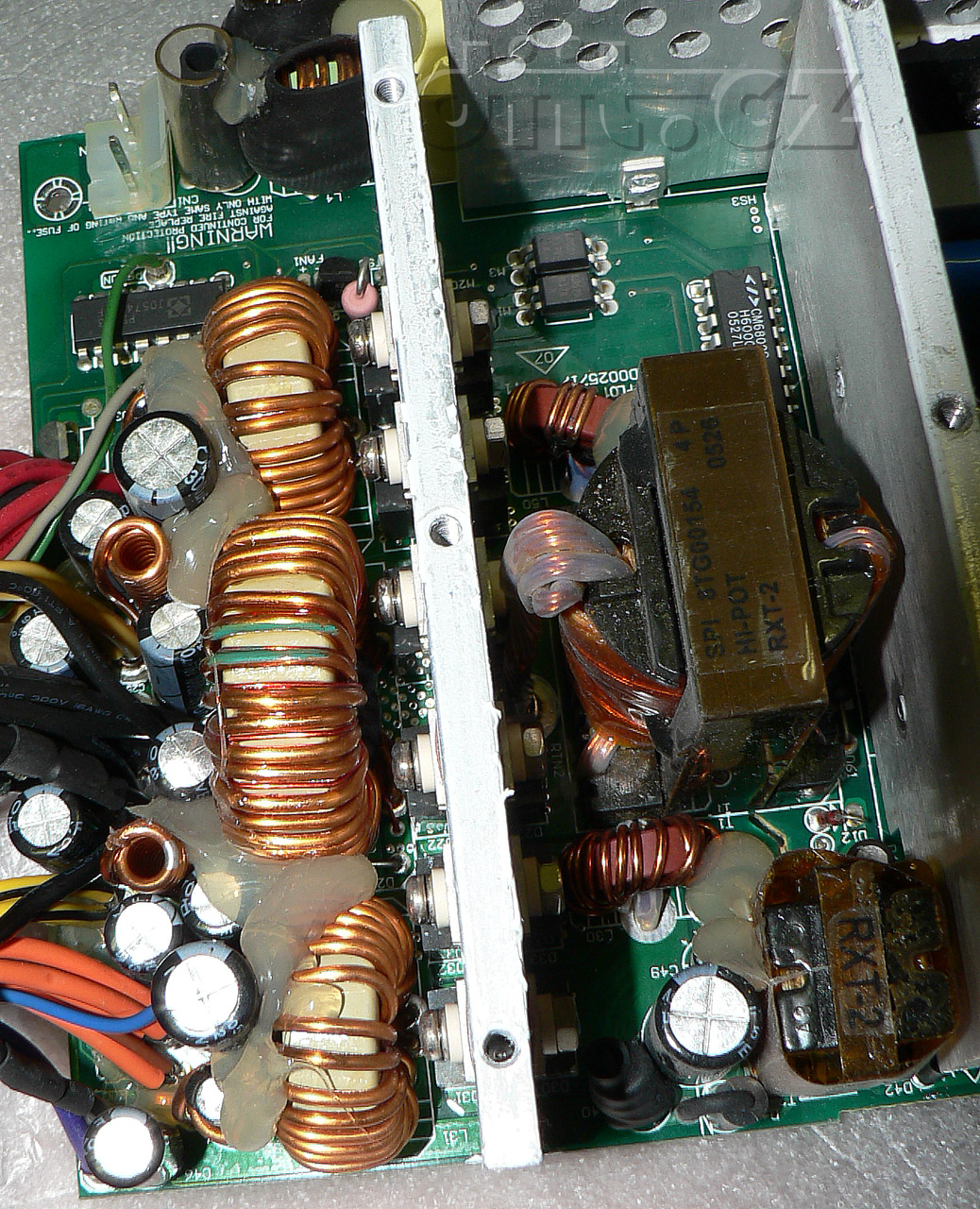

            Does it have ferrite rod inductors for the O/Ps (in addition to the big toroids)? If not, I think that is the purpose of ferrite rod inductors. If it does, try ceramic caps on the O/P side of the ferrite rods. Also, check to be sure all the connections to chassis ground are tight. A poor ground connection can show up as noise. Another possible cause might be a snubber that isn't doing its job - e.g. a bad solder joint or toasted resistor - or was left uninstalled to cut costs.

              Well now that you're asking, there are ferrite rod inductors and two "air core" inductors (just more wire without any core) what FSP uses. If the two are for +3,3 and +5 V, do you think that's it?
              ADD// seems like the inductors without core are on the two +12 V rails so +3,3 and +5 V have ferite rod ones. Heres an image.
