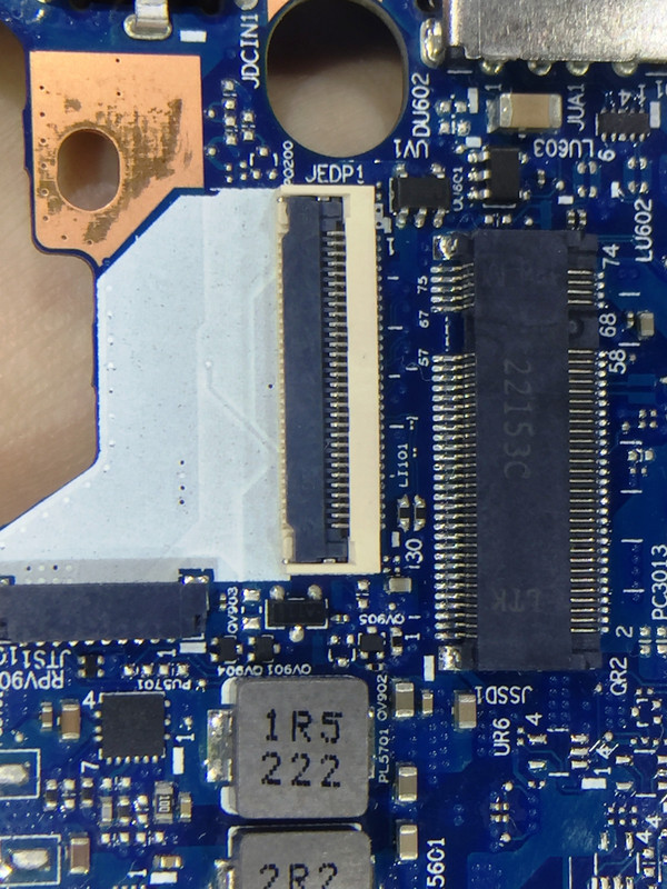

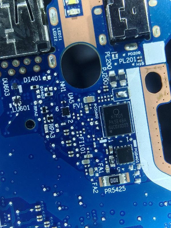

      Send clear picture from your board both top and bottom near EDP and DC connector
      Here's is fuse backlight

        First of all, thank you for taking the time to answer. Well, I have taken photos of both sides of the mother: near the lcd connector and behind the lcd connector. Now, and forgive my lack of experience, but how should I measure the circuit that may be damaged and perhaps should be replaced? What I know is measured with the multimeter in V, 20, grounding in some area of the motherboard and on the other side in the circuit, fuse, am I correct or am I ignoring something else? All the help you give me will be useful. On the other hand, I have investigated and seen video where on the one hand, the fuse is replaced or on the other hand a bridge is made. What do you recommend me?

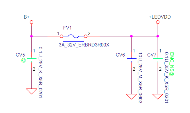

                According to the diagram, there is a resistor R121 0 Om, which works as a fuse.

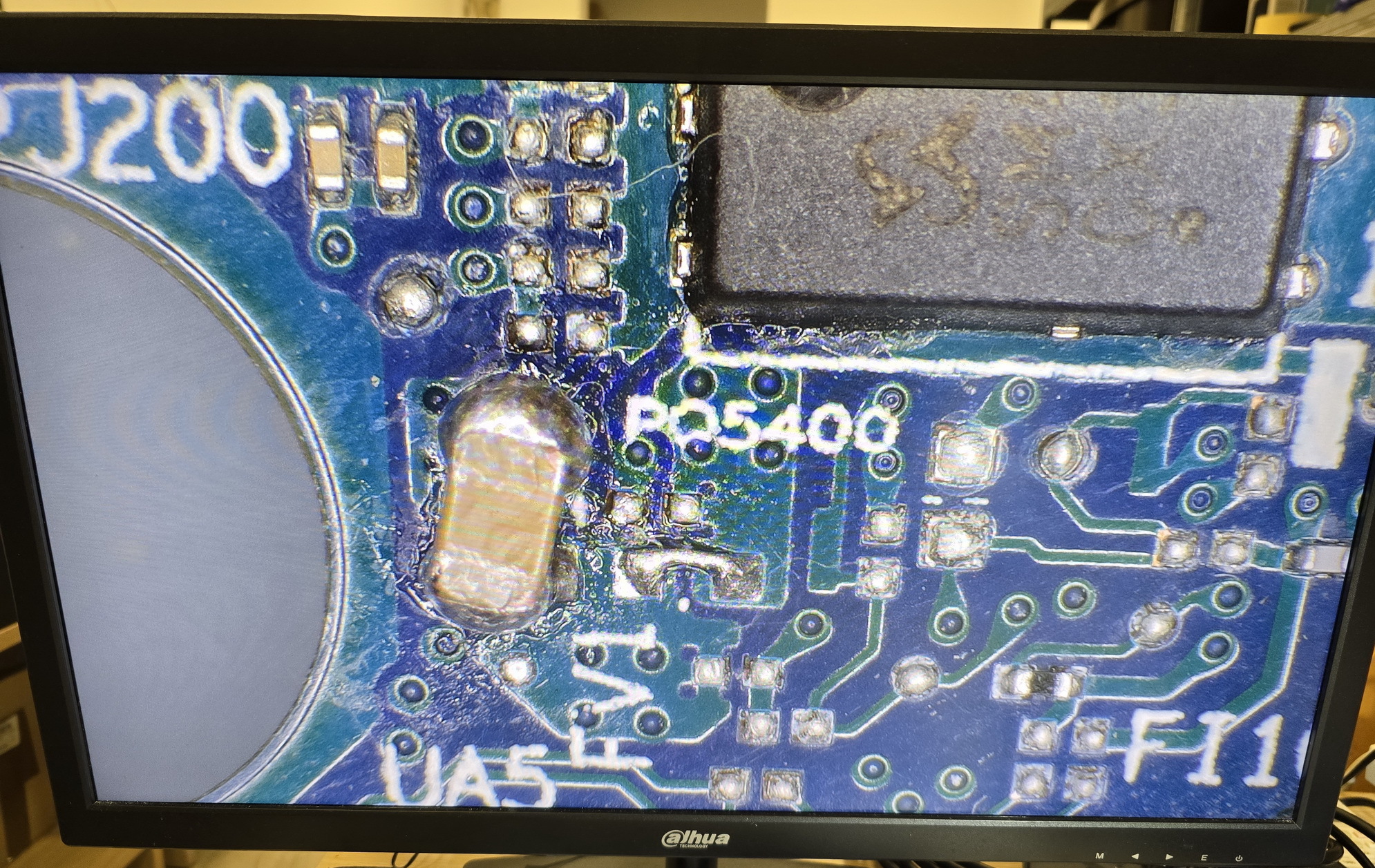

                  https://www.badcaps.net/forum/attach...2&d=1675462628
                  https://www.badcaps.net/forum/attach...1&d=1675462628
                  Can you tell me which mother model you are talking about and indicate according to the photo? Well, in the mother that I am looking for a solution, there is no resistance with the name R121 or C133. Look at the real photos I uploaded of the plate. That's why I think that to locate the mother I have I need the NM-D471 Rev 2.0 schematic, which by the way I can't find anywhere.

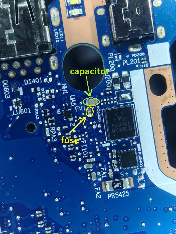

                        It's a white fuse with some black markings underneath the flex on the opposite side of the board.

                          hi are this issue is solve. i have the same problem. from schematic i got short on CV6 which is brown caps around FV1. al ready replace but still dimmed. im also measure FV1 and i got 20v in 1 side and from site 2 i got 9-11v

                                  Hello friends. What will be the value of the capacitor? It looks like a short circuit, but it can't be for insurance purposes, right?

                                      Should I replace the fuse? Should I replace the capacitor?
                                      If it is a fuse, is this correct? 0R 0805 5%
                                      What specification is correct for the capacitor?​

                                        Lenovo ideapad 3 15ITL6, no picture on LCD screen but there is a picture on external HDMI monitor.
                                        Like on the schematic fuse FV1 was blown because capacitor CV6 was shorted. Changed capacitor with 10uF capacitor but I didn't have it in same size so little bigger one, and fuse replaced by wire link.
                                        Everything works fine now.
