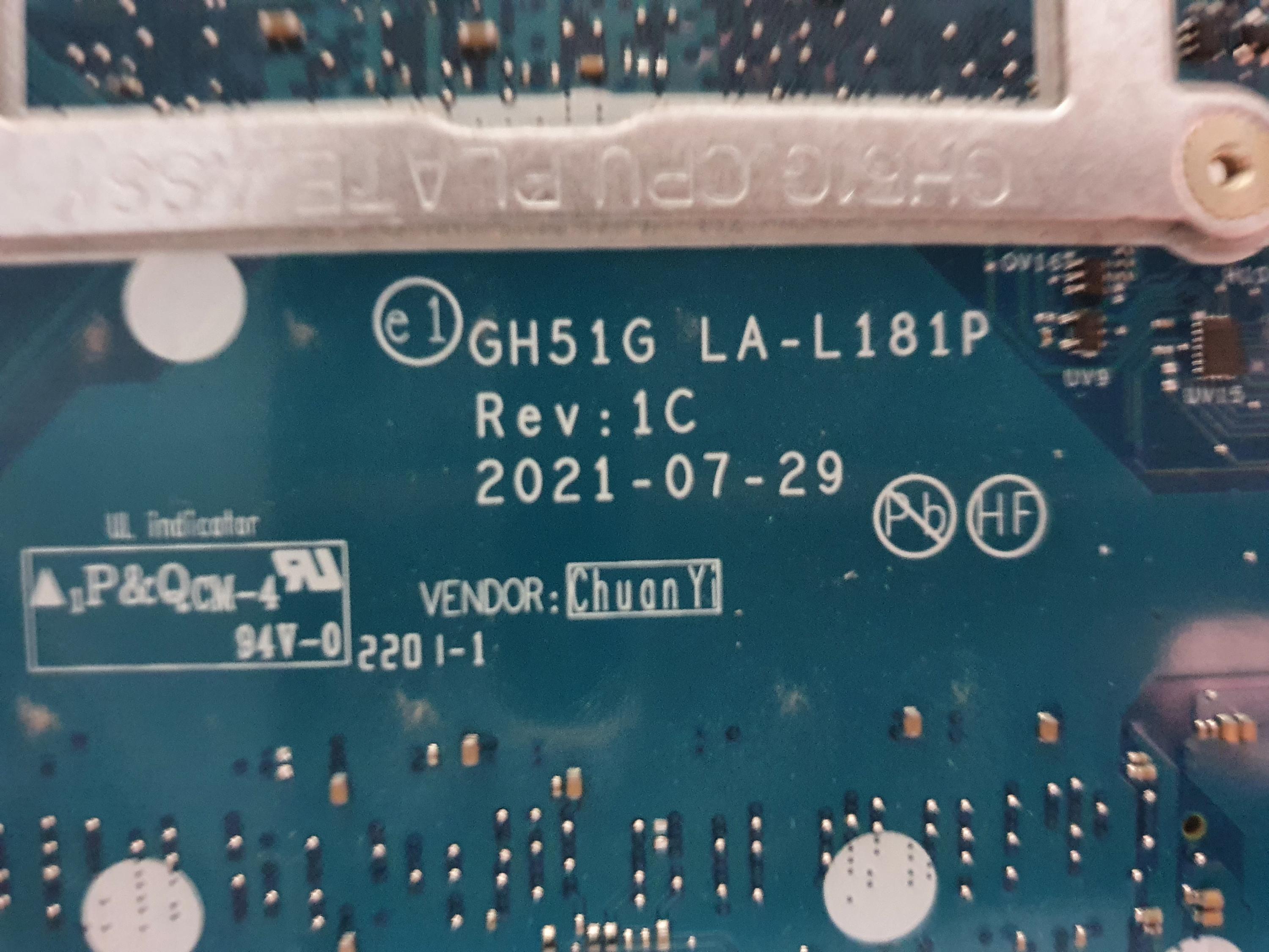

    Hi everyone!
    I'm currently in desperate need of a boardview for my acer laptop.
    Make : Acer
    Model : Nitro 5
    Motherboard: gh51g - la-l181p Rev: 1C
    It is completely dead with no power, lights or anything.

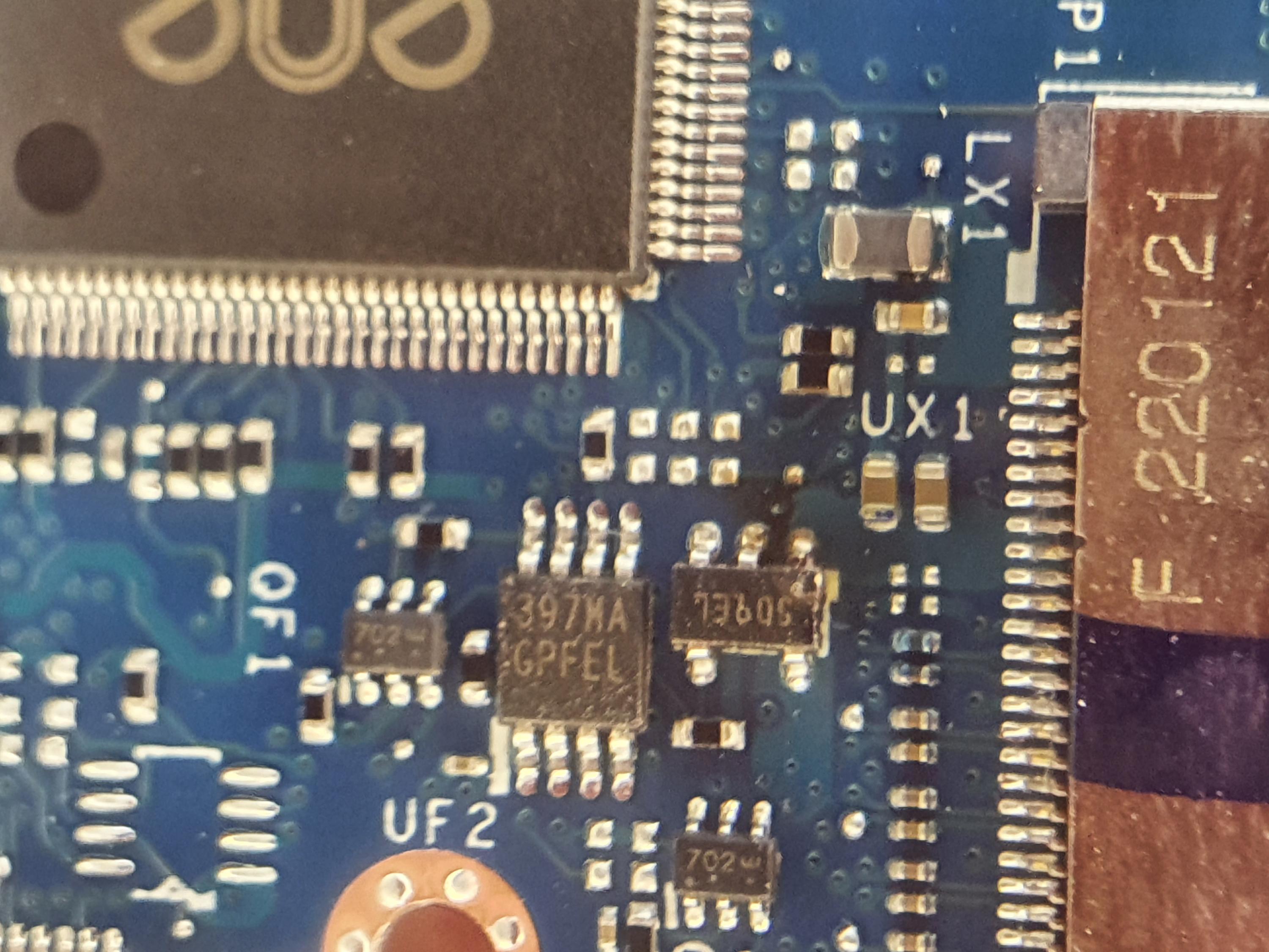

    After inspecting under the microscope. I have found what looks to be a burnt chip (509EL)?
    After countless hours looking online I cannot find a replacement.
    If anyone had a boardview, and can also possibly point me in the right direction for a replacement it would be a huge help!
    Thank you!

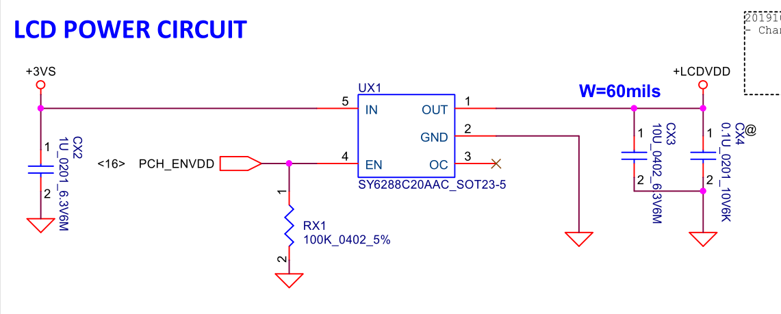

    See attached.
    UX1 = Silergy SY6288C20AAC
    It is a load switch but the suffix is important when you replace this component as it defines the current it can support and the EN pin polarity.
    https://www.aliexpress.com/item/1005003009896790.html
    https://www.aliexpress.com/premium/S...psort=1&page=1
    PS: These are very common load switches in the SOT-23 package. Check Diodes Inc. / Microchip for possible alternatives as a replacement.

      Re: Acer Nitro 5 nc20c1 - gh51g la-l181p Rev:1C Boardview
      Will get these ordered now. Thank you so much. I have been struggling to find them.
