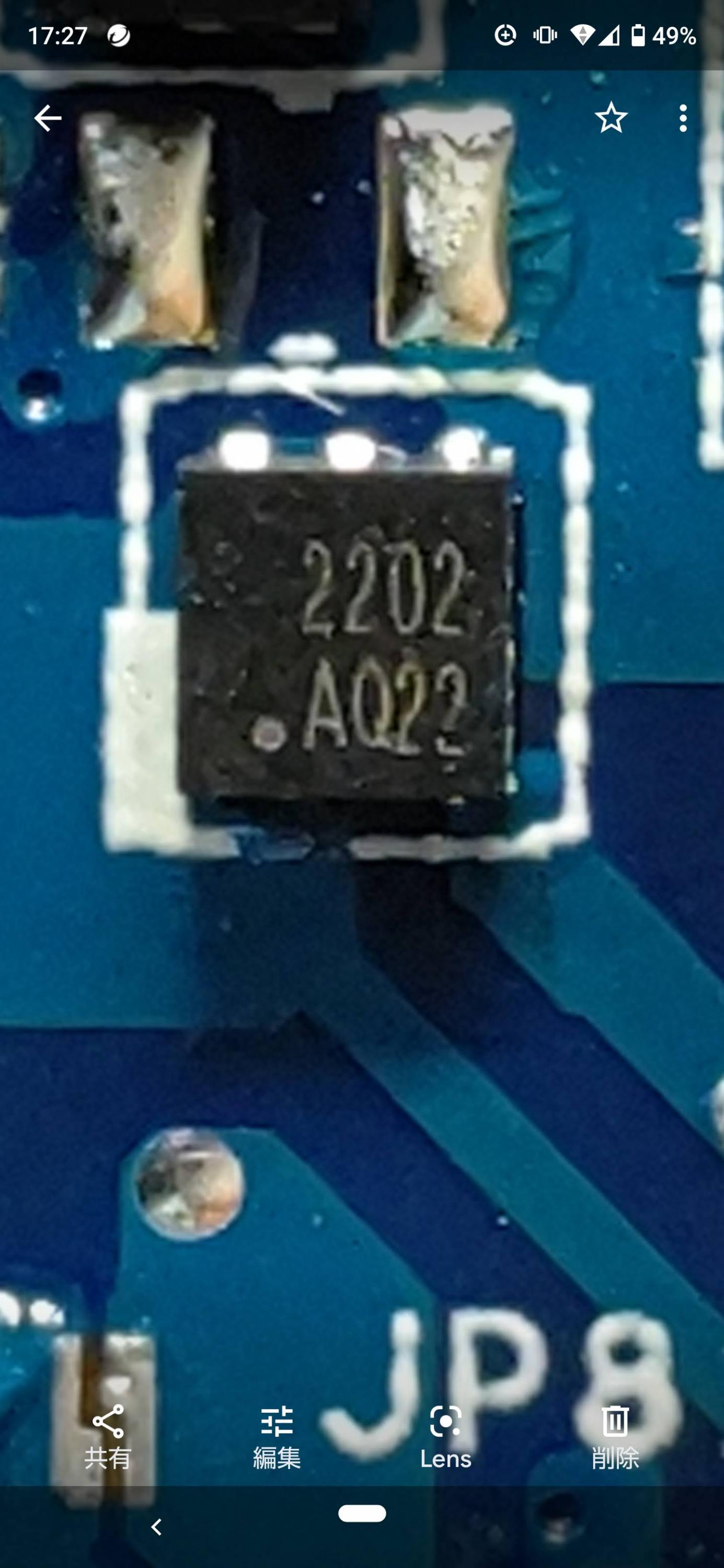

        Re: I am looking for a schematic of Toshiba Satellite NB10-A.
        Please tell me more.
        The terminals of "Q8103" and "Q8102" on the board are corroded, so I would like to replace them, but even if I search for "2202AQ22" on the chip, the information does not come out.
        If anyone knows more information, please let me know.
        Thank you.
        • imoimo
          • May 2021
          • 7
          • Japan
          I'm looking for a chip labeled "2202AQ22" in the photo.
          I am currently repairing the Toshiba satellite NB10-A, but I would like to replace it because the chip marked "2202AQ22" in the attached photo is corroded.
          However, "2202AQ22" does not seem to be the name of the chip, and even if I look it up on the Internet, I am in trouble because I do not know the detailed information.
          I think it's a MOSFET, but if anyone knows more information, please let me know.

            2202 AQ22 could be a sino power SM2202NSQE - https://www.badcaps.net/forum/showthread.php?p=1018935
            Q8102 and Q8103 can be replaced with a Vishay SiA432DJ
            https://www.badcaps.net/forum/showpo...7&postcount=10
              Thank you for providing information!
              Probably the same thing.
              I searched for "SM2203NSQE" on AliExpress and found some hits.
              I will buy it as a trial and exchange it.
              It will take some time to transport, so I will report the result.
              Thank you very much.

                Hello.
                I received the parts for the "SM2203NSQE" that I was told, so I replaced it and it worked normally. Thank you very much.
                However, the personal computer itself has not been fixed, and as a result of various investigations based on the BoardView I received, even if I replace it with a new part in a situation where normal voltage is not output from multiple pins of the "U8300", there is no change and it does not fix. in trouble.
                If you have any hints, please let me know.
