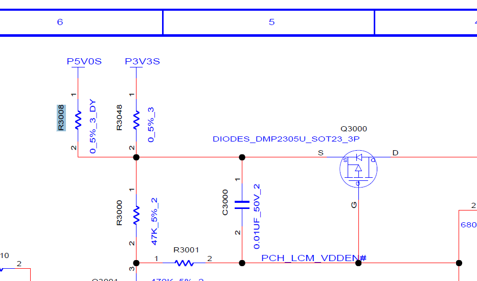

    Looking for inventec 6050A2493501-MB-A01 schematics.
    I have burnt R3008 resistor connected to the source of Q3003 Fet.
    Does anyone have this specific schematics or know the value of R3008.
    Thanks in advance.

    Re: Need Schematics For Toshiba Qosmio X870 inventec 6050A2493501-MB-A02
    R3008 = 0Om_5%_3_DY
    • makinist
      • Jan 2021
      • 6
      • Turkey
      Thank you so much.

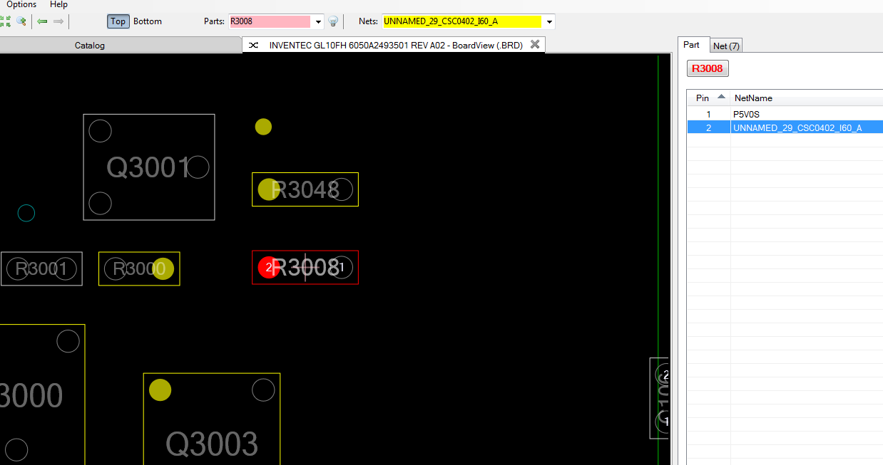

      • makinist
        • Jan 2021
        • 6
        • Turkey
        I could not get any picture over LVDS. Everything seems ok over VGA.
        @lg_cat or anybody, If it is not too much trouble can you please share the page of LVDS connector, either on schematics or on boardview.
        Thank you.
          • 21886
          Thank you.
          Here
          • makinist
            • Jan 2021
            • 6
            • Turkey
            Much appreciated.
