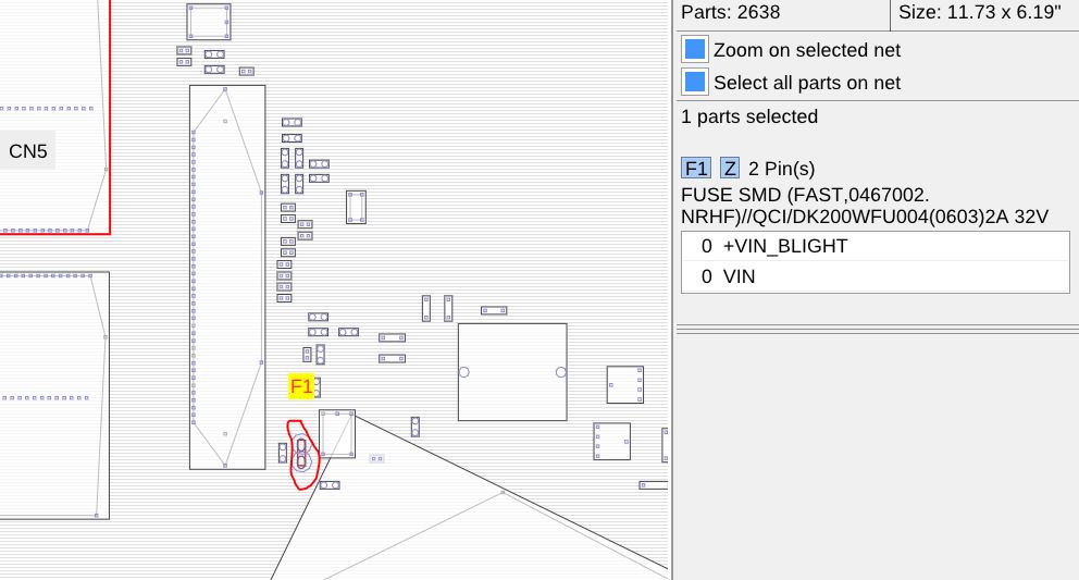

    looking for schematic for asus
    DABKLGMB8D0 REV
    MODEL:FX504G
    powering but no backlight charnged backlight fuse still no change, need to see if PCH is sending the enable signal
    thanks

    Boardview .

      Hello Petersedoon115,
      I have the same problem...no backlight on Asus Fx504ge with motherbord
      DABKLGMB8D0 REV D
      Can you tell me where is located backlight fuse?
      If you have a picture, will be nice
      Thank you, in advance!

        Use the boardview posted above. The fuse is F1

          Thanks a lot!
