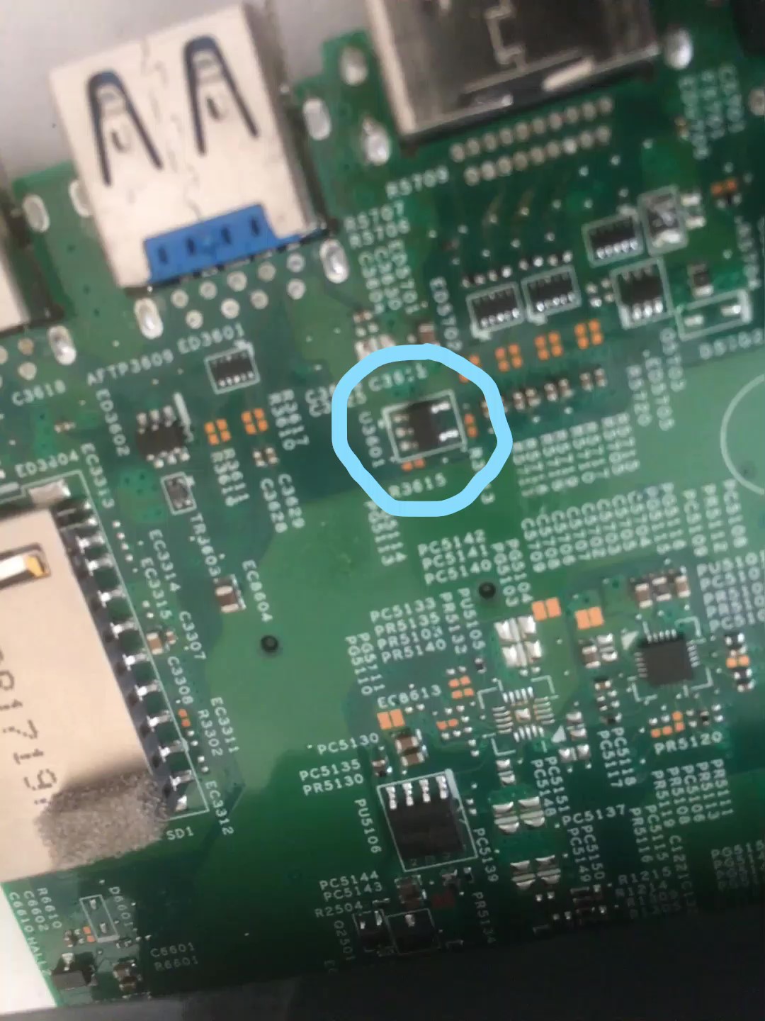

      I have notice that U3601 54B1K (or 5481k) IS GETTING VERY HOT.
      Pins 1,2 i get nothing.
      Pins 3,4 i get 3.3v
      Pin 5 i get 5V.
      i tried to find ic pin diagram but i couldn't.
      i believe that pin 5 is the input (vcc) and pins 1,2 that are connected together
      are the outputs.
      what to you think!
      thanks

        Upload a photo with it

          image uploaded
          if i can not find such a part what options do i have

            U3601 = G524B1T11U .The motherboard schematic is available on a few paid sites.
            EDIT: G524 Datasheet https://cdn.badcaps-static.com/pdfs/...41e690a0ad.pdf

              I found the problem.
              there was a short capacitor near battery on the other side. there ware 2 capacitors in parallel and one of them was short.
              now usb ports are working
