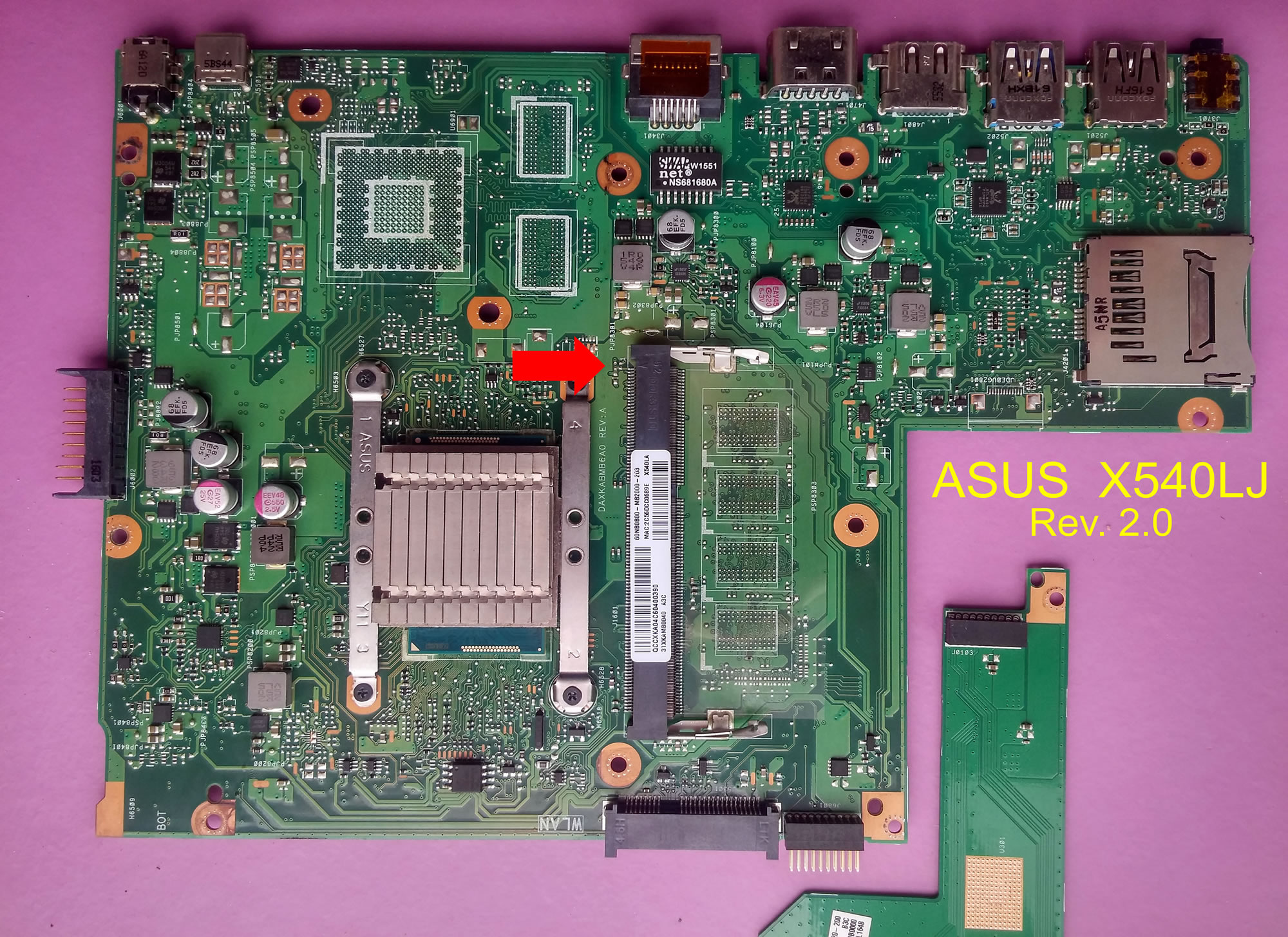

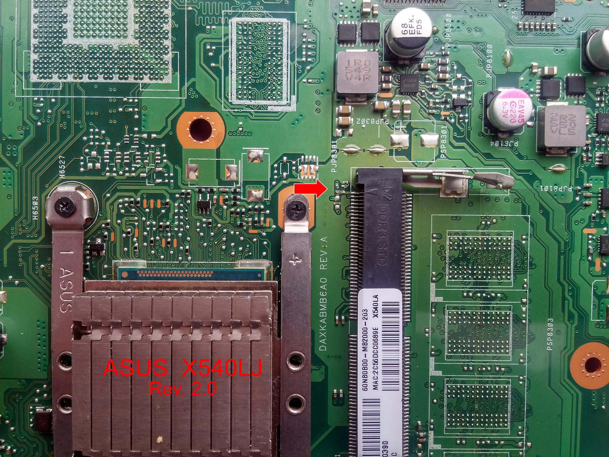

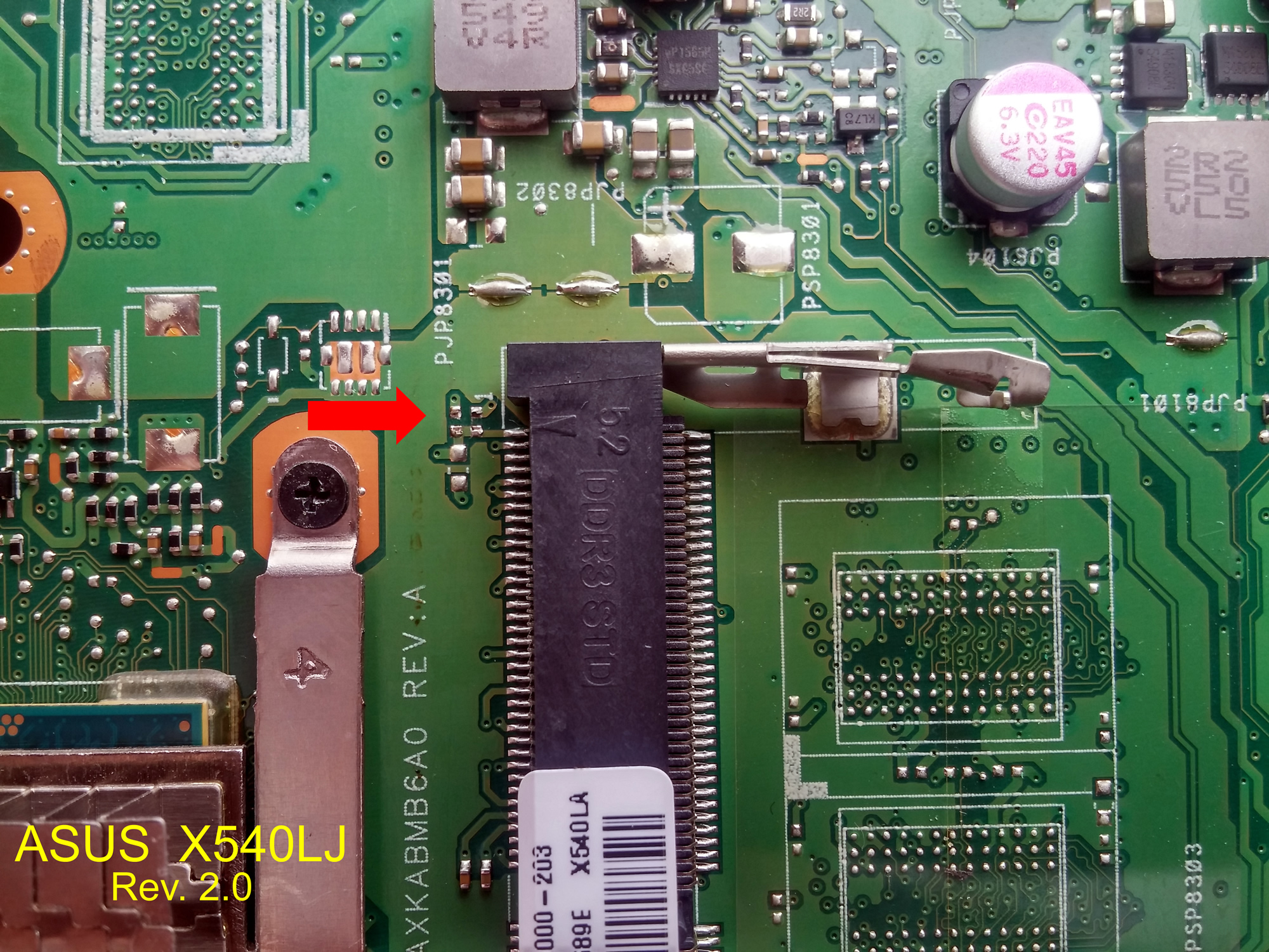

    asus X540LJ Rev. 2.0
    Hello!
    I need help from the motherboard asus X540LJ Rev. 2.0, I have detected that 2 smd capacitors are missing but I do not know their measurements or capacity.
    If someone gives me the schematic, boarview or the reference of the capacitors
    ...Thanks in advance

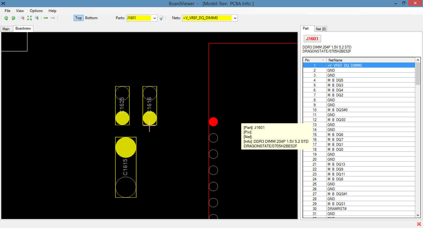

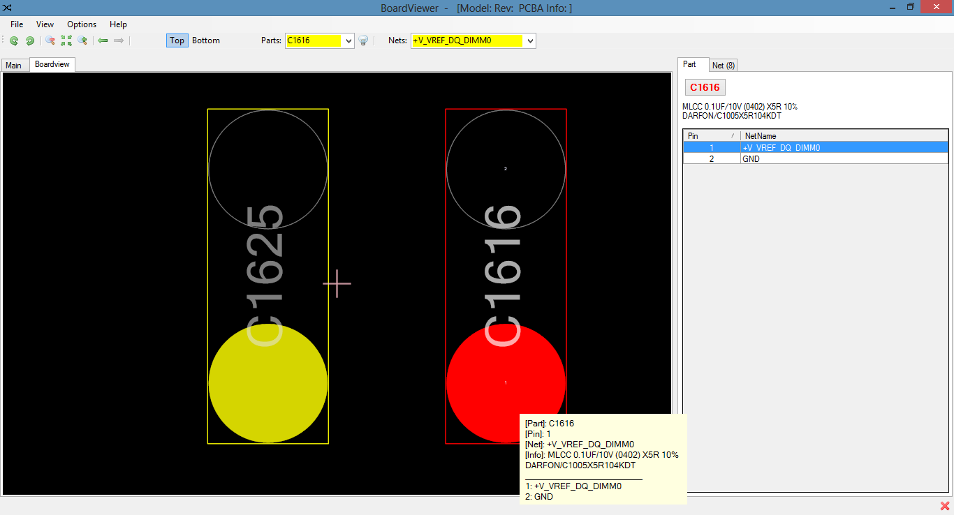

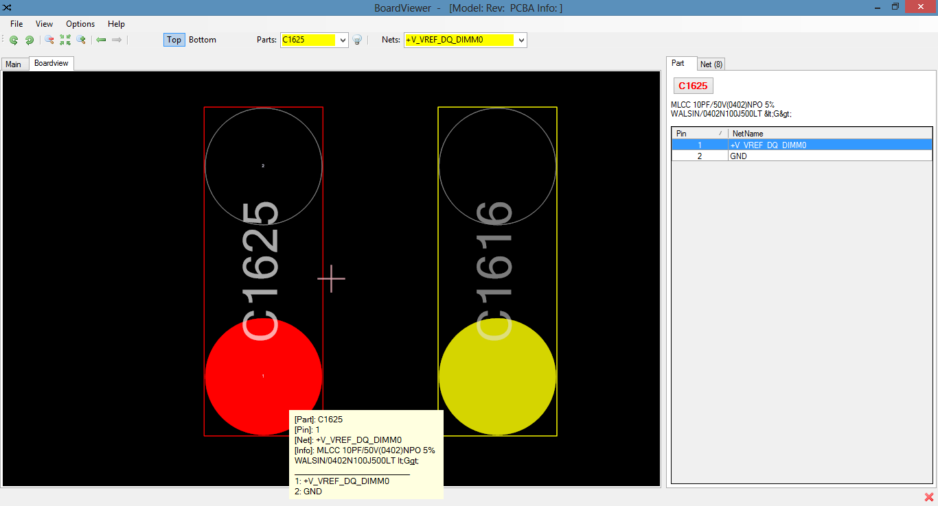

    Re: asus X540LJ Rev. 2.0
    here a few screen shoot only:
    • hugbald
      • Feb 2019
      • 3
      • Spain
      Thank you very much on/off , it has been very helpful for me
