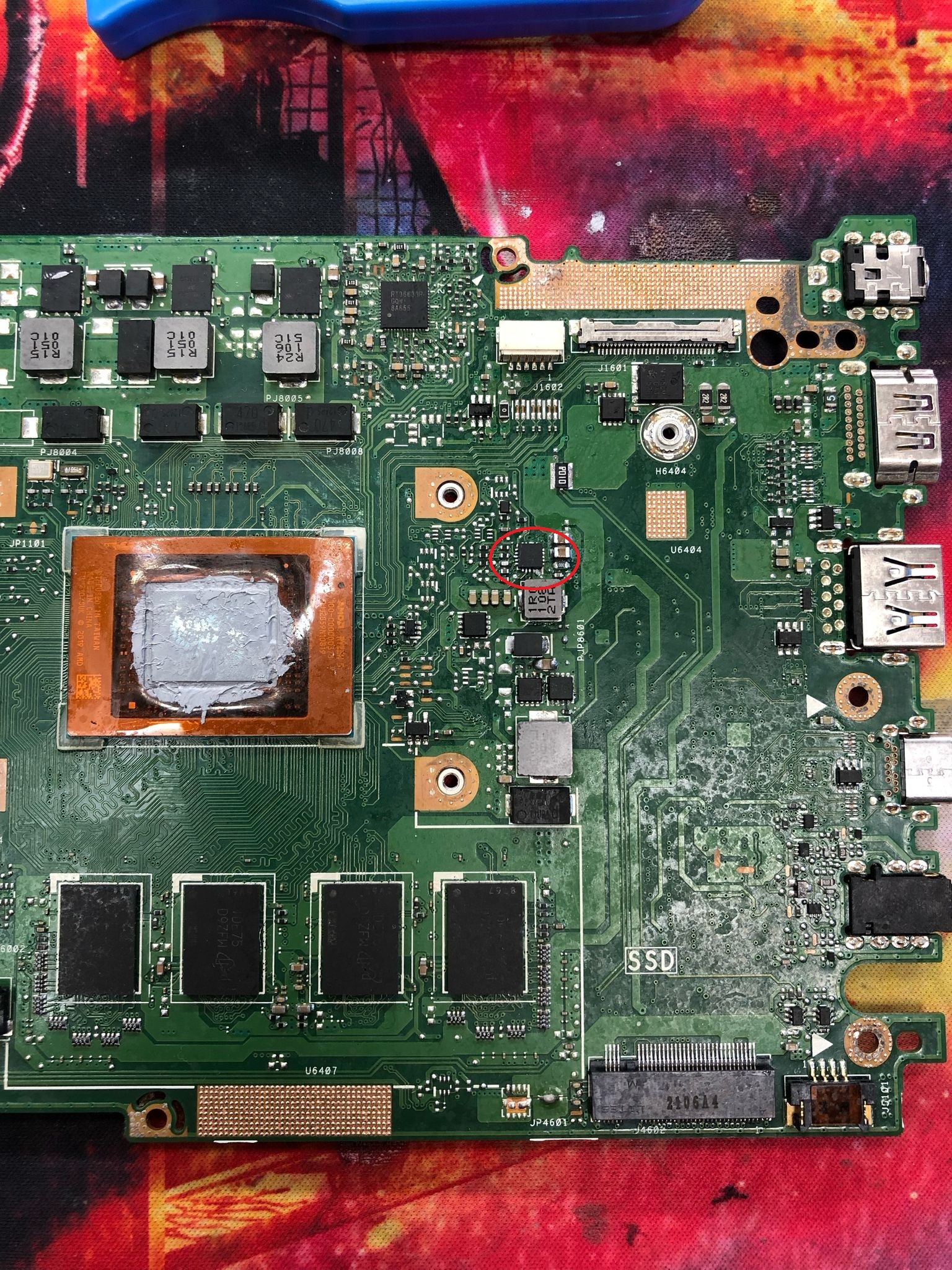

    schematic Asus Vivo Book X421UA
    Need schemiatic Asus Vivo Book X421UA r2.0
    I cannot find information about the system signed "AWSCRG", it looks like a 19v -> 0.75v converter.

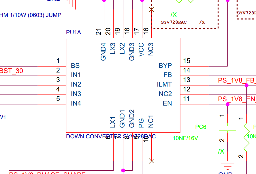

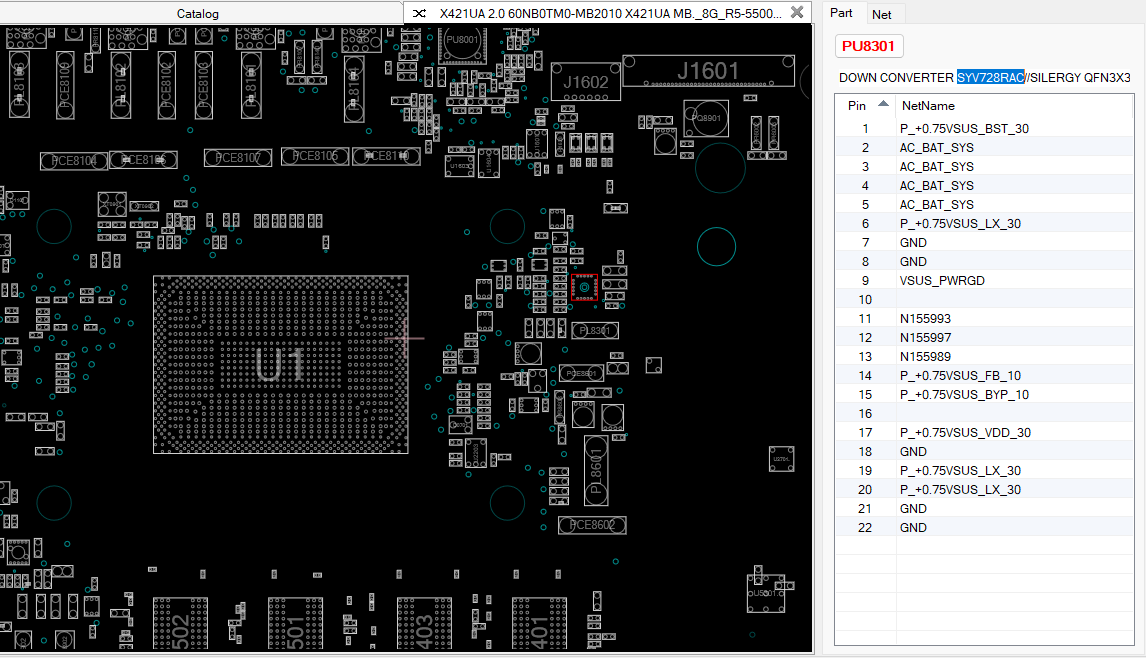

    try SYV728RAC Click image for larger version
ID:	3585493 Click image for larger version
