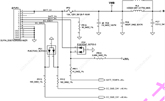

    Please help identify SOT on Toshiba Satellite R50-E
    First of all it is clear..schematics for this laptop does not exist..
    Anyway I am not able to to get photos...but can someone please send me a photo or marking code of a 3-pin SOT-23 located on pin 3 and 4 of the battery terminals.Mine combusted
    Thank you

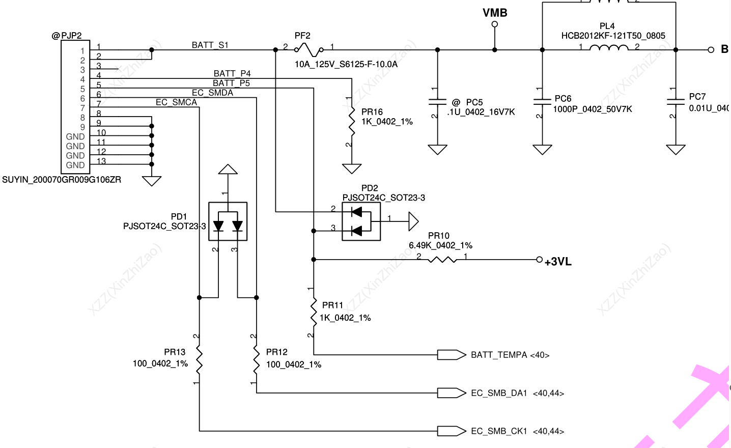

    Other Toshiba logic boards are fitted with the PJSOT24C (according to the schematics).
    PJSOT24C-03_R1_00001 Panjit | Mouser Canada

      Post the motherboard model number

        FTL5SY4
        A4458A

            Thank you very much mon2 ...it worked...After I soldered the PJSOT..I got the battery detection back
