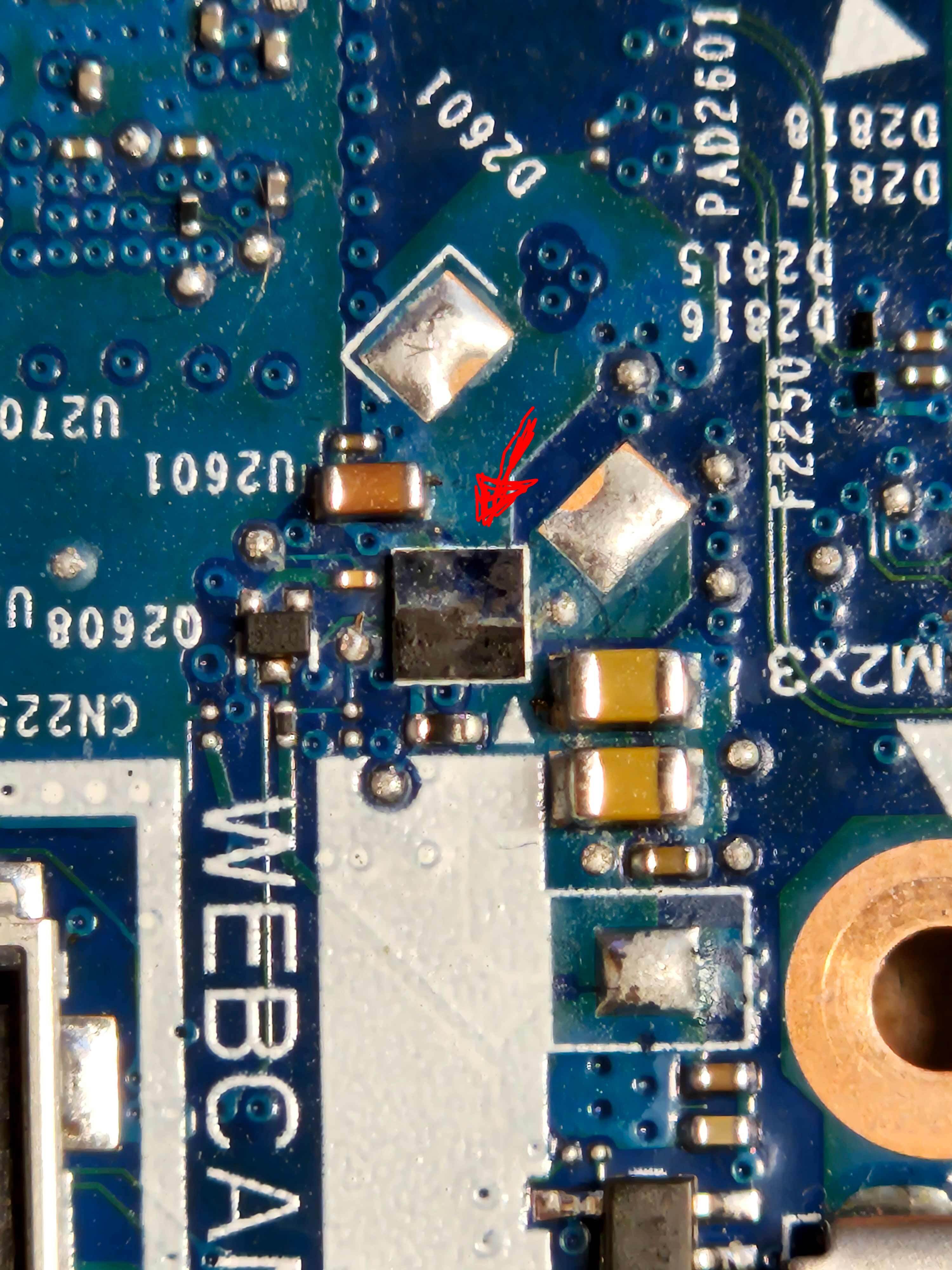

    Hi everyone,
    I'm reaching out for some help with a problem I've encountered with my HP Elitebook x360 1040 G6.
    I recently noticed that my computer wasn't powering on. After a bit of investigation, I discovered a burnt component on the motherboard. Unfortunately, I'm not entirely sure what this component is, and I would greatly appreciate any assistance in identifying it and determining if it can be replaced. Model of the HP motherboard: brighton-6050A3037501-MB-A01(A1) (l63007-601)Click image for larger version  Name:	3.jpg Views:	17 Size:	115.6 KB ID:	3284991Click image for larger version  Name:	2.jpg Views:	18 Size:	665.9 KB ID:	3284992Click image for larger version  Name:	1.jpg Views:	17 Size:	734.4 KB ID:	3284993

    NX5P3290UKZ

        Hi, i recived the pice, but i don't know the right orientation.. how to put it on the MB. Can you help me out? THX

          or at least a schematic, where i can check myself.. thank you

            The white triangle on the board is pointing to pin 1 .That should be VIN . Ball A1 of the part is VIN https://www.datasheets.com/part-deta...ctors-85029759
