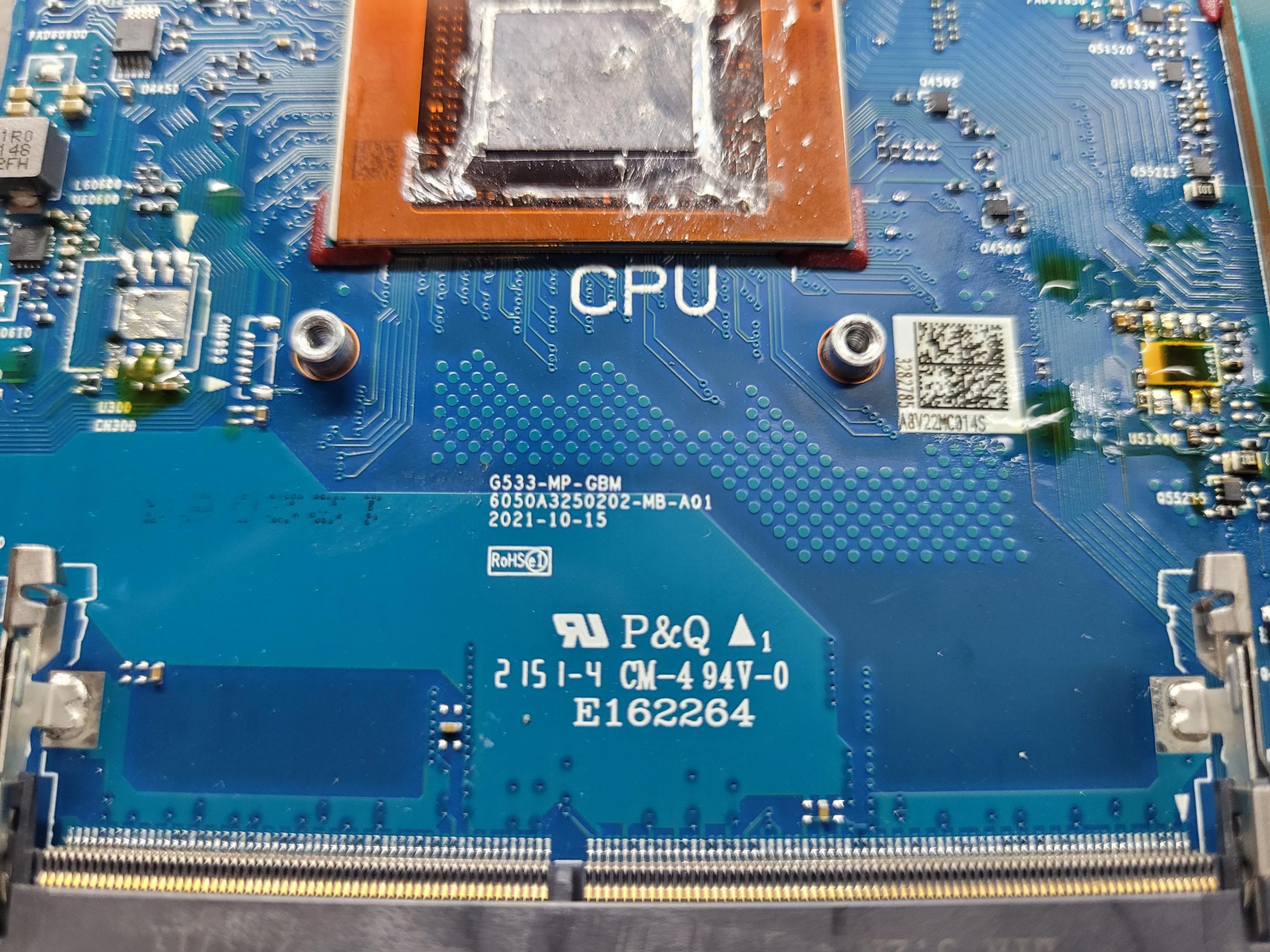

    Hi i also need schematic for this board ( g533-mp-gbm 6050A3250202-MB-AO1 ) , main difference between 6050A3250202 and 6050A3250201 is that power meter NCP45491 is used in 6050A3250202 and NCP45495 in 6050A3250201 and i have a problem with NCP45491 showing insane power consumptions (200+ watts) on idle gpu
