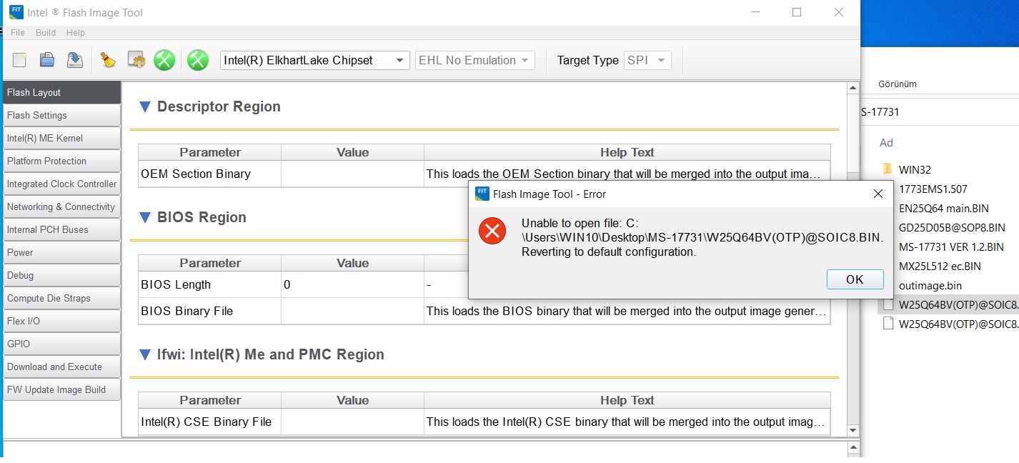

    hi.I can't clear me in msi bios. It gives error.
    If there is another bios, I would like to try it.
    thanks..

    Don`t use OTP to backup it adds extra code,it is not a one time programmable chip, your backup is 8,193KB it should be 8,192KB. Post the full laptop model number such as "GS70 2QE " .MSI support has full bios images,go there enter the model number
