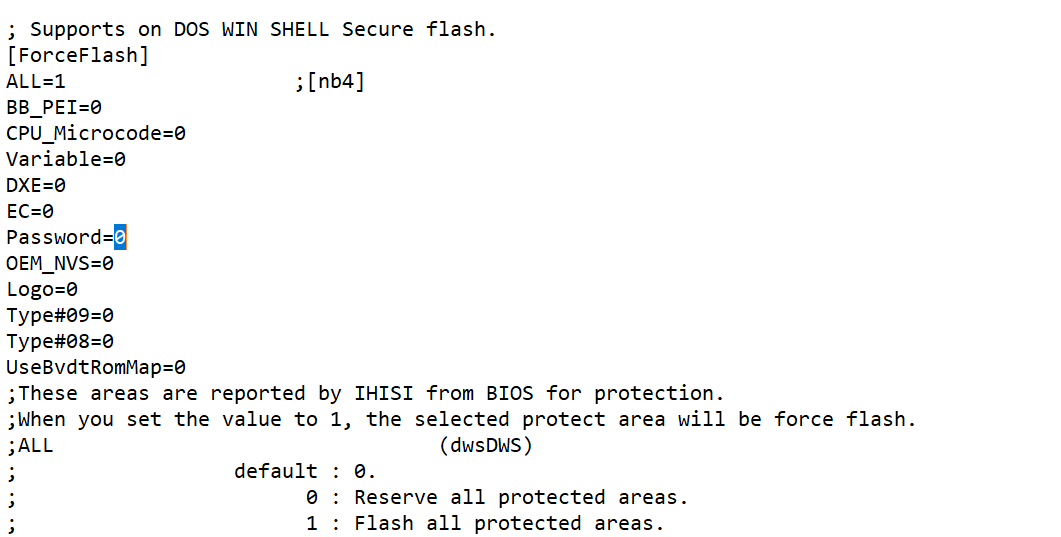

    You have to use an SPI Programmer to read the BIOS chip and upload its content here to remove the Password from the file, after that you can flash the new file to your BIOS chip. You can't remove the Password by installing a new BIOS through OS.
    Read this topic to know more:​
    https://www.badcaps.net/forum/troubl...21#post1622421

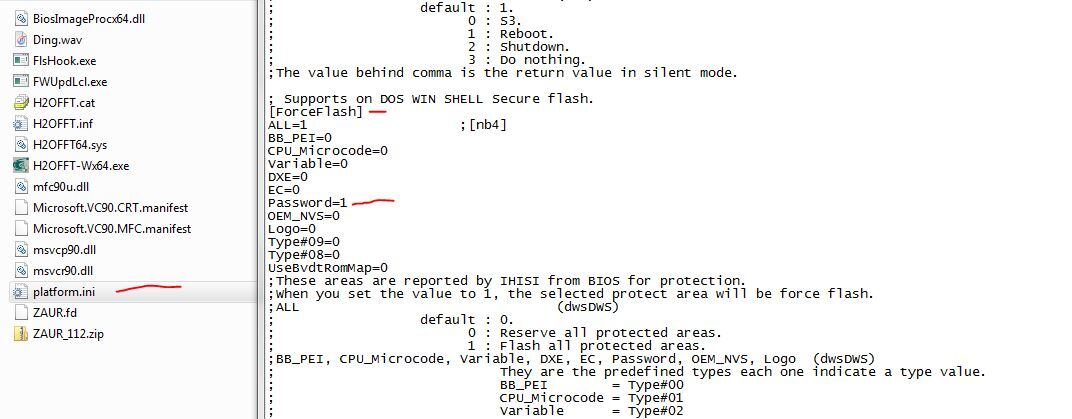

    Its possible, by editing the platform.ini file
    • hardware1
      • Sep 2021
      • 2949
      • N/A
      Very nice, will try it when I have Acer laptop with a Password. So I just need to change the value there to be "1" instead of "0" then run "H2OFFT-Wx64.exe" to update the BIOS?
      This "Force Flash" will force the laptop to accept the BIOS even if the current BIOS version is higher?
        You would have to edit the platform.ini some more. Bios_Version_Check

          Alright, thanks.
