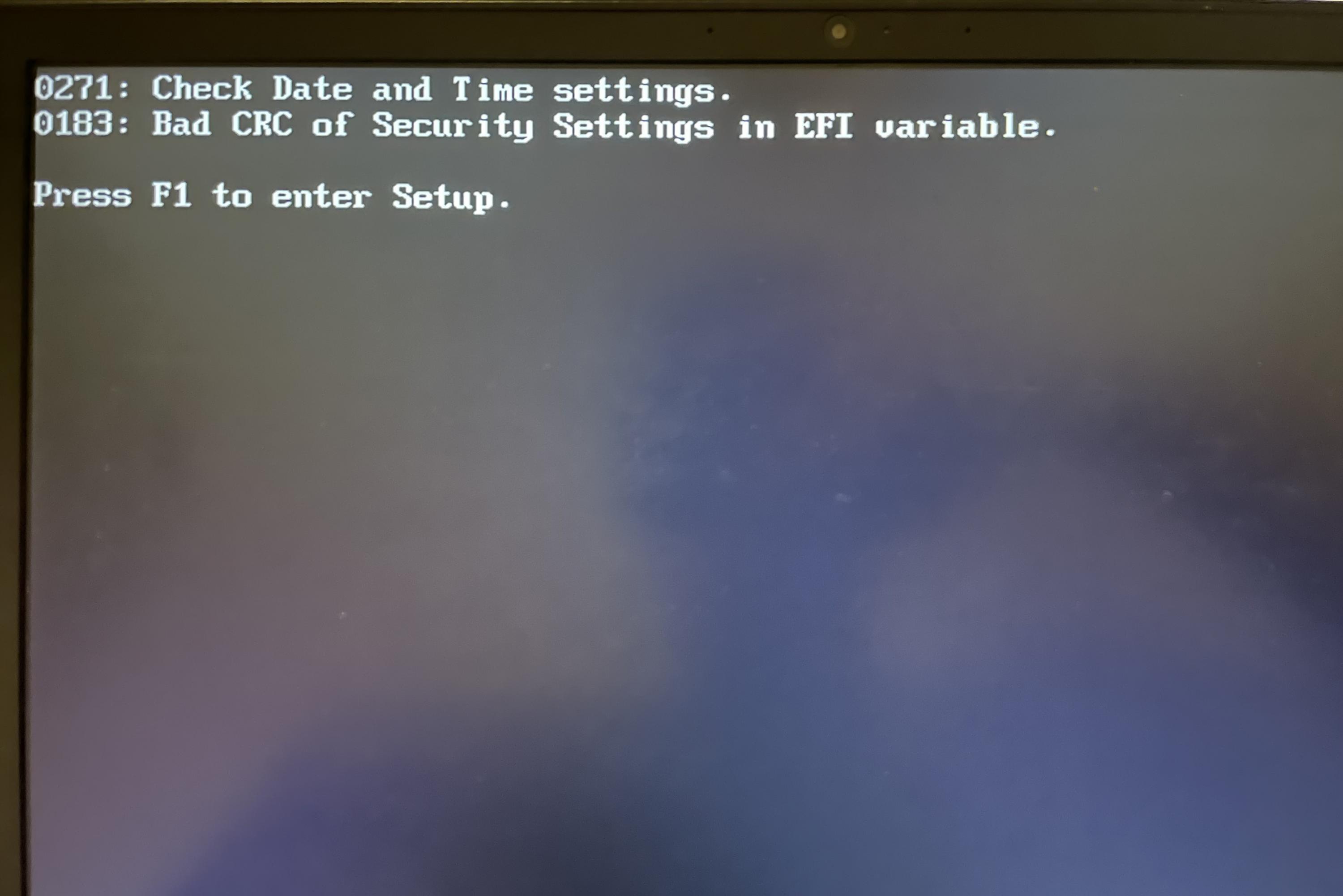

      Wow - thanks for the quick reply. Partial success! The laptop is showing signs of life as it is now posting...
      However, there is a Supervisor Password set, which I've not been able to unlock having tried a range of defaults. Also, there are two errors being reported - both are stopping from booting, running diagnostics, etc.
      0271: Check Date and Time settings.
      0183: Bad CRC of Security Settings in EFI variable.
      A photo is also attached.

        Try starting the machine without the CMOS battery or check and replace the new CMOS battery.
        Re:0183: Bad CRC of Security Settings in EFI variable
        The CRC error could be caused by the file itself or the hard drive. Among are the possible causes of the said error: hard drive corruption, misconfigured files, registry file corruption, cluttered disk or unsuccessful program installation
        Press F1 when error message appears.
        Enter ThinkPad Setup menu.
        Navigate to the [Restart] menu and check that [OS Optimized Default] is same as you set before. The default setting is On.
        Press F9 to reload default setting.
        Press F10 to Save and Exit.
        Error message will no longer appear.

          Obviously, can only attempt to solve 0183 once I get into the BIOS itself. Supervisor Password is still there regardless of the number of times I remove the CMOS Battery, and completely discharge the board... Leading me to believe it is in fact dead.
          I will order a replacement in the morning, and advise of any updates.

            Bios password? Did you set it before?
            https://www.badcaps.net/forum/showthread.php?t=87588

              Re: Lenovo Thinkpad E590 20NB-0016UK
              Yes, I did.
              Let me try the link.
              • chr892
                • Oct 2022
                • 6
                Worked a charm, password removed and no errors.
                Thanks for your help!!
