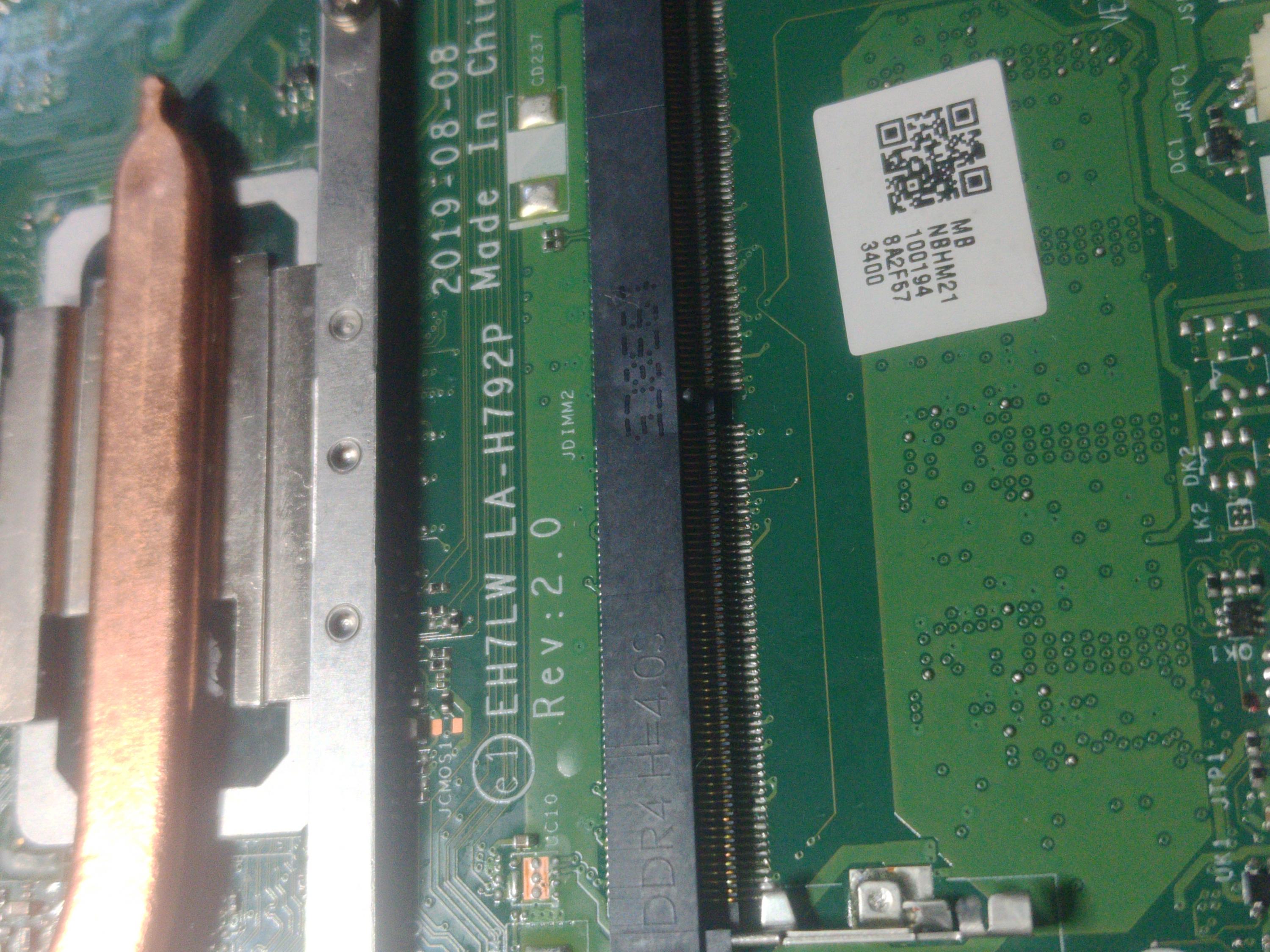

    Hi guys,
    does anyone have working Bios for this model, size is 8mb, and i found only 16mb on forum. Old bios in attachment.
    Acer Aspire 3 A315-54-32WU
    EH7LW-LA-H792P Rev 2.0
    Thanks in advance

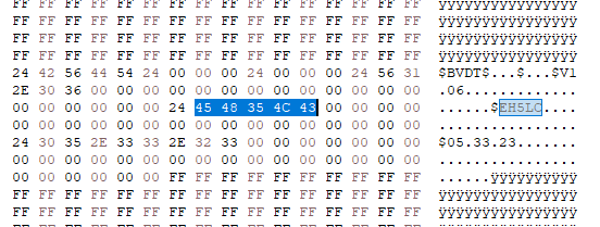

    Something wrong with your file. your bios should be 16mb, maybe there is another 8mb chip, or your file is corrupted.

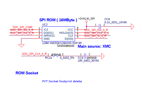

      Your Board should be (EH7LW), but in your file is (EH5LC).
      also the schematic said your chip should be 16mb.

        The base cover,with the model number on the sticker could be from a different laptop. The EHL5C extracted bios is 16MB .Opening the OP`s bios with UEFITool returns errors ,proving that the bios is all wrong. It should be flashed with a EH7LW bios,on a 16MB chip (@hardware1 you are right).

          Well this is the chip QH128AHIG, is it possible that EZP cant read it correctly, thats only one explanation, it detect as 8mb...ech seems its time to order some better programmer.

            Yes,i`ve seen a lot of errors with the EZP programmers,choose the chip manually if its in the support list,and if not choose something else like W25Q128.Post the bios again

              ok, model wasnt on a supported list but Ive read it as W25Q128BV, anyway it looks weird , also I dont get it laptop had a sticker on screws, was never open before and customer said he bought it from media markt so how its possible bios is wrong ???
