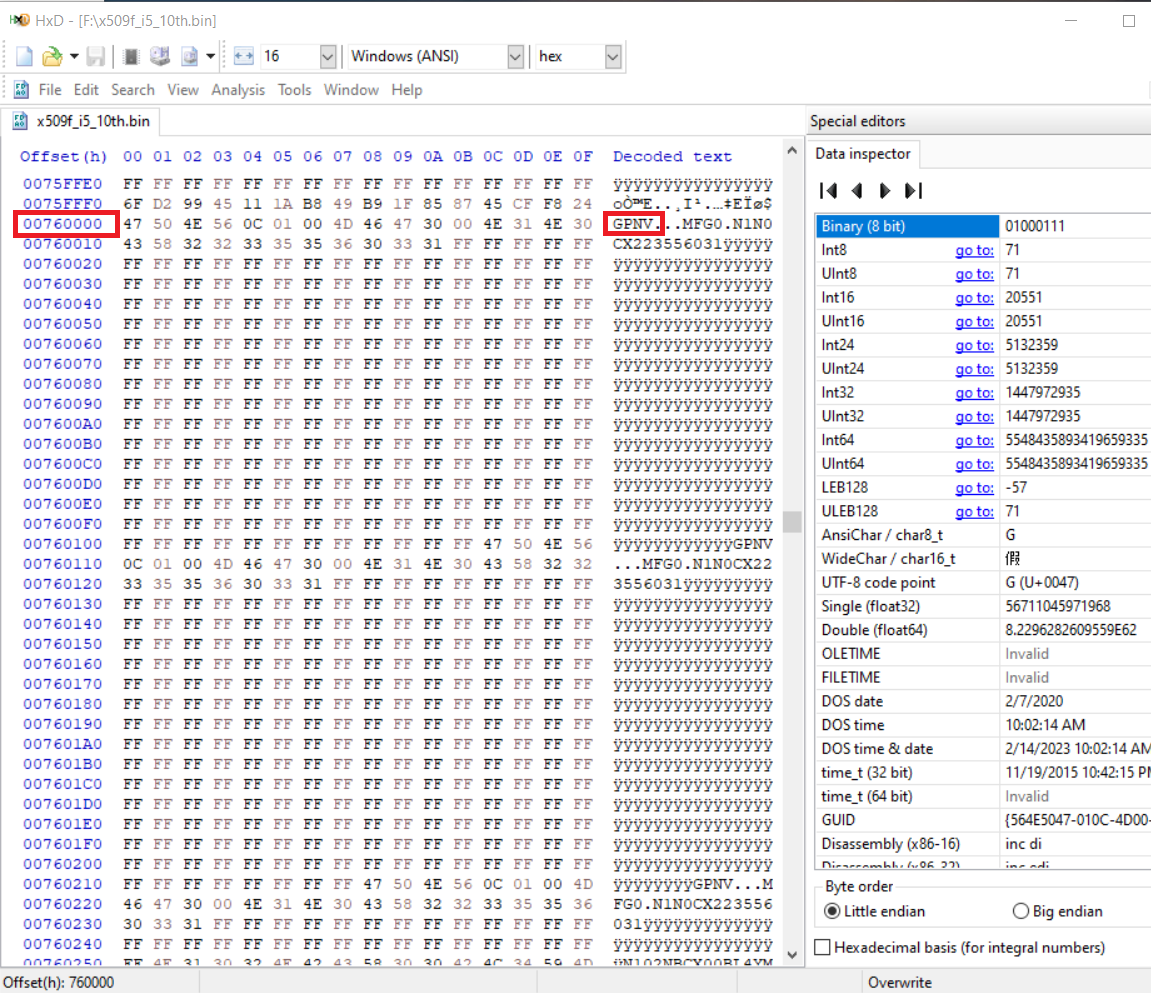

    hi,
    arrived with corrupted bios, i programmed a dump and it works fine.
    Now I need to change serial number, i tried DMI editing with WBT.exe but no luck.
    Does anybody have fix it?
    thank.

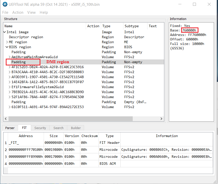

    Re: ASUS X509FA-BQ1064 change serial
    Look at the pictures
      just change with my serial?
        I fix it!!
        it was enough to replace with my serial in all the strings in which it was present.
