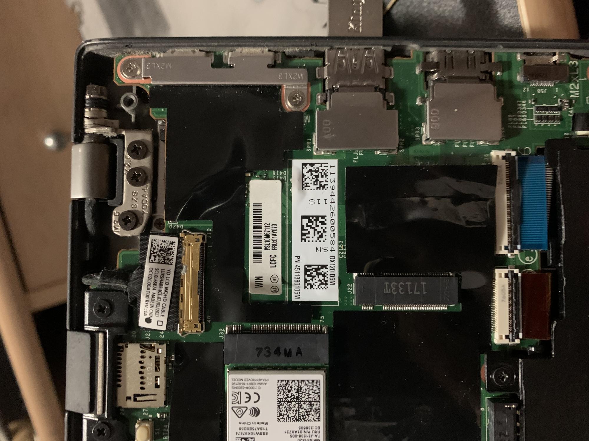

    I have a "Lenovo X1 Carbon 5th Gen" it has a power up issue and when it tries to boot i get an error ME FW Downgrade - Request MeSpiLock Failed.
    Im assuming previous owner tried to downgrade Bios FW or a failed update?
    If that is the case how can i fix it. I have a programmer.
    Cant boot a USB to update bios.
    Cant boot windows to run bios update tool.
    I assume ill have to update with programmer.
    Do I use a donor image? Can i apply update to the dump or directly to chip?

    Post the serial number,Model Type and your corrupt backup

      Laptop Mode: Lenovo X1 Carbon (5th Gen)
      Machine Type Mode: 20HQSZUU00
      System-unit serial number: PFOUJ677
      System board serial number: L3HF77K021X
      Motherboard Model: DX120 (NM-B141)

        Try this file.

          Re: Lenovo X1 Carbon 5th Gen - ME boot Error
          Try this file.
          Same thing when i go to boot menu and select any item it powers off.
          Have to remove battery and reinsert to power up again.
          I get CMOS Checksum error Bad CRC.

            Do you have this FRU number on the motherboard 01AY073

              Yes that is correct
                  Originally posted by Ghamidi
                  Try...
                  I was able to boot to a device once after this image but if i turn it off it wont come back on unless i press the reset button under board or pull battery to remove power. also seems to do a re-run system check at first power on each time. it is black screen but led and keyboard light up after 30sec or so it powers off and every few boots it comes back on and shows lenovo screen.

                    try this one.
                      Originally posted by SMDFlea
                      try this one.
                      same turns off after selecting boot device Iv linked a video maybe it will help?
