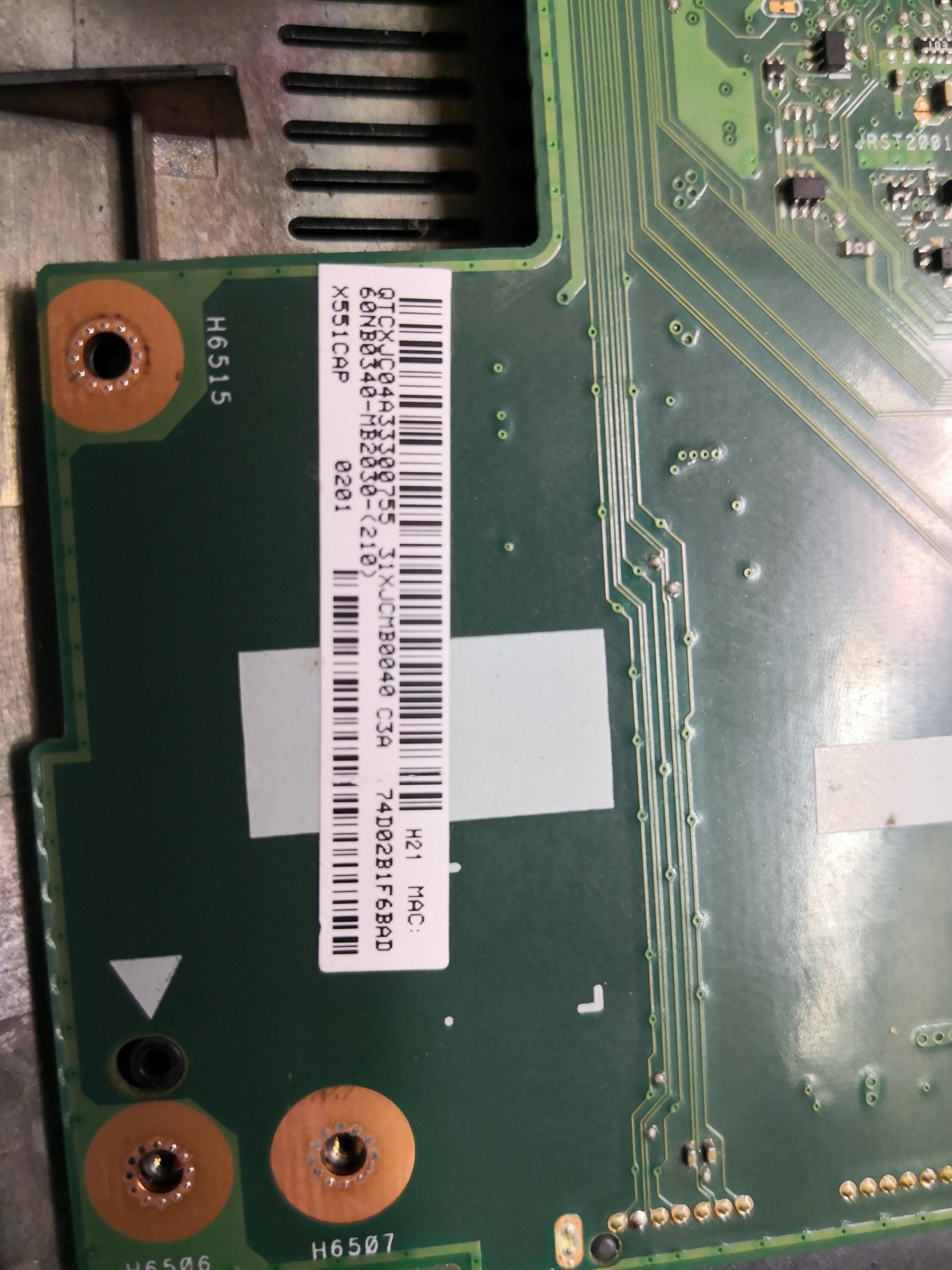

    hello every one
    i need bios dump for asus mainbord x551ca rev 2.1
    i use search all i find is rev 2.2 and it dosnt work
    mainbord built in ram there is no memory slot
    here is my dump

        Post the laptop serial number and a picture of the barcode sticker on the SATA connector, if there is one
        • egypt_tiger
          • Sep 2015
          • 36
          • egypt
          Re: help with asus x551ca rev 2.1 bios dump
          here is them

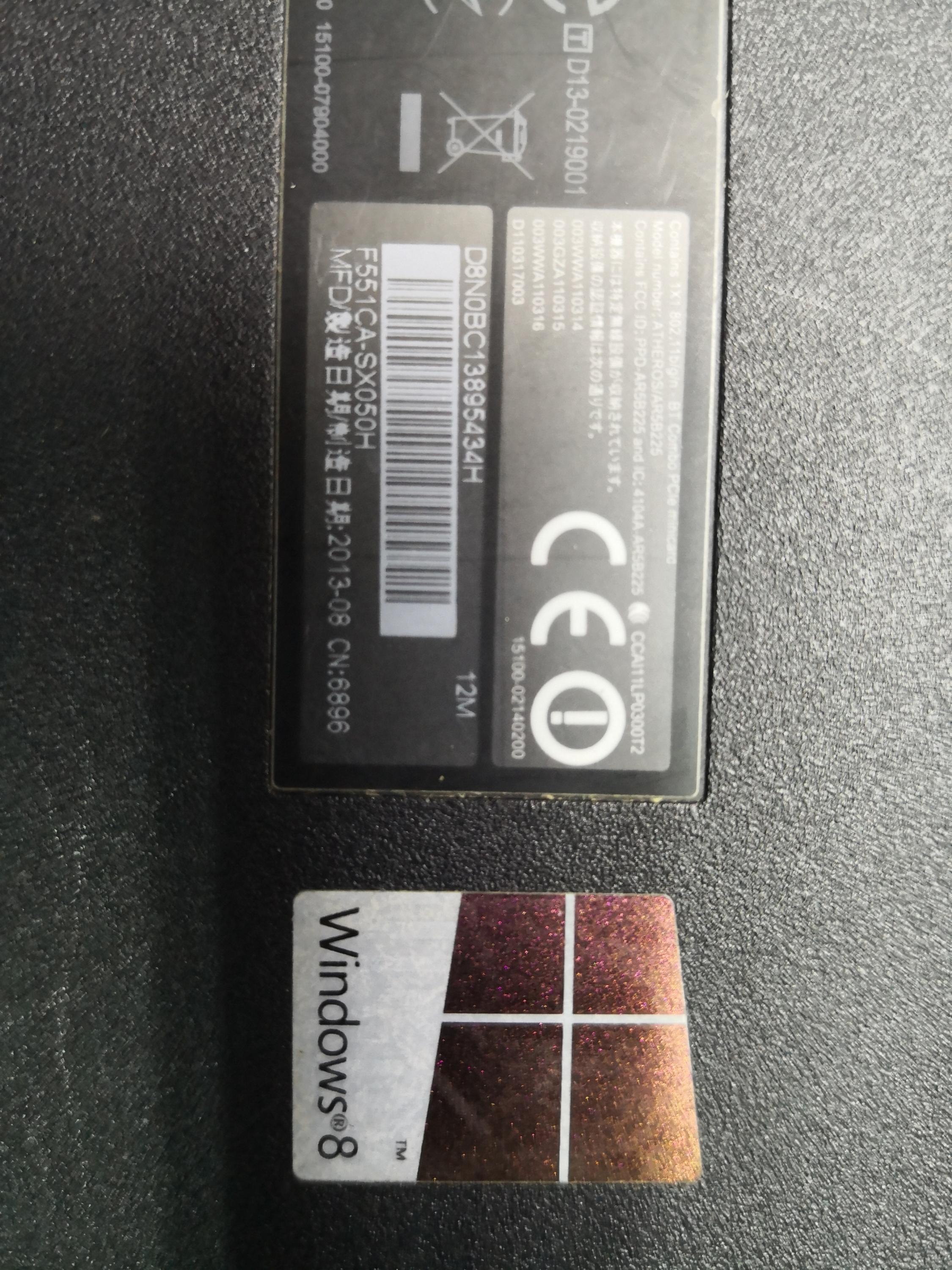

            I have repeated my procedure and both output images come out identical. I downloaded the update for Asus X551CAP model as shown in the second picture and confirmed from the original backup. FIT was used to build image with clean ME region, and only the winkeys were added using hex editor.
            Verify that the new bios image was really written, check for any blown away devices, resolder pads, check voltages, particularly leg 8 of bios chip, should be 3.3v or 1.8v for newer models
