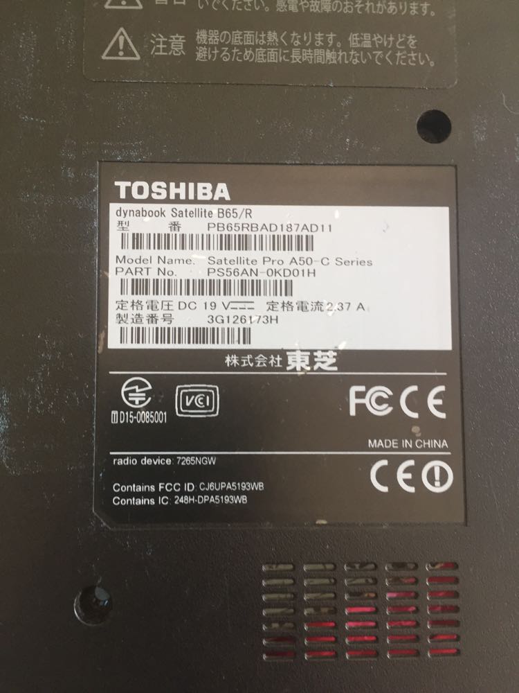

    I use comextract to extract to but its 3.5mb i backup 8mb?? does anyone know how to do it properly??

    here my backup bios bin

        The bios you posted is from a dynabook Satellite B65/R .PS56AN
        The PS56AN extracted bios update is the same as the one you posted for the PS56AC. It can`t be merged/edited with your backup as its corrupt.
        Edit: What is the motherboard model/part number

          The first main issue for this one is that the SSD is read in bios but can't load Windows OS i tried to reinstall the OS but nothing happened then i wanna try to reflash the bios but i maybe manage to bricked the backup since i reflash it again back i got no cpu activity and no image.
          i try to merge a bios update got a usb power and CPU Turning on but no activity. i'm a newbie idk what i'm doing i just copy a section of what i thought could be the same block in my backup.
          Toshiba Satellite Pro A50-C (PS56AN-0KD01H)
          Board# : (FAEPSY4 A4097A)
          can someone pls rebuild the bios?? with the information in my backup?? or a working bios?? much appreciated help. thank you.
