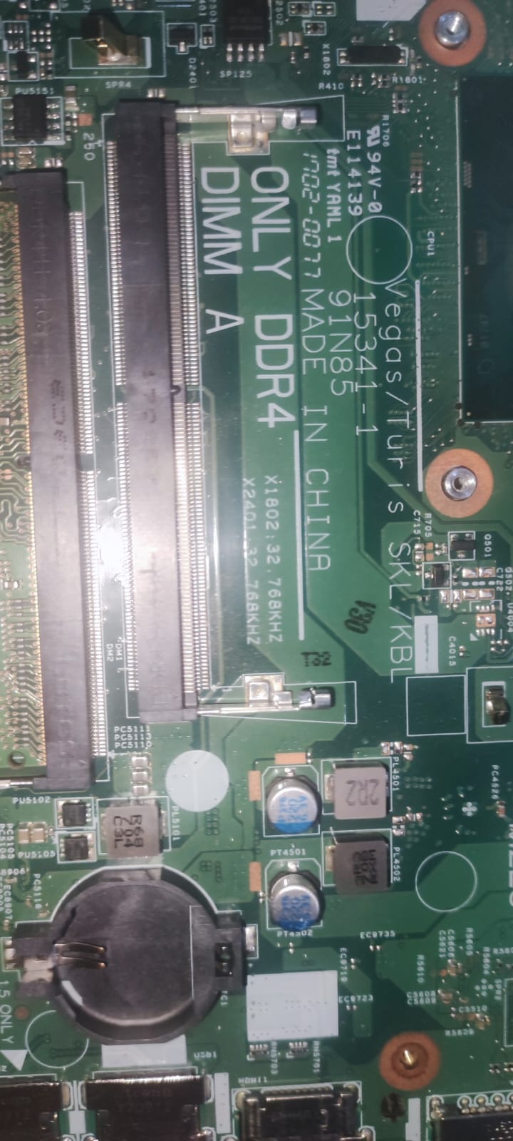

    During bios saving i have lost orginal bios of Vegas/Turis Skl KBL 15341-1 91n85
    laptop motherboard
    Is there any helper for giving me clean bios of this board
    Even i dont have service tag no, and corrupted backup
    Just have board id printed on motherboard
    Thanks in advance
    Site bios attached here

    Without the original file, the complete bios file cannot be built.

      Sir if i have working bios of another same model board, but not working on my board
      can u make some changes on it to make it working bios for my board????

        That's bios for Vostro 15 3568.

          Thanks sir, but i copy it from working vostro 3468
          Anyhow, any more solution ????

            I'm not sure if it can work or not.

              Not working
              Sir can u make another try on this bios????

                Vostro 3468 and Vostro 3568 share the same Bios region, the others do not. It certainly won't work with the Inspiron bios.

                  Sir i search on google through board id
                  VegasTuris Skl KBL 15341-1 91n85
                  Then i found that above posted bios__________ board code is same, only the diffrence inspiron and vostro

                    Try searching on the forum
                    https://www.badcaps.net/forum/showth...highlight=3568
                    https://www.badcaps.net/forum/showth...dell+3568+bios

                      Thanks Sir SMDFlea and special thanks to sir hoaca388
                      But during repairing process, the owner of that lapi, took back so i cannt confirm laste posted bios on it

                        Finally got 100% working bios vostro 3468
