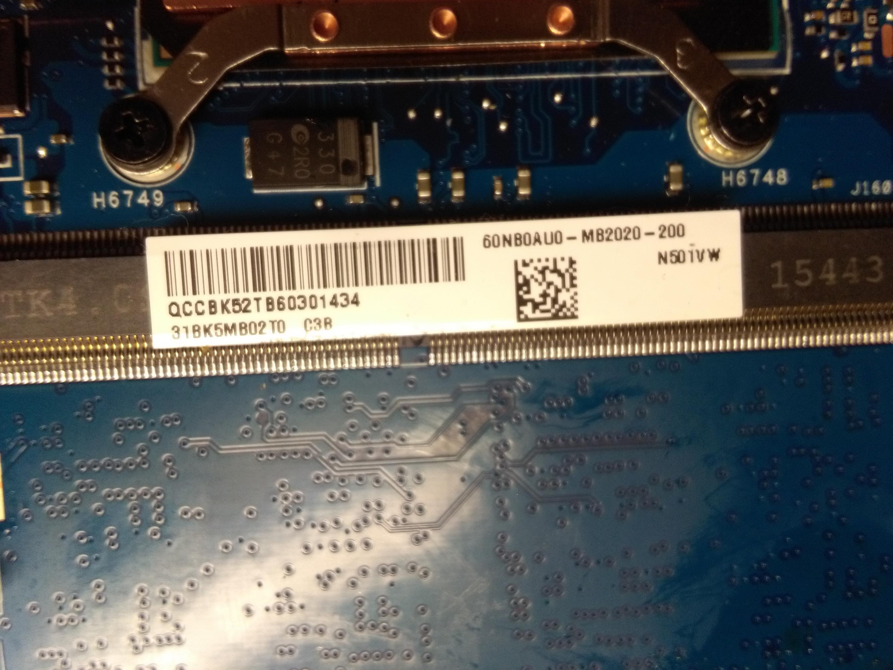

          Asus UX501V Bios need
          Hello. I need bios file to Asus UX501V UX501VW-FY010T
          60NB0AU0-MB2020-200
          QCCBK52TB60301434
          31BK5MB02 T0 C3B
          I tested various bios from this forum, but either there is no image or the keyboard and touchpad backlighting does not work

            Re: Asus UX501V Bios need
            Post your old bios, I need it for the DMI region and ME region version.
                Originally posted by SMDFlea
                There is no need to post multiple thread for the same thing. If you do what members have requested from you then the bios can be fixed.
                I'm sorry for that.
                The problem is that I got a laptop with a non-working touchpad. The first thing I did was update the bios via Winflash and probably after that the keyboard backlight stopped working. I replaced the KBC, but the touchpad and keyboard backlight are still not working. I tried different bios but without success. Everything indicates a problem with the bios, KBC connects to the mass of J3102, and on J3103:
                n1, n2 - 5V
                n3, n4 - 3V, and it should connect to ground for the backlight to work.
                There are tools posted to fix the keyboard backlight pproblem,but if your original bios is fixed it should be ok.
                What tool? Can you send link?
                //Edit: I fixed Keyboard backlight via ASUS Block Transmit Tool. But still touchpad not working.

                  Try this one, new Bios from Asus website and your own DMI region, with cleaned ME region.
                  • scarman20
                    • Jun 2013
                    • 13
                    • poland
                    Re: Asus UX501V MB:N501VW rev 2.0 EC
                    Thanks for help, laptop is working ok on your file but touchpad still missing. Why did the keyboard backlight start working only after using bt2.exe and not after programming with different batches? Is there a bios area that is not programmed and only the bt -c cnfg / w dd 7c command saved the changes in this area? Maybe there is a command to run the touchpad?
                    • Mazorca
                      • Jan 2017
                      • 463
                      Did you check the obvious, laptop might have an enable/disable touchpad key on top of keyboard. Does driver show up for ps/2 keyboard on device manager?
